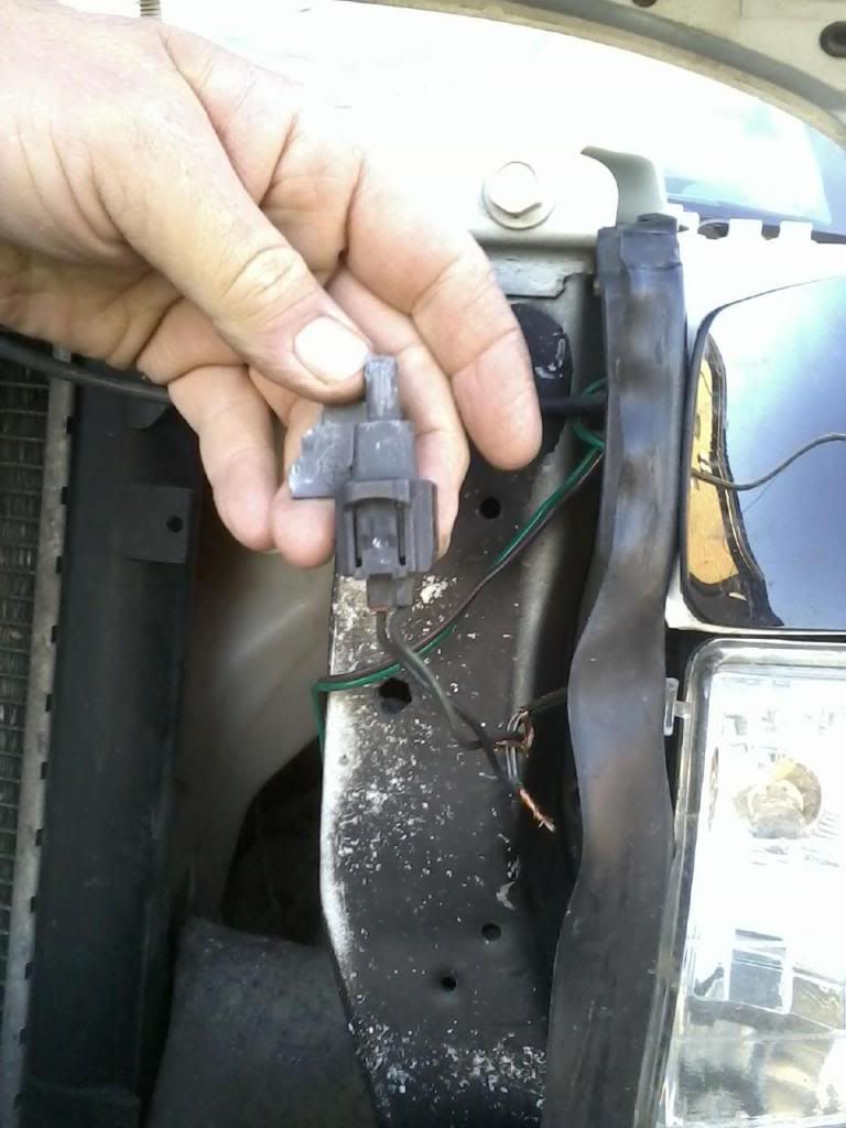

Hello Mark...I will keep an eye out for your top. I am documenting for a future conversion and have 3 others watching that are new to yotas. Alot of this you will already know and have seen on here but others have just started following.
I finally pounded something into my brain. The CSI Timing Switch is 24mm. It is an odd sized sensor and I always forget the correct wrench when in the yard. I even learned something.

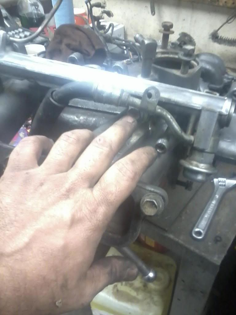

Here is where you remove the harness using the finishing nail to undo the clips. Will need to remove hoses as well to get the Plenum separated from the Intake.
After this step is done you then are down to the Fuel Rail. There are two bolts that mount the rail to the intake. Above my middle finger, a 10 mm bolt( not shown) you need to lift up the metal fuel rail to get one of the bolts. The Allen Bolt is used to attach the intake to the block.

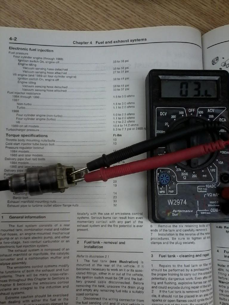

I took several injectors and got a complete set that matched to the same resistance. They were to be 1.5-3.0 ohms. All read 3 ohms.

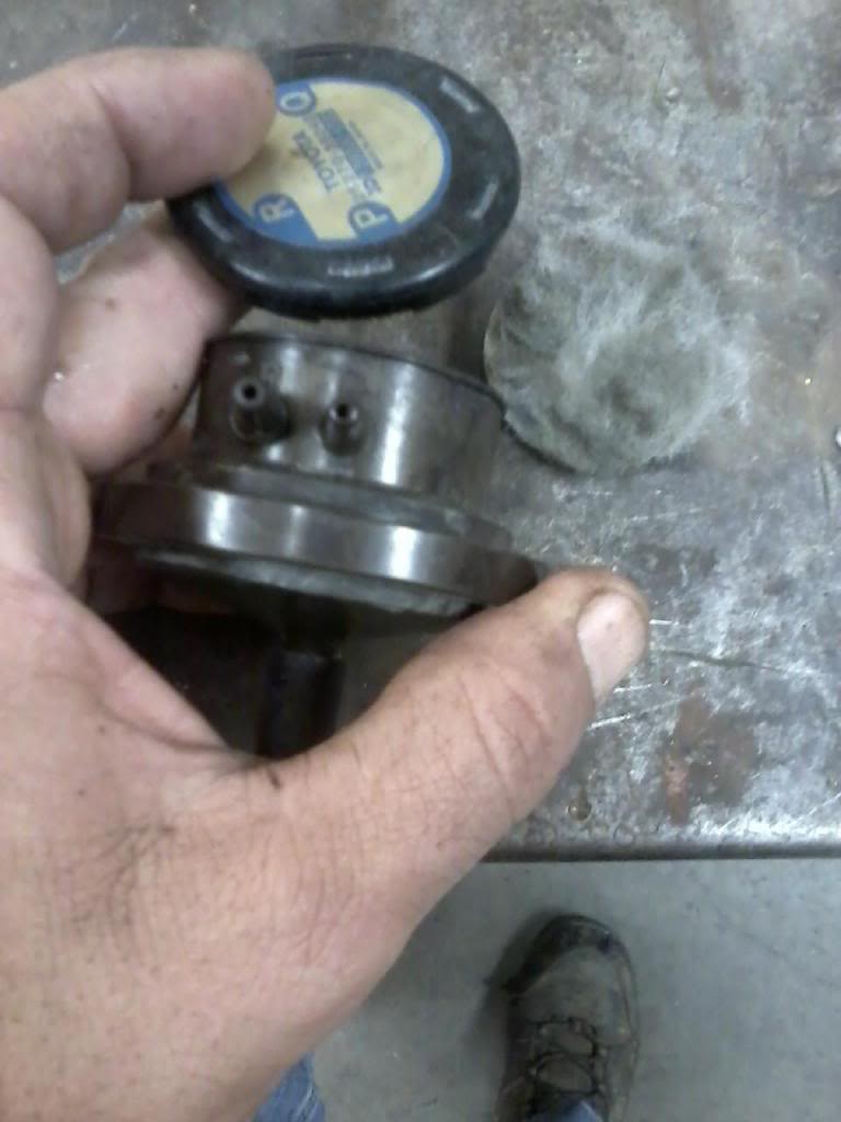

Where my finger and thumb is at, these two are connected and let air flow when working correct. Both needed cleaning as were clogged with carbon. Eay to over look.

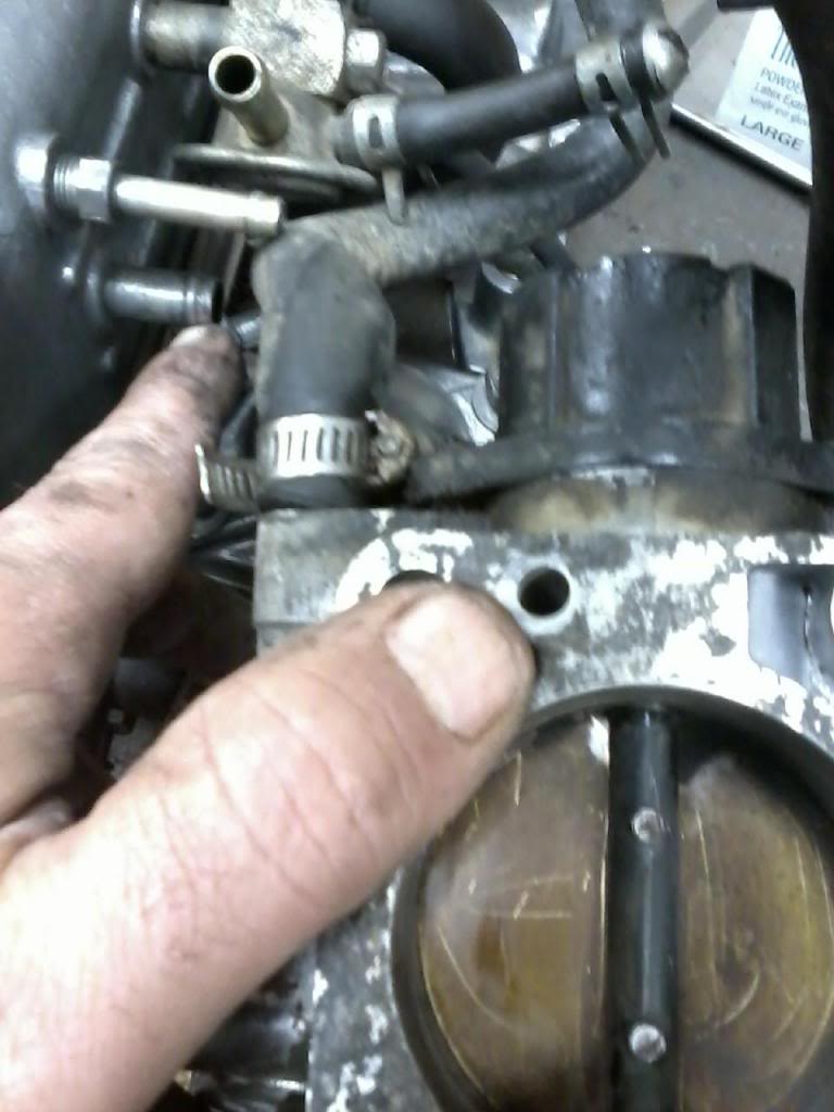

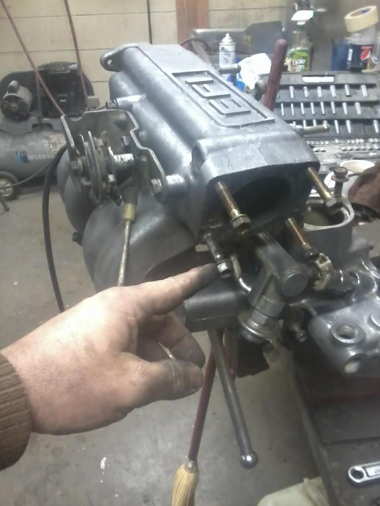

Inside the Throttle Body, you will see 2 dots and next to the flapper, there is a pin hole. These are connected to the 3 hoses on top. I use an electrical cleaner with the hose attached to a can and clear these lines as well.

Most of the lines look good on this system. Looking at this hose from the top, there is a hole in it and you would not see it without removing it. There is currently a thread posted on the home page where he is getting horrible mileage. Most likely a good tune up with great parts, timing settting, and a good cleaning of the Plenum would solve alot of his problems. He is getting a EGR code as well it souds like. I have always gotten an EGR code to go away with a good cleaning. I plan on working on the EGR tonite. I was also going to show how to test some of the other sensors, but that involved heating and cooling some and would be alot of pictures. Haynes does great at explaining alot of the test.

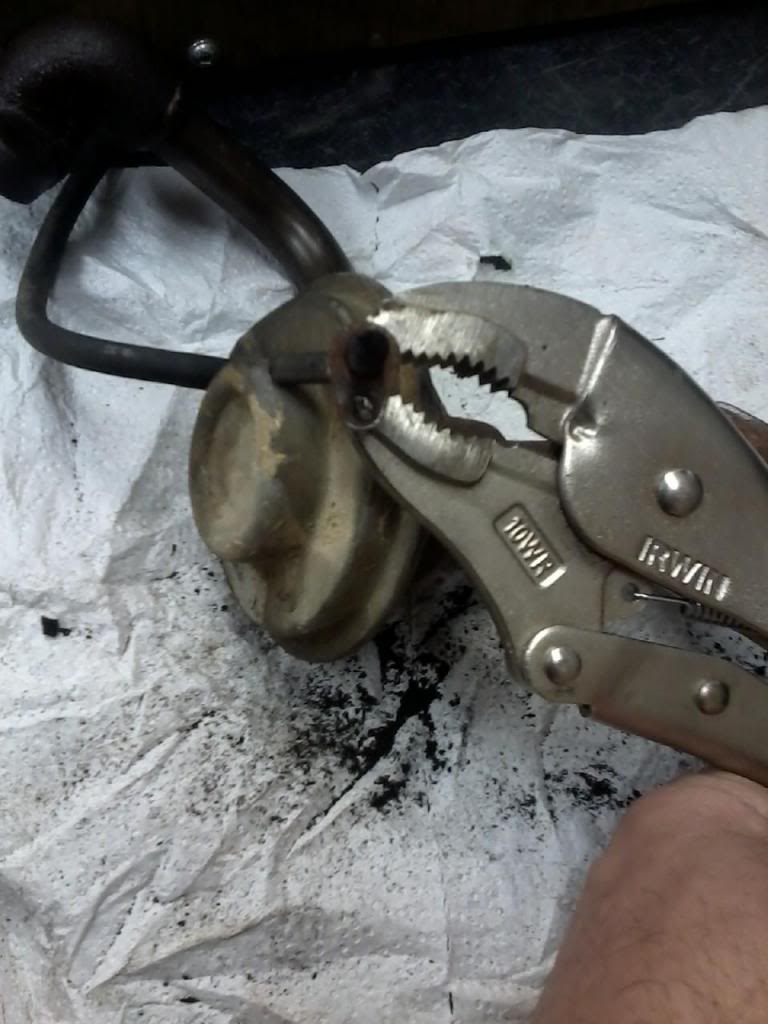

Here is the EGR. Here is another Phillips screw that will not come out with just a screw driver. I will need to use a pair of Vise Grips to get it broke loose. I have done plenty of these to already know it should of been put in with a bolt. Once the screw is out, getting the pipe out is another job in itself. The carbon will have the pipe stuck inside really tight. You can see in the picture that the carbon has the little pipe clogged and will be in the EGR tube as well.

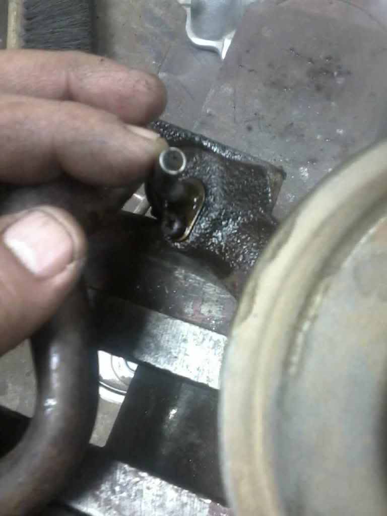

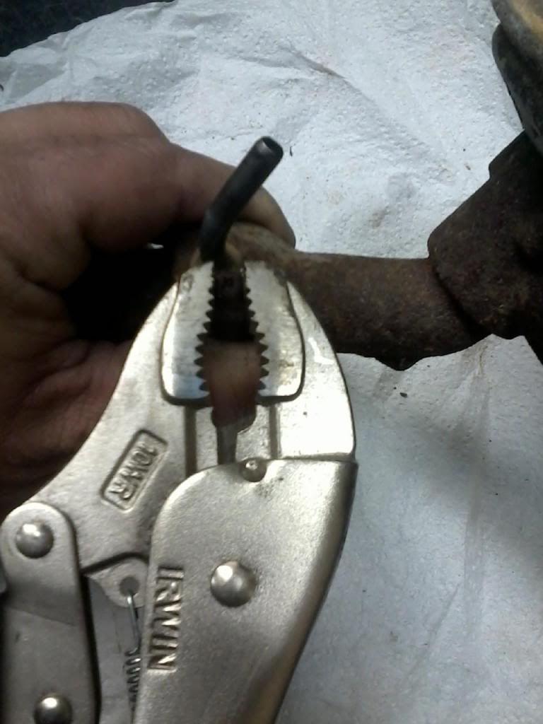

I worked on the EGR. Here is another picture that may look like the wrong way to do this, but the screw will strip if you use a screwdriver. Get a good firm grip, but not so hard to distort the screw.

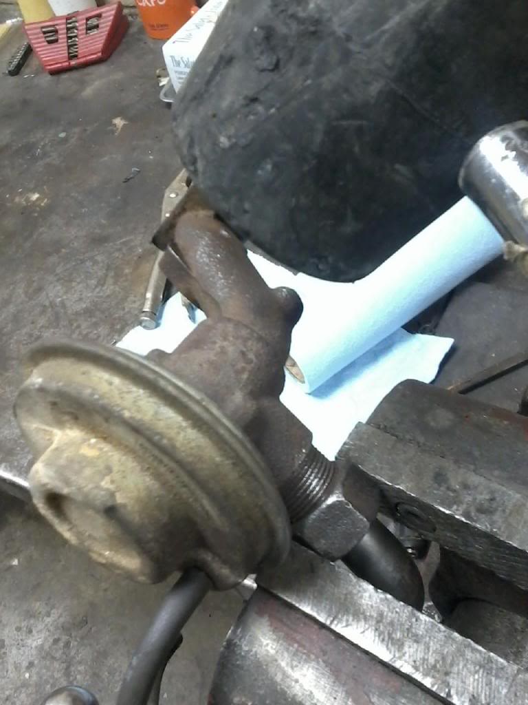

With the screw out, get another bite on the the pipe to get it out of the EGR. Leave the carbon in the pipe at this time as it will help keep the pipe round. The carbon is hard as concrete. Slowly work back and forth to get the pipe spinning inside the EGR tube and to start breaking it free. Could take up to 10 minutes but just be patient.
Once you get the little pipe out, I tap on the the big nut with a wrench to help break the rust up on the threads. The I mount the nut in a vise and tap in both directions, tightening and loosening, with a rubber hammer. I have tried using wrenches and did snap an EGRs threads one time which ruined it. These run about $150 on ebay if I recall right. This could take another 10 minutes.

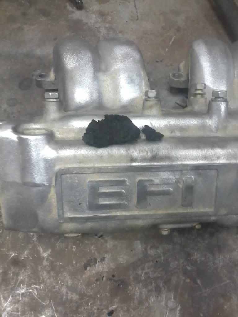

While cleaning the Plenum, I got a big chunk of carbon out of it. It is at least a 1/4 inch thick. It was dirtyyyy. It was all through the Plenum and had hoses blocked. This is why I block off the EGR.

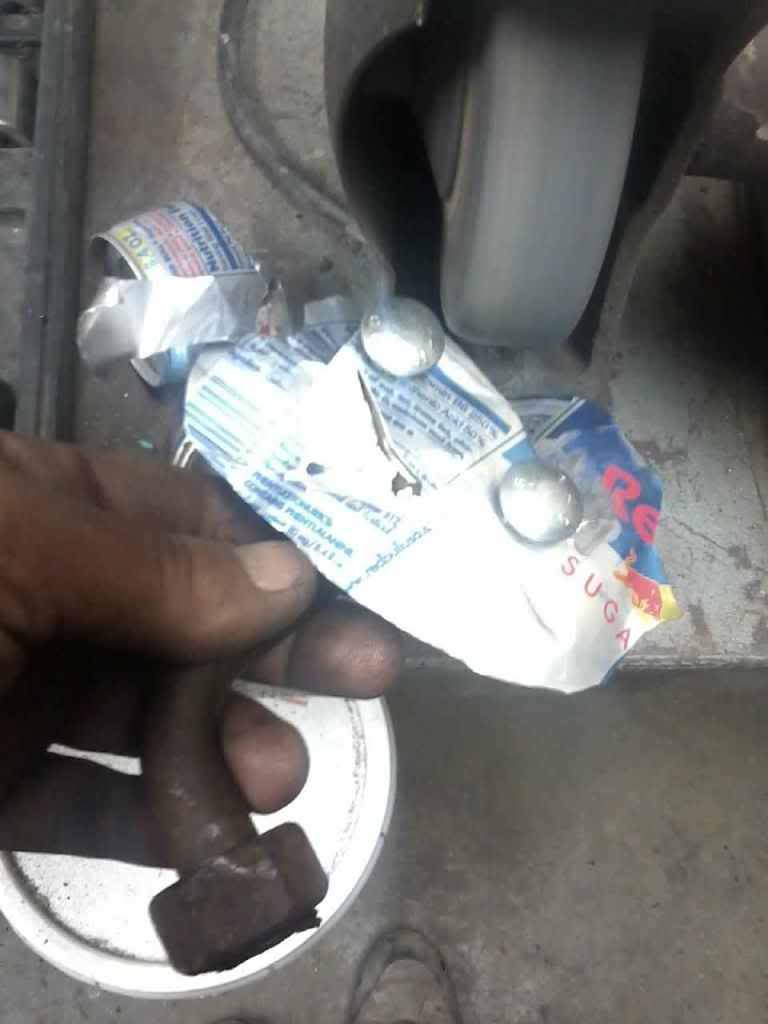

My high tech block off plate. Using a Red Bull can. Here you can see where the pipe broke.

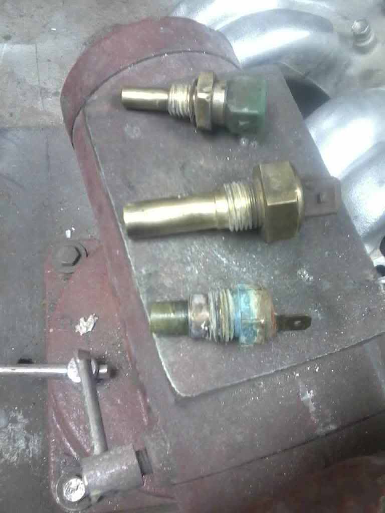

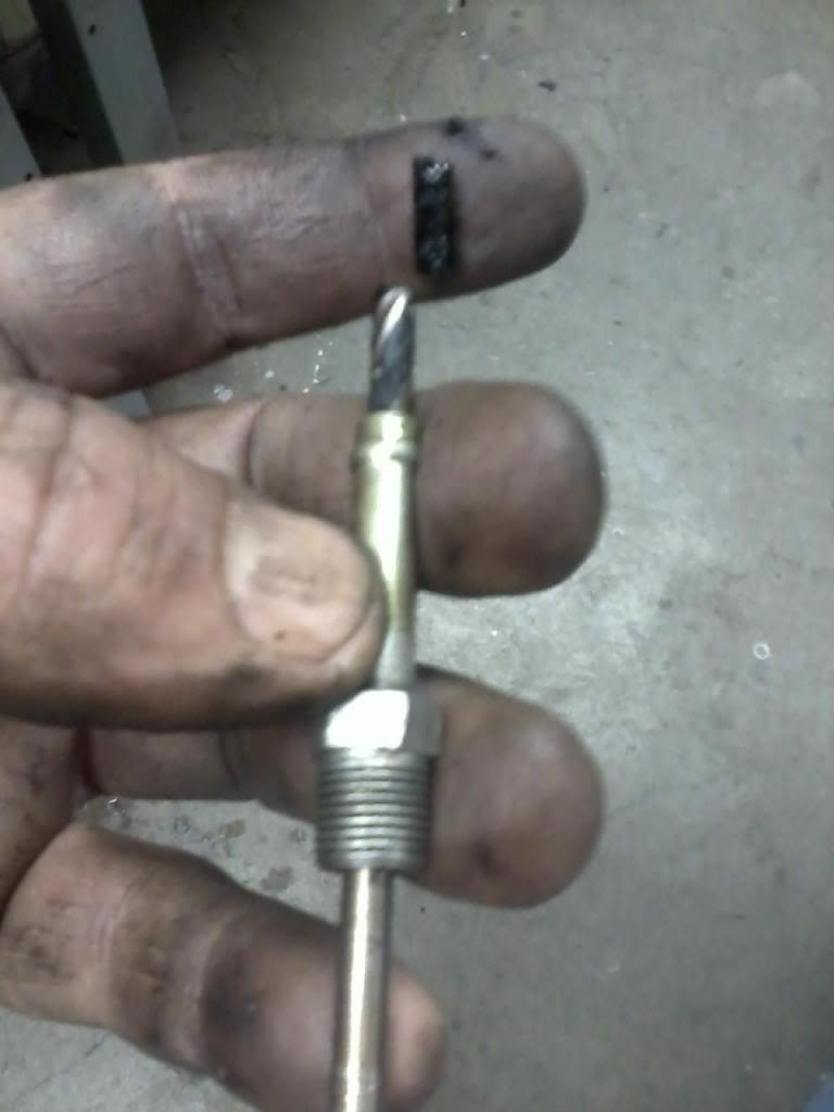

While tearing down the head, I cleaned the sensors. The top two are cleaned, but the bottom one isnt clean. This one goes to your water temp guage. I have had some gauges jumping from cold to hot. This one isnt as bad as some I have seen, Cleaning this one can solve your erratic readings. I just use a wire brush or a green scrub pad.

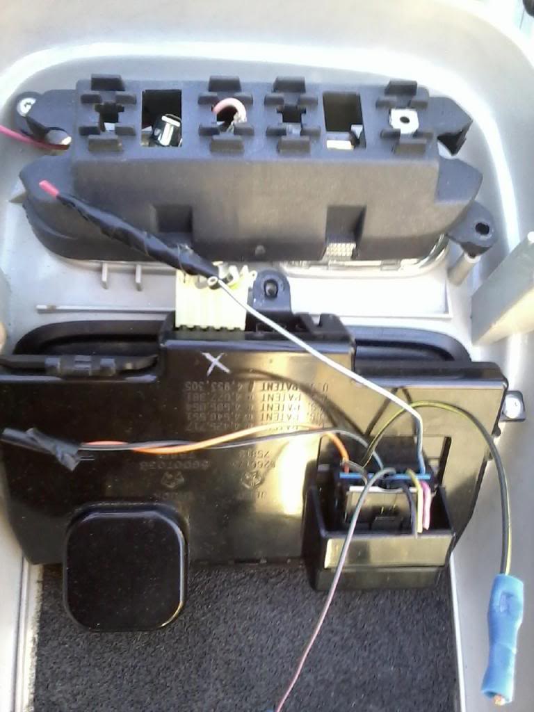

A future project that I want to try later. A friend of mine is fixing a 98 Dodge Ram. He was telling me that to add a temp and compass from a dodge is simple as adding a sensor under the hood and 2 power wires.
I will look at adding it below the stereo or something that looks like it belong. It wont be tacky looking. I am eventually going to replace the headliner in my runner when I get a good one and might see about mounting it overhead. I can not get the stains out of the headliner and soon as the yards dry out, I will be getting one from a runner that has a good one.
Here is one from the Ram.
Control Module behind the display.
Sensor under the hood.

cold as its been id like to have a temp sensor
98 dodge huh nice idea i look forward to seeing how ya do it terry
id be willing to remove the under radio not so useful cup holder i got for a blank panel to put in the compass an temp

Hmmm temp sensor would be awesome, to b ad i have a sunroof. Good write up on EGR cleaning Terry! always love seeing what you accomplish because you document it so well.
