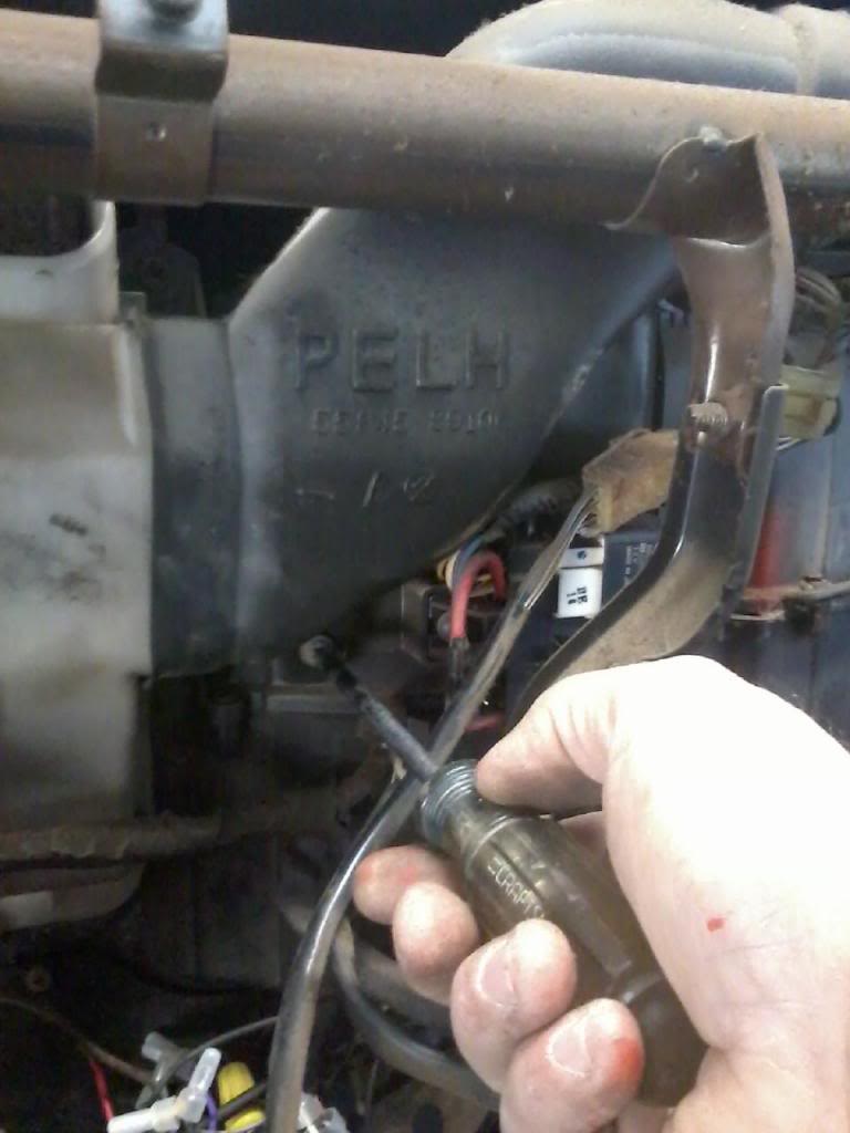

I am starting the EFI Swap. I will make the post short and add more info later as Iwant to get the most done with descent weather.

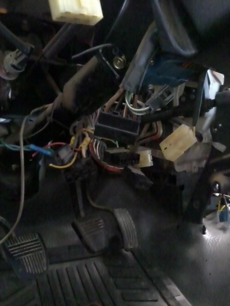

Remove the piece below the Steering Column. 6 Screws if I recall right. Disconnect the 2 plugs.

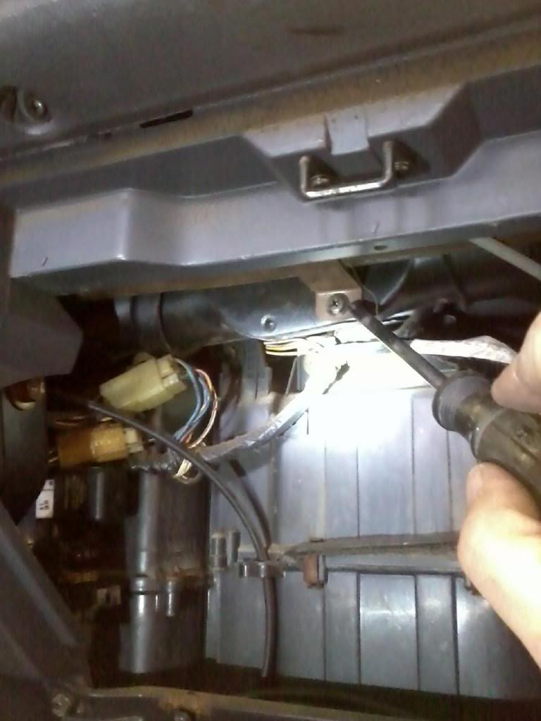

Remove the Speedo Bezel. Remove 2 screws above the gauge closet to the firewall. The plug in my hand to the Cancel Switch, lift up on tab to disconnect it.

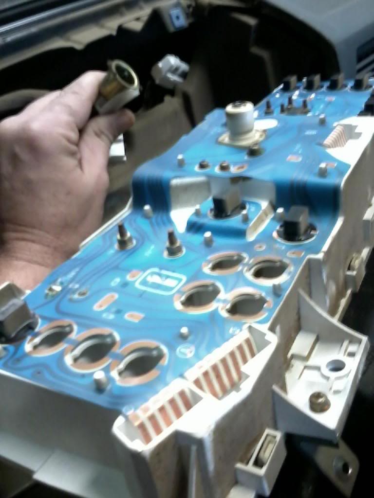

Remove 4 screws holding speedometer.

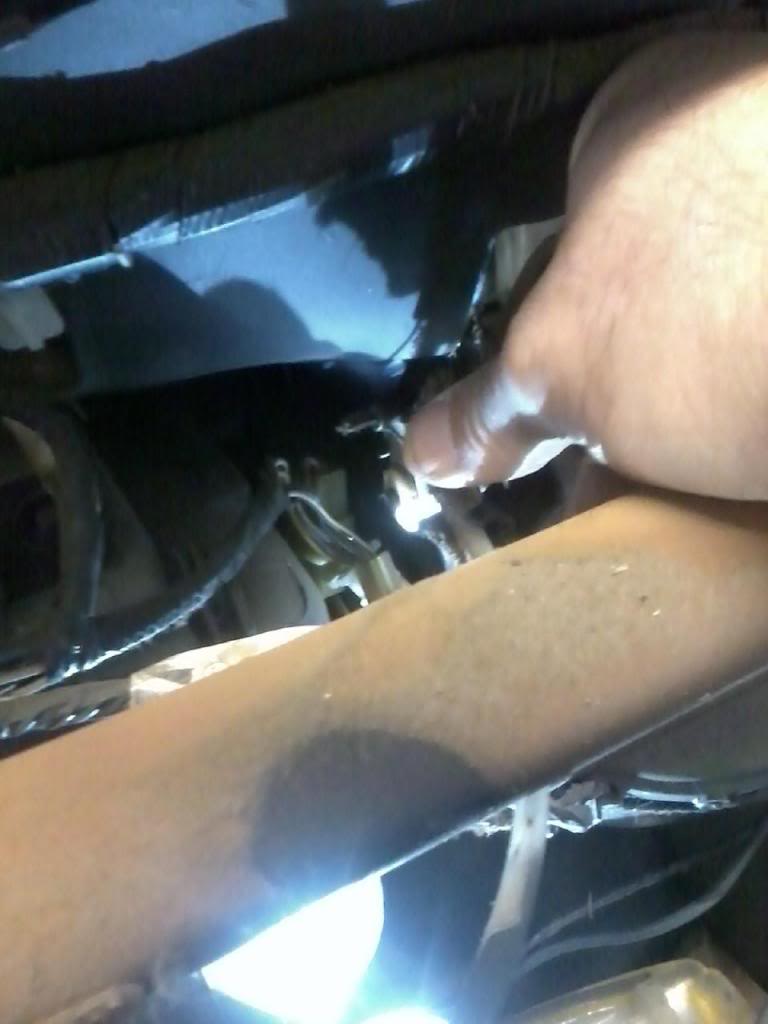

Under the hood on the firewall, remove cable from the clamp holding the cable. This will give slack to pull the speedo out further in cab.

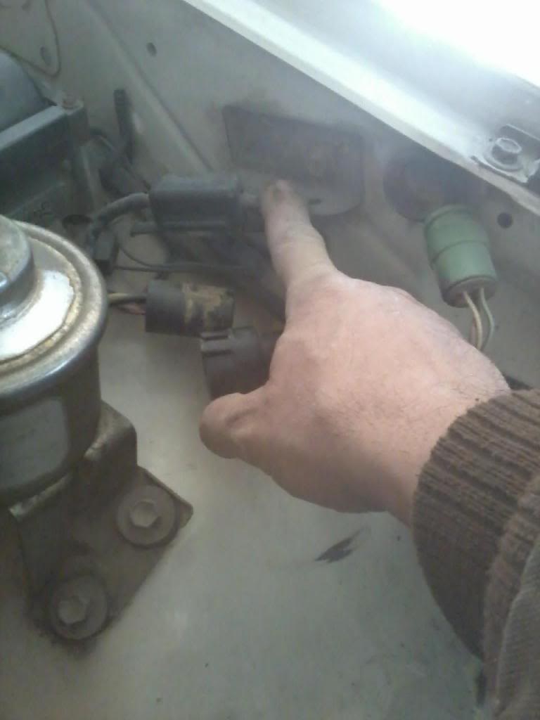

Disconnect 3 electrical plugs. The tab I am holding with my thumb, you just squeeze to release. It can be stubborn. Here is where loosening the cable under the hood makes it so much easier. If you need more room, you can loosen the cable more under the frame.

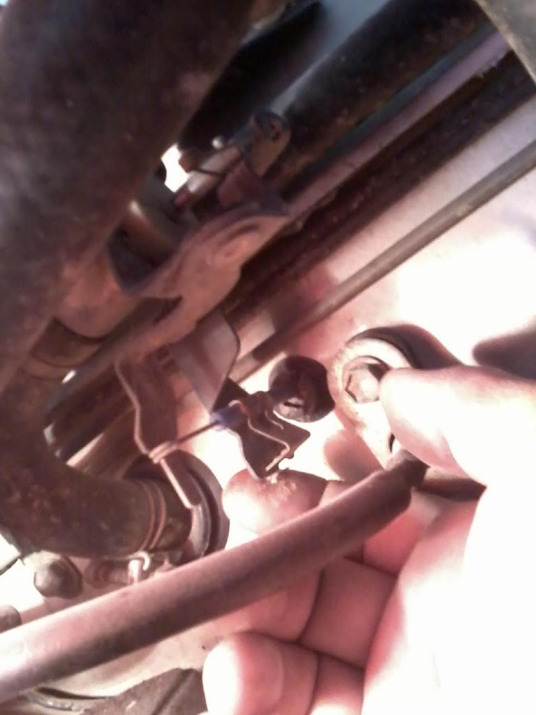

Remove the three 10mm bolts. 2 in speaker well and 1 up at top by blue plug.

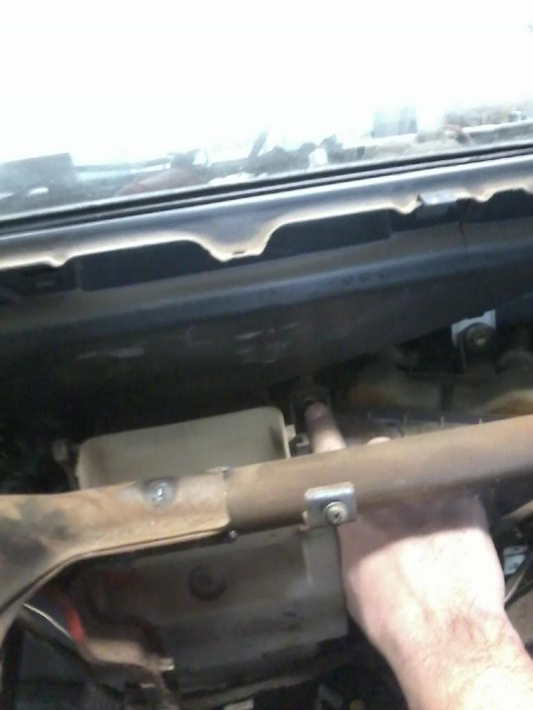

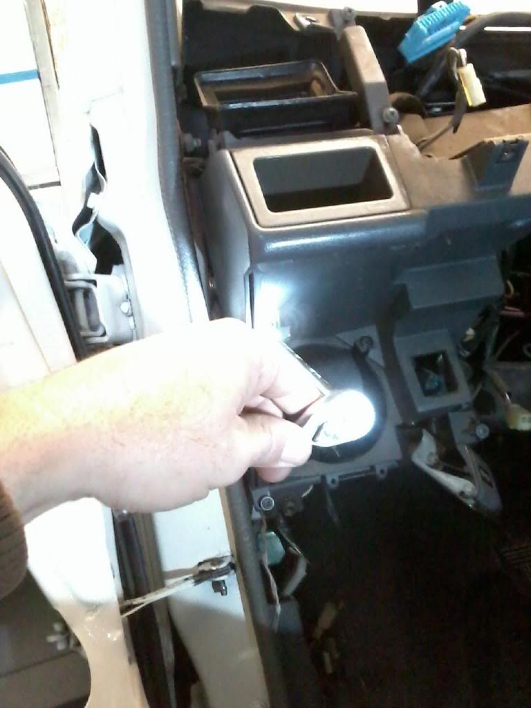

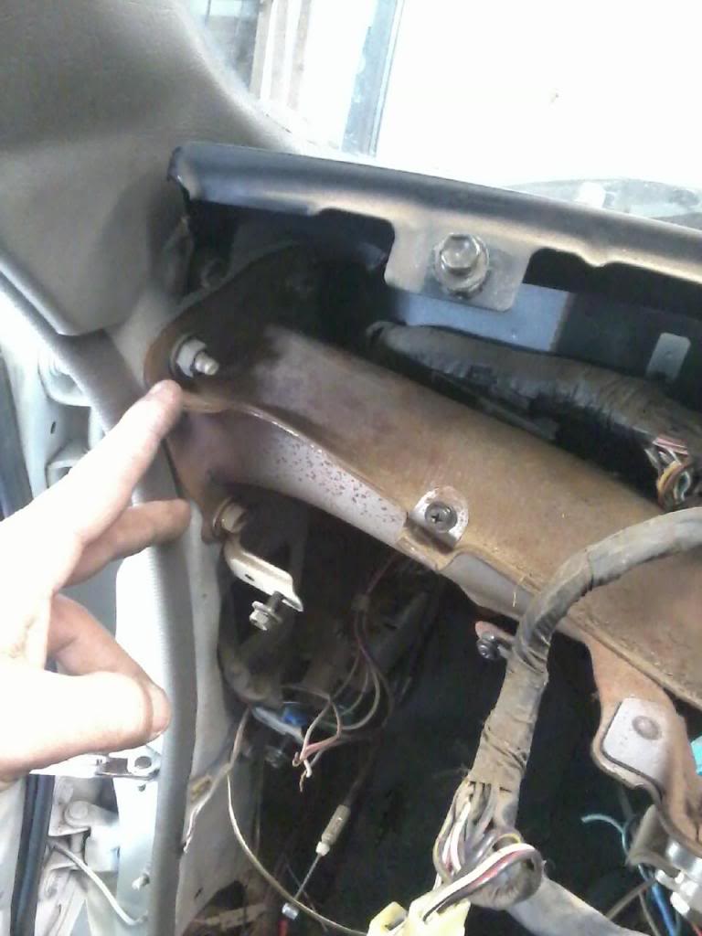

Remove the bolt with ratchet and nut that holds dash pad on. On a 84-88, I work from driver side to passenger side.

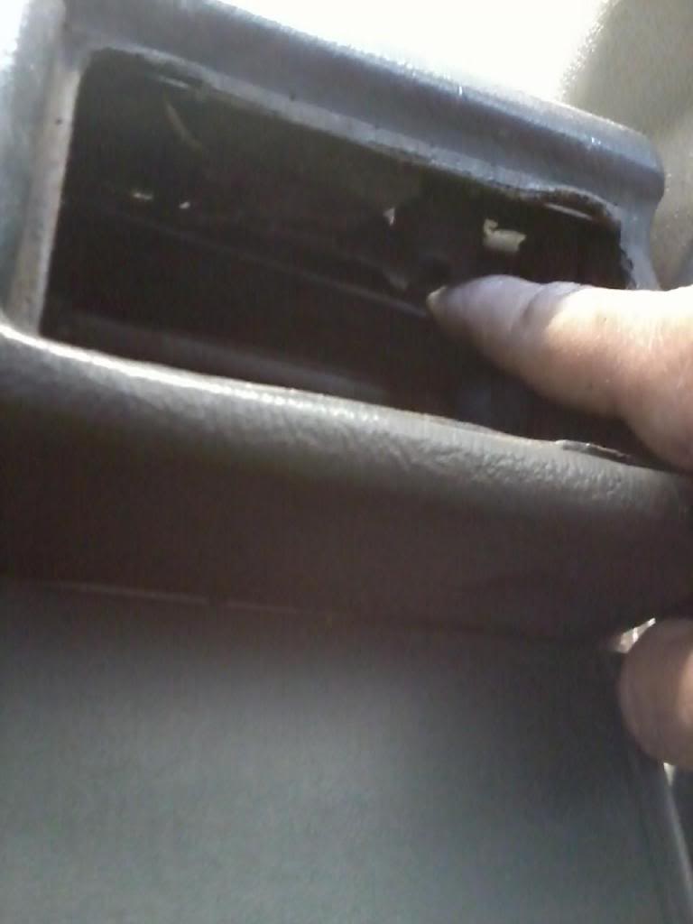

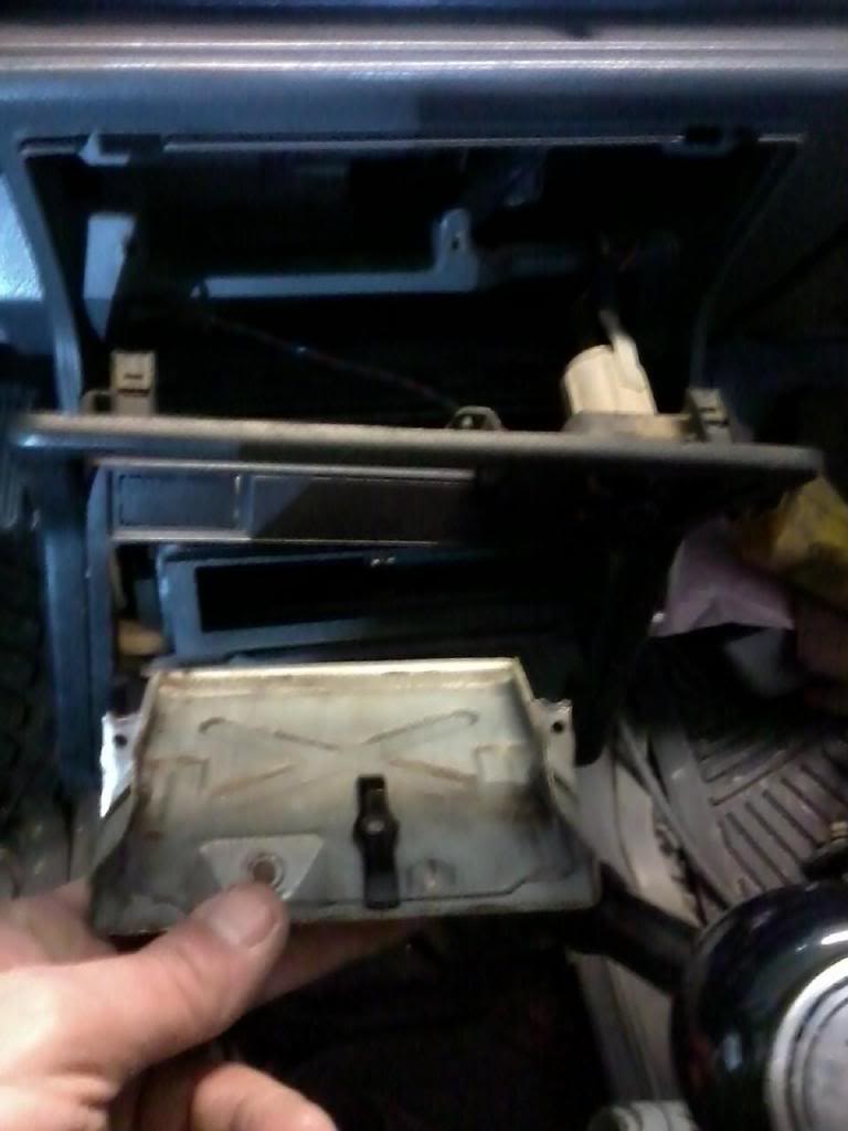

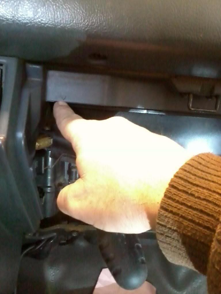

Remove these 2 screws and 3 screws that hold ash tray assembly. One of the ashtray screws is on top at an angle.
Angle in the ashtray assembly I am talking about.

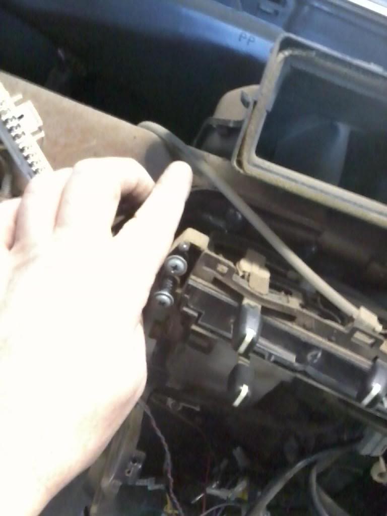

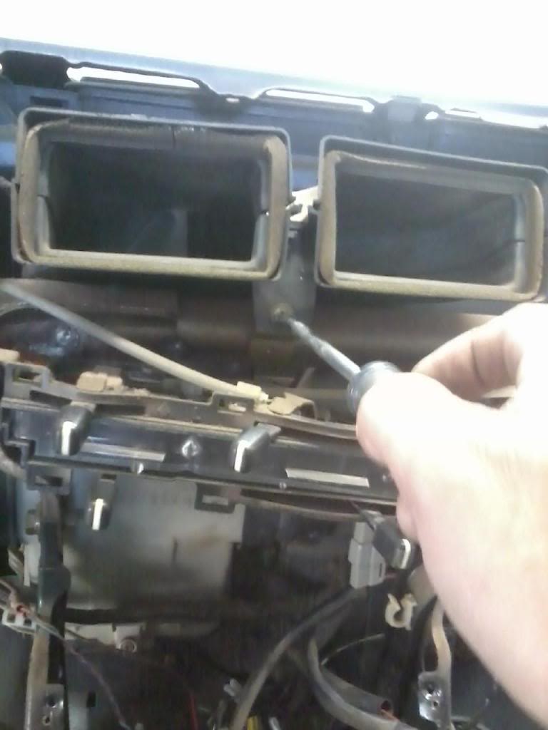

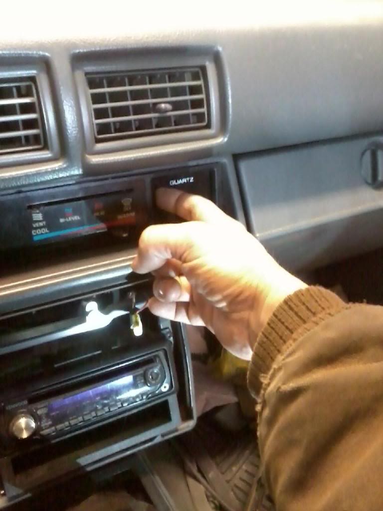

Remove heater contol knobs. Where my finger is at, pull gently and slide to the left. It should have a small bow in the middle. If you have the orange and red panel, it will be brittle and will want to crack. Be gentle on that color of panel.
Once it is to the left and the tab my finger is at is free. Slide the whole assembly to the right to remove the panel.

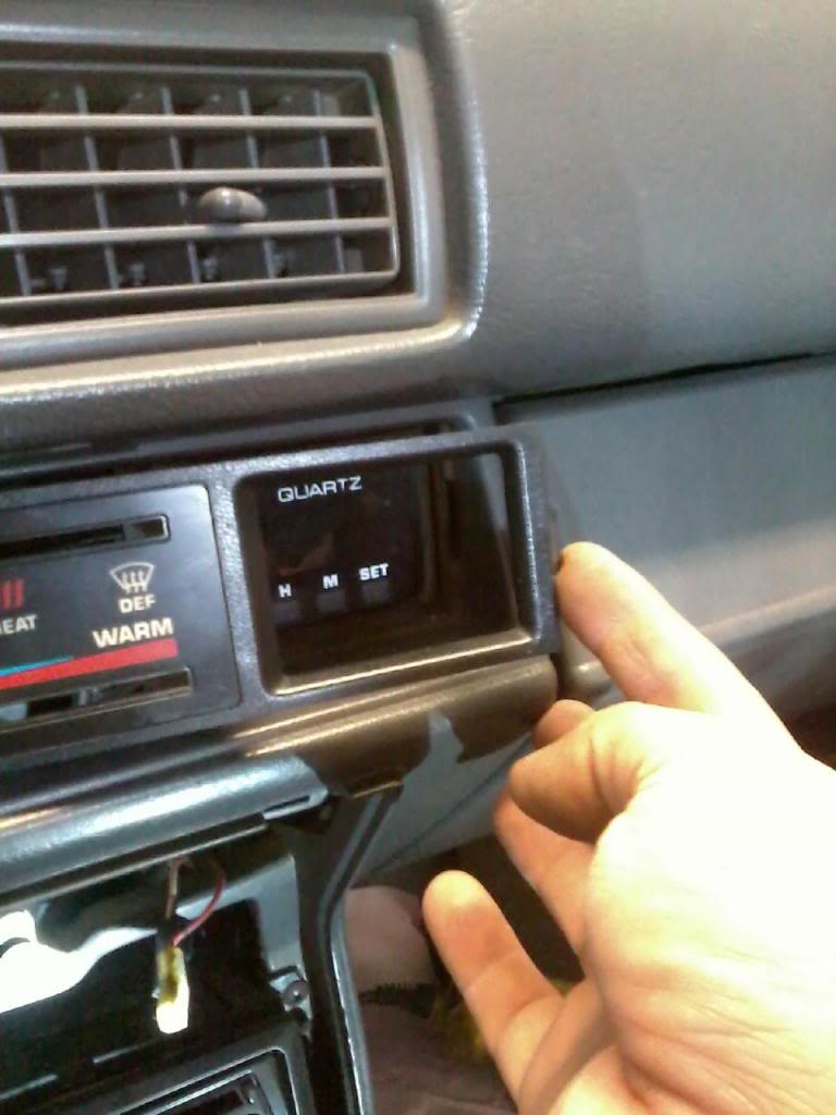

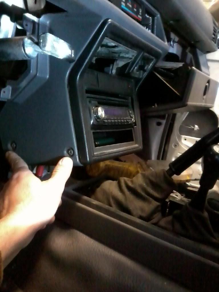

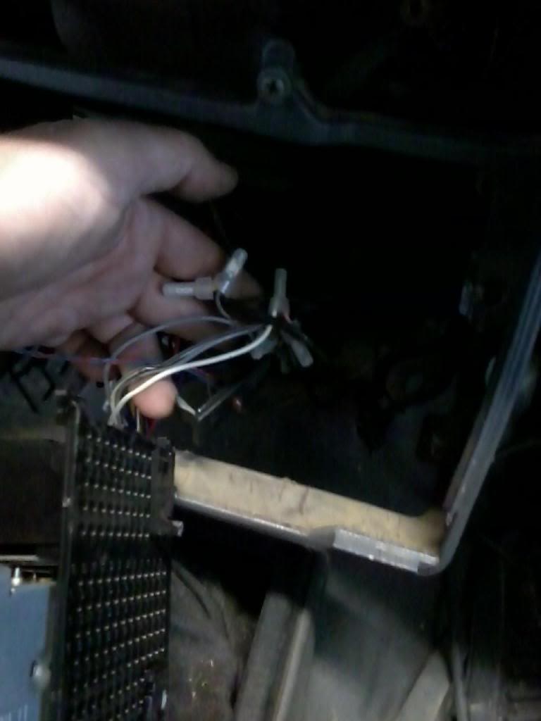

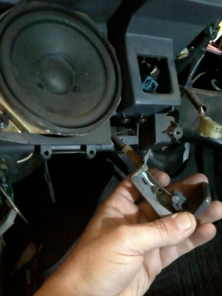

Here I removed the stereo. The PO hardwired in the stereo. Get a kit to install a stereo right. This is a common source of electrical problems on these trucks. Wal Mart sells the kit I think.

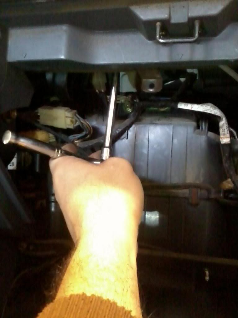

Remove glove box. 2 Screws at bottom. Once the glovebox is out. To get the cover of the glovebox, use a flatblade screw driver at these arrows and it will get the cover out. It hides the PE ppe that you will need to remove in the next few steps.

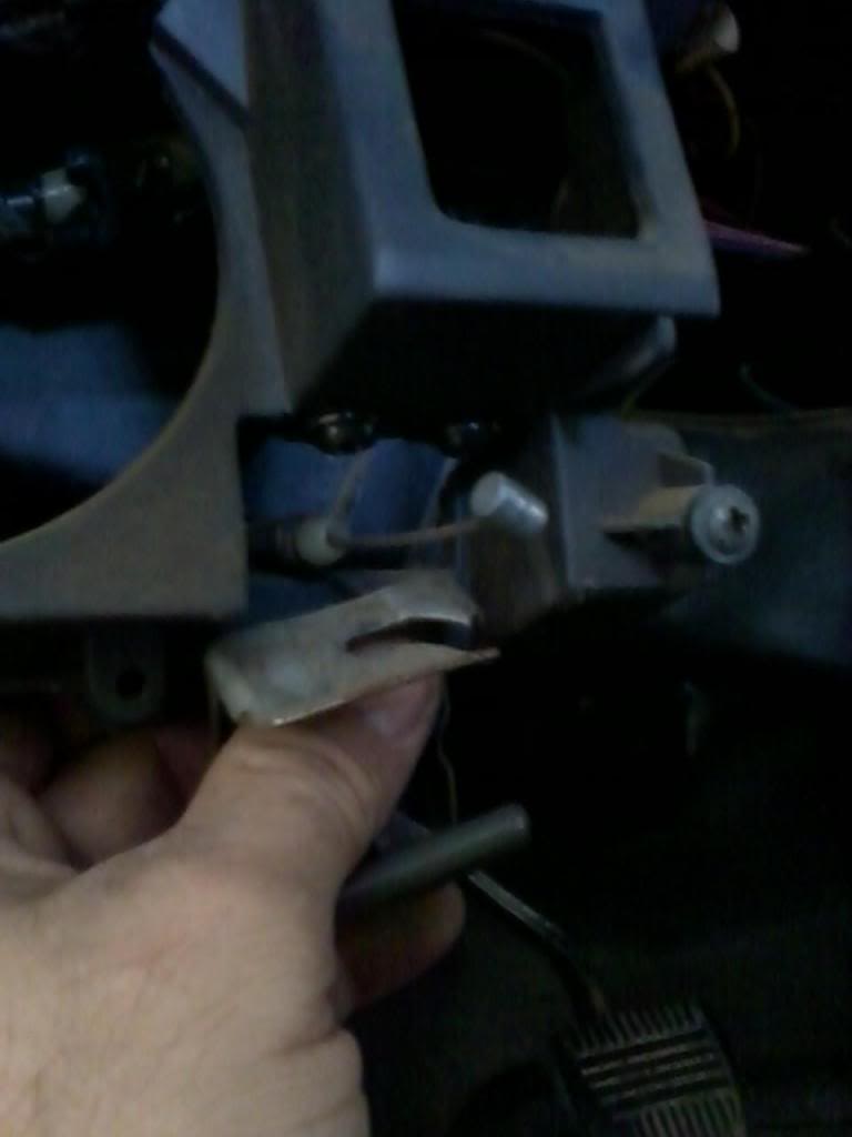

Screw taht holds the PE pipe. You need the PE pipe out of the way to access a nut that holds the center of the dashpad on.

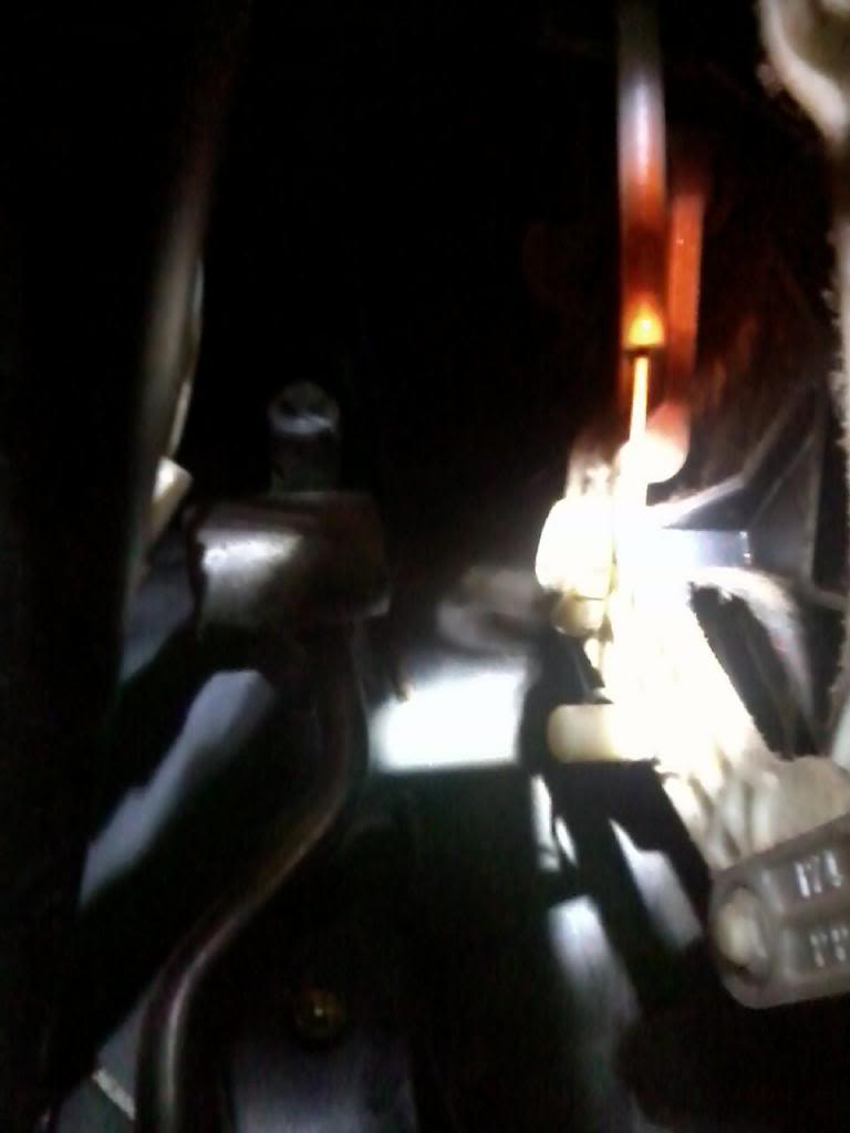

With screw out, slide the PE pipe to the right and tilt down and then slide to the left and downward to get the pipe out. The foam on these can get worn out and cause poor ventilation. I also put the screw back in its hole to help keep up with all the screws. have got most screws back in there spots along the way.

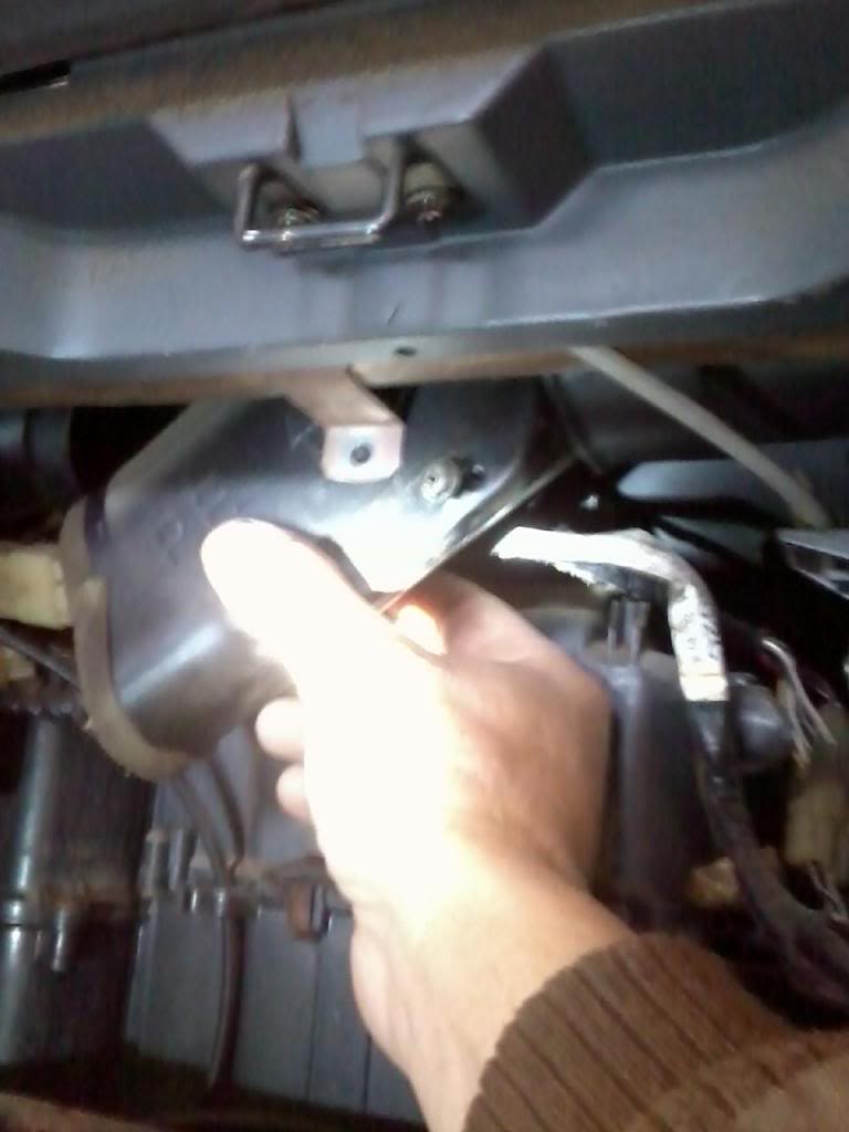

About here, using a 10mm socket and a foot long extention, to get to the nut that holds the dash pad on. It is the only nut that you can see if looking up at it. ot able to get a picture of it at this time.

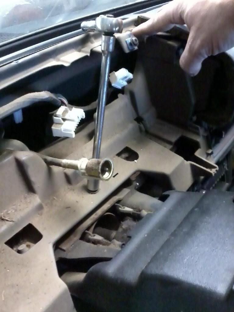

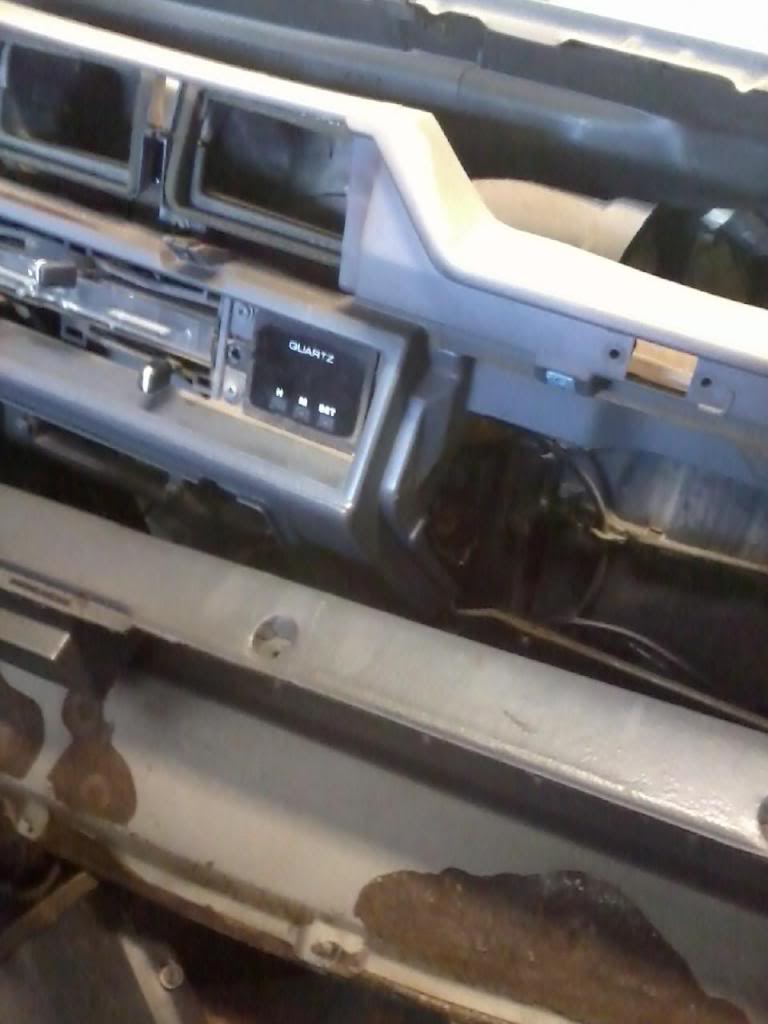

You need to remove the far passenger vent to get to the bolt that holds it in. Getting the vent out is something that I spent about 15 minutes gently working out to keep from cracking. I have a video I will add to this later and the FSM on how to get it out. These can crack easily. I have a 50/50 chance of getting one out and have done several and know how they come out. If you get one out without cracking, this is a cause for celebration.

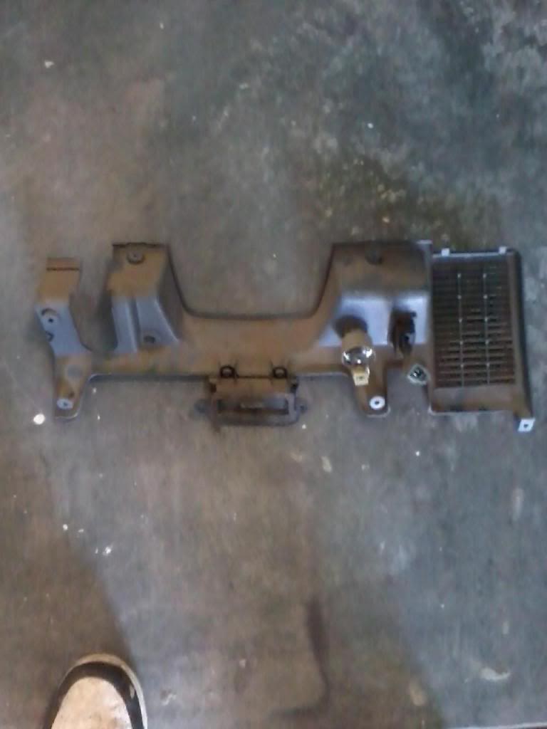

Main Supoort out.

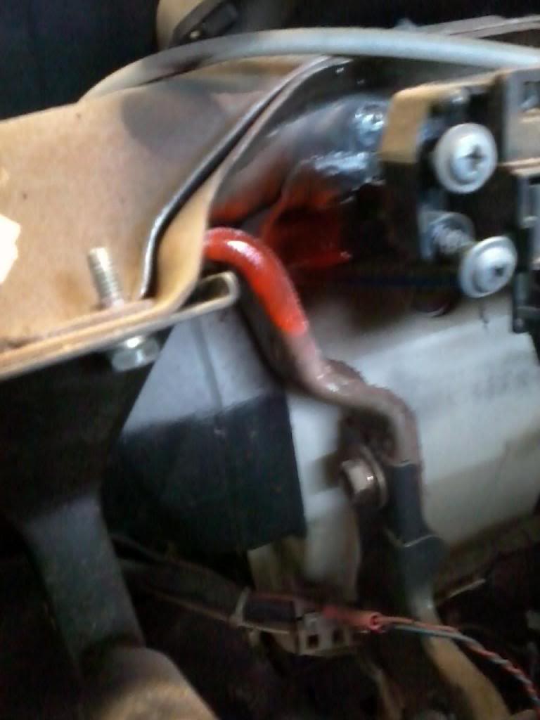

I left the Heater Control Assembly in when I took out the Main Dash. Here I spray some paint on the cables and where they route when I put it back to gether. This is top passenger side. I got black on top and orange for the bottom ones. This will help when putting Heater Controls back in and is probably the most difficult part.

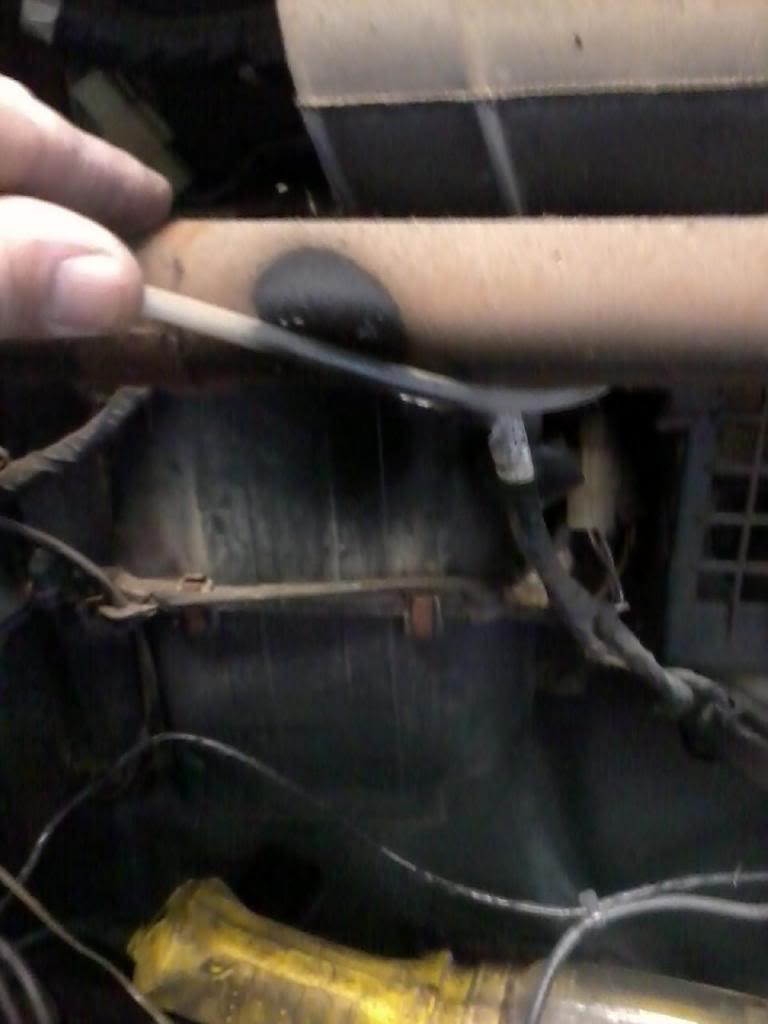

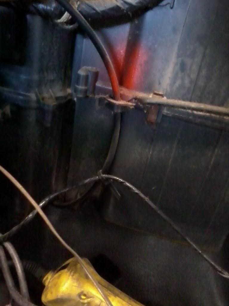

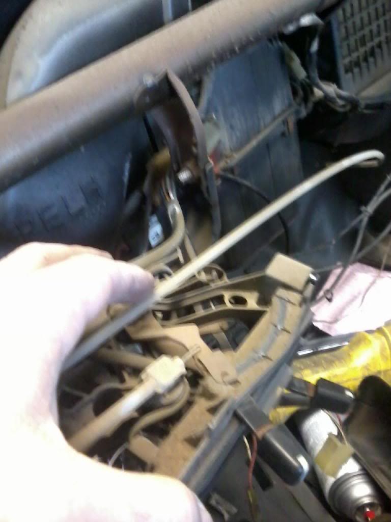

On the bottom of this cable there is a clip that holds the black cable. I shot some orange paint on it to show where it needs to sit in the clip.

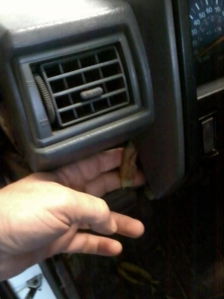

Remove the Passenger Vent and you will need to work it side to side and work it up. All of these vents are dirty and you would be suprised at the mud that comes out of these.

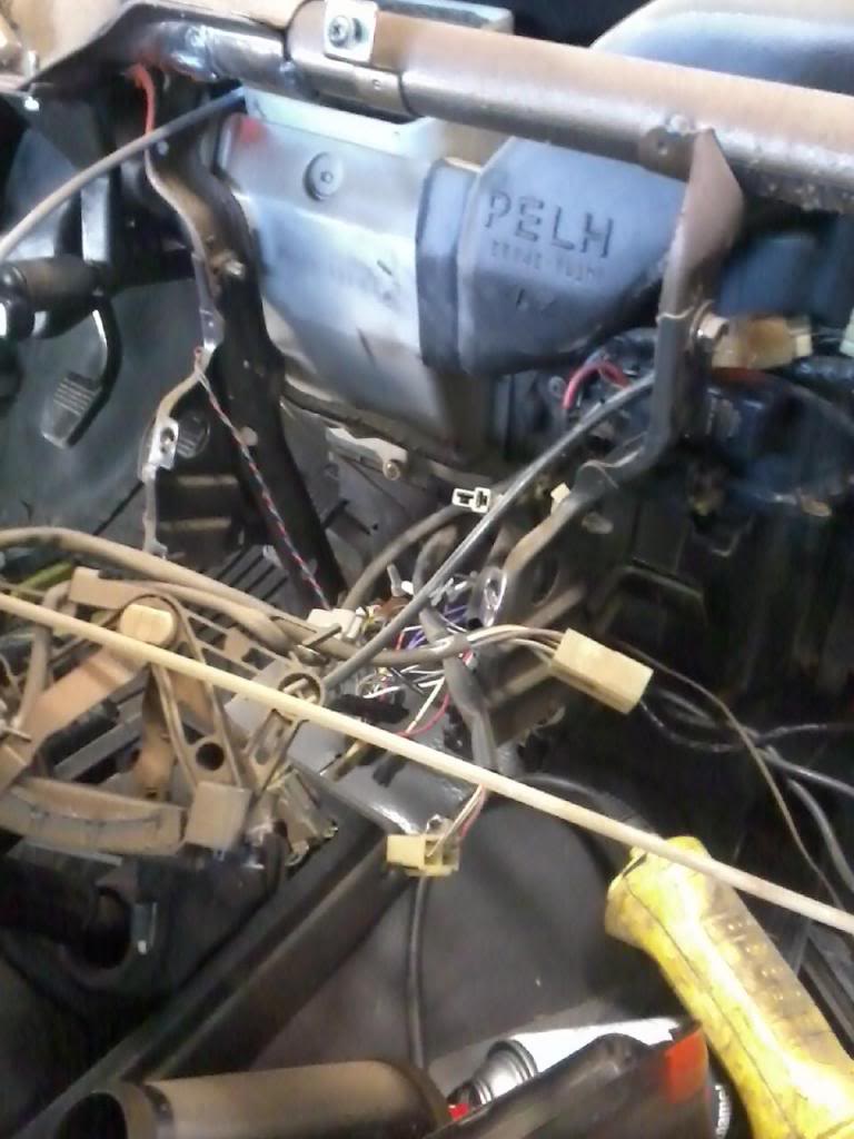

Notice that the Blue and Black cable run thru the inside of the black brackets that support the main dash frame.
The Black Cable and electrical connections run behind the bracket on the passenger side. White cable is in front.

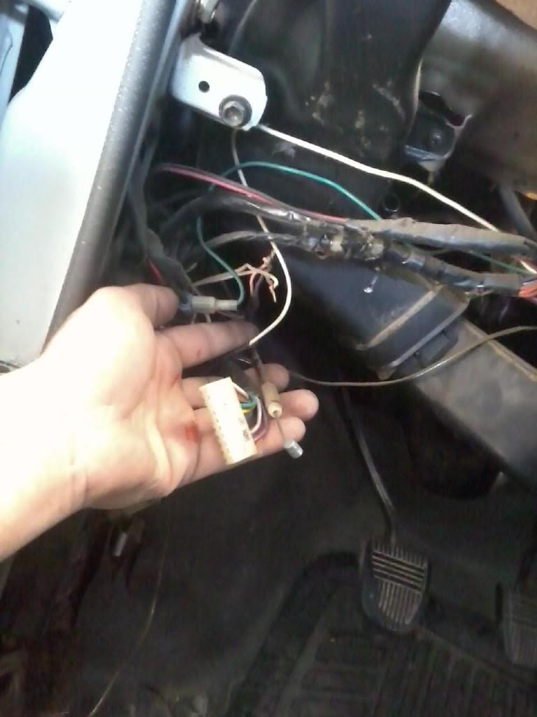

This post here will not be added to the 86 build later on. Just showing some mighty fine crap wiring. It was a Security Sytem gone wrong.

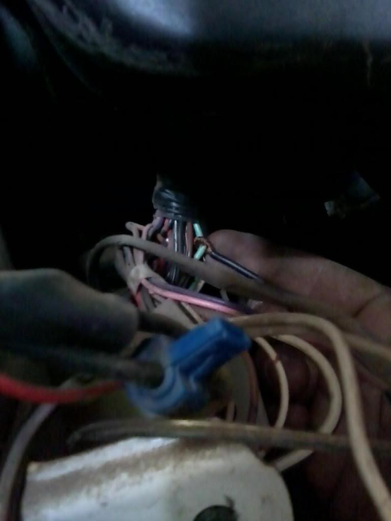

More fine crap work. Notice how they just wrapped around a bare section wire.

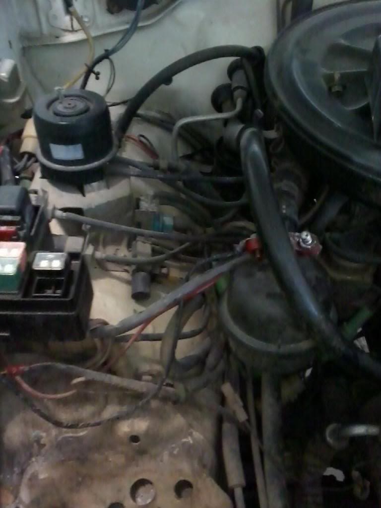

More unplugged and bare wires. I knew there was a few under the hood that went inside the cab. Didnt think it was this much. More not showing in pictures.

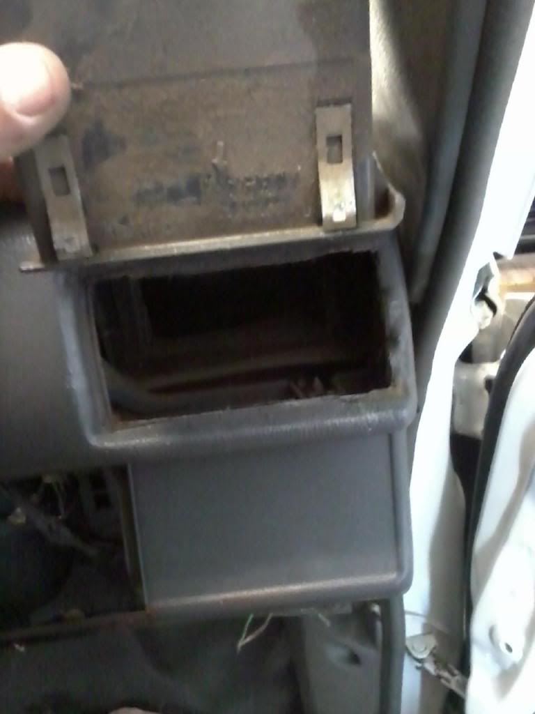

This vent pipe is the one that would be by your right knee if you were sitting in the driver seat.

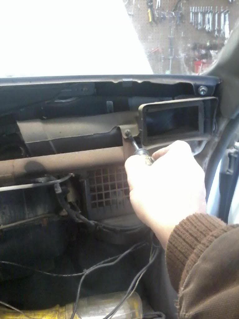

This is the big defrost vent that can be a pain to get out. You have a big screw on the bottom and 3 screws that hold it on top. When removing it, slide it to the left to clear the white vent in front of it, but watch the lever that operates the white vent assembly.

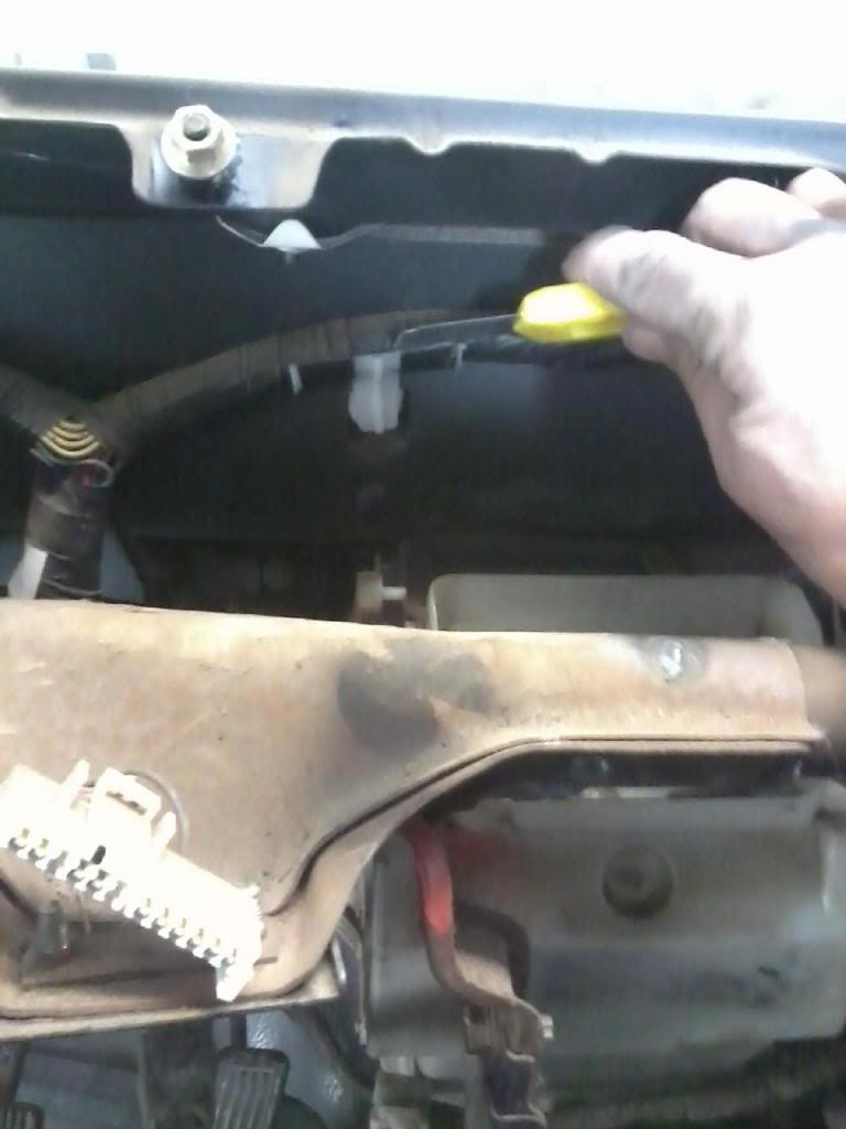

Getting the white clips out of the firewall is difficult. Usually they want to break. I just cut the tape and then I will use zip ties to install the new one. The white clips like to break is why I just cut the tape.

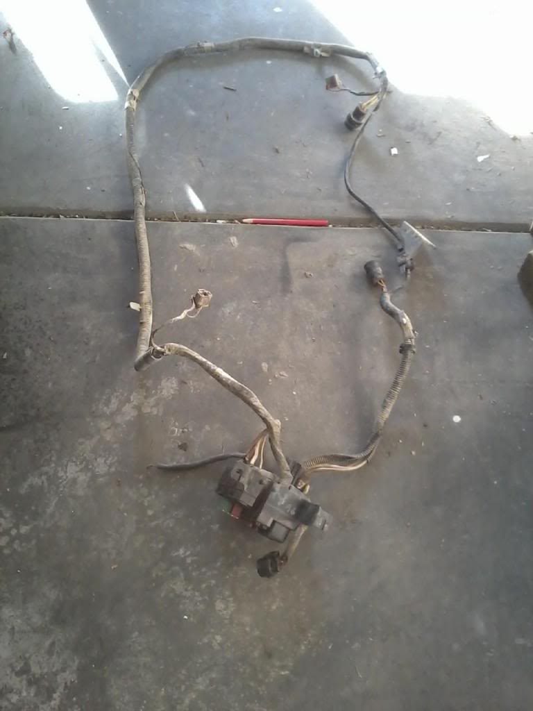

Finish disconnecting any electric plugs that may have been missed. May not show in the picture, but more poor wiring was spliced in.
You will need to remove these 4 bolts/nuts to get the harness to clear the fire wall and the cross bar. Still need to disconnect the harness from the front of the truck.

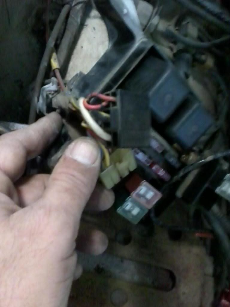

From: Anderson Missouri

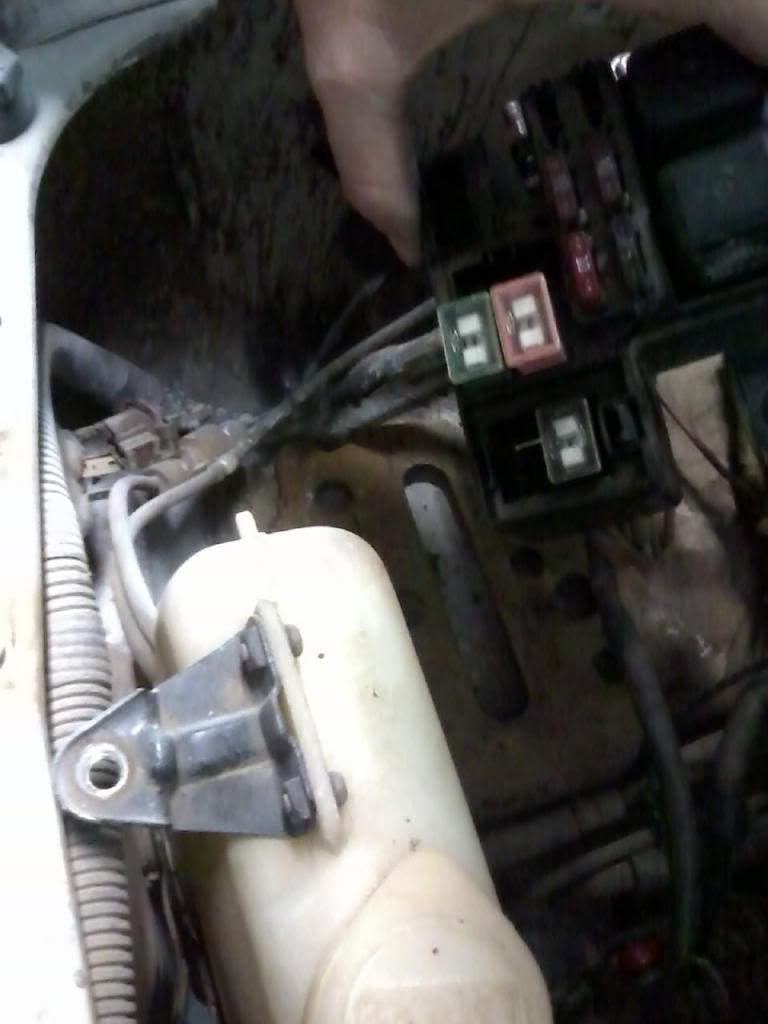

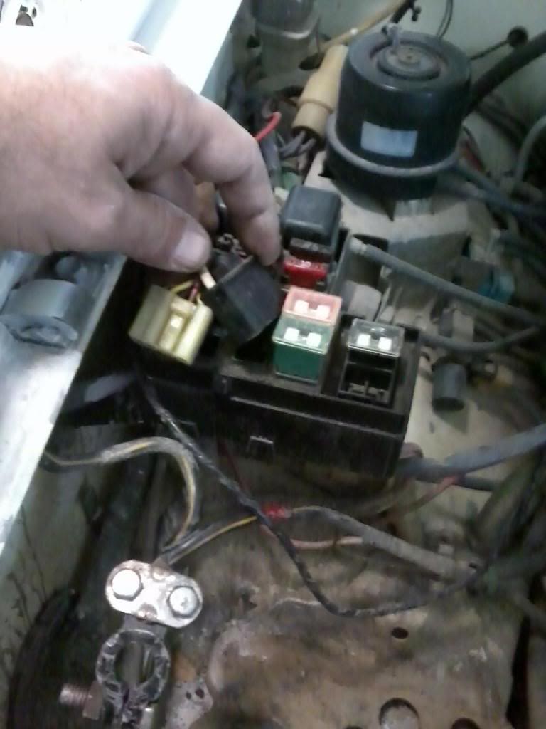

Here I am removing the fuse box under the hood. A friend of mine swapped one from 22re to 22r. When done the heater blower would not work. We eventually found that the boxes are wired different. It may look tempting to not swap the fuse boxes but it is not hard.
Remove these 2 plugs from the Fusebox. Just press tabs.

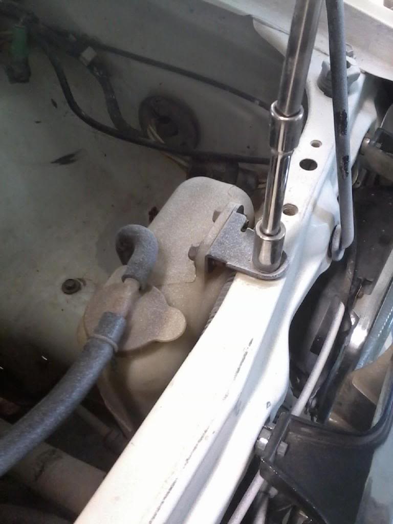

With fuse box unbolted, disconnect passenger side headlight, unbolt the windshield washer bottle. There is a squeeze tab behind the headlights that hold the harness in. I can usually squeeze with my fingers to get them to release.
Here is the squeeze tabs. I think there are 5 total. This truck has an aftermarket radiator. A factory radiator is a tighter fit and you may need to loosen the radiator to get the cable out.
Remove the Overflow Bottle as harness runs behind it. Disconnect the black plugs.
One of the black plugs I was mentioning.
You can open this box and it is just a factory connection that is connected by a nut and bolt. I just follow it all the way to the alternator and remove the entire assembly as one piece. The bblack ground wire that goes to the alternator is damaged so I just took the whole assembly as one piece.
Here is the Fuse Box Harness. Not hard to remove. May not show, but I did mark this as a 86 22r part.
