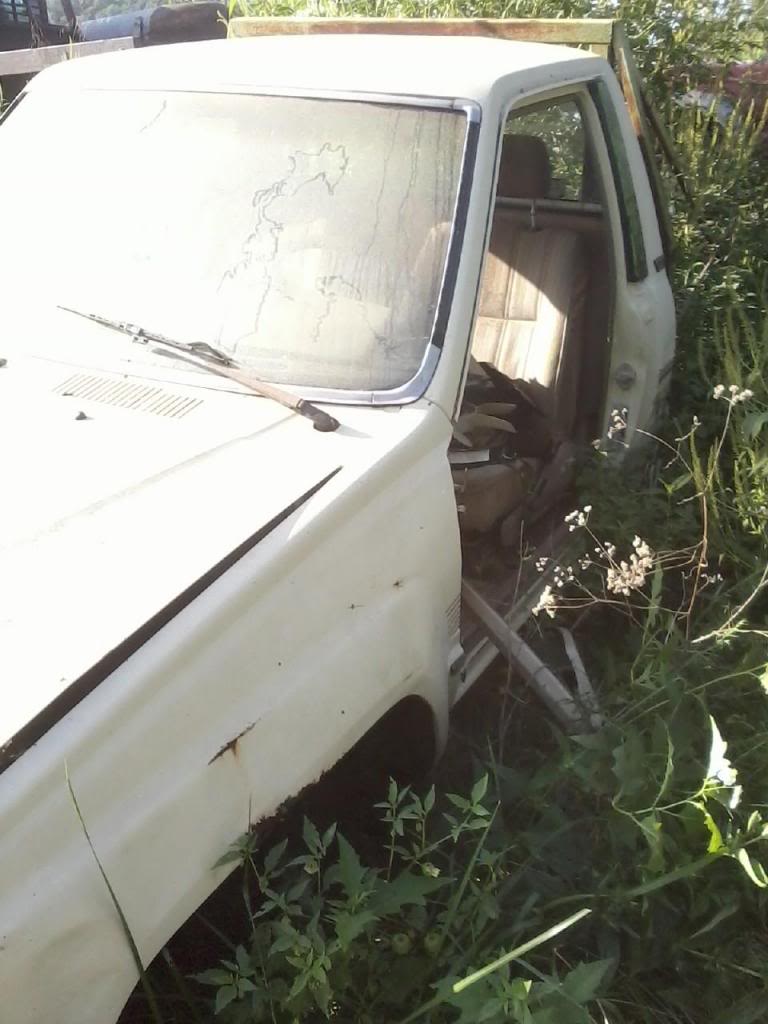

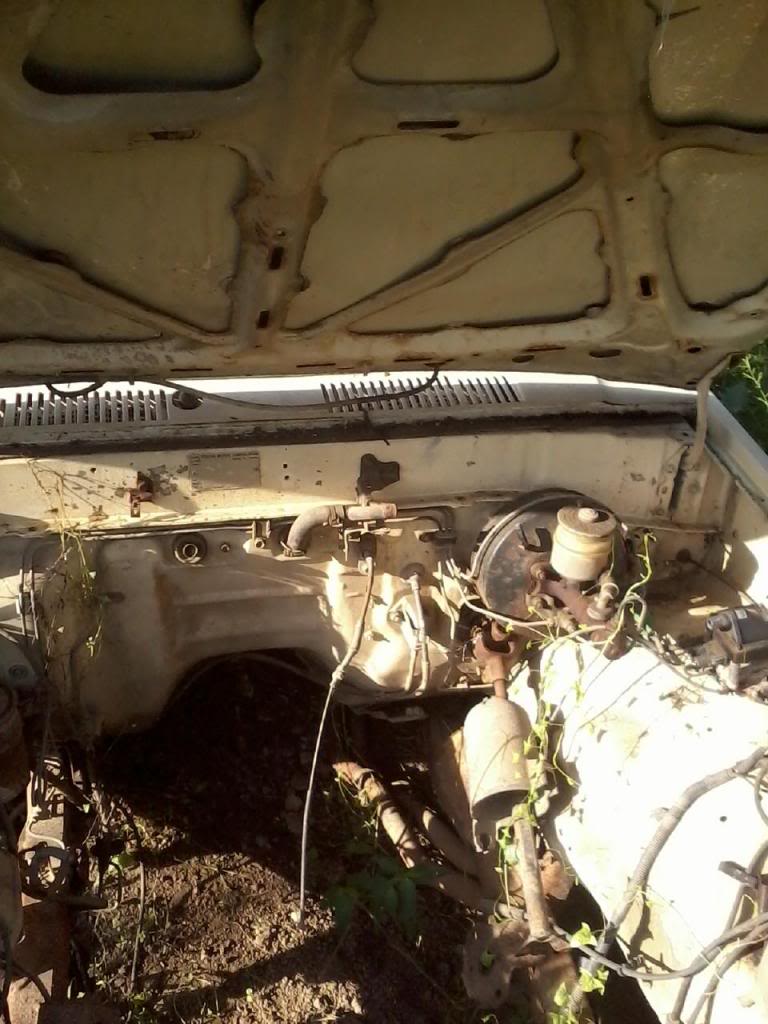

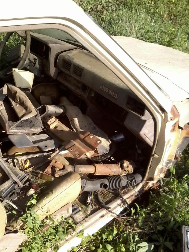

Scored a perfect dashpad. I bought it and the guy now wants the whole truck gone. It will be awhile before I get this truck. To many wasp and sure there is a snake hanging around the area. It is beyond fixing. Rusted frame and wrecked cab. A few parts I will need for my 85 on it, but I will pull all of the good parts off of it and scrap the frame and cab. About the only good parts on it is the main dash support, condenser, coil, leaf springs, wiring harness (22r, carbed) sliding backglass, A-pillar trim, windshield (going on the 85), windshield trim, front core support,booster,heater contol assembly,steering column, relays, and a few other odds and ends.
Things I am keeping is Ignition Switch, windshield, heater controls. I have plenty of these parts, so really dont need these. I dont throw any good parts away will eventually post them in the parts section. It will be awhile before I post them but if you want first dibs let me know.
Perfect dashpad and heater bezel. In storage already. Will put it in Mistys or the 85.
It is pretty well stripped.
Another view. The rear part of the frame is gone.

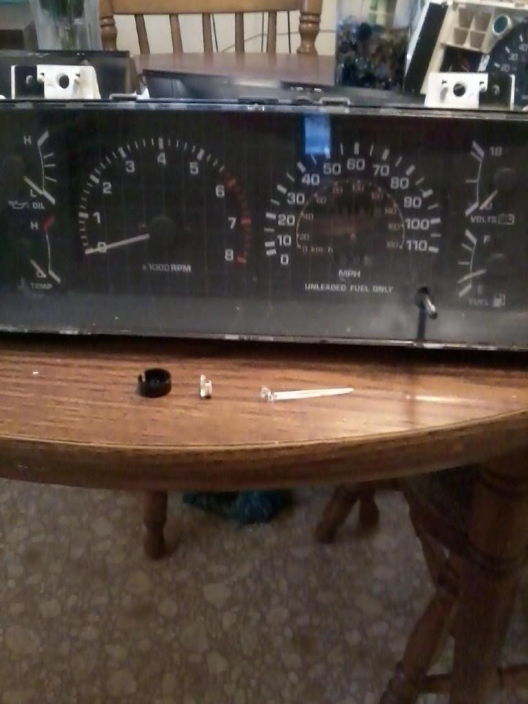

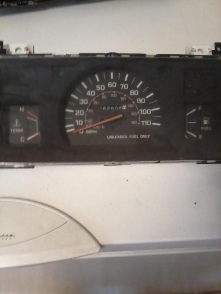

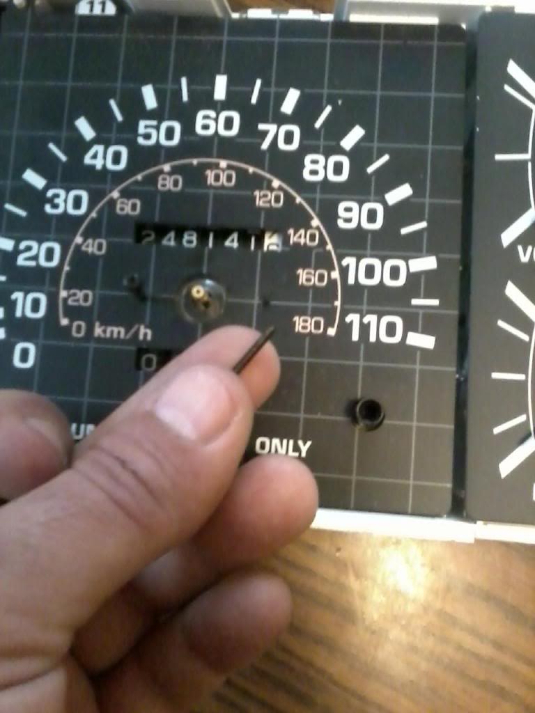

On the SR5 Guages they will interchange with the non SR5 Guages. I have had some that the tachometer will not work, but all you need to do is to run a wire from the negative side of the coil to the backside of the guage. I will have to dig that picture up somewhere later today.
I prefer to use the top guage that just has horizontal lines. The needle will come off easily as the shaft is just smooth. The bottom guage has splines on its shaft and I have broken two of the needles in the past on the bottom guage. The needles are not interchangeable from one guage to another. I already tried that. I also tried taking two non SR5 guages needles to fix it and that wont work either.
If your friend is going to upgrade, try to get the top guage. Pull the needle off and then remove the two little black screws and then I work from left to right, or the largest numbers to the smallest, by holding the numbers and twisting the numbers to the correct mileage one row at a time. It can be difficult to get each one to turn, just have to be patient and persistant.

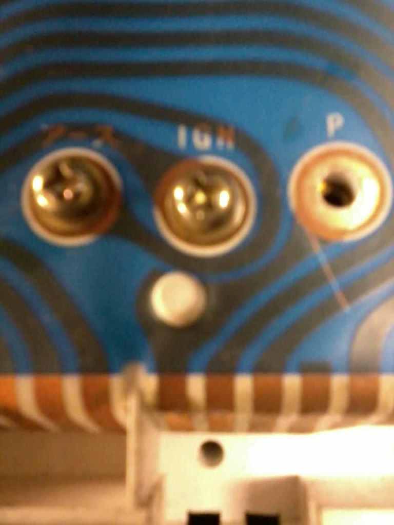

There is a difference between 4 cylinder and 6 cylinder guages. The tachometer is not set the same on them. There is a screw in the back of the tachometer on the top that needs to be adjusted if not using the correct guage. Either one can be made to work right.
This truck didnt come with the SR5 guage so I added it. If your truck is not Plug and Play like some are, you need to run a wire from the negative side of the coil to the little "p" to make the tach work.
Then what I did so as not to short out the electrical run beside it. I placed a piece of electrical tape over the little "p" and crimped a wire to the smallest connector that I could find.

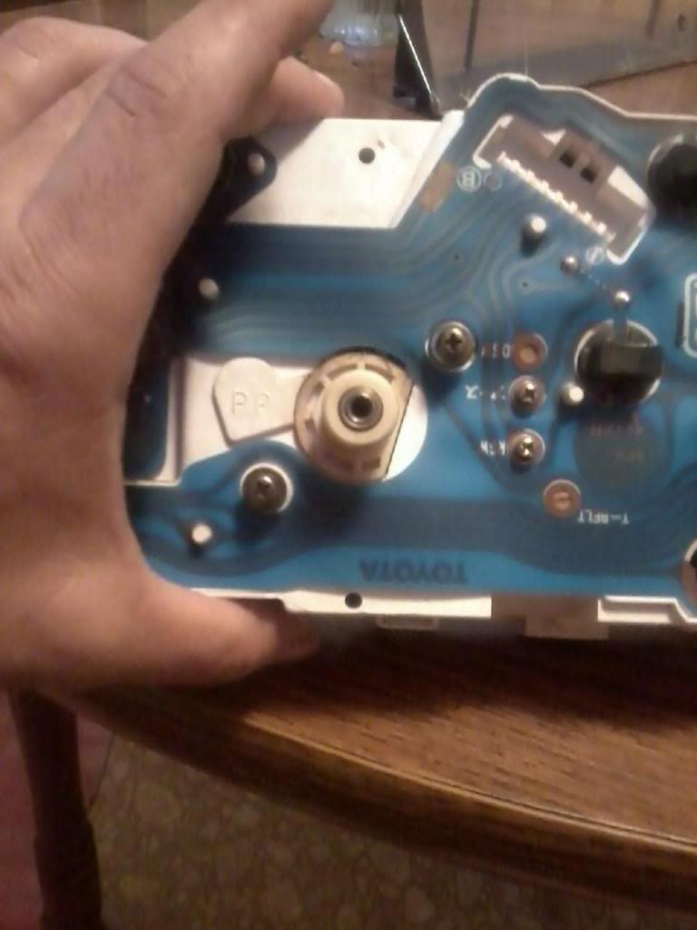

I then ran a wire to the negative side of the coil, on a carburator coil it is a little different then a standard coil you are most used to seeing. This is a temporary connection til I can come up with a better connection for it later on.

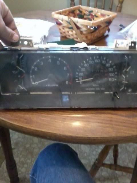

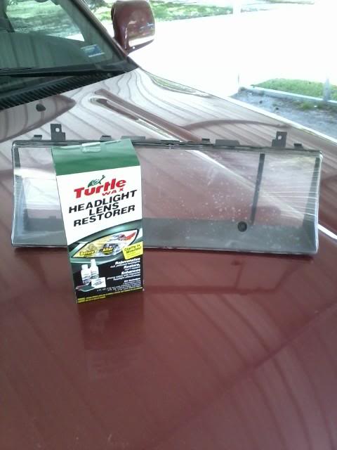

I wanted to put my SR5 Guage in and got to looking at it and wanted it cleaner. Remove the tabs that screw the cluster to the dash to get the lense off.
SR5 Guage Swap info.. https://www.yotatech.com/forums/f116...06/index2.html
I used a lense cleaner to clean it up.
I am quite happy with the results. The label says to allow up to 24 hours for the lense coating to dry. Will have to wait and see final results. Either way I am stuck with it. I have it tilted to avoid a glare while taking the picture. No matter how hard I tried, just couldnt get a good pic without the glare.
SR5 Guage Swap
Here is the Guage. I will address the cracks later.
Remove this screw and the bracket faces forward and same for other side.

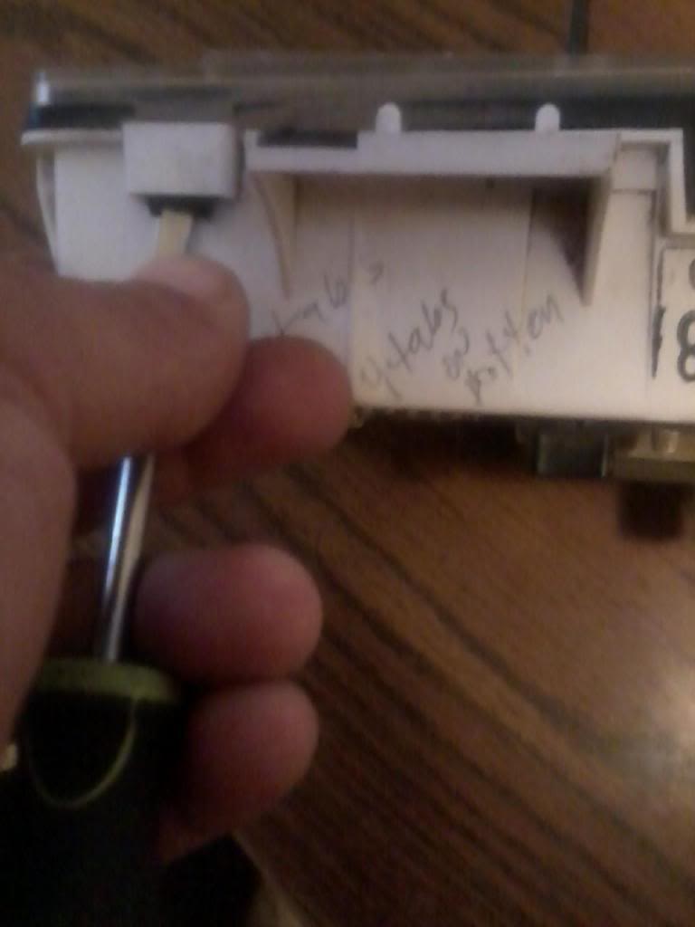

You have 4 tabs on top and 4 on bottom. I find it easier to start on one end and get the first one loose and then pry it slightly with a flat blade and then do the next tab. Same for the bottom.

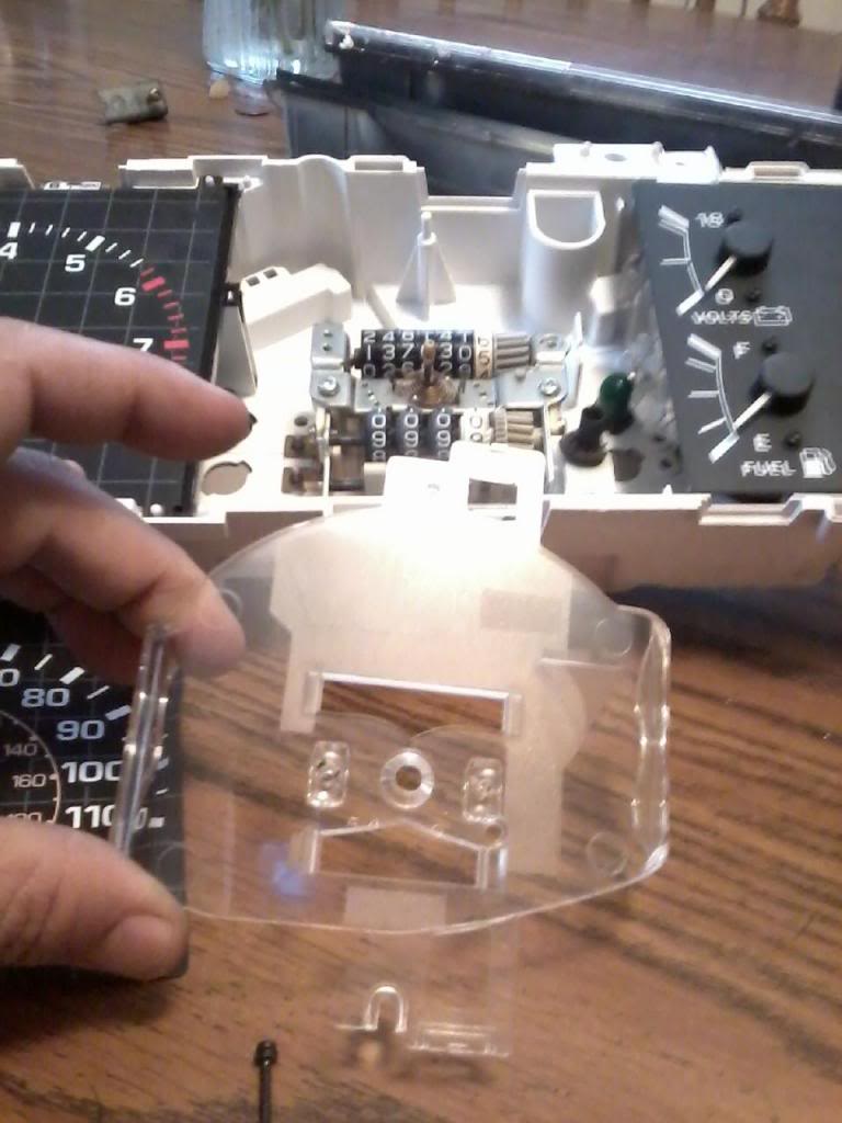

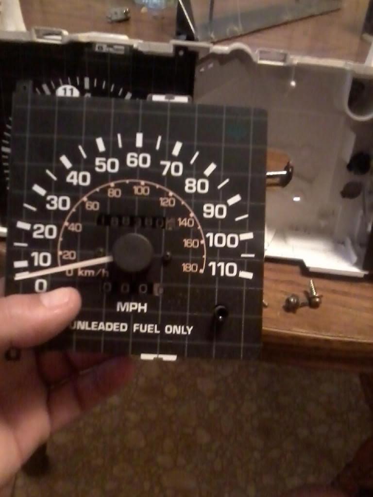

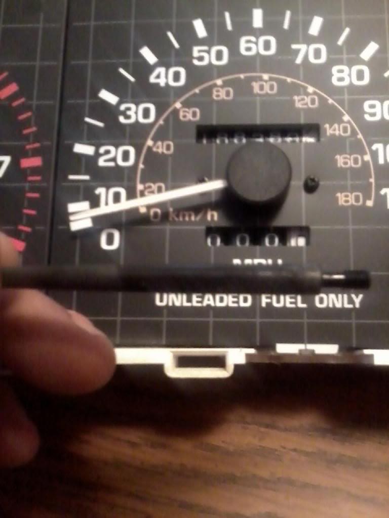

These 4 screws hold the Speedometer in the cluster. Will need to remove cluster to correct the mileage.

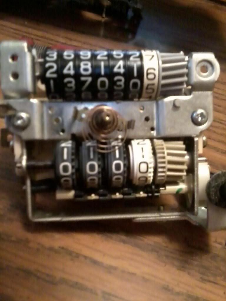

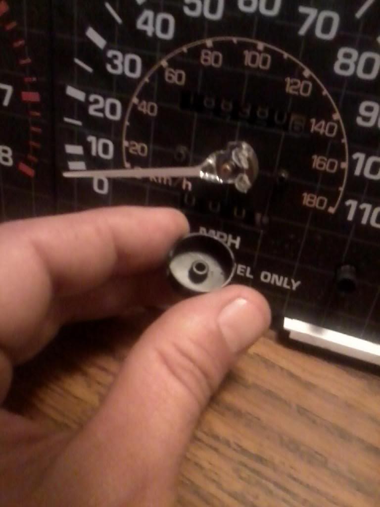

Here is whole assembly out. Also the Tripometer needle is taken out by spinning the whole handle to the left.
On this style of needle the round cover over the needle can and will pop off. It is just pushed back on.
Here is cover I am talking about.
I loosen the two screws showing just a little to make it easier to correct the mileage. Start at the far right or the lowest number and work your way to the highest number and then retighten the screws.
Reinstall the plastic cover.
Then the faceplate and the two screws holding it.

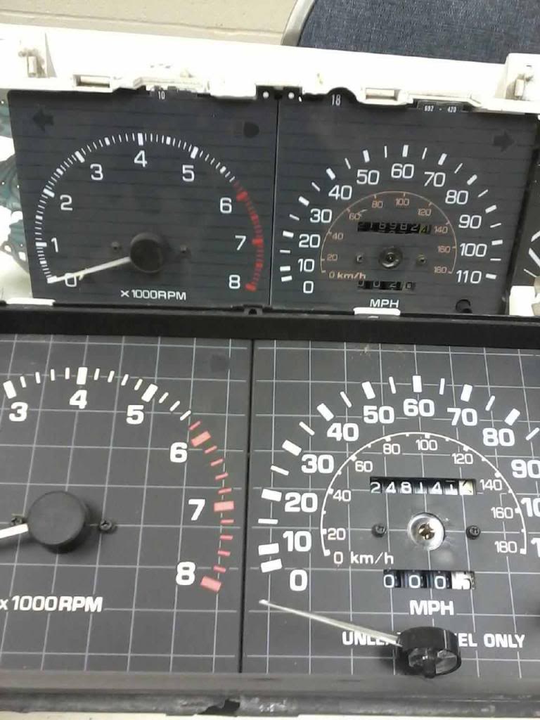

FIXING CRACKED FACEPLATE

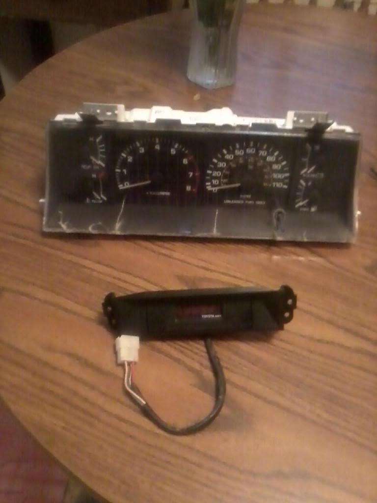

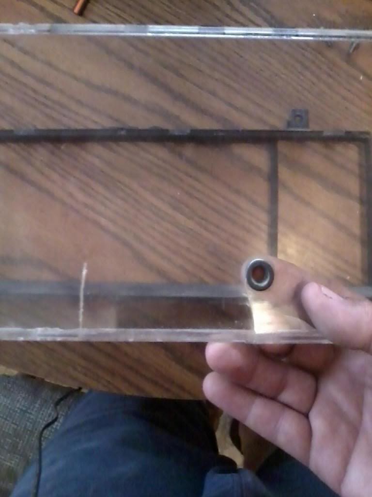

I got Toms SR5 guage from him yesterday and wanted to get the mileage corrected and the face plate is cracked. Figured it would be something that I could do inside the house. Besides the wife doesnt mind and care when she is at work and doesnt know I am doing it inside the house
Here is his SR5 Guage. Has three cracks in it. The clock below is one I got from him as well and will see if I can install it at a later time. I have seen a clock in a truck before and always thought that someone took it from another Toyota model and put it in. But Tom had this in a parts truck and now I am wondering if it wasnt an option. I seen the same clock as well. I figured that since the clock option was always by the heater control, Toyota wouldnt offer it elsewhere.
Cracked faceplate.
Standard guage.

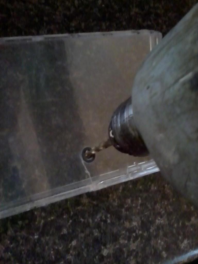

The SR5 Guage just has two lines that run on the ends of it. I gently took a flat blade screwdriver and seperated the plastic from the black part on both covers. The SR5 plastic has a little rubber grommet and the hole for the tripometer is quite large. I just put the two covers on top each other and used the grommet as a guide and drilled the hole.
The two covers are stacked on top of each other with the SR5 on top. Doesnt look like it but it is there. I then drilled the hole and when I got the hole I did several test fits and seeing which way I needed to enlarge the hole for the tripometer handle to reconnect and have plenty of room to operate.
Here it is with the Standard Cover on a SR5 Gauge. I just used Super Glue to reseat the cover on. I also got the mileage corrected while working on the guage assembly. One set back is while trying to get the needle off, it broke. It was being stubborn. I worked it gently for 30 minutes and it still wouldnt come until SNAP. I am not worried. I do have another guage, but Jason is sending me one that is bad but the speedometer is good. One small setback.
