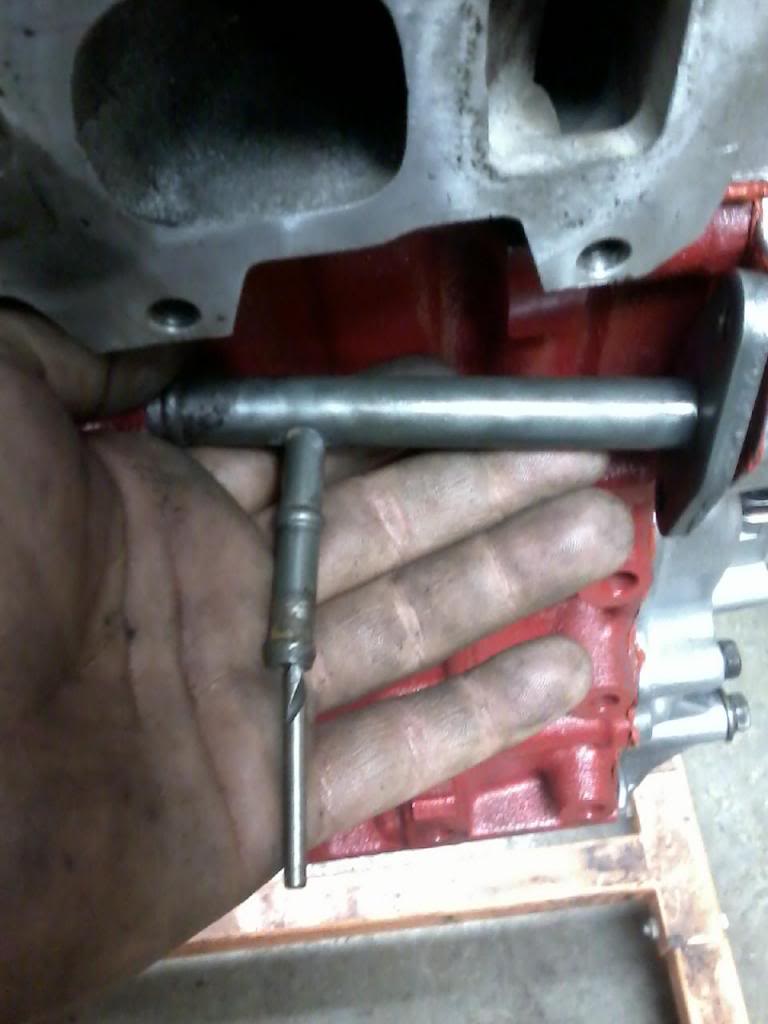

Mostly putting this up for Mark and will add it to his thread. I was reading where a guy was having the idle problem and he said his Throttle Body was a clogged water port. I am not sure if it was where I found this clog but I was sruprised to see it clogged here. This is on the motor I am building for the 85, I havent had one to be clogged here before, but will say I havent every stuck a rod down to see. You probably wouldnt be able to see it anyways.
Clogged water pipe. I used a drill bit to clean it out.

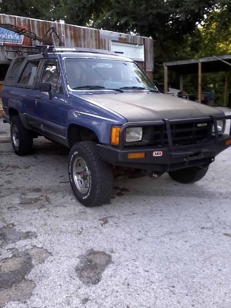

Here is the one that is for sale in town and made me realize that the light is at the end of the tunnel. Mine still isnt as nice as Mistys but it is catching up quickly. She has started noticing and is wanting to add a few things to hers to stay ahead of me. hehe

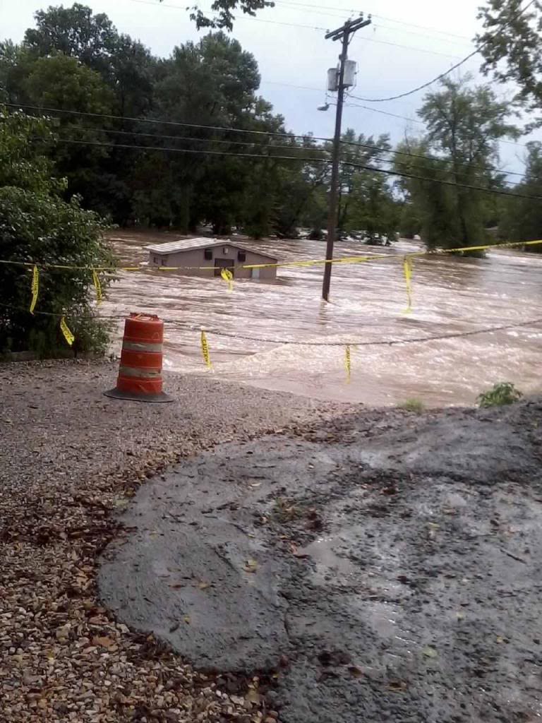

We have been getting hammered with rain. Yesterday a neighbor of my parents and also the parent of a girl I went to school with got caught in a flashflood and passsed away. It was mentioned on CBS evening news of the 2 fatalities that it has caused and she was one of them. Suprising at how close to home it happened. The rivers have exceeded their limits several times over. We went and looked at some of the rivers and watched whole trees just flying on down the river.
This building sets aways from the river and the water was up higher on the windows.

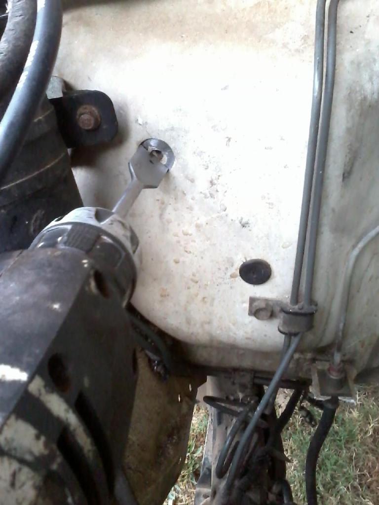

The AC install has gone great. My truck didnt have AC as it didnt even have the holes cut out for the lines. Toyota did have the dimples as to where to cut in the fire wall. That helped alot. Almost looks like a professional did it. Almost!!!
Carpenters are going to scream with me using this tool to cut the holes. But it worked.

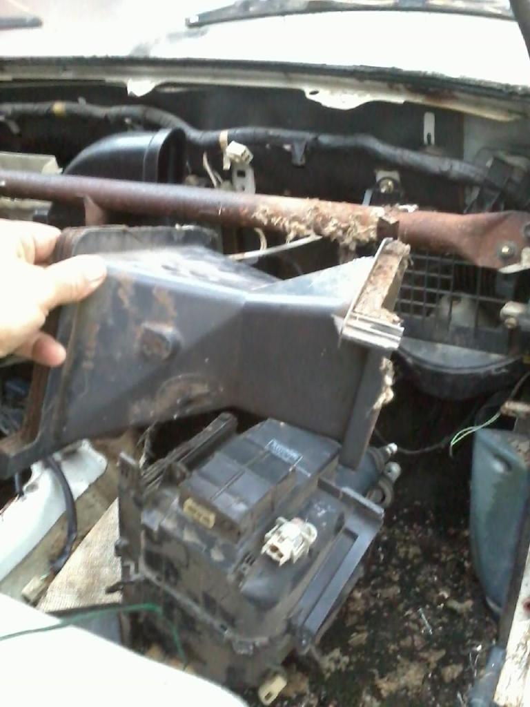

Evaporator you will need. Where my finger is pointing is what Mark is talking about on his thread that needs adjusting.
The top piece is basically a pipe that connects the blower to the heater core if you dont have AC. Otherwise the Evaporator sits in its place.

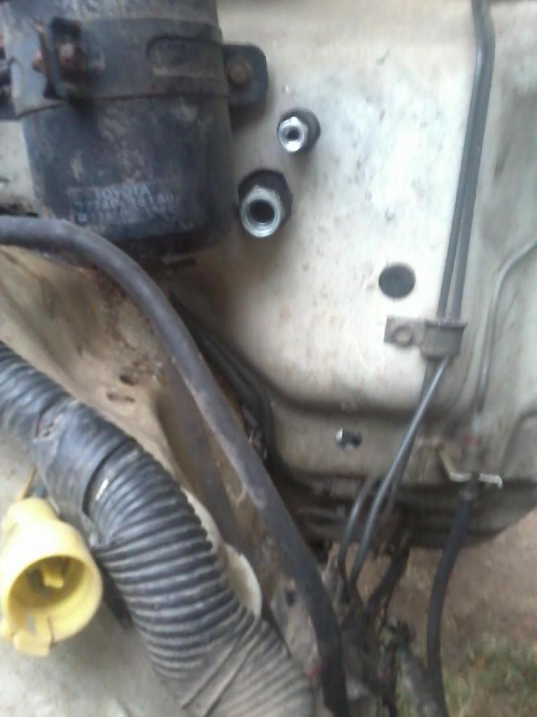

Wiring harness needed to connect to the trucks main harnes. Appears all connections are already installed.
Will get some rubber grommets to seal up the excess hole and for protection of the evaps metal pipes.

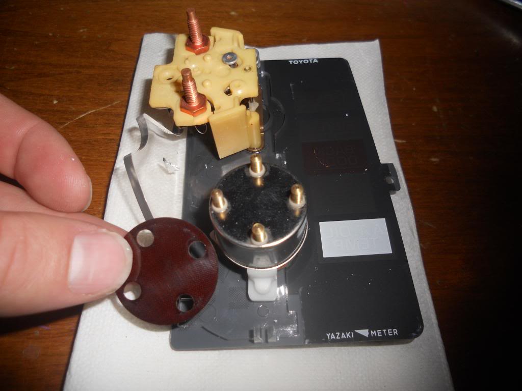

My brothers trucks Temp Guage is the worse I have ever seen. I did get it fixed and working great. Using Infernos thread, neither of the two guages I worked on had the little disc that Inferno is holding on to. I just put a layer of electrical tape on the silver canister and it works like a champ now. Not sure if this is what fixed it, but it working great.
I have gotten 2 guages to work. Both of the ones I fixed did not have the insulating piece that Inferno is showing. It may not be on all guages, and I am sure both of mine had never been taken apart.
What I did and am not for sure if this fixed the problem, is I used electrical tape to isolated the two pieces, but this thread did get mine fixed. Also I did have the 3 long post loose. I have added electrial tape on both and they are working great. Great thread Inferno!!!

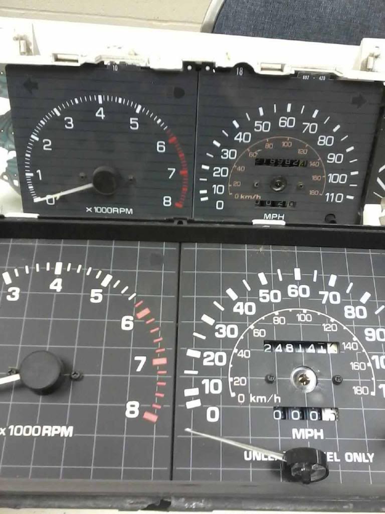

Got Jasons old guage set. I was hoping to use the needles off of his to fix the one that I had broke the needle off of. The needles look the same but are different on that the way they mount to the speedo shaft.
The top one would be my prefered SR5 Guage if I have a choice. There are more differences then just appearances. The backsides of the Tach are different, the way they mount inside the housing, and the way the speedo needles mounts to the shaft.
The top one, the shaft is pointy and is easily removable to set the mileage correct.
The bottom one, the shaft has splines and is easily breakable. I got the mileageage corrected for the 86 Extra cab fixed now. It is all back together and cleaned up now. The guages that just have horizontal lines is the one I prefer. Mostly just as it is easier to correct the mileage.

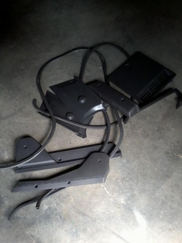

The 85 is getting a temporary eviction. If all goes well, I will be painting the 86 extra cab on Wednesday or Thursday. Been having to wait on the weather. I will spend a day or so getting the shop cleaned out for painting. Would be so much nicer if I just had my million dollar paint booth, but until then, I have to pull everything out but it does get things organized again, but only for a short while.
I think I have all of the pieces to the passenger area done now and just need to get the pieces in on to have the runner finished up. I still need to work on the shifter areabut still dont know which way I want to go on it just yet. Dont lack to much to have the trunk area finished. It is the next area I am going to start focusing on.
