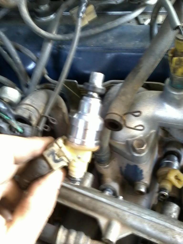

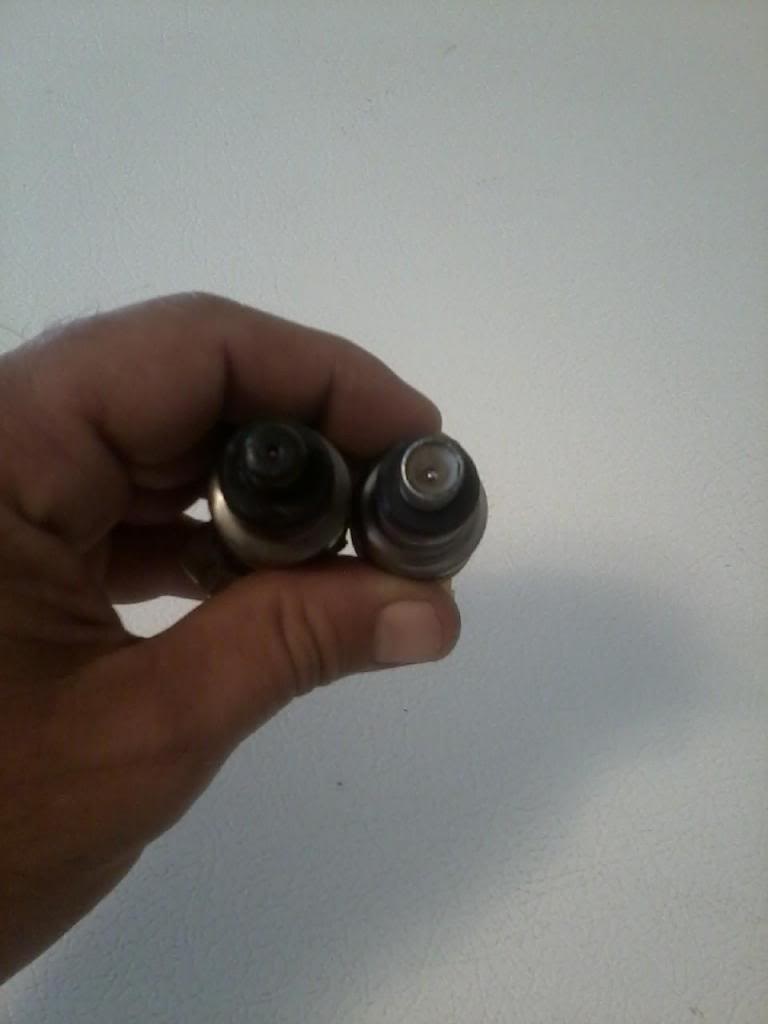

Flamethrower was offering some injectors for testing purposes and reviews. I was fortuante enough to get chose to recieve a set of his injectors. I recieved them today. I plan on putting them in on Wednesday or Thursday.
Our factory injectors are 20 plus years behind in technology and I was curious as to what his would be like and sure there is room for improvement on the factory injectors. When comparing an orginal injector to the factory one, I can see where his could be a huge improvement. As you are looking down inside the the injector, where the fuel sprays out, it is like a funnel or an inverted cone. Sometimes something like this could make a world of difference for several areas of performance.
This is one of those things I am just itching to see what kind of difference I am going to see and makes you think " Why didnt I think of that?" I am sure there are some other things that may not be seen. There is always room for improvement and I am looking forward to the results of these. I am glad someone has taken the time to see where something can be improved up on and still supporting our hobby.
The one on the left is the Toyota Factory one. The one on the right is Flamethrowers Injector. I could see how this can be a big improvement.

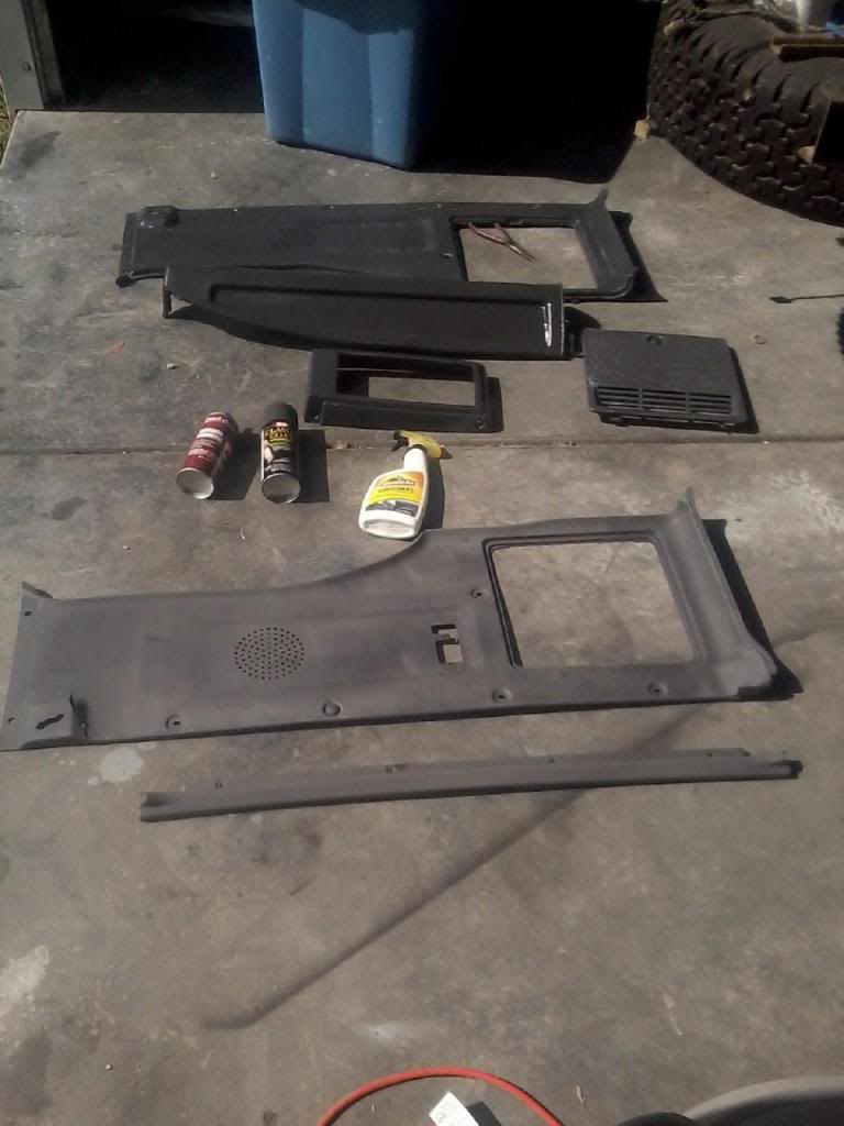

I let my paint guy talk me into using an off the shelf interior paint. I have a lot of time cleaning these pieces and then I painted them. When it went on wet it looked great. After it dried, it looked powdery. I have the top ones covered in Amorall and when they dried, they have the look I am going for. I am going to see how this turns out or may have to start over.
Bottom are freshly painted..grr Top is freshly painted and soaking in Amorall. My new to me dashpad is turning out to the way I want it to, now if it will just hold it color and shine.

Hello Cyberhorn...That is what I am afraid of. I am just hoping against hope that I dont have to clean them back up. We are getting rain all this week and I dont want to have to put the top on as it is easier to do the interior, so I have a few days to experiment.
This week is just going down the drain. I was planning on painting the 86 Extra cab this week as well, but not with the humidity that we are having. I had such high hopes for this week and it started out great but is now a big slow down. Just a bump in the road.

Hello guys... I can say I am very pleased with the Flamethrower injectors. When I pulled the old ones out, I did lose some fuel out of the fuel rail and it took a few seconds for it to start and to get fuel into the rail and injectors. Then it got fuel, sputtered for a minute and started running smoother then before. I was happy with how smooth it ran before but now I am still amazed at how it just sits and idles.
After letting it run and checking for leaks and I then started seeing at how quick it would rev up. It seems quite a bit more responsive to the quick reving. Then it was time to take it on the road. I left the driveway and the area in a reasonable manner. Got to the highway and gave it a little more gas then normal. It did start spinning the one tire. I wasnt trying to do that actually as I am in no hurry for buying new tires.
Took it on the interstate and there I did run it hard. The first 3 gears I have always been able to go thru fairly quick. This did improve quite a bit. 4th and 5th I didnt notice as much of an improvement other then the engine does run smoother and seems like on some hills, it did help out a little.
I then got on the side roads and could not keep my foot out of it again. It has alot more torque on the bottom end. I did chirp the tires a couple of more times and again wasnt trying to,chirp them, and I could of spun them if I had wanted too.
I did try for a 2nd gear spin and did get a squeak. It would break the tire loose if I really stomped it hard. I just wanted to play with the new horse power for a little bit more. I did drop the fuel guage down with my heavy foot. I am curious now as to what my mileage will be like when I start driving like I normally would and not as abusive as I did today.
I will be posting a review later today for Flamethrower. I want to eventually get some of his injectors for my other two trucks. I am very happy with them. Overall in my experience a big improvement for the lower RPMs and some on the higher RPMs.
I would recommend for someone that may be new to Toyotas to label the injector connectors. #3 and #4 might could possibly get swapped.
