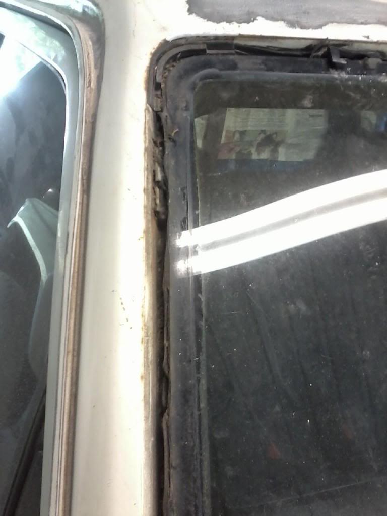

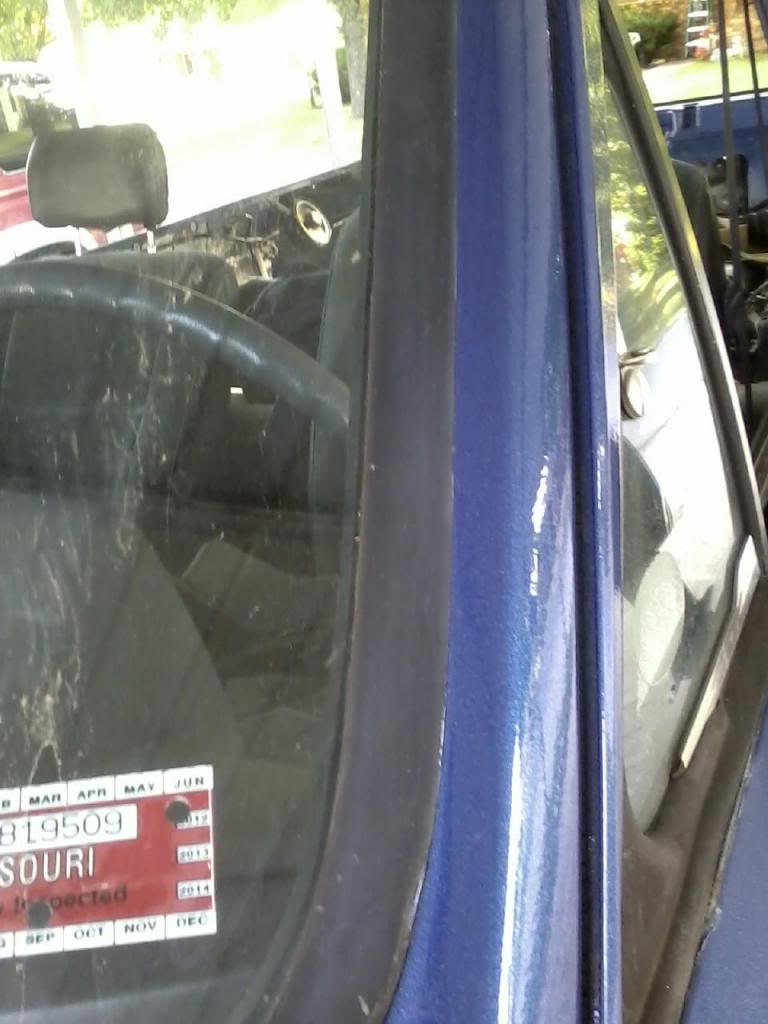

I have a truck in the shop getting ready for paint. It has the trim off and I can get a picture of it. It will leave a big gap and show the metal clips and black caulking in the window channel, that I dont think you will like it.
I will get some better pictures of my runners windshield. I had a rubber seal installed around it and it looks better then without the trim, and stops the rust that the clips and trim cause. I will get some pictures up later today.

Hello Ray.. Here is a truck I am getting ready for paint. I have the trim removed so as to get a better paint results and to get some of the dust and debri that can get trapped behind the trim as well. I also have a metal clip that has started to cause some surface rust that I still need to take care of, which is why I do remove the trim and use a generic rubber seal. Even at the windshield shop, I helped them remove the trim. The plastic clips that are in there are so brittle they will break. They have a hard time removing the trim. The shop I use charges me $10 to take the trim off. I would suggest having someone to take it off for you. It is a pain in the rear. To reinstall the windshield or trim, they can buy a kit for around $20 and they have to, really no way of avoiding of breaking the clips. But here is what it looks like with the trim off.
Here is what I have done when I have a windshield replaced and will eventually have done to the 88 and 85 trucks as well. The 88 doesnt leak, but I have to keep my 85 in the shop as it leaks like a sieve and will fill the floorboard with the slightest bit of rain. ( Disaster..errr, I meant interior work in progress in the background.)

So the replacement rubber trim slips in between the edge of glass and the lip of pillar?
I would be loading a kayak (sea water) on my roof so I think completely sealing interface between glass and rubber, then between rubber and frame with silicone would be good, so water never gets into that cavity. Your thoughts, guys?

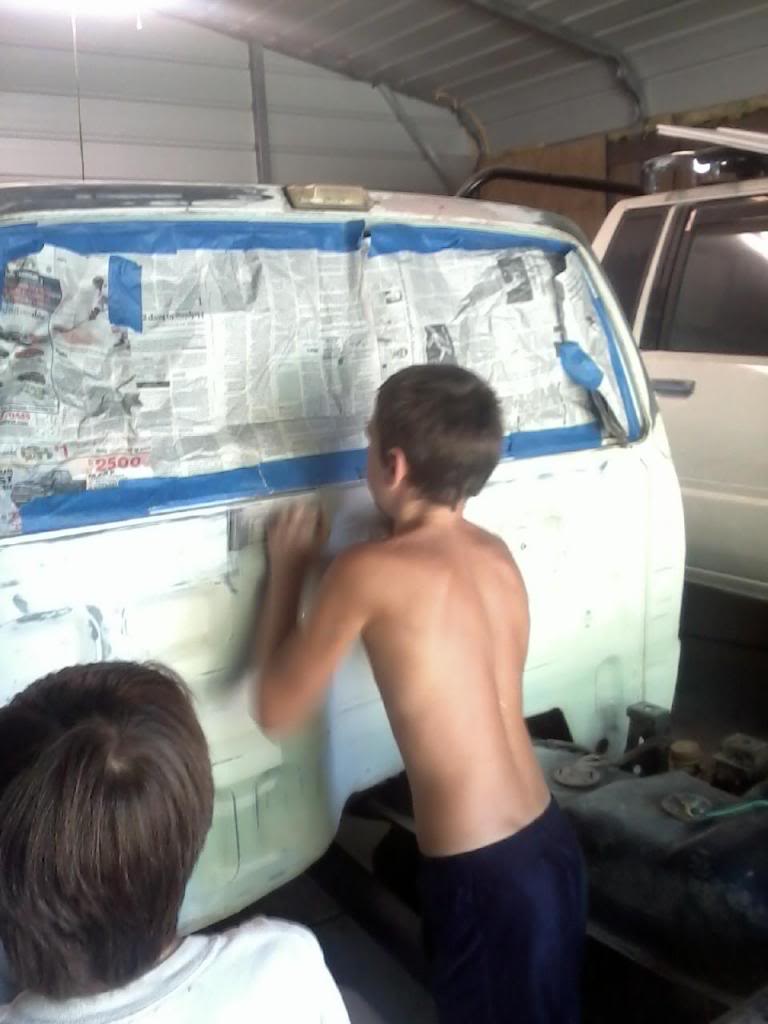

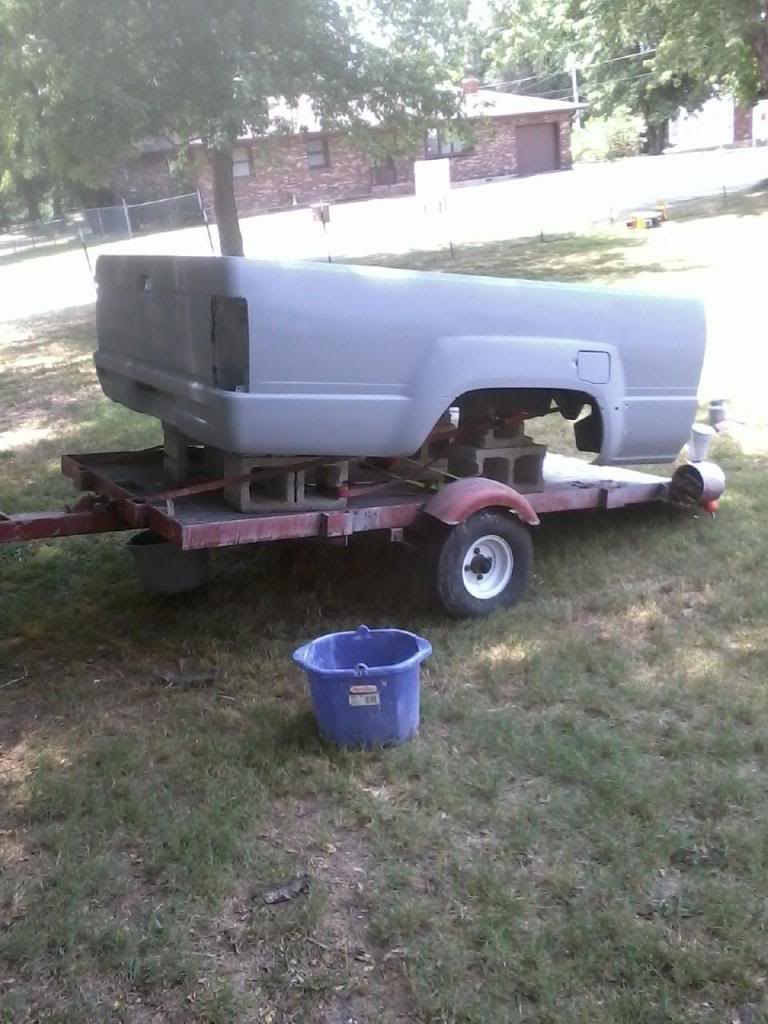

Was hoping to paint tomorrow but somethings come up. I might have an hour or so to completely finish the bed. The cab has about half a day or less and it will be ready. Tomorrow I have to help an elderly relative so that just stopped everythig til my next days off. Misty did the priming. This truck was really taken care of but it did have some damage. This is one of those trucks you just wish you could find, minor dings and such, just 20 years of being a nice daily driver. She knew the conditon it was in and think she likes the fact that she had a big part in getting it straight again. No way will she even try painting. Doesnt even like the idea of painting but is getting better at priming and alot more confident. She is starting to see beyond what a truck looks like and what it can be like.
Bed is nearly done.
Misty and me started early this morning and the kiddos wanted to join in. If I ask them it is a 50/50 chance. If mom is involved, it must be fun so they will join in no matter what she is doing.
Justin getting the back of the cab.
Hunter getting where the camper shell rubbed a groove into the cab. I wont let them or Misty to do the roof or hood. It is to easy to flex and bow around. Those too areas take light pressure and paitence.

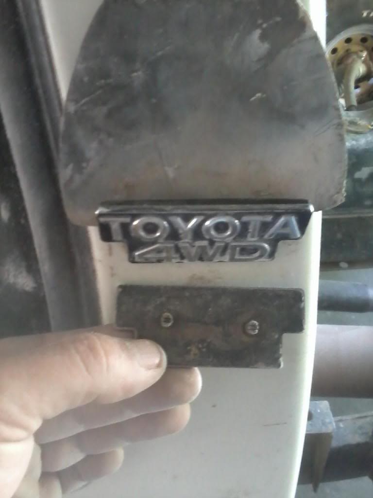

Mostly a reference for me. The "EFI" is glued on, the "Toyota" has pegs. Just use a scraper to get them off. I keep forgetting which is glued and which has pegs.

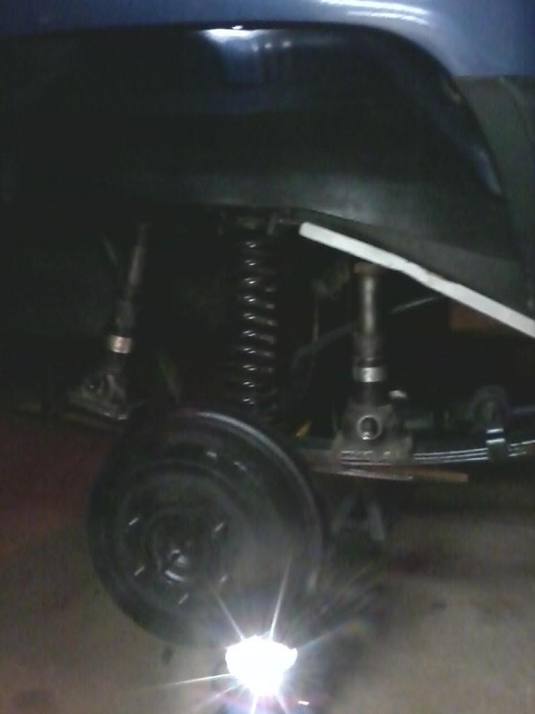

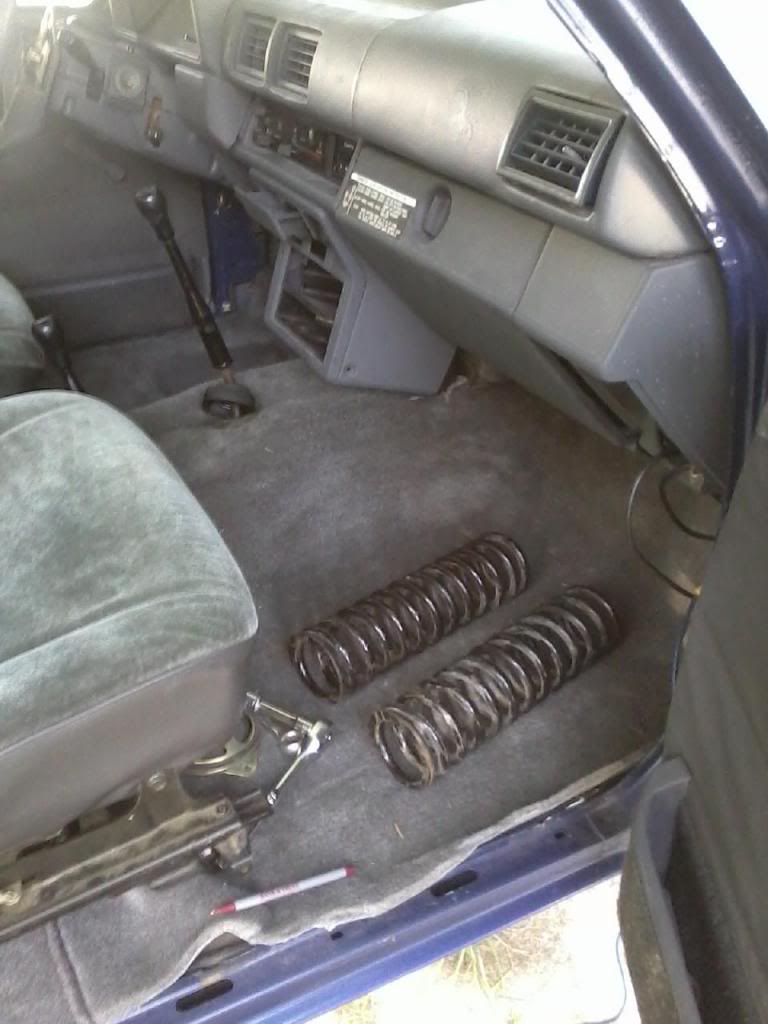

On my runner I got Marks coils in the mail today. Thanks Mark!!! I have the saggy butt going on and like the ZUK mod as I do a lot of trailer towing and feel coil springs are alot better for what I use my trucks for.

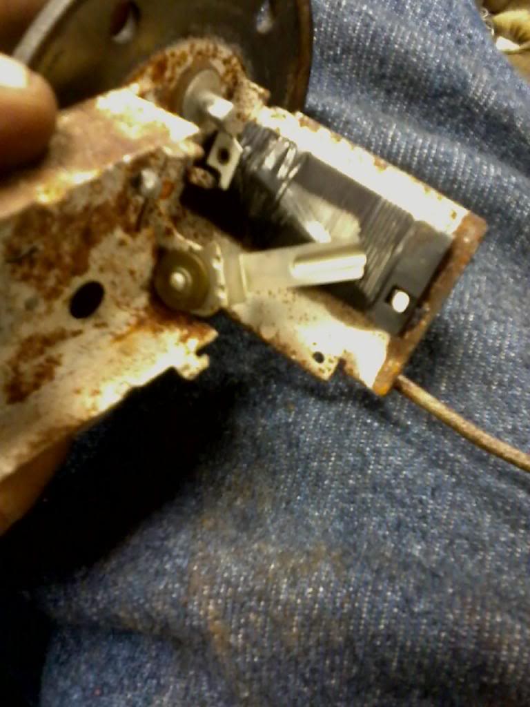

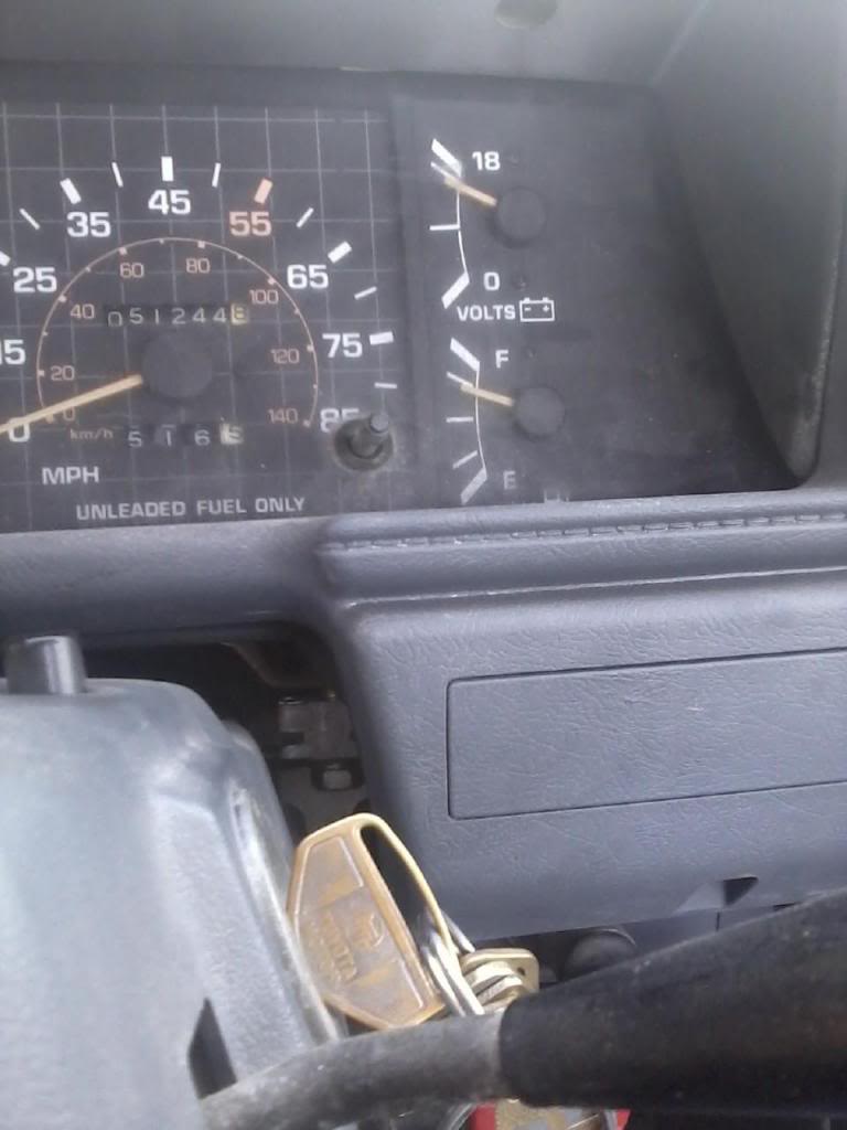

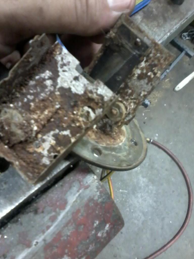

Got my fuel guage working as well. I will eventually replace the float assembly but it is working which I was suprised that it is.
I took the assembly apart and cleaned the wiper that connects to the coil. The black coil by thumb just needed the corrosion cleaned off of the little wiper.
Here is a better view of the wiper that slides on the coil. It had some broken strands so is no good now. A spare that I had.

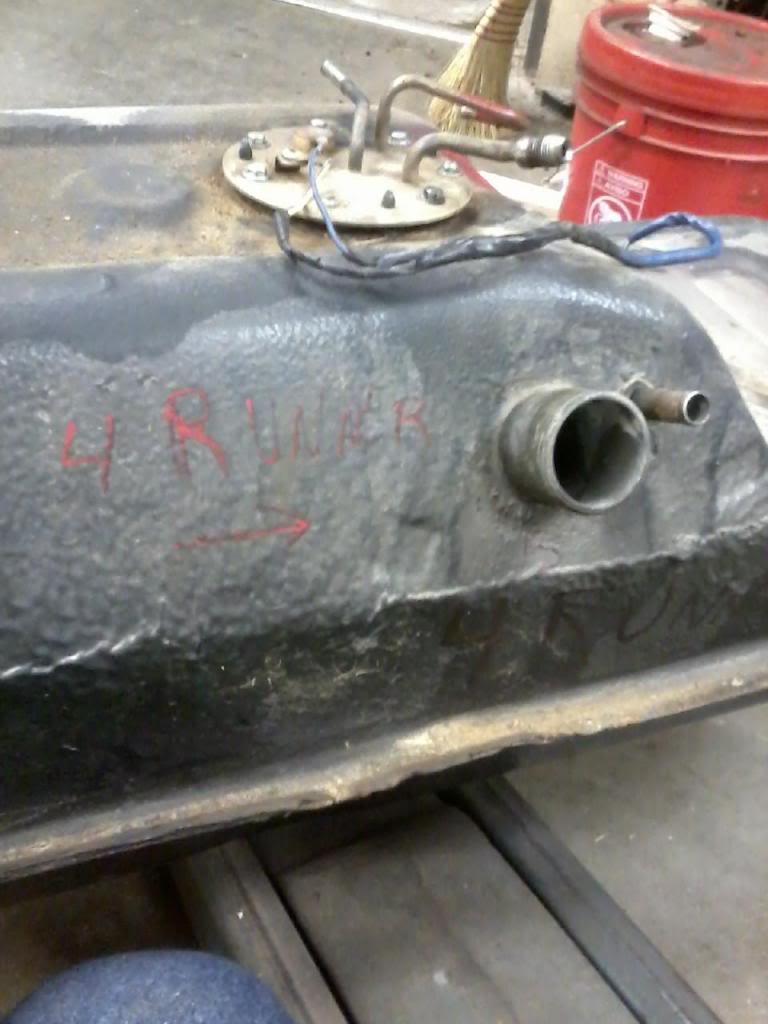

Here is a 4Runner tank. Mostly a reference for me. The big and small pipes are oppisite of each other on trucks and 4Runners.

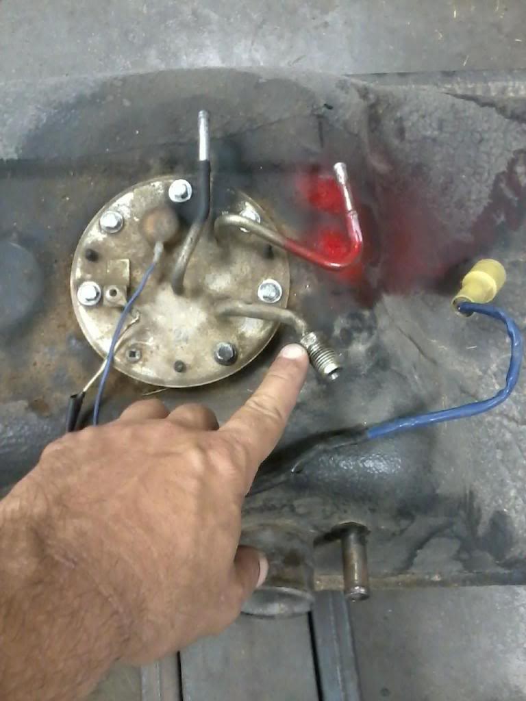

Another reference for me. The 14mm nut is stationary and the 19mm is the one that gets turned. Will add this to my fuel tank page for future reference for me.
