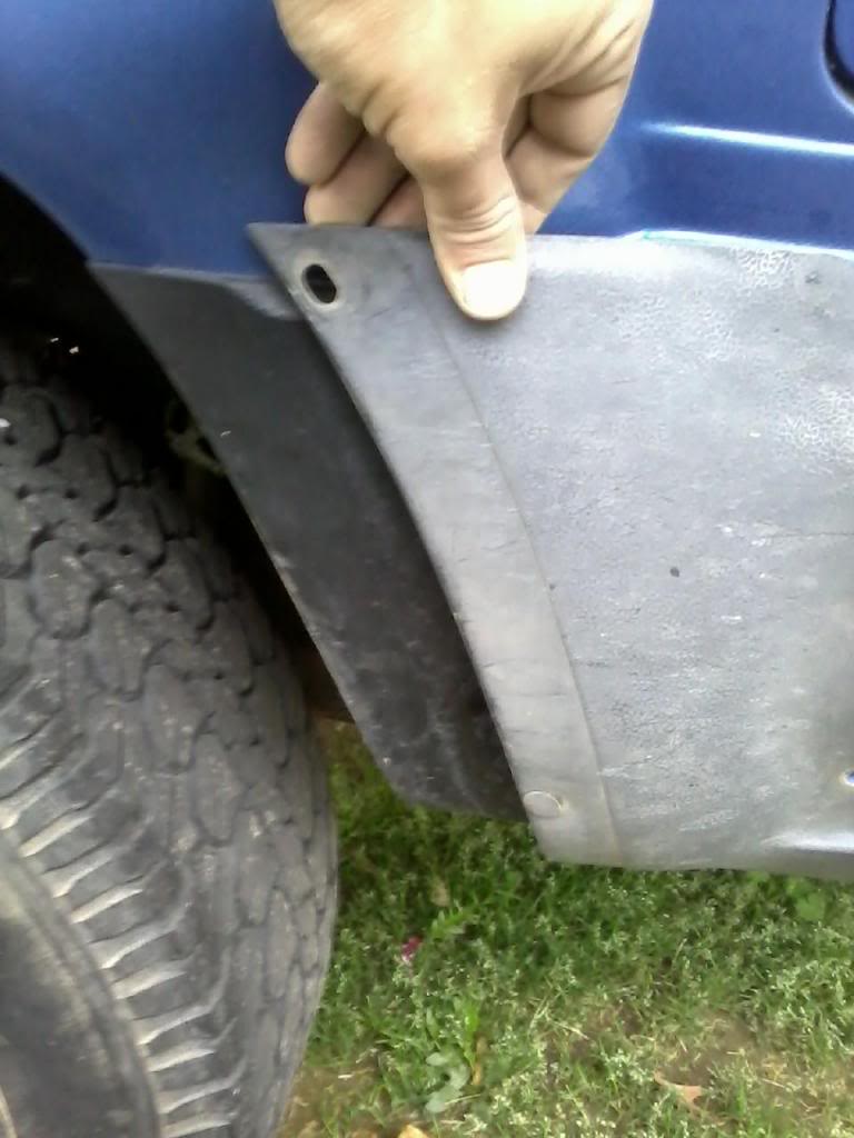

I have been looking to dress up the plastic trim, but there's one piece I can't figure out how to get off without risking damage to it. The quarter wheelhouse guard (the small flat plastic trim in front of the rear wheels). How do you get this off?

Hello mseale. On the 4Runner you will need to pull the inner panels to get access to the screw that holds the bottom in. The other two are plastic clips that will possibly break on you when you try to pull them out. Truck and 4Runner rock guards look the same on the outside but are different like in the above pictures.

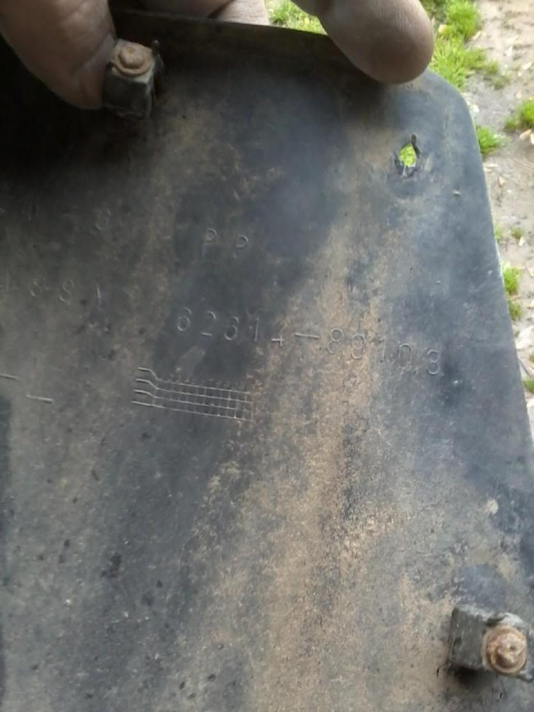

4Runner and Truck rock guards look the same but are different. Truck is in my hand. A 4Runner only has 2 tabs on the out side and some screws on the lip of the fender. A truck has 7 fasteners.

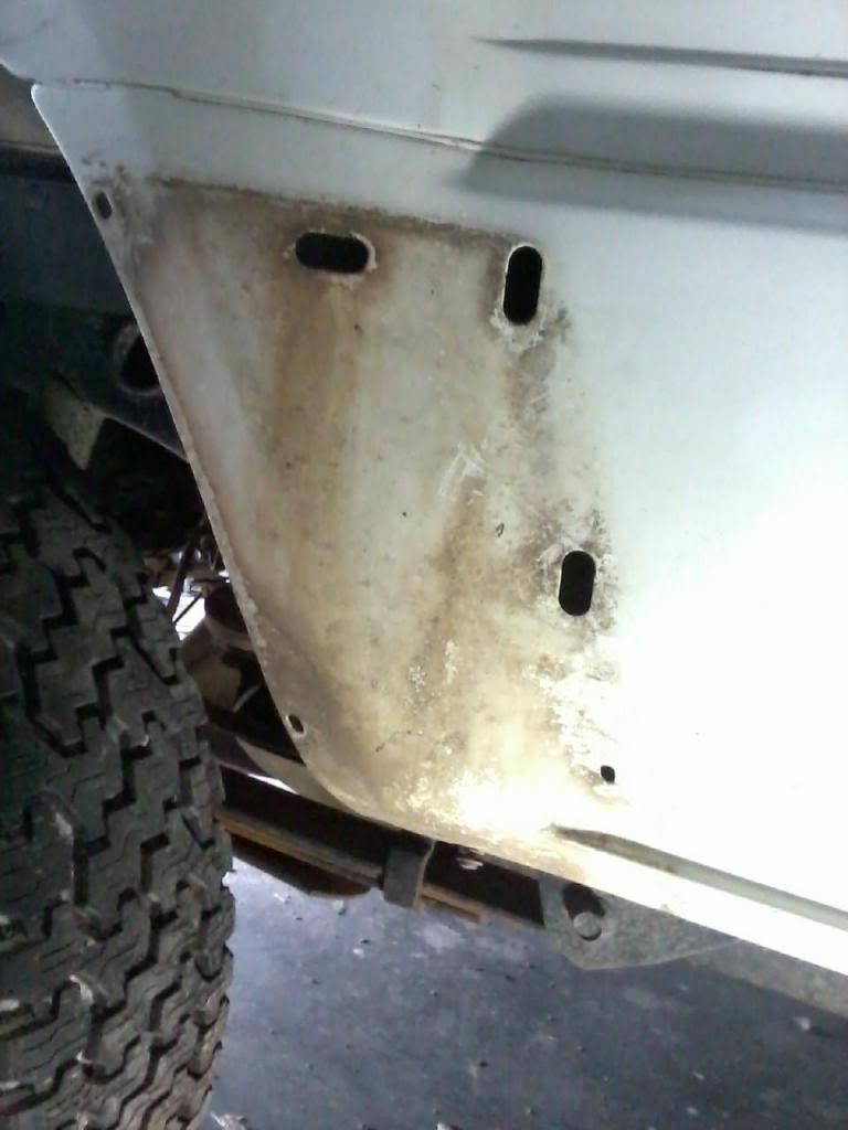

Trucks have 7 locations. Screw at the bottom is another one that is showing in bottom of picture.

One broke in this one. The screws are usually difficult to get out. I normally have to squeeze the tabs to get them out. Not the first one that I have broken in the past and sure there will be more in the future. The other side came out fine.
