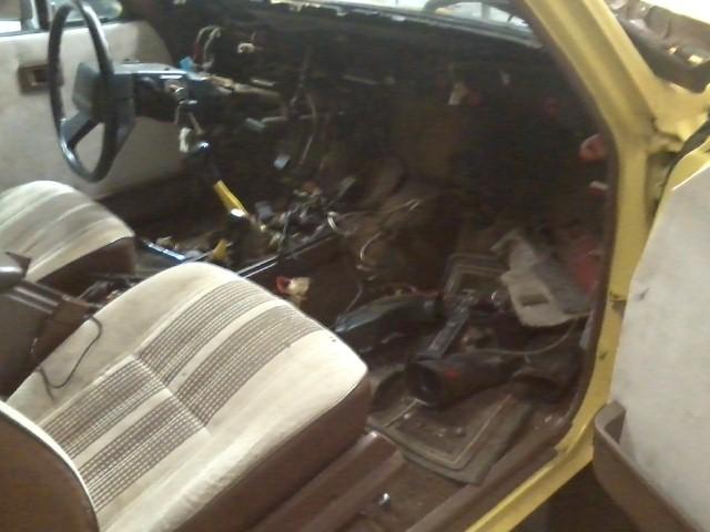

This was on the same day. The weather started out coldddd, but the shop was nice and toasty. It was 15-20 degrees. We got the heater core fixed.

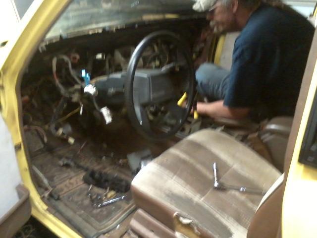

Here was Jason getting the passenger side put back in. I did not get many pictures as I would of liked but we were trying to get as much done as possible.

One hang up that we ran into was his runner had an aftermarket evaporator installed in it and we put in a factory evaporator in. Along with getting the system cleaned which added some time to the project. My air compressor broke the other day and we took the replacement evaporator to the car wash and it freezing. I have 3 evaporators and all three were dirty. I wish I would of gotten a picture of the gunk that come out of the evaporator.
Aftermarket evaporator and getting the wiring all straightened out took a while.

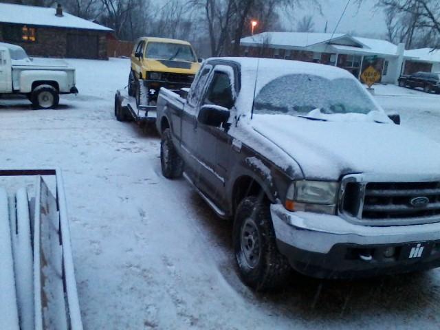

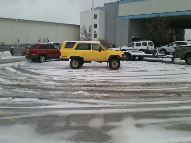

Here we loaded it up and headed for Branson. Weather changed quickly and got nasty.

Jason was able to use it for getting around in Branson which is hilly, curvy and with the weather was slick. Here we are getting it loaded back up for the trip for the way home.

The weather changed on us quick and things had been planned for quite some time to be in Branson. It started out great and went bad quickly after about 12 oclock. We were going to have two days to work on it but lost a day due to bad weather. Just to change a heater core is at best a 4 hour job for me and I have done them several times. We only had about 7 hours to work on it. When you have to clean and get the correct parts it starts eating up time quick.
I am the idiot that when there is winter warnings that will still be on the road out there. I can get around in two wheel when I have to and will go across country for a snow cone if I wanted one. Bad weather wont keep me home. On our way to Branson I tried to teach Misty how to drive on bad roads and after about 20 miles of letting her drive on it, she was ready to let me drive and I was ready to get back in the drivers seat. She only has to drive a mile to work and it is an easy drive and we both decided other then driving to work, I will be the one that does the bad weather driving. At least she tried.

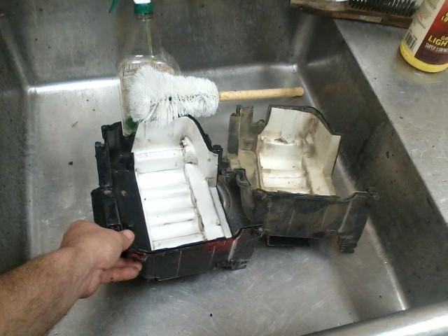

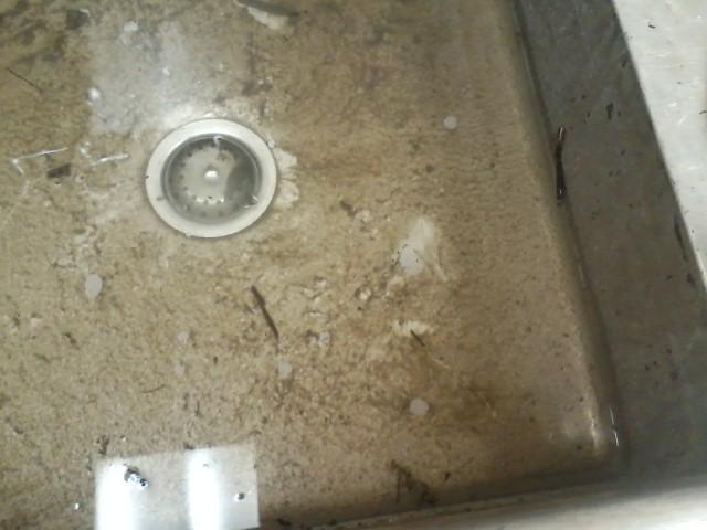

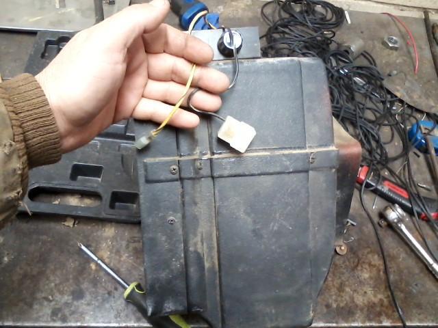

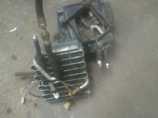

I had some spare evaporators left over when we did Jasons runner and am taking the best of two and making another evaporator for a future project and get rid on one bad evaporator to free up shelf space. I had cleaned these with an air hose but still alot of dirt is in them. I made a thread from Toms build https://www.yotatech.com/forums/f116...trucks-286766/ on cleaning the ventilation system. I later found out that you can purchase a new evaporator for about $120 on that thread. These get dirty and can cause a mildew smell if dirty or drain line is clogged. Also a reason for wet carpets.
Just some of the dirt out of an evaporator. Usually I just go to the carwash with it. I used a shop sink, wife would of killed me if I had done this in the kitchen sink.
I just clean the case with a toilet brush and Simple Green.

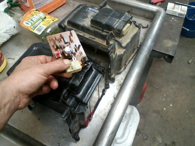

You can pull the controller out to get the case clean. Just loosen two tabs and slide controller out.

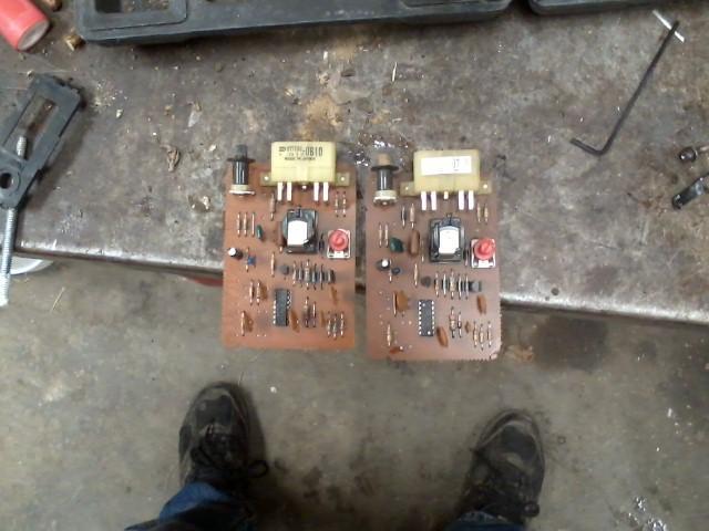

Not sure if you can see but these controllers have 2 different part numbers. I cant see any difference and would bet they are interchangeable but dont know for sure.

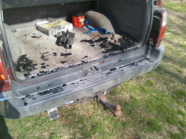

Was taking my air compressor to get some parts for it and was sitting at the light. Light turned green and was concerned a car wasnt paying attention so took off harder then I really wanted to and the compressor fell to the rear. I had it braced for normal conditions but it still fell and knocked out my rear glass on the 3rd gen, grrr...
I have a new back glass and tail gate mostly apart. Does not look like too bad of a repair. First damage I have done to this truck in the 13 years of owning it. Stumbling my way thru repair of a 3rd gen tailgate. If it was a first gen I would feel more comfortable with the repair. I used the 3rd gen due to having a larger trunk area. Never again will I be without a truck. 85 shouldnt be much longer to get on the road. I am taking pictures of the repair on a 3rd gen tailgate and will add more tomorrow.
New glass only weighs about 4 pounds but a broken glass generates 20 pounds of glass. Got the glass out of the truck area and need to get it out of the tailgate.

Thanks Robb.. One small piece does rattle and I think I have finally gotten it out. I was trying to avoid being hit and it bit me in the rear. I watch about as much behind me as I do in front but was really frustrated as I have really done very little damage to any of my trucks unless it was especially just for abuse or work.
Thanks Cyberhorn...I will give that a try. It broke into a million pieces and and various sizes. I have to floor mats for the rear. One for carrying things and one for looks. Glad I had the working mat in.
