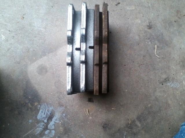

Dang , those pads were roached.

Hello Chris... I think I did get the most out of them pads. lol Wasn't much left.
Hello 775Toy... If it wasn't for a caliper leaking, it would of been when I heard metal to metal. Got me worried what the rear brakes look like.

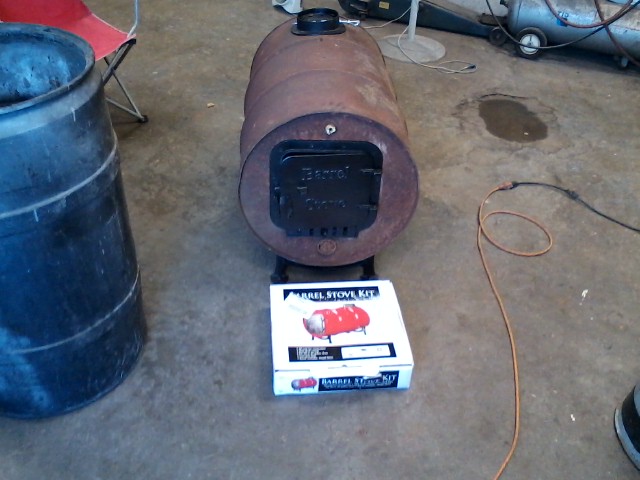

Hope everyone had a great Thanksgiving. Seems like this year is flying by. I got the nuts on and so far no more leaks. I have a friend that has dealt with this issue as well and showed me this fix. I will say installing the nuts, while bundled up under the truck, is just something I don't care for. I was wearing thick coveralls and didn't want to wait for the shop to heat up. Trying to get your arms around in tight places is a with thick clothing on sure takes the fun out of it. I did notice a small oil leak while fixing the exhaust but it is going to wait until I get the 85 running as I want to pull the 86 back in and do some more work on it at a later time. Mostly front end work, fix a leak or two and some upgrades in the interiror.
I was going to use another wood stove but it is bigger then I want to use as it takes up to much floor space. I took kornhuskers advice and got the barrel kit from Orshielins and it is an easy build to do. I have about an hour into it. The kit cost $40 and I still need to get the stove pipe. I will get it later this week as I still need to get the wall ready where I want to put it.
Kit
Here the stove is ready. I bought a rusted barrels so as not to have to deal with the paint burning off. You can use this kit for a 30 gallon drum as well and there is a kit to put another barrel on top to trap more heat. Last winter I put on some weight as it was to cold to work in the shop and was about to get cabin fever. I should be ready for this winter here shortly.
I should be coming back off of overtime and am hoping to get things moving along again here soon. Got plenty to do. Here is the stove completed.

Great. I was going to tell you not to use a plastic barrel but you figured it out on your own. I miss the wood stoves I've had in other houses. It's cozy heat. My garage is attached or I'd get one.

Nice little heater you have there Terry. Where did you get the KIT from? I have a barrel that I would not mind making into a little furnace like that.

LOL Nervo19... I was able to figure that one out. A plastic barrel was 10 times easier to find. You see barrels all the time until you need one. I am hoping to have the stove up and running tomorrow. Wood heat is so much warmer.
Hello Mark...I got it at Orshlens farm and home. It is 30 or 40 dollars for the kit. They have a $20 kit that you can put on top of the bottom barrel for more heat. Also they have a kit that you can install for cooking on. We have lost power for a week at a time and I plan on getting it at a later time since we have mostly electric in the house.
I was looking on craigslist and there are people buying the kit and then selling the whole stove for $150. It is a real easy kit to install. Really cool little idea that some one came up with.

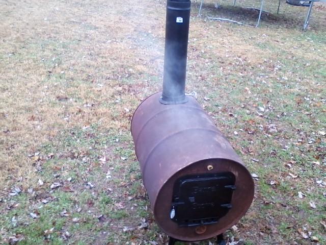

I was taking care of some other thing around the house and made some progress on some and not so much on other things. Sure is nice when things go as planned but it doesn't always work out that way. While I was working on those things, I lit a small fire in the barrel just to burn out any residue from what ever was in the barrel. Glad I did. I set it outside and apparently there was some contamination on the outside as well.
I would suggest that if you get a painted barrel to let it burn off any thing on the outside before using it inside of a shop. After a while it burnt it off and no more outside smoke. I could feel the heat quiet a ways from the barrel
These are popping up all over craigslist for sale>>> http://springfield.craigslist.org/for/4786039626.html I have seen them in other towns in my area as well.
Looking closely, you can see contamination burning off of the outside. These smoke you see is from the outside and not from the smoke stack
