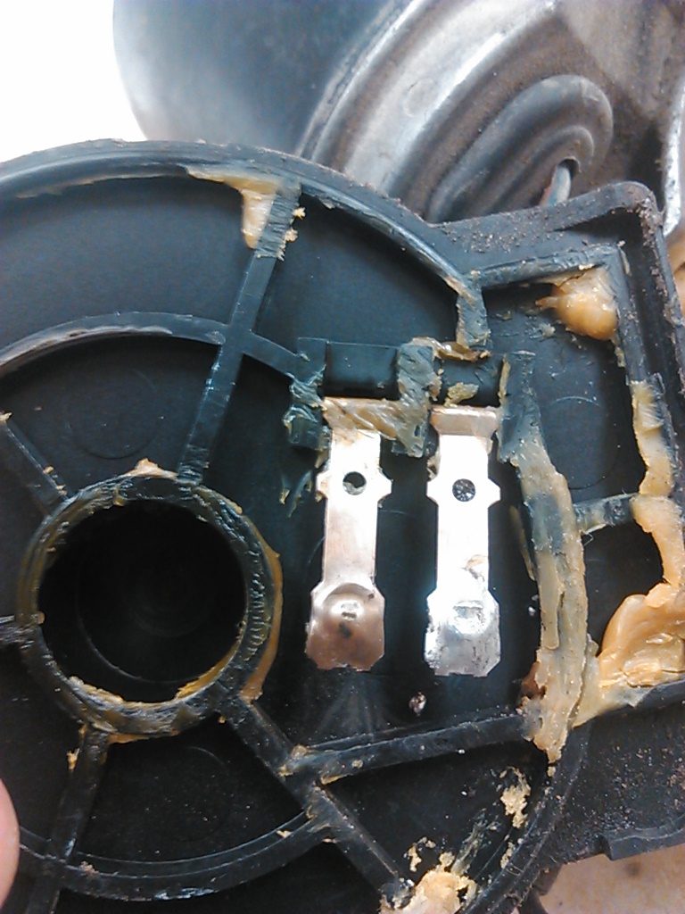

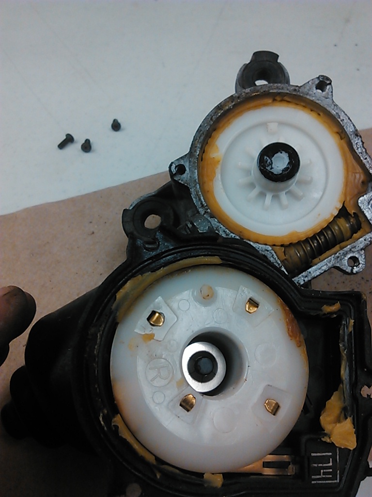

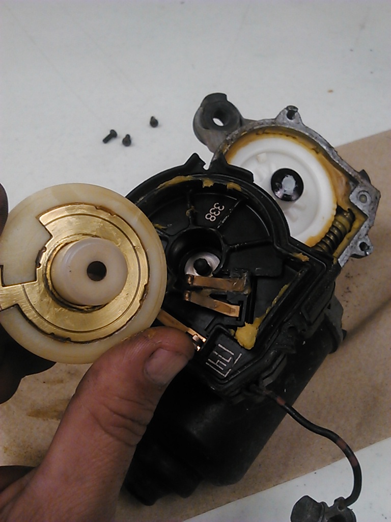

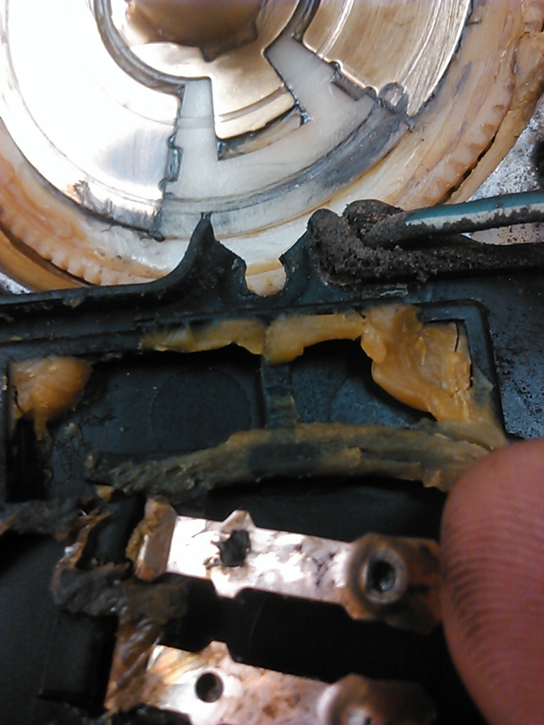

Mistys Runner and this truck have a similar problem and just wanting to see if there is anything I can do about it. The wiper motors on both trucks wont go to the normal stow position. I have a few spare wiper motors so I took one that I have and disassembled it. What I have noticed is the terminal should have a little button or nub on it that has worn off. I am wondering if I could use solder to remake that part that has worn off. Do they even make a brass solder that you could duplicate? I think that would fix one of the problems with these motors.
I really don't want to pull the motors as getting the wiper motor back in time can be a pain to deal with. Been there before, if I could just do some soldering to fix the terminal, I think you could do that with out removing the motor.
Also you can see the plastic that stops current flow that controls the motor some how.
If this isn't fixable, I am see about trying to get some wiper motors out of California as they don't get as much rain and will have a lot less wear and tear on the motors then what we have in our area.
Just for information, this wiper motor is for an 85 or an 86 model due to it having the round plug. The newer models have a square plug.
What I did is fill the hole with solder and it seems to be sticking really well. I will hook up the electrical connection to my 86 and see how it does. I am going to ask Ray if this would work as well.

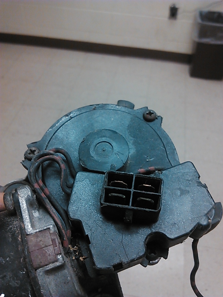

The 87 and newer motor, here is the square plug I was talking about.

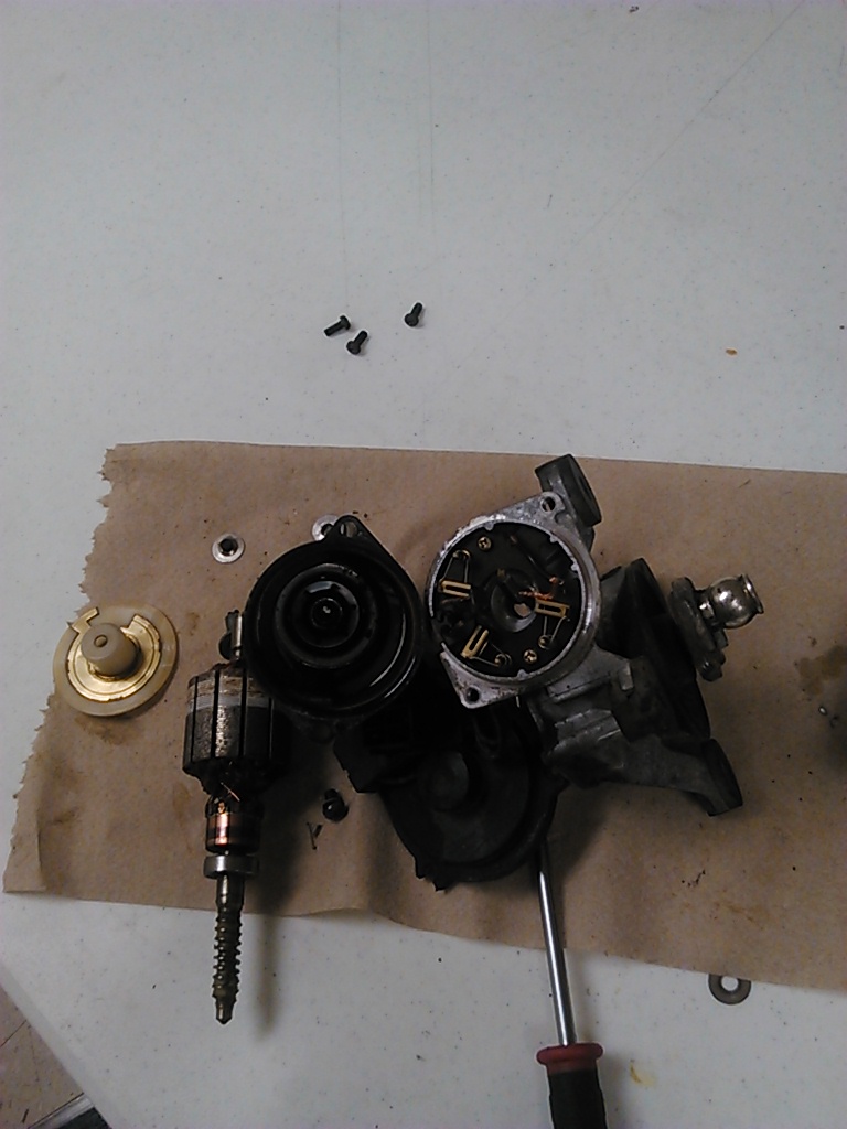

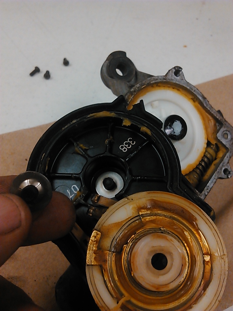

Unfortunately, getting the newer model motor apart has a little clip that holds the wheel on. I tried getting it off and broke the shaft the holds the wheel.
The bottom wheel is how the motor comes apart. Not sure how to get that clip out without breaking it. Not much room to work with it.

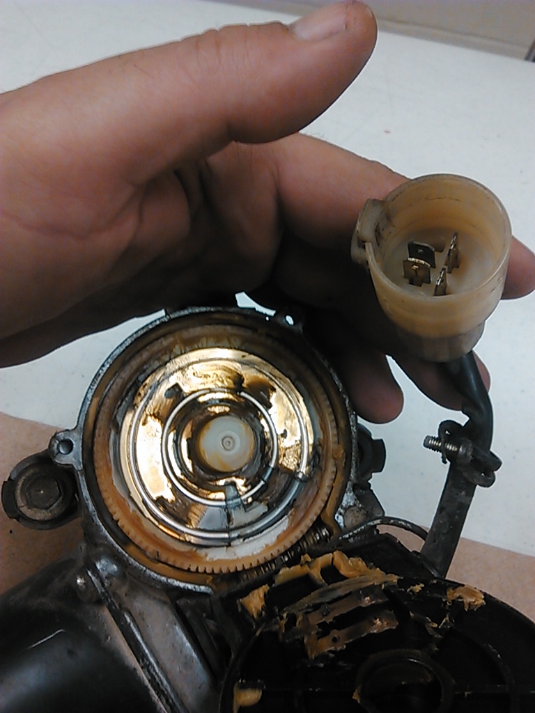

Basically it operates the same as the older motors, but isn't as easily serviceable.
Here the disassembly (destruction) continues. Since it is broken I wanted to see if there was any other things that might could be fixed but the inside of the motor has held up well.

well the solder is softer than copper but with grease to help it should go for quite a bit terry

Thanks Cyberhorn..I am hoping it is in the combo switch as I really don't want to swap the motors. Getting them back in time can be a pain sometimes. Done that before.

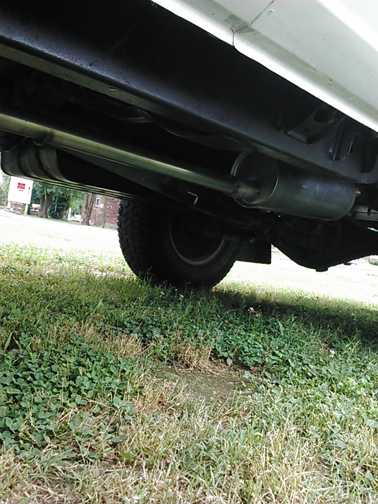

I got a new exhaust system on the 86 pickup. We don't have to worry about emission inspections here so the catalytic converter didn't make it home. They are usually so worn out that they are not doing any good and in the past I had one to break apart and clog the exhaust system years ago. They just get so brittle. Last few I took to the scrap yard they weren't worth anything as I guess all of the good metal burnt up. I scrapped a new Edelbrock catalytic converter that came on a truck as the aftermarket is not nearly as good as the factory. If you are going to keep a catalytic converter, you are better off with a factory replacement and they are not cheap at all.
Eventually I want to get my catalytic converter removed from my runner as it is just a big ugly rusty looking piece hanging down and it shows when you are several feet away. My exhaust system is in great condition but don't care to see that ugly thing when walking up to it. I wonder on a new exhaust system if you used the VHT paint if that would keep the pipes in better condition for the long haul?
New pipe from the "Y" pipe to the end. The old muffler was in bad shape. I got the quietest one that I could get.

Nice work on the exhaust, it turned out really good, that's something I still need to redo on mine...someday

Nice exhaust Terry! What muffler is that? I hear ya about the ugly low hanging muffler system. Which reminds me... I should probably fix mine lol.
