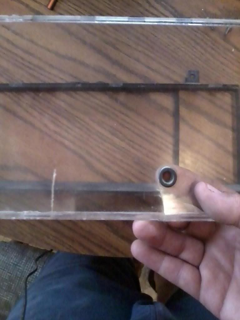

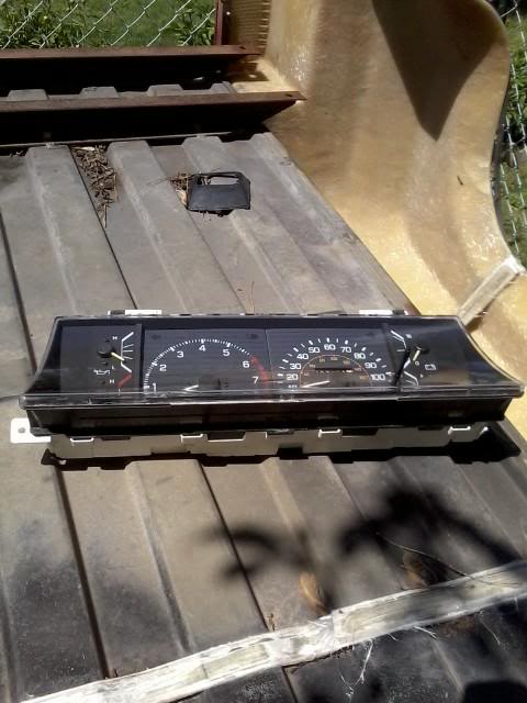

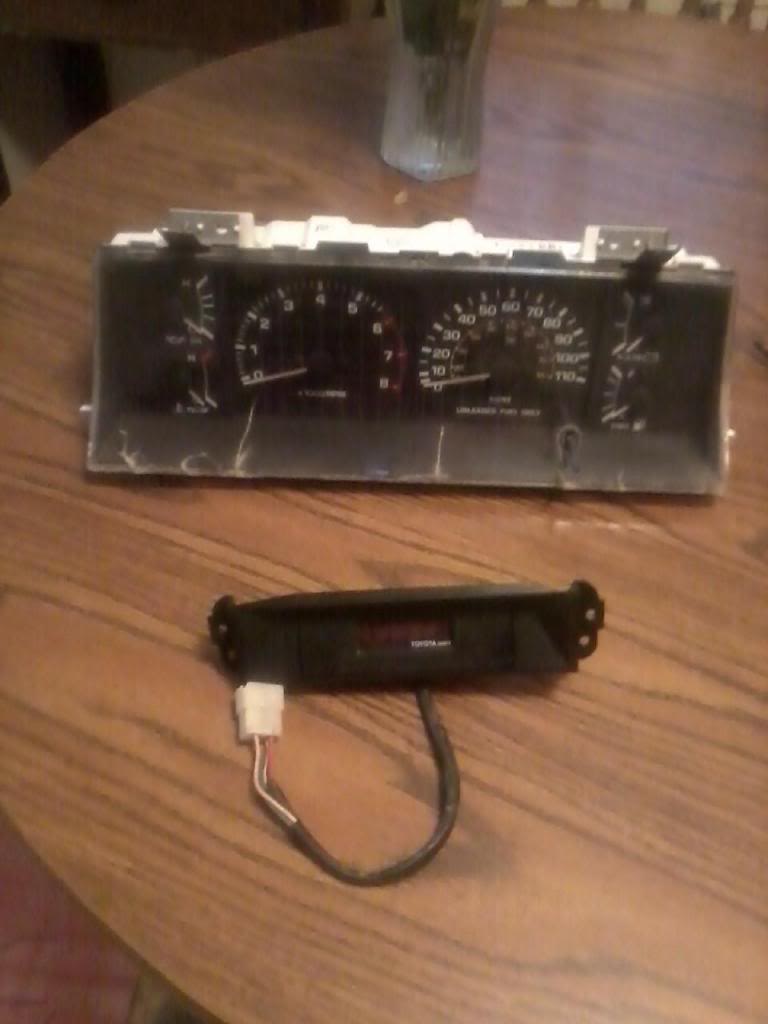

Things are cold, wet and miserabel outside. We had a tornado in our area last nite and just going out to the shop to get some basic tools was colder then I wanted to mess with. But I wanted to get something done today. Better weather is coming soon and I want to do the things I can do that require to be outside when it does get here.

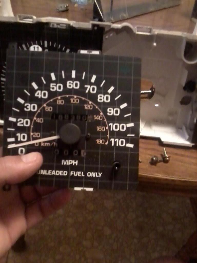

I got Toms SR5 guage from him yesterday and wanted to get the mileage corrected and the face plate is cracked. Figured it would be something that I could do inside the house. Besides the wife doesnt mind and care when she is at work and doesnt know I am doing it inside the house
Here is his SR5 Guage. Has three cracks in it. The clock below is one I got from him as well and will see if I can install it at a later time. I have seen a clock in a truck before and always thought that someone took it from another Toyota model and put it in. But Tom had this in a parts truck and now I am wondering if it wasnt an option. I seen the same clock as well. I figured that since the clock option was always by the heater control, Toyota wouldnt offer it elsewhere.
Cracked faceplate.

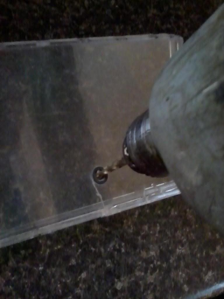

The SR5 Guage just has two lines that run on the ends of it. I gently took a flat blade screwdriver and seperated the plastic from the black part on both covers. The SR5 plastic has a little rubber grommet and the hole for the tripometer is quite large. I just put the two covers on top each other and used the grommet as a guide and drilled the hole.
The two covers are stacked on top of each other with the SR5 on top. Doesnt look like it but it is there. I then drilled the hole and when I got the hole I did several test fits and seeing which way I needed to enlarge the hole for the tripometer handle to reconnect and have plenty of room to operate.
Here it is with the Standard Cover on a SR5 Gauge. I just used Super Glue to reseat the cover on. I also got the mileage corrected while working on the guage assembly. One set back is while trying to get the needle off, it broke. It was being stubborn. I worked it gently for 30 minutes and it still wouldnt come until SNAP. I am not worried. I do have another guage, but Jason is sending me one that is bad but the speedometer is good. One small setback.

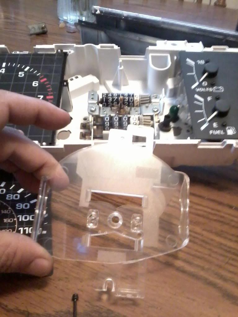

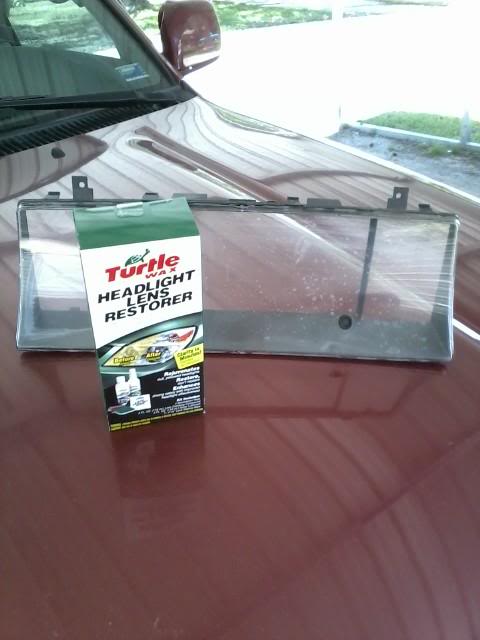

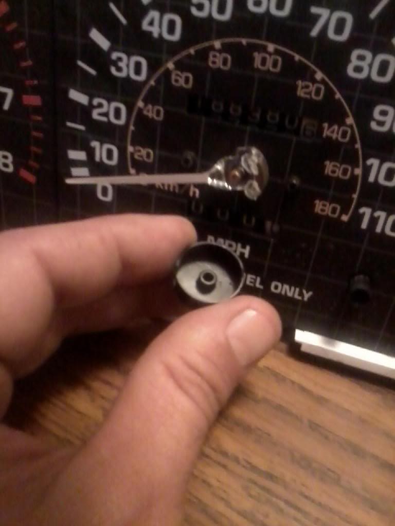

I use my 88 Runner thread alot for myself to refer back to for information and was surprised I didnt have more on doing the guage swap. I am posting it here so I can update it and add to it and will eventually move this info to the 88 Runner build.
I wanted to put my SR5 Guage in and got to looking at it and wanted it cleaner. Remove the tabs that screw the cluster to the dash to get the lense off.
SR5 Guage Swap info from iamsuperbleeder.. https://www.yotatech.com/forums/f116...06/index2.html

I used a lense cleaner to clean it up.
I am quite happy with the results. The label says to allow up to 24 hours for the lense coating to dry. Will have to wait and see final results. Either way I am stuck with it. I have it tilted to avoid a glare while taking the picture. No matter how hard I tried, just couldnt get a good pic without the glare.
SR5 Guage Swap
Here is the Guage. I will address the cracks later.

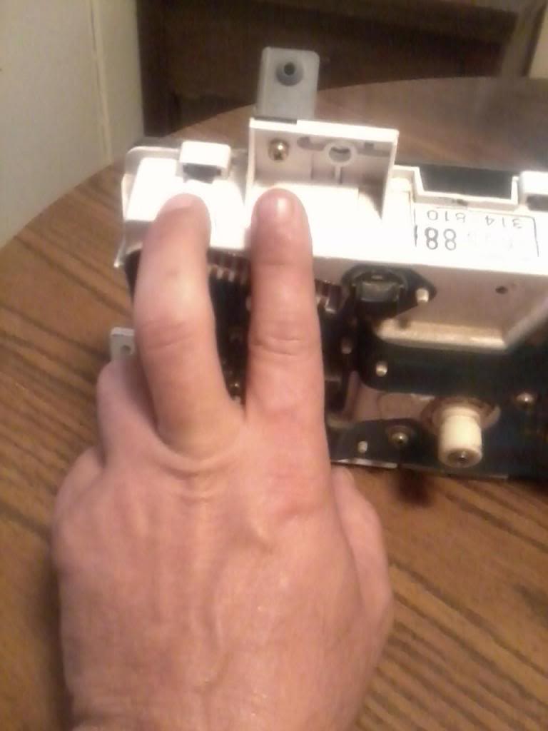

Remove this screw and the bracket faces forward and same for other side.
You have 4 tabs on top and 4 on bottom. I find it easier to start on one end and get the first one loose and then pry it slightly with a flat blade and then do the next tab. Same for the bottom.
These 4 screws hold the Speedometer in the cluster. Will need to remove cluster to correct the mileage.

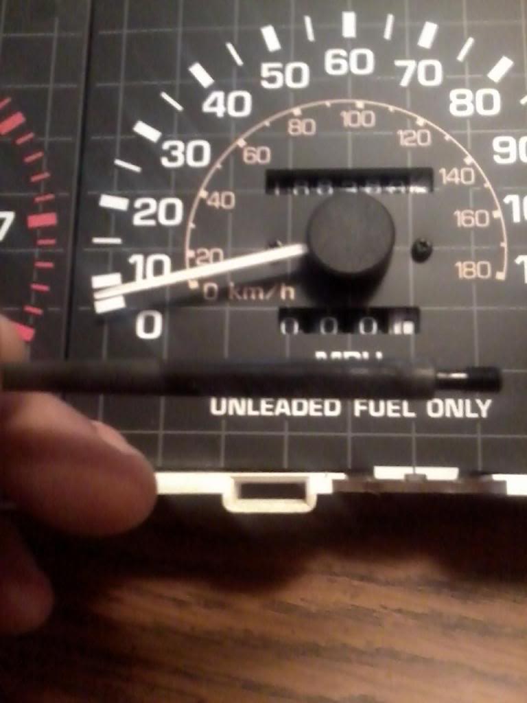

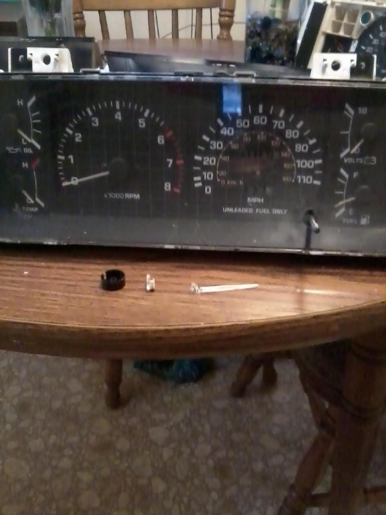

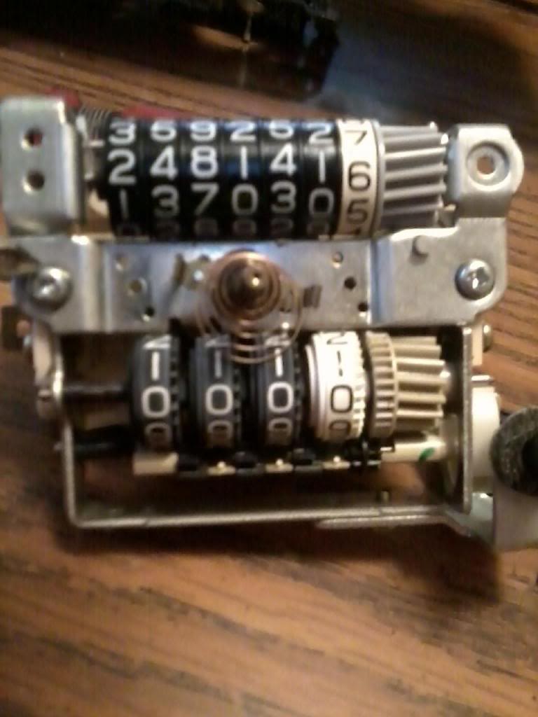

Here is whole assembly out. Also the Tripometer needle is taken out by spinning the whole handle to the left.
On this style of needle the round cover over the needle can and will pop off. It is just pushed back on.Tripometer handle I am talking about that I am holding.
Here is cover I am talking about.

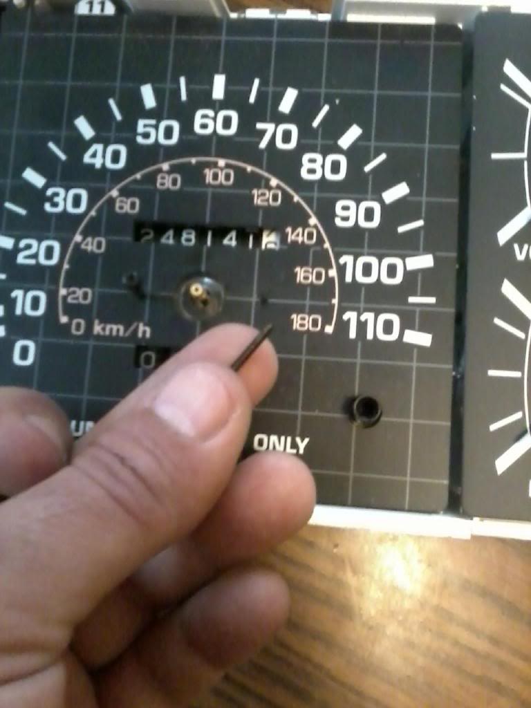

I loosen the two screws showing just a little to make it easier to correct the mileage. Start at the far right or the lowest number and work your way to the highest number and then retighten the screws. Also I dont mess with the tenth setting. It is tight and you might break it. Leave it alone in my opinion. When changing the numbers, twist them downward.

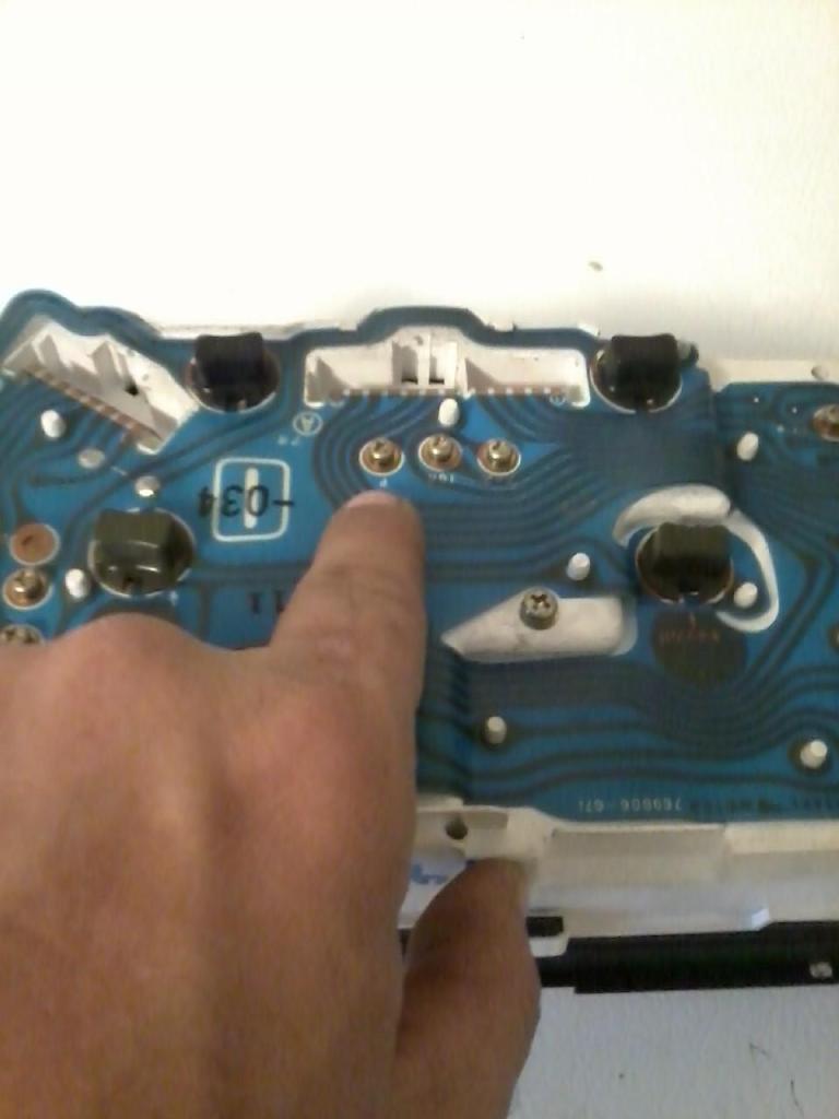

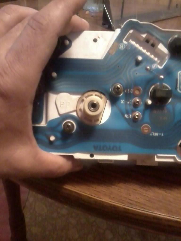

I am starting on getting the tach working. I found this on getting the tach wired up if it doesnt have the factory wiring. I will post good pics if this works.
LINK>>>> I found http://www.siestaoffroad.com/clustertech.html
Back of guage is marked with a "p".
This connection for the negative off of coil. A little different from the typical coil. I just stuck the wire into the slot.
