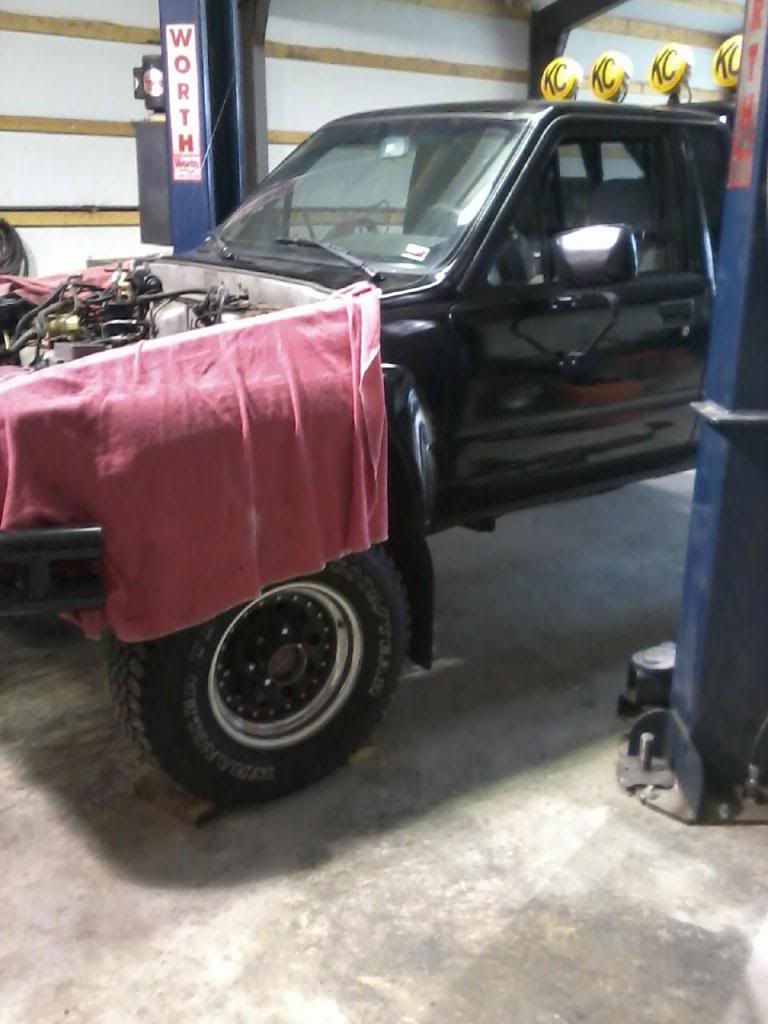

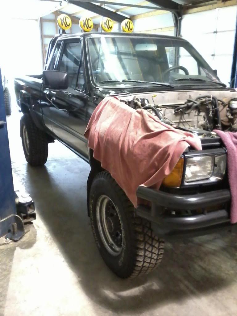

I have been busy on everything else but the trucks and am really wanting to get out in the shop next week. Supposed to have better weather then. Today I got to see Jameser84 Extracab 86 pickup Back to the Future build. I was unable to help him do his motor swap and refered him to a friend to do it. James truck is one sweet little truck. Setting in it showed me the potential for my truck. It is nice in side and on the outside as well. Here is his build>>>https://www.yotatech.com/forums/f199...eplica-256752/
Getting ready for heart surgery.

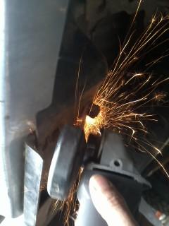

I am working on the 86 Extra cab. I have a better bumper for it and the old one is dinged up really well. It got bumped in the back end and did some damage to the back of the bed. I need it out of the way to get the back end repaired.
I would suggest not using carriage bolts for bumpers. The bolts can rust up really well and the square holes that hold the bolts usually will strip when alot of pressure is applied to them. I am replacing this bumper so saving the bolts and the bent bracket wasnt a concern so out came the cutoff wheel.
Bolt that I had to cut as it rounded and the bracket hole rounded as well.
Damage in the back below tail light. I see alot of these truck with quite similar damage in this area. I take a pry bar and from beneath the truck ( will post a pic later of how I do it as pic didnt show up) and pop the dent out. I try to keep bondo at no thicker then a nickel. It will look like a lot of bondo is applied later on, but most gets sanded off. Bondo gets a bad name as people put to much in and dont try and take the time to dt the dent as shallow as possible.

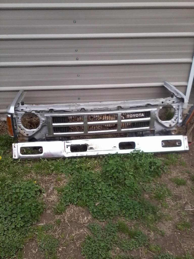

I had some rusted and dented fenders and extra things laying around that I though that I would assemble the front end. The radiator support core is the orginal core I used to get my 86 Runner all together until I found a better one.
Here is the core I orginally had on the runner that I am using for in the picture below this one. The drivers side lower part was all rusted up.
Here is the rusted core and some rusted/dented parts I had laying around that I was unable to repair so thought that I will eventually add this to my shop. I want to eventually use the head lights for extra light and either get it real straight or make it look like it crashed thru the wall.
Junk parts getting used again that will be a small project for later on.
