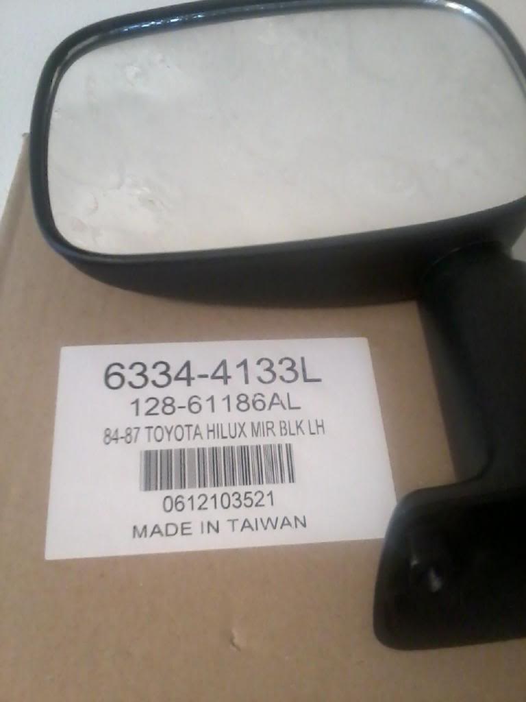

When I got the runner, someone had taken the mirrors off before I got it. It came with the big brackets that have a third mounting hole half way down the door. I intentionally went with these doors. Most probably prefer the smaller mirrors, but I do a lot of towing and I want my mirrors to set out further then normal so I can see trailers that I seem to pull alot.
I havent found any in the boneyard yet and I will eventually get some but for the meantime, I did get this one for the drivers side for a temporary fix. The salvage only charged $9 for it new. It is Taiwan made which I am not a fan of, but for someone that may need one it is an option. I find alot mirrors on ebay as well, just not the ones I am looking for.

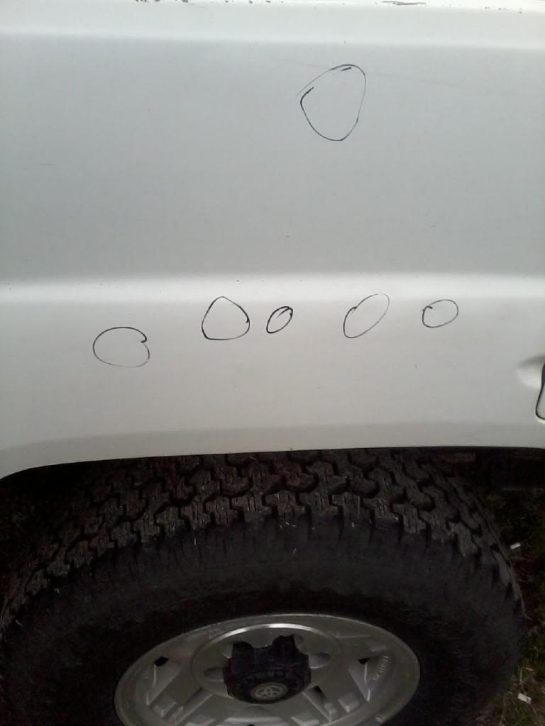

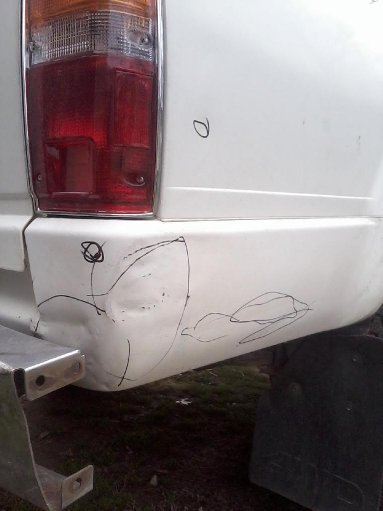

It is easier to find the dents when paint is still on. Once you get the gloss off it easy to miss even a small size dent.
Here is where the most damage is and is on both sides.
The five smaller dents in the rear fender is actually factory spot welds. I dont see this in 4Runners but see it in pickups. I believe it is for the inner fender wells.

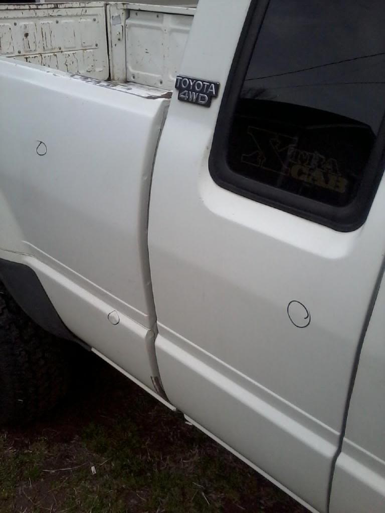

A couple in the extra cab part and what I plan on fixing first.

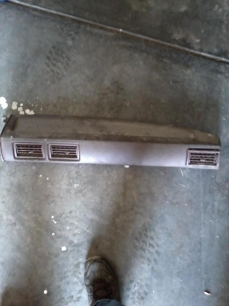

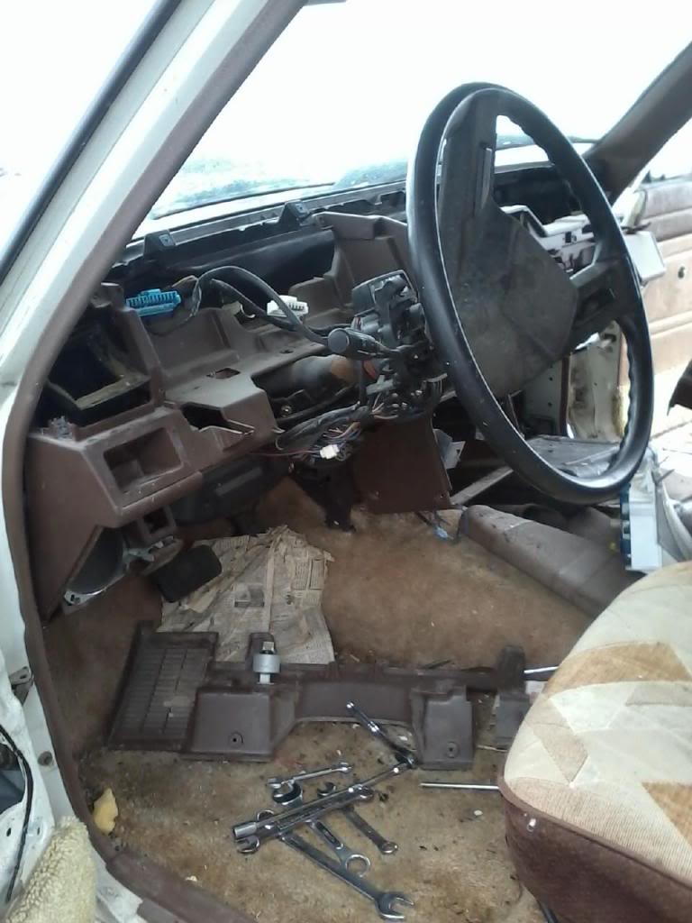

Went to the boneyard and got a perfect dash. Not sure if I will put it in Mistys truck and take her old one or just put it in mine. Still debating on which one it will go in. Got it out of an 86 camper. Only had 50,000 miles on it.

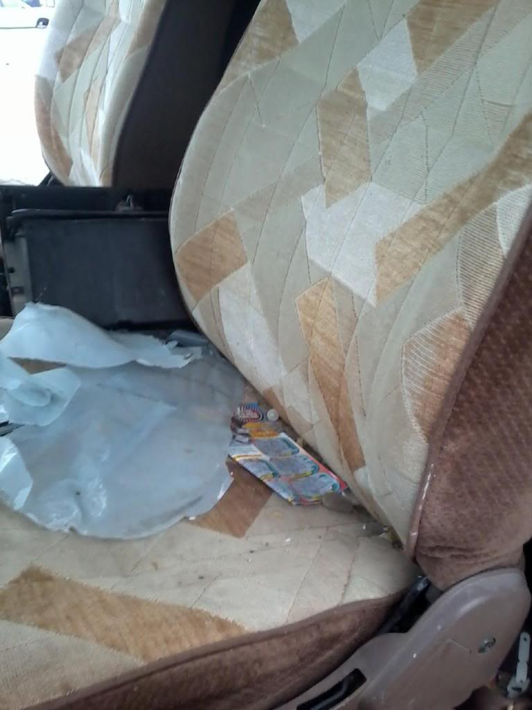

Seats were in great conditon, but not my style. Might see about getting them recovered, still thinking on this one.

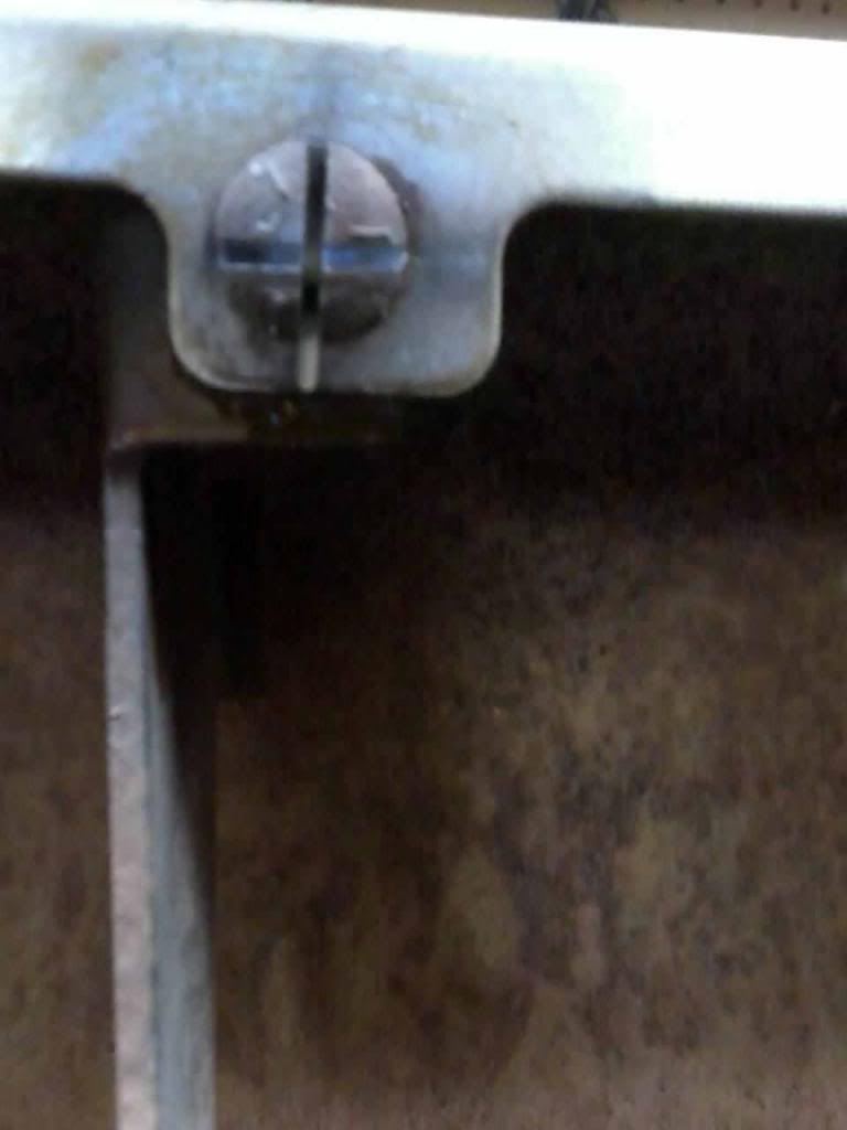

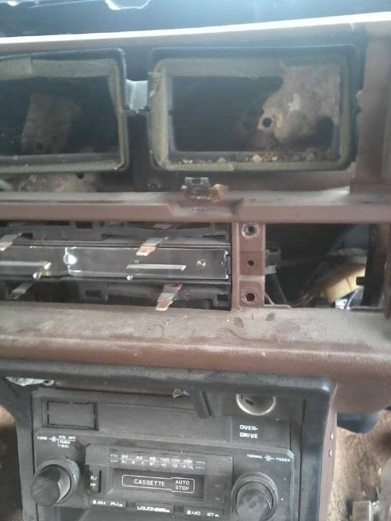

I have seen some dirty ventilation systems before when truck sits awhile. This one was no different. I took everything apart in hopes that if someone beats me back to this truck that it wont get destroyed for some simple part. I want to get the heater assembly for it at a later time just to have a spare.
I came out with 2 pounds of nuts, bolts, and tabs. Just thought I would mention this as it is something that is easily forgotten and needed at times. These just pop out from the back really easily and while in the boneyard is a good time to learn how tho get these apart so you dont damage yours when working on it. I took it down to the heater core just for the practice and save the truck some damage.
I did put everything back together and it is just sitting there. I put the speedo and bezel back in but took the picture before I did that. Told the yard owner everything is still there and not destroyed. For what he was going to charge me for the dash, I got a injector harness for the 85 as well for the same price. made out like a bandit today.

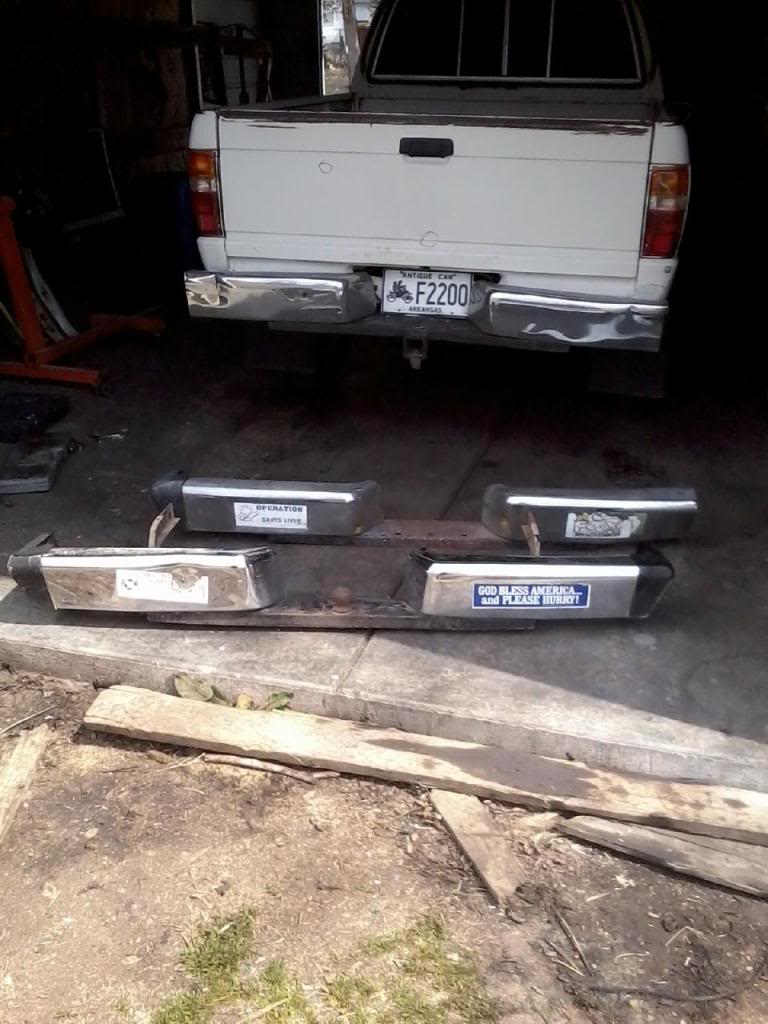

I started working on the rear bumper today. Was hoping to start on bodywork but I have been chasing and trading parts so that took alot of time. I came out pretty good. Will post about that later. Still need to get pics of them.

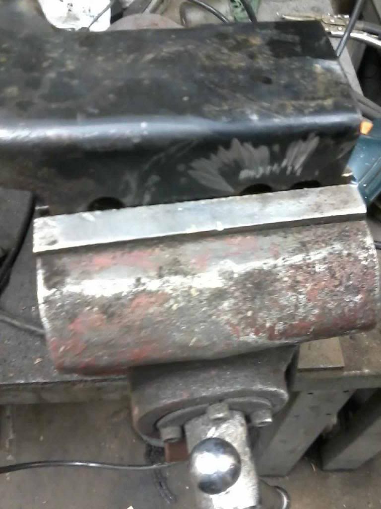

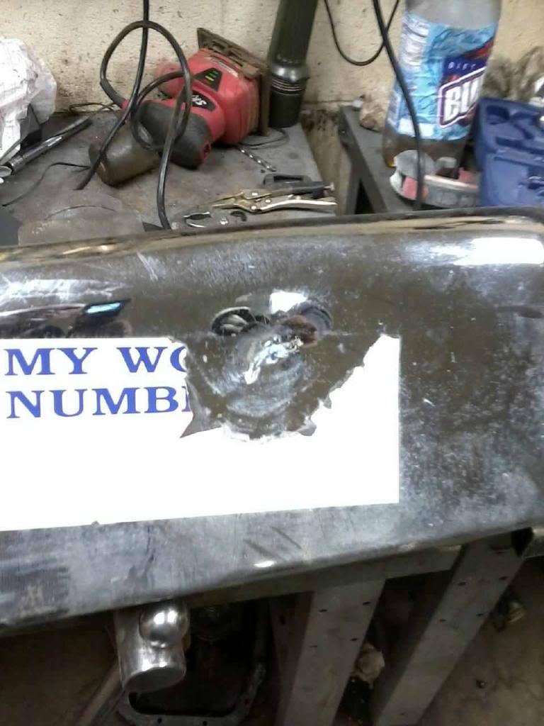

This bumper had a big dent in it. I took a piece of metal and laid it over the inside of the dent and used the Big Freaking Hammer and conviced it to flatten out. I might use this part instead of the other that is flatter but doesnt have the shine to it. Will wait and see how the rest of the pieces come out.

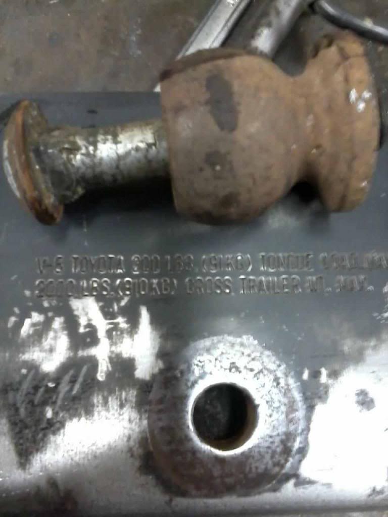

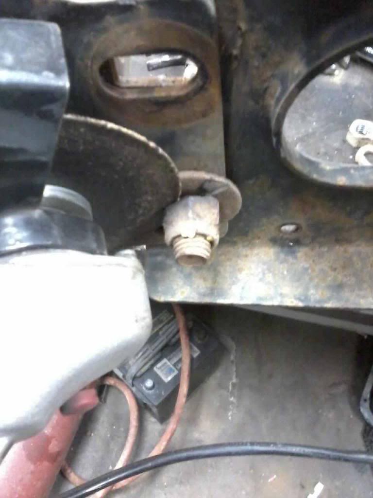

The bracket bolts have a carriage bolt head on them. The bolt just twisted and wouldnt break loose. I had to cut about half way and whack them with a hammer to get them off. One of the benefits of rust.

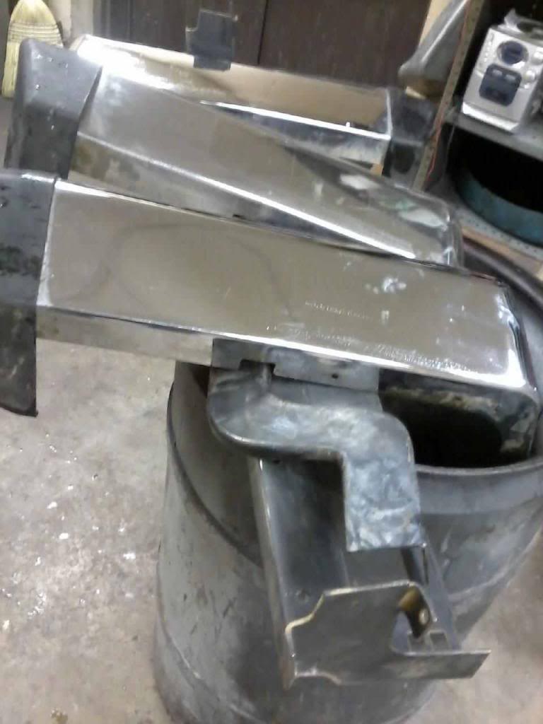

Here I got alot of the main frame of the bumper cleaned up and the rust off of it. I am not sure, but dont think you can get these ball hitch anymore that have the bolt that runs thru the ball. I do not like them in any way. They just dont seem to hold a trailer on to well. This truck will only tow a light aluminum boat that is probably less then 300 pounds. If doing alot of towing or heavy towing, get a frame mounted hitch. I have seen several people get into trouble not knowing alot of information about the correct set up. Every bumper should have the rating stamped on it some where.
Several parts of these bumpers are bent. I have made some great repairs just by using a vice to get everything straight again. A few pieces I didnt think would flatten out and now I have a hard time finding the dents. Just doing the best I can with what parts I have. I think it will turn out okay. Wouldnt hurt to have them re-chromed, but probably not going to happen.
Other bolts that I couldnt get off I cut them in quarters and used a hammer and chisel and took the bolt out a quarter at a time. Doesnt take long. Just watch the cutoff wheel as it does like to catch and try to jump up and get you.
Here is one main frame and a set of brackets. Will get them ready for paint here shortly. Three of the chrome bumpers have turned out well. I will try and use some Never Dull for a better finish. Some of the bumpers have scratches in them and I am hoping they buff out.
