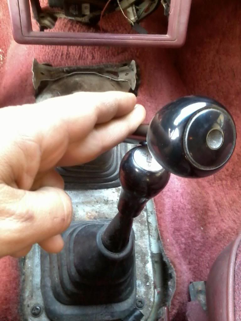

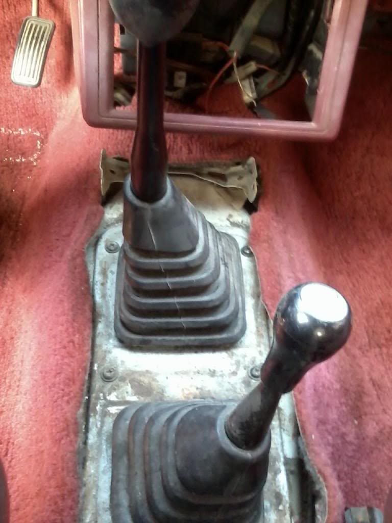

I started to look around the net and YT. My Transfer case looks like it is in 4 Low and is actually in 2 HI. I have pulled the stick thinking it might be in backwards or something. I can tell this transmission has been out at least once as they had the wrong bolts holding tranny in. Dont know why it wont work right and no matter what I do. I cannot get it in 4 Low.
When I put it in Reverse, I hit the transfer stick and have to push against it to go into gear. That is the reason I am getting ready to swap t-cases. I wonder if this is even the correct t-case for this truck.
Any suggestions would be greatly appreciated. I have done many tranny swaps, but never a t-case swap. From what it is looking like it is an easy swap, once I get it ready to go in. I want to clean it and get in new seals.
Going in Reverse.
First Gear.
Going in Reverse.
First Gear.

boy terry somthing doesnt seem right with the shifters hiting like that but its been so long since mine was together I dont remember ˟˟˟˟er positions well enough to be of any help. I no this isnt your problem but mhy wifes dodge would go into four low when she bought it and I started checking into it and the shifter was hitting the floor do to the BL the PO had installed[since been removed] like I said I know thats not your problem but It might be somthing simple like that.
#326
I'm sure you said you turned it around.... but DID YOU TURN IT AROUND? hahahaha. Just to try, ya know? I can't remember, and I was just in there! grrr! lol.... Can't remember, I meant, "Is the 4wd shifter angled in any way at the socket/insert"? I know the main shifter is,....but you said you'd tried that turned around, too, right? My new Marlin Kit is much tighter, ...but I had to mark it as I took it out as I was quickly getting confused and forgetful! lol.... Oh well, getting old can suck, BUT ALSO ROCKS! LOL.

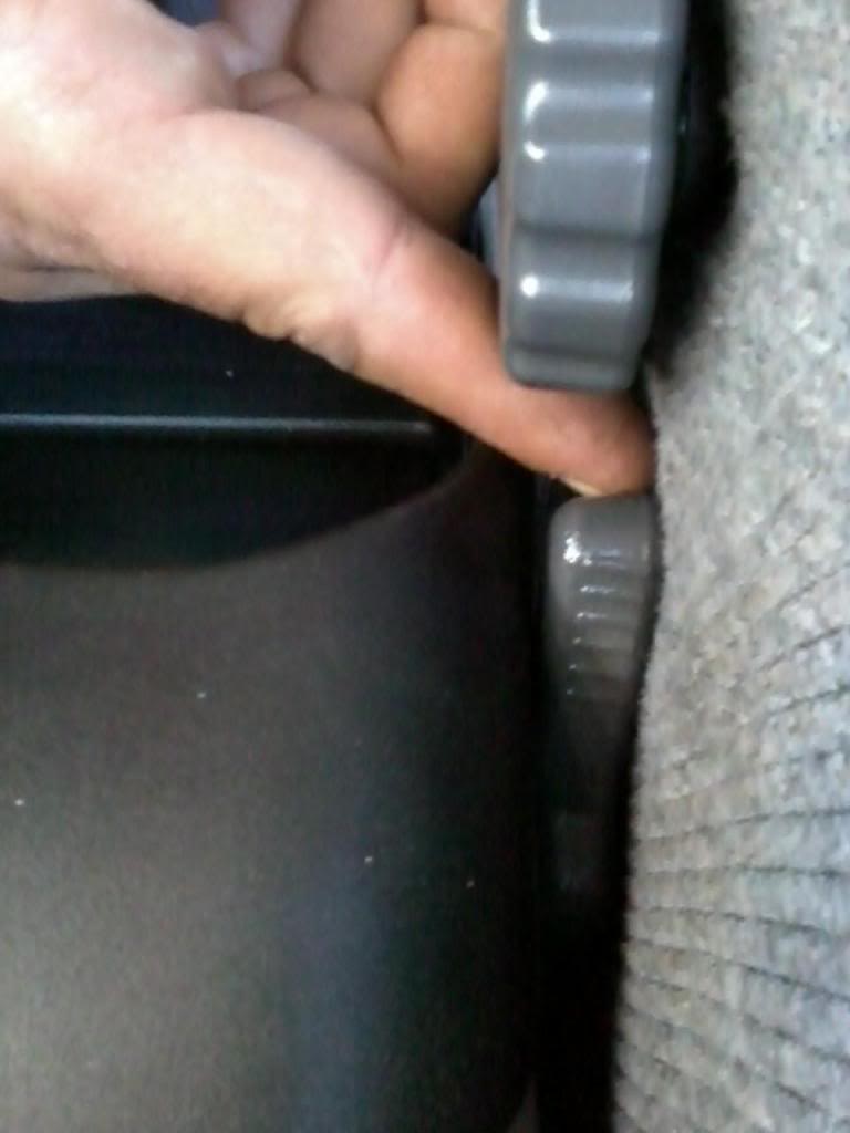

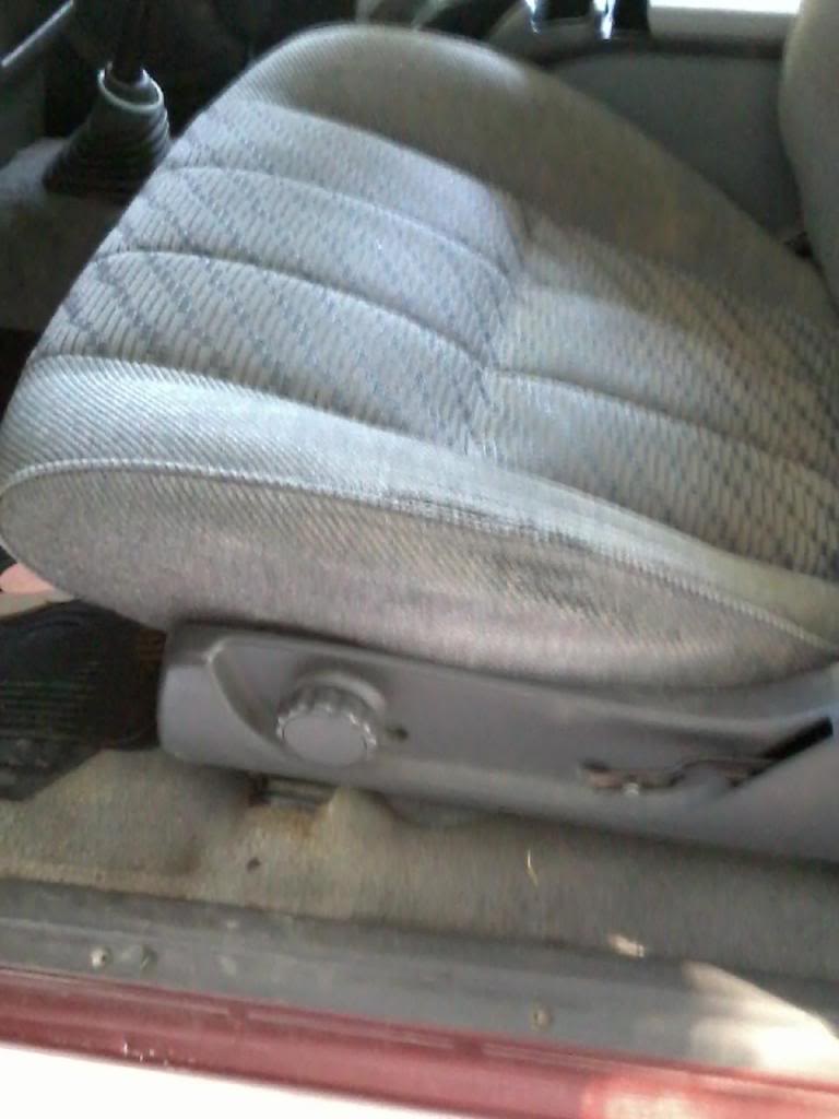

Hi Nervo, how you doing? On my 88 the seats just have tilt foward and backwards. As far as I know the 84-89 4Runner seats were pretty basic.
On my wife truck, I put 89-95 seats out of a 93 4Runner and they have the side support and butt support. This is only on the drivers side. The passenger side is basic, slide forward and tilt.
By far the 89-95 seats are more comfortable. If I could ever come across another drivers seat for the passenger I would get it.
I dont think the trucks got the same options but I could be wrong.
Back Support
Butt Support, round knob
Back Support

Thanks for the quick response. Maybe some Aussie member can send you a right hand driver's side seat.
I guess I'll hold out for some SR5 seats. The ones like yours are on Craig for $75 in northern VA. I'm confused whether 90-95 will slide if they are from a more common 4DR? My 11 year old already has a time getting in now, with 31's. Have to have the forward slide.
Hmmm. I already have a perfect set of '00 gray seats but they are in the avatar vehicle. I'm pretty sure they would be missed if I borrowed them!

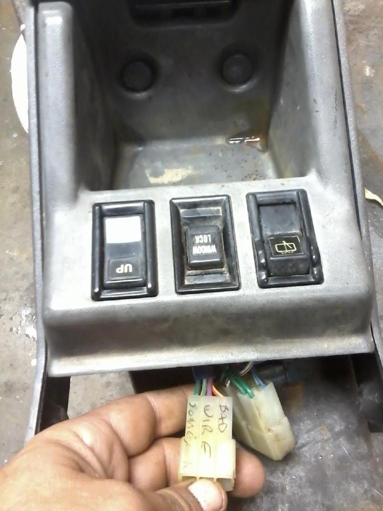

I must have made a wire loose on my rear window switch when I took out and reinstalled my interior. I Ohmed it out and cleaned it up and couldnt find where the break is at. I could move the console a little and get it working. Finally I just switched it out with a spare and got it working again with no problems.
One thing I have learned, even if it is bad keep it. I have been able to get things working before such as my headlight/wiper switch assembly and washer bottle. The switch is fixable and will work in a pinch. I did mark its problem and with time and patience I would eventually get it. Just put it back into my parts stack to keep it all togther.

Thanks Chef.. My transfer shifter was in backwards. I still took a picture of it and looking inside the case and when I changed the gear oil, I could tell it had water in it at some point. I knew this truck had been abused and neglected, and the tranny has been out with wrong bolts in it. Also had wrong bolts in the motor and I got them straightened out.
I still cant get it into Low Range. I even engaged the hubs and tried rocking it back and forth, drive a little bit and still no luck. 4 High Range and 2 High work, just not 4 Low. I didnt want to try alot of pressure just in case I would break something. My replacement works and will be getting it in hopefully in the next couple of weeks.
I have pulled trannys with cases attached and have done alot of 4 wheeling, but I am not knowledgeable about Tcases in any other way, shape, or form. I have a friend whose going help me replace the seals and swap it out when the time comes.
If anybody has any other suggestions about this Tcase and getting it in Low, I am all ears. I am still going to replace it just because I know its history. But I would like to get it working and cleaned out just so as I have a spare.
