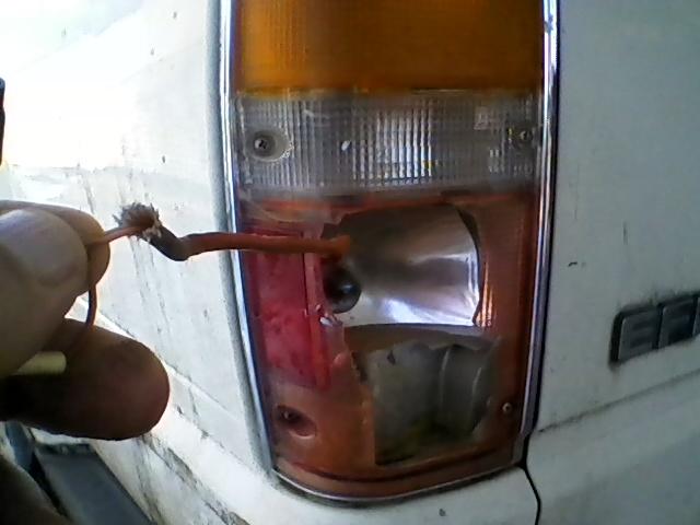

I want to get something done at least once a week, no matter how small it is. The PO had put holes in the lenses and used U-Haul lights. So I had the little guies to help on that.
