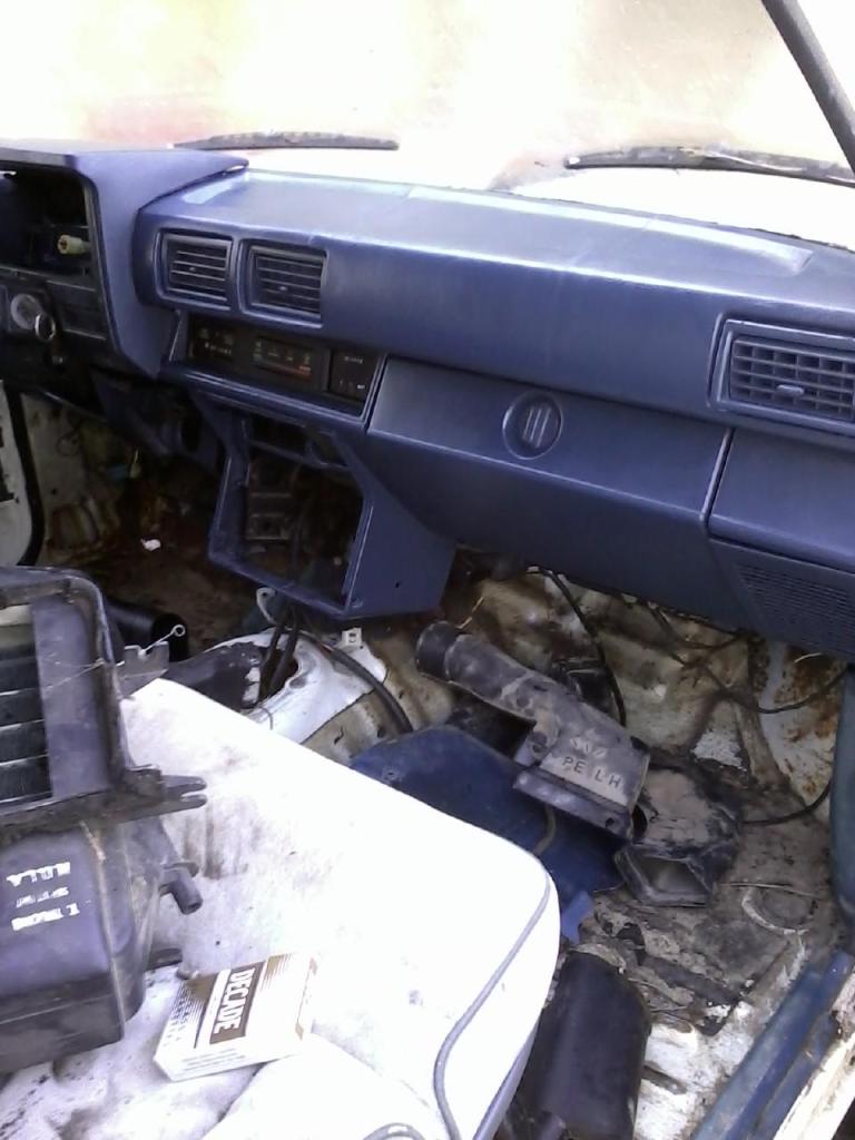

I got my dashpad installed. Unfortunately it all has to come back out. I have started to get it cleaned out. I will pull the seats and carpets out. Will leave the carpet out until I can get some new carpet in it. It was pieced together anyways and wasnt a good job at that. Still need to look at the fuse box wiring at it also. I will take the seats to the carwash and gve them a good cleaning.

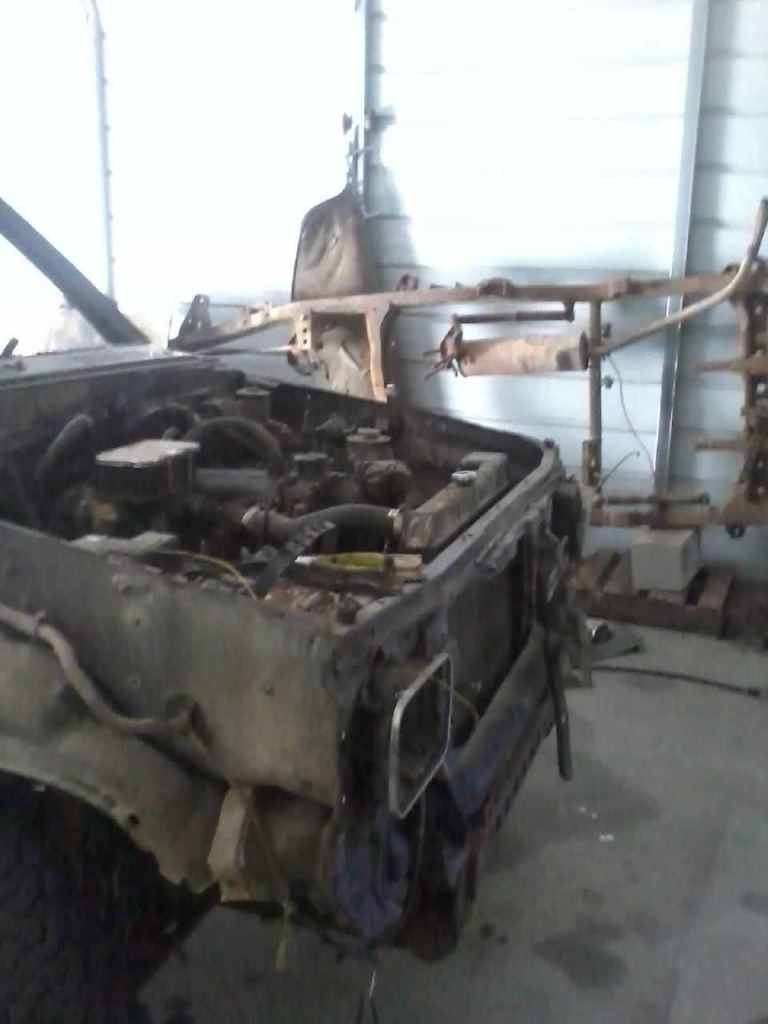

I have been busier then just on the 85 truck. I bought an 84 to fix and sell and then seen it was to bad to sell as a driver, I wont sell a dangerous truck. My brother really likes the stepsides. I orginally sold him the 84 and told him I would swap frames on it as it is bad. Then I got the title for the 85 extended cab and wanted it instead of the 88. I traded him the 88 pick up back for the 84 as I need the motor and wont have time to do a frame swap for a little while anyways. Further inspection show the cab is really bad and as bad as I hate parting a truck, I started parting this one.
He sold me his bass boat and a hot tub for a fair price and I sold him the 88 for a fair price. He wants me to fix the 88 up alot nicer then I would of for my self as I was just going for a nice clean stock look with my Downey bed. He will be getting the bed off of the 84 and I will be doing the Downy truck at a later time. I have nearly everything to get the downey truck built complete but it is on the back burner. I want to get my Runner finished more then anything but I need a truck worse at this time.
Back to my brother truck the 88, I will be doing the restore on it and he provides the parts. He has paid for it and has given me another $500 to start on buying what I need to do to it. Alot of that will be going to paint and getting the rest to the way he wants it. I had a tough time getting the bed bolts broke off as my impact gun was acting up but is workign great now. Just as soon as I get the bed ready for paint it will be getting done.
The 84 will be fixing two trucks, mine and his. You can see the frame in the background that I will use for the Downey truck at a later time, my runner comes before it. Since I have gotten over my tooth epsiode and the wife and kids go back to school soon, I should make some fast progress. I got plenty to keep me busy and it is funner spending someone elses money.
Bed that will go on the 88. Left of tire, you can see some plating.

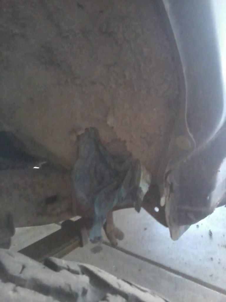

Started stripping. Frame and cab will be all that goes to waste. You might abe able to see where I am drilling the spot welds off of the core support for my runner as it was rusted really bad but was all I had at the time. Motor for my truck, runs GREAT. Downey frame in back ground.
Some of the cab rust. Some!!

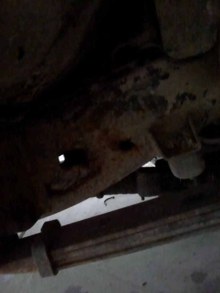

Frame rot and has been plated several times, even the front end is rotted.

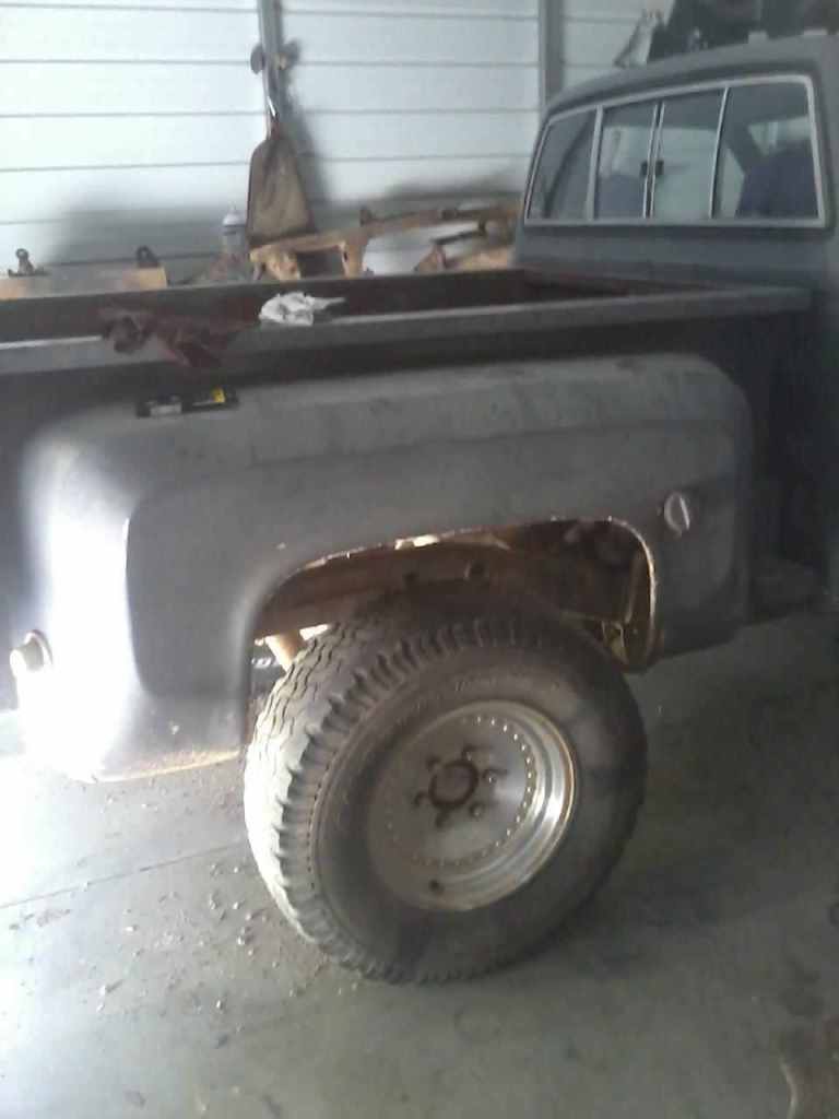

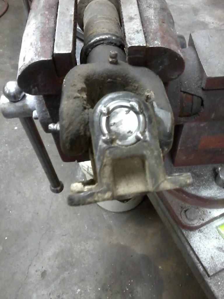

I have a U joint going out on Mistys runner so I thought I would grab a spare shaft and replace the U joints in it. This is a first for me. They welded the U joint in. I was wanting to just change them out and put the shaft in later today or tomorrow. The jury rigging never ceases to amaze me. It isnt much more difficult to do it right. Got some wires to straighten out in the fusebox area.

well at the very least they didnt full weld the cups in terry, a grinder should with a bit of careful work free things up an leave a clean paint able surface

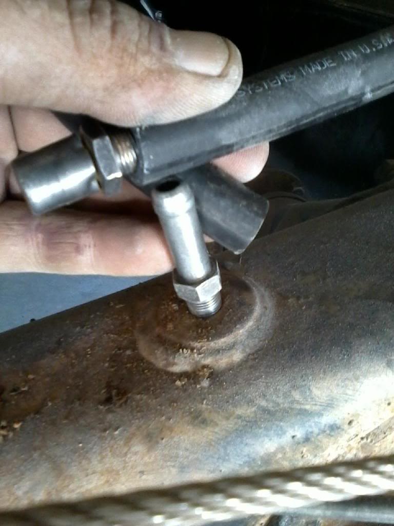

I was reding Chefs thread and forgot that I had done this on my 86 Runner. Will do it on the front diff as well and run it up to the fire wall. I have some "stickys" on how I do things on my projects and keep them listed on the first post of this build. A while back I found several Youtube videos and posted them thru out the build where they applied. Need to go back and add more info that I have found.
Diff Breather Extention.
22re Plenum fitting, 3/8th fuel line and the axle vent. I did use hose clamps but posted the pic to get the idea across. I ran it up to my gas tank which is higher then any water I will ever go thru. I have seen it ran up the rear tail light like habs link shows. Also it should work for the front diff and will eventually run mine up the fire wall or something similar.

YEP, YOU DID, ....thanks! lol.... I don't have an extra plenum port... but I GOTZ IDEARS! hahaha. Lots of links are popping up too. 4crawler put the breather end in (the rear, brake/rev./running light housing), too. Not a bad idea, really.... Neither is the Gas Tank!
The main thing I wanted to check is that mine is breathing fine, too... And I am TICKED at myself for forgetting to do that when I installed the 4.30's and locker... Not a big deal, easy to check/pull(at least on a rust free rig, right? ...I know, I know, we're spoiled! haha)...

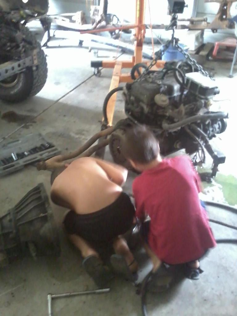

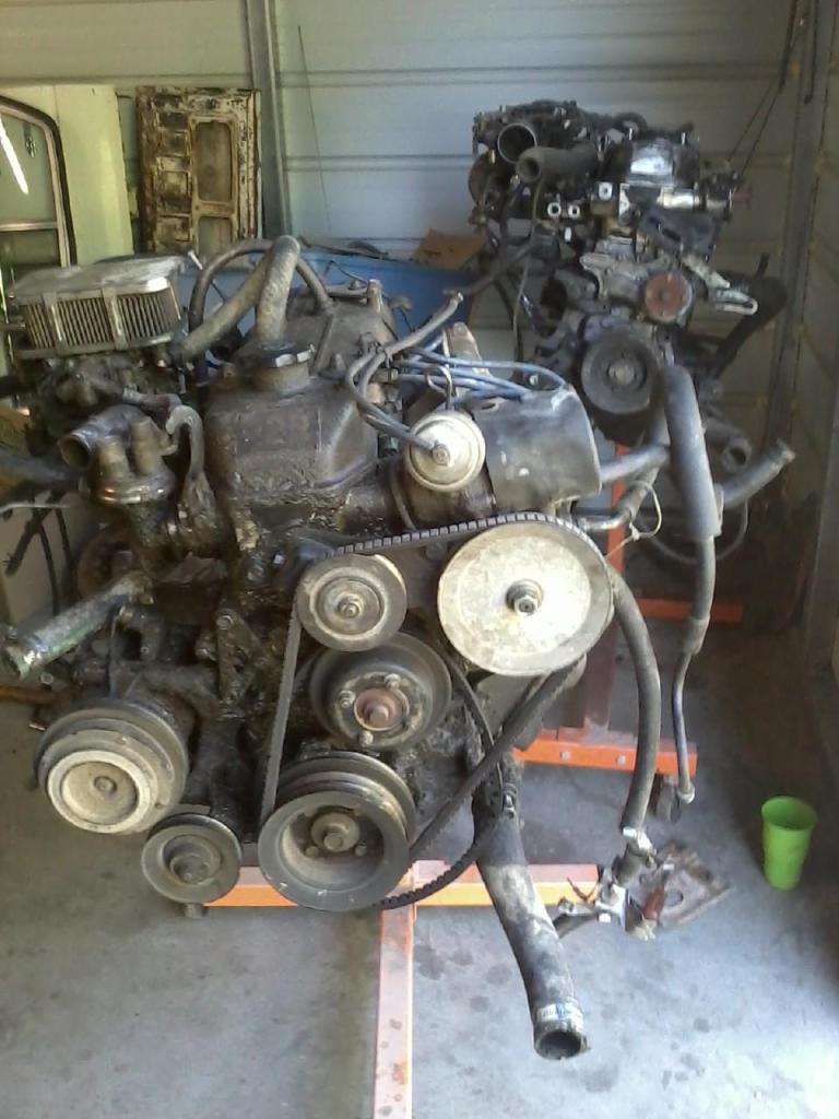

Did have the boys helping remove the clutch off of the 84 motor. Anytime I run the air tools they are there in a heart beat, then I conned them into helping me clean the shop afterwards. Got the 84 stripped. It isnt safe for highway use and it will be getting another chance as it will be come an offroad rig. The cab,frame and axles are solid enough for that and is getting a new home.
Boys helping.

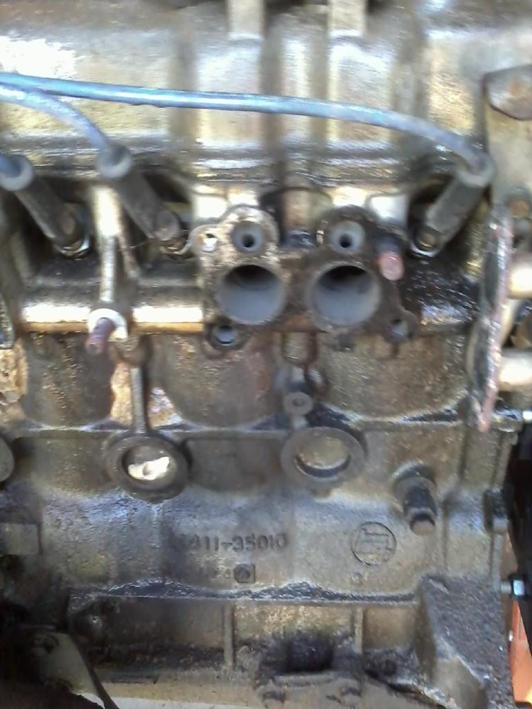

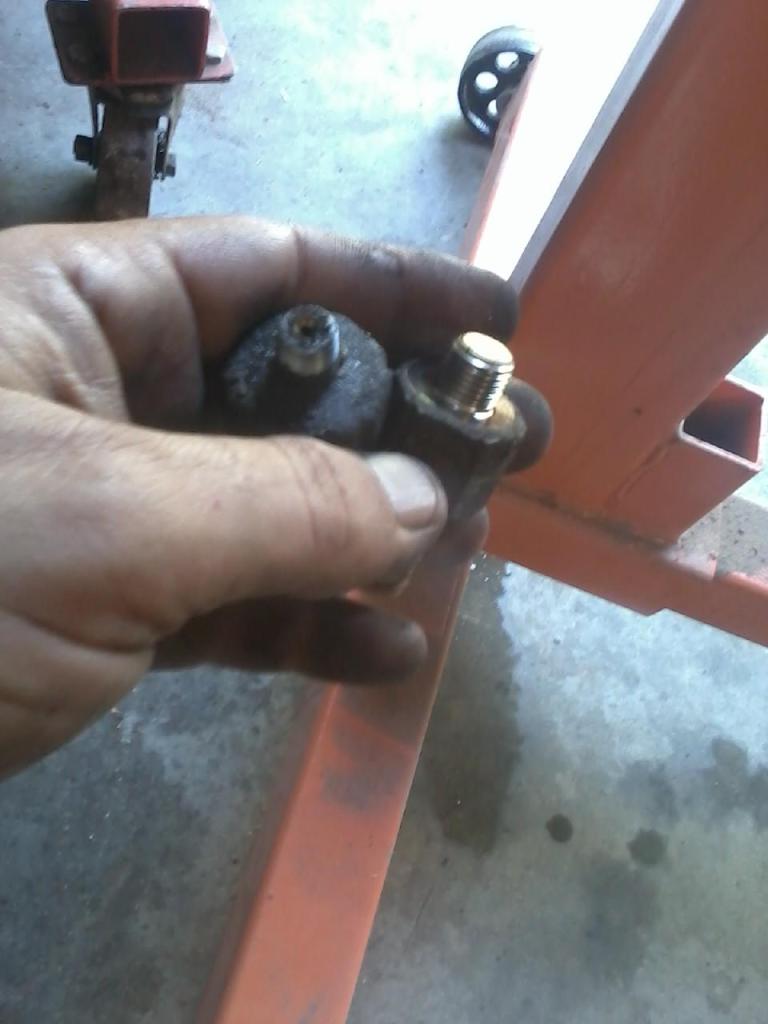

Some of the differences I have learned and have some on other threads that I will move to here. Pics of differences will explain alot to others that may be unaware. I was thinking 83 was the change in 22rs. Valve covers are interchaneable, but timing covers are not are some of the other things I know.
Differences in motors. Below is the 84.

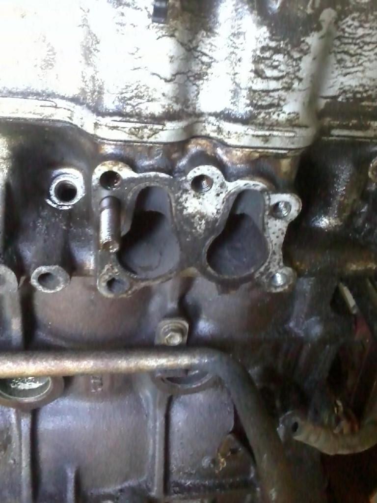

Round exhaust ports.

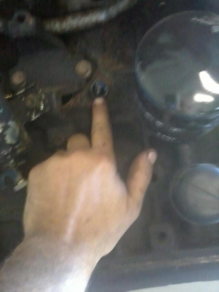

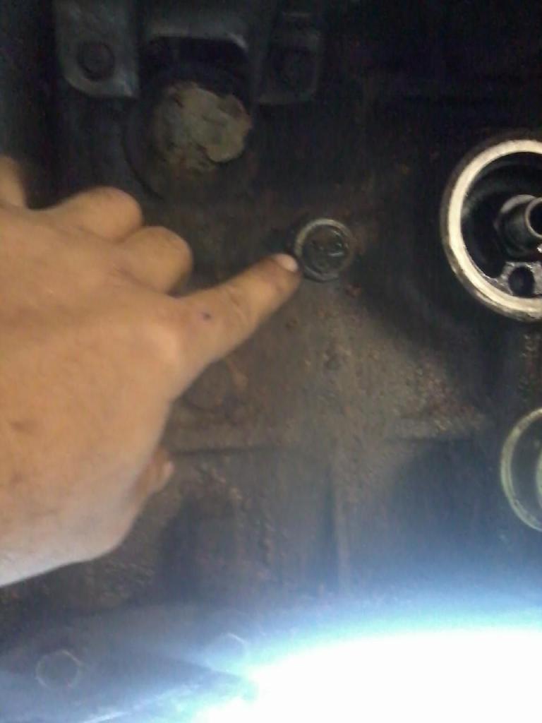

No place for the Knock sensor. The oil sensor ( probably not right as this motor had some poor workman ship on it)on this motor is in a vein that runs the lenght of the block. A knock sensor has bigger threads and sits about one inch higher. You can see the round flat spot that could probably be machined for knock sensor.
85 motor
Pear shaped exhaust ports.
Knock sensor has a larger thread and sits higher then the small oil sensor thread.
Thread sizes are different.

PS> I KNOW, it's not preferable or possibly even workable... But could you possibly use a thread adapter to slap one of the Knocks in? I would think it might interfere with 'resonating' sound/vibration... but maybe not? I GUESS it would not hear as much and adjust the timing to a possible dangerous level? Just throwing it out there... HAS to be a way to make it fit... JUST NOT SURE IF IT WOULD THEN WORK! lol.
#839
Hmmm, I swear I've heard of people mounting the knock sensor to the motor mount and not having any problems, ha, ha, never tried it tho, lol.
#840
the knock sensor is just a sound transducer a microphone tuned to hear a certain sound type long as it has solid metal which transfers sound nearly as well as water far better than air it will work
