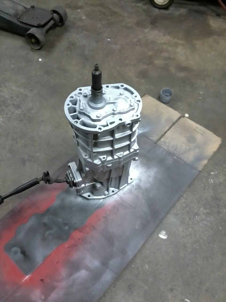

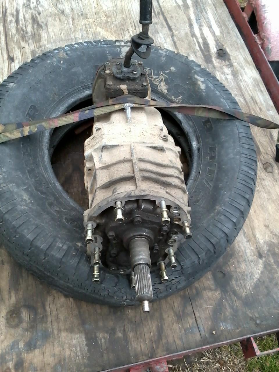

Got to searching Craigslist and found one. Supposed to be good, but you never know, didnt ost to much so feel it is worth the risk. The guy I got it from has a perfect interior and told him I was intrested in it. Will have to wait and see on that one. I also looked into an 84 cab and frame. It is rolled and stripped of the bigger parts but has a PERFECT dash and pad in it. It has other parts that would make it worth the $100 he wants for it.
Next tranny I am going to try as soon as it warms up.

I got the 88 running again. Saturday, the day that was warm and I had a chance to get the new tranny in. It isnt as quiet as my orginal tranny, but it isnt noisey either. I am ging to start looking into seeing what I can do about rebuilding the orginal tranny. I am thinking the input shaft might be bent and I might be able to just swap it out with the tranny that has the bad 4th gear in it. These things are getting so hard to find.
I have only driven it around the block asn still need to get the power steering hooked back up and the hood back on. Looks like Wednesday I will have a descent day to get it wrapped up, but will have to wait and see.

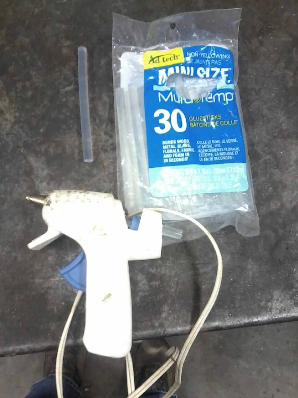

One of the kiddos bumped the plastic on the rear heater and cracked it, it is brittle being 20 plus years old. I usually use a 2 part epoxy, but a guy I work with has an electric glue gun. I think this is one of my new favorite tools and seems to work great. I hear they really arent to expensive and for the plastic that is used in these trucks think it will be a good investment.
Something I think that will work on the plastics for these trucks. Time will tell.
