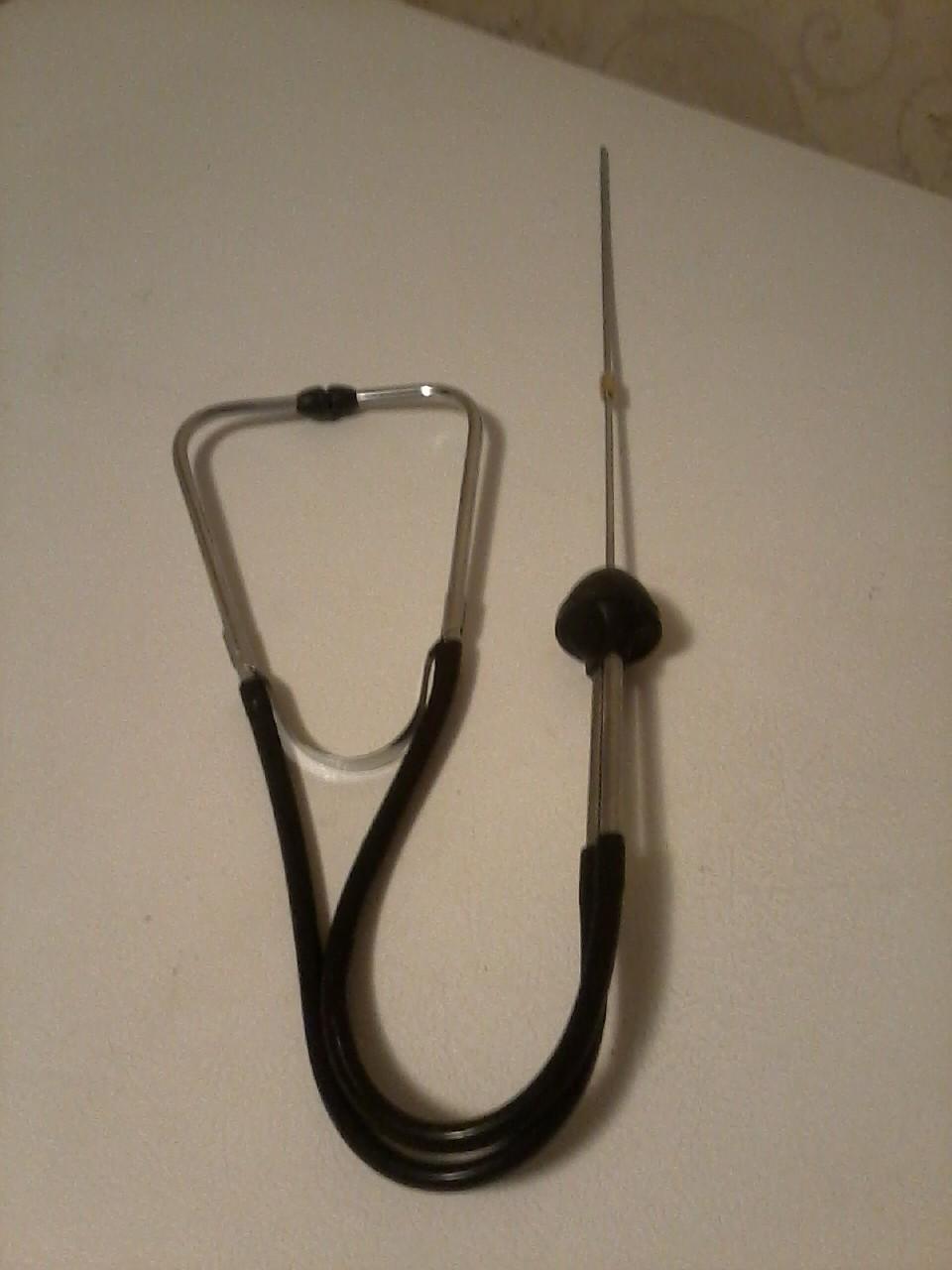

I didnt realize this thread had gotten moved up, the runner has been running great. Once I got my shifter cover on I havent noticed the whine, but since I know it isnt as quite as it can be, I will still eventually change it out, most probably wouldnt mess with it but this truck is my fav. Really using this runner as the bar for my 86.
The weather just wont warm up for very long at all and when I have gotten a few days I have been trying to make the most of it. I know I have one or maybe two lifters that need to be readjusted. I bought a stethoscope to try and make sure I get the right one and will check all of them whennn the weather warms up.
My newest toy to start looking for any other kinds of noises. Will start looking for noises on the 86 as well.
