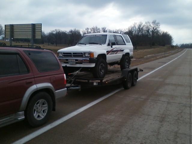

Cherry Manifold, urgh!!!! I have more time spent on this then I care to admit to. I finally decided to send it to Toyota and had high expectations of getting it fixed. One thing they did find that I probably would not have was the connector to the AFM had a pin not seating correctly. Toyota did get it running better. After I picked it up from them, I took it for a drive and it was dark enough that I popped the hood and it still had a glowing manifold. By the time I got back to Toyota, they had already closed. I left the runner in their shop with the key in the over night drop box and will be calling them in the morning and seeing what they say. Really want this truck back on the road.
On it way to the shop. The fix will be easy, it is finding what is wrong with it. I will say after talking to several other mechanics in town, Toyota had me feeling the most comfortable with them. Some of the other supposedly mechanics had me concerned on changing hub caps.

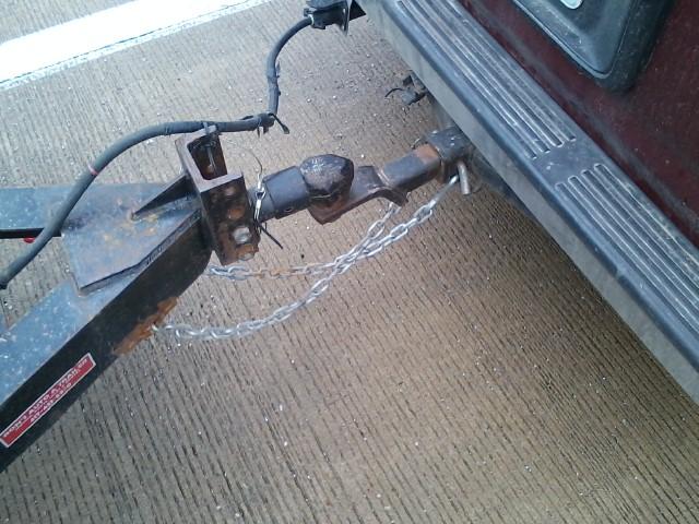

I have to rent a trailer when I haul a truck. The trailer rental place I use, one of the employees mentioned to me that in Oklahoma, ( I live 10 minutes from Oklahoma) that you have to have the safety chains crossed or it is a $75 fine. Supposedly if the trailer comes off of the hitch that it will land on the cross and not damage the pavement. I have been pulling trailers for years and never heard of that rule or reason. Not sure if other states have some crazy rule like that but thought I would mention it.
Cross I am talking about.
Old Jan 12, 2015 | 05:41 PM
  #1256
Cyberhorn The Dragon's Avatar
Joined: Jul 2012
Posts: 2,365
From: Idaho
crossing the chains is new to me terry now unless its a NEW law all the trailer towing sites dont say anything about crossing the chains
http://trailers.com/state-laws/oklahoma.html
http://drivinglaws.aaa.com/laws/trailer-hitch-signals/
Old Jan 13, 2015 | 06:02 AM

Crossing chains is pretty normal up here, but dont think theyre any laws about it Kinda of a personal preference. I prefer that if the trailer came off, that it drop the ground to slow down, not swing into my bumper/tailgate as I try to slow it down.
Old Jan 13, 2015 | 06:22 AM
  #1258
crashburnoveride's Avatar
Joined: Dec 2012
Posts: 613
Likes: 33
From: Lincoln, NE
+1. I was taught to always cross chains.
Old Jan 14, 2015 | 04:29 PM
  #1259
Terrys87's Avatar
Posts: 11,787
Likes: 28
From: Anderson Missouri
Hello Cyberhorn, rattlewagon, and crashburnoveride. For some reason I have never thought of crossing chains and really don't remember anybody in my area crossing them. I do see the reason for the cross now. I still am not sure which way I will go. I am open to other reasons.
I will say that about 15 years ago, I had a trailer to come loose and it was straight chained. The trailer dropped to the grounds and did drag but did no damage to pavement. The only damage I did get was an exhaust pipe got bent a little but nothing close to any major damage at all.
I have not seen the ball that had the bolt that run thru the center of it in years. It is the old style ball and not even sure if you can still find one now a days. Today the ball and bolt is all formed into one piece. The top of the bolt snapped off and let the bolt fall thru. When it came off, I just slowed down slowly and when I got to walking speed, just moved to the shoulder. I think you are right that with it crossed that it would/could slam into the bumper or other areas and do more damage then what I sustained. That was all the experience I have with a loose trailer and all that I want, lol. Just something I have never really thought about but am open to other suggestions.

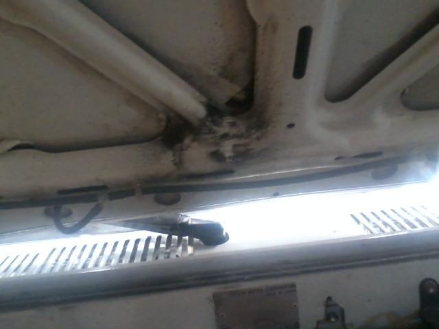

I may finally be on the downhill side of my Cherry Manifold. I took it back to Toyota and they looked a little deeper and said that I had an EGR problem. I wanted to do the work myself as not sure what they would charge to do the repair. Up on further inspection, I did see some carbon on the hood. I did find a loose bolt holding the EGR to the block.

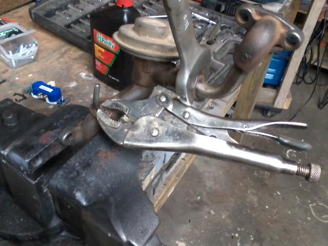

I went ahead and took the EGR off to give it a cleaning and check to see if it was function. By creating a vacuum on the port on top I could hear the plunger operating and with a vacuum on the plunger, I could blow air thru the EGR. That has always worked for me in the past to test an EGR.
I have posted earlier in this build thread or one of the others but for some that may have missed it I wanted to show how to remove one of the pipes that gets clogged and can be a bear to remove. Also the elbow pipe that attaches to the EGR and Plenum can snap if not careful. I use a wrench and gently tap the wrench with a rubber hammer until it breaks free.
We are getting sleet and the roads are getting a little slick so could not drive it real hard to see if I get a cherry manifold but I drove it 9 miles and had just the faintest glow down where it connects to the Y pipe. 10 times better then what it was doing.
Getting the screw out with a screwdriver will just strip the screw. Get just a good enough bit to break the screw loose. Also tapping with the rubber hammer on the wrench as to help break the elbow pipe loose.
