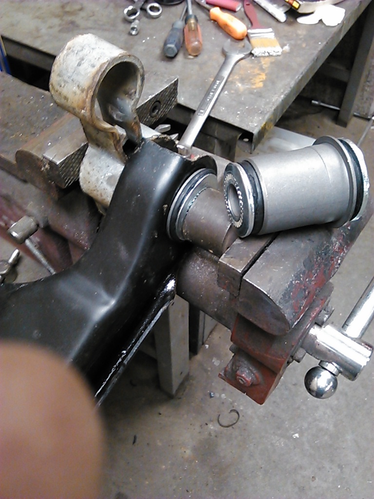

Got the rear tires on her truck today so she is good all the way around and she is liking how it rides with the new ones on it. It has always rode nice and I really didnt think it would make much improvement but it did help some.
I ordered two bushings from partsgeek.com, I thought ordering 2 was 2 pair, Instead I got 2 bushings. Urghhh!!! I got the bushings in and am waiting for then other two to show up now. Pressed them back in and it went well.

Hey terry, nice work,those bushings look like a bear to replace.

Hello Chris...They can be a work out. I still need to get them on. It will hopefully happen soon.

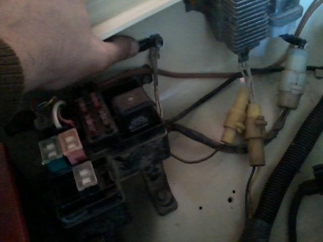

She went to work the other day and got the click, click. I have replaced the starter contacts, cables, battery, cleaned the starter relay contacts, and new cables. Ray has run into this issue and I talked to him and he showed me that the starter circuit runs everywhere instead of straight to the starter. I did his upgrade on my 86 and neverh ave gotten the click only start again.
I did the same thing on her truck and it fires up each time now.

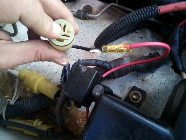

Another electric upgrade I got from Ray was to run the battery ground to the headlight ground. It has to help to shorten the path for the headlight ground. I just extended the battery ground to the headlight ground. When I do one upgrade to one truck, I try and do it another truck. I got it done to my 85 and will do it to my 86 runner later on.

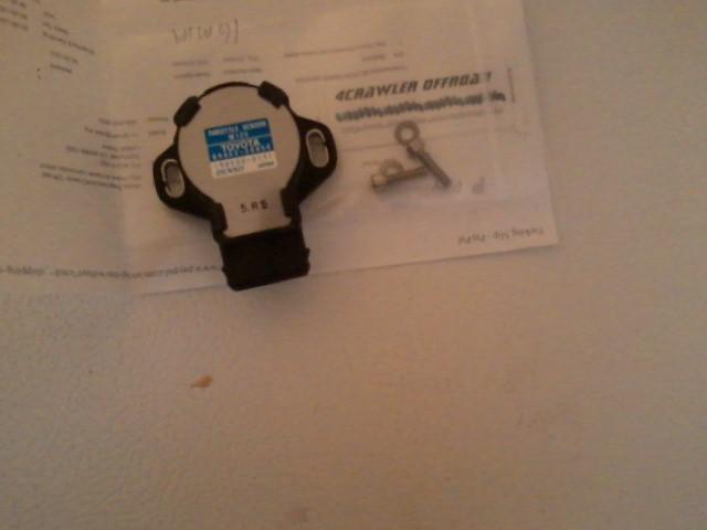

Misty has been driving the 3rd gen as her leg has been giving her problems and I am still working on some idling issue with her runner. I have several old TPS and some test bad and the others are just worn out. I learned on the 86 extra cab I did a while back that it is just easiest to replace the TPS. It is a pain in the rear to get it set correct but her truck has 320k miles on it and I am sure the TPS has millions of cycles on it so just ordered a new TPS.
I also ordered the allen screws from 4Crawler and he shipped them fast. Even before I was able to exit out of my email to him, I had a response from Roger. He is quick with responses and shipping. I would highly recommend him. Looking forward to getting the TPS on my next days off and hope to get her runner back to normal.

On my "new to me" 89 4Runner - I am amazed at how many issues can be solved by correctly adjusting the TPS. I just did mine and got rid of a hunting/surging maintenance throttle cruise, improved my fuel mileage and I swear it even helped my transmission shifts.

Hello Mark.. I am hoping to get to the TPS this week. I have tried to adjust one in the past and some make it sound easy but it isn't for me. I really am not liking the TPS. I am hoping it solves several issues for me as well. Her truck has 320k miles on it and I am sure her old TPS is just worn out.
