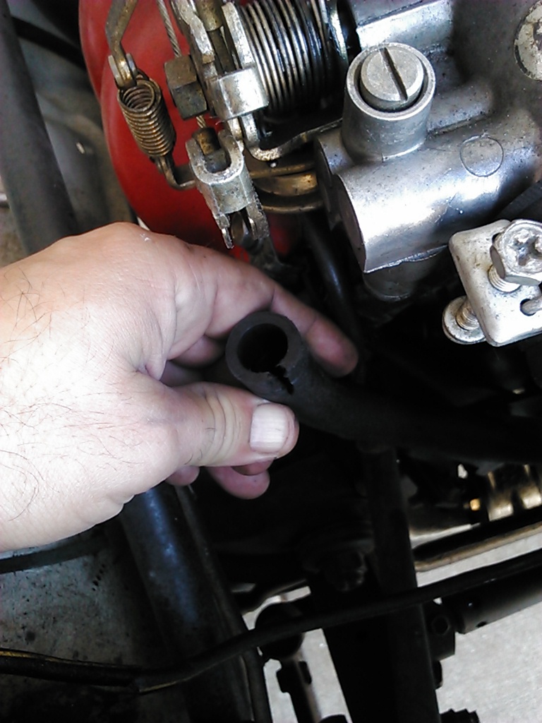

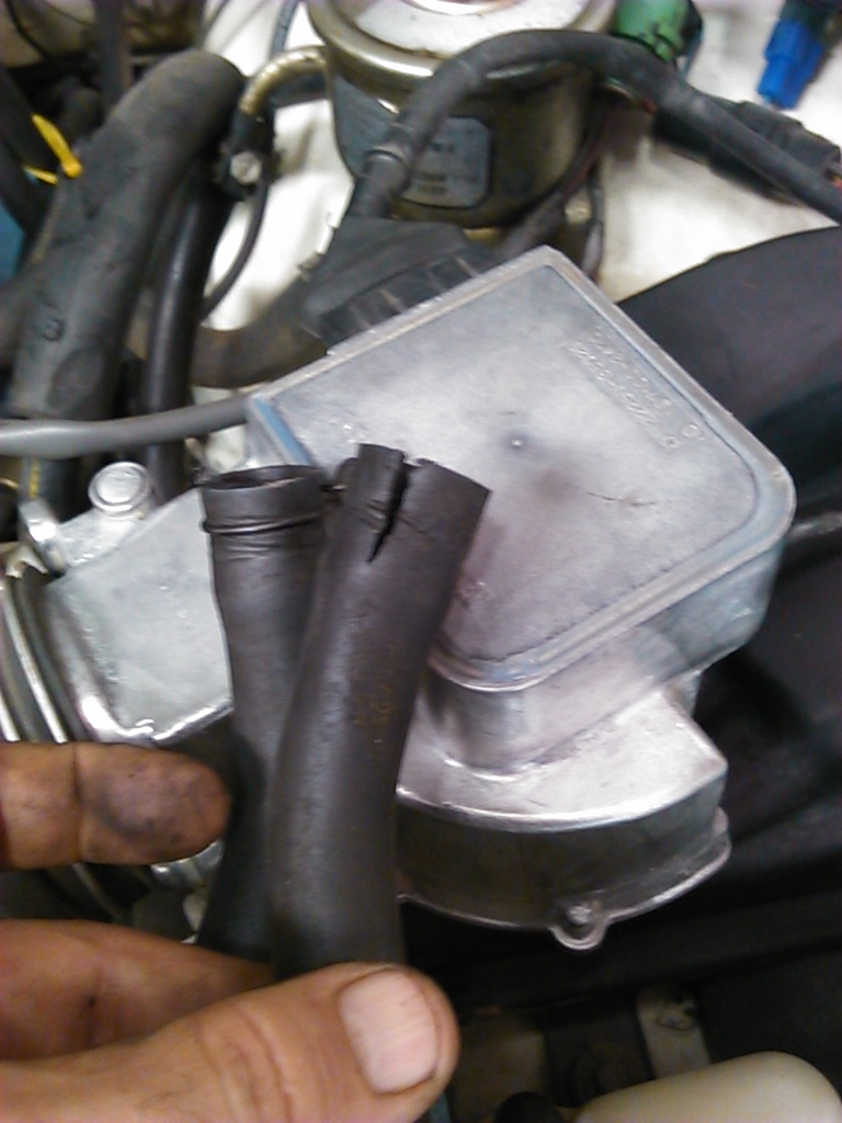

I may have found the problem. It has a cracked hose and had slid down far enough to let the gap be bigger.

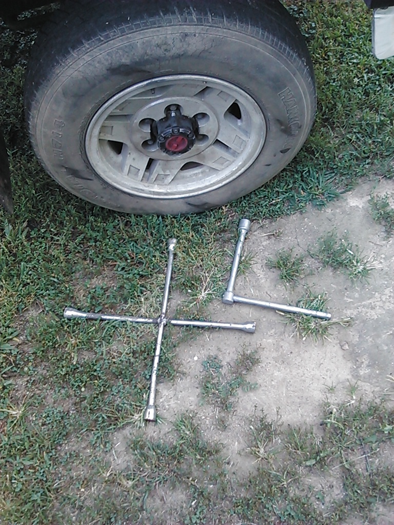

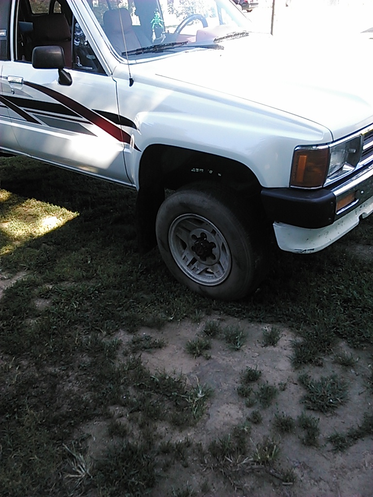

And the joys keep coming. Coming home from work I ran over something and slashed the side of the side wall and ruined the tire or it blew out but not sure which, luckily I was only going 20 mph when it went flat.
I was telling another member awhile back that I keep a 4 way wrench inside the spare tire and he liked that idea. This time I was glad to have a 4 way as the lug wrench Toyota provides just doesnt give you enough leverage to break some of the nuts. Using the wrench Toyota provided I could not break one loose. I also keep a jack in with the spare tire. One in the tire and one in the normal storage location. I have 2 spare jacks and just to get them out of shop that is where I keep them. When keeping a jack in the spare, I just wrap it with a trash bag to keep it dry. This jack worked great on the road.
With a little creativity you can keep a jack and 4 way under the spare and make it work. You can get smaller 4 way wrenchs that would fit in better as well.

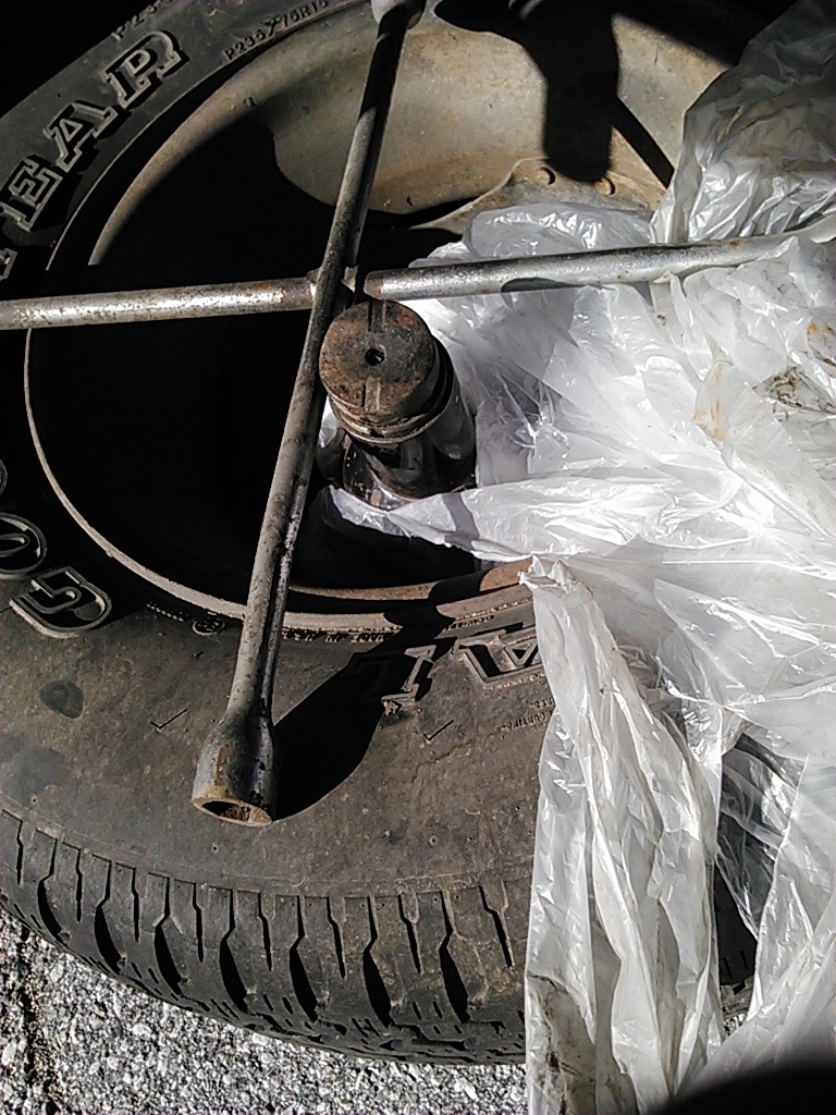

Dont be a dumb butt like I just did. I have spares for both runners. Luckily I was the one driving Mistys on the way home. The rim I had is a 6 bolt and I just assumed it was for a Toyota. The center of the wheel would not go over her hub assembly. I do about a month or so make sure they have air in them, but never checked to see that it actually fit on her hub. I had Misty to bring my runner and had to use it for her spare.
The lug wrench on the right is what comes in Toyota tool kit and just not enough leverage. I will add the 4 way under the spare tire to my Tool, Tips, and Tricks.

Sorry for your misfortune terry. Glad you didn't get hurt having it happen an a higher speed.
I like the idea with the 4way and jack.
I started carrying a 1/2" drive 18" breaker bar with the appropriate socket a long time ago.
Never had any luck with the factory stuff

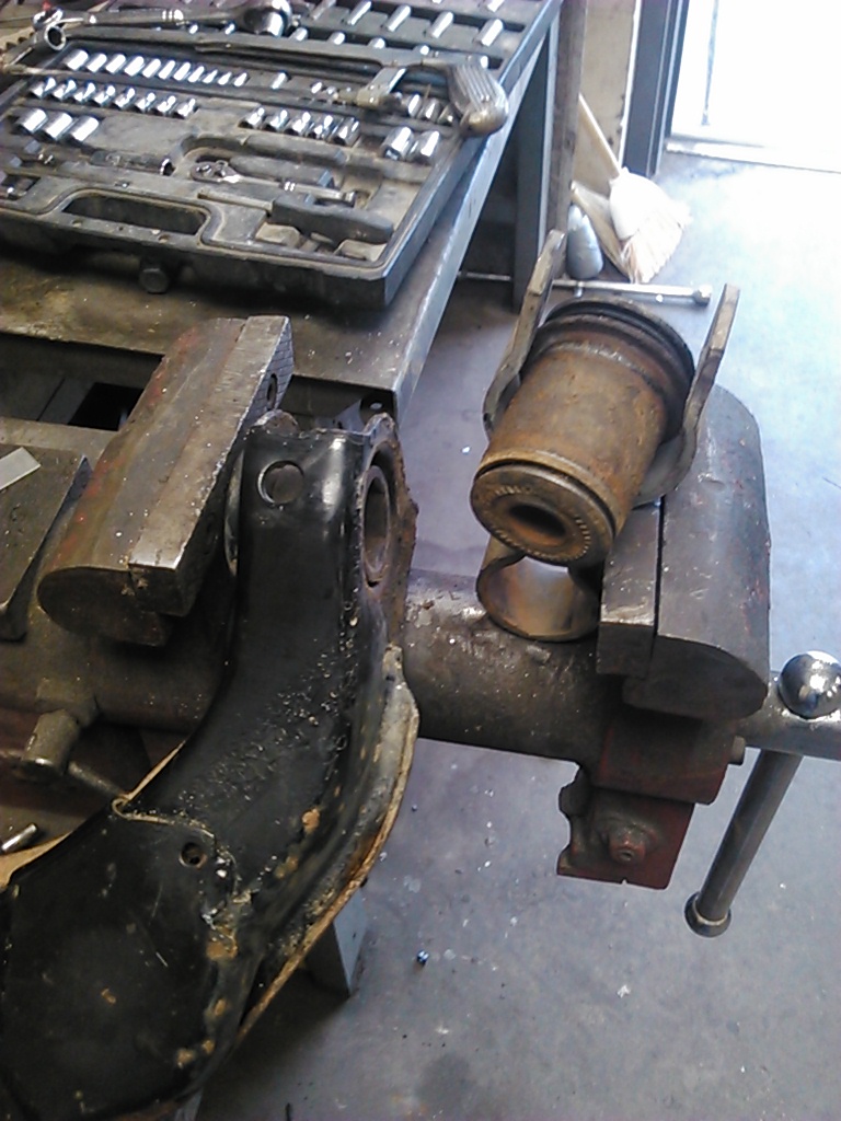

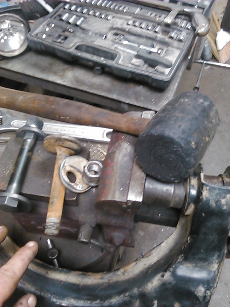

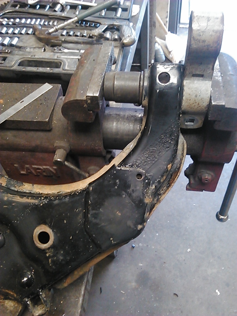

I am learning slowly about doing the bushings on these trucks. I have done some in the past but not on Toyotas and it has been so long ago. I have a spare set of Lower Control Arms so am doing what I do know. Got them cleaned and start pressing out the bushing. Eventually will be going on Mistys Runner.
Here I used a socket on the small end of the bushing to press it out. I used a socket on the small end. I dont have a socket large enough to cover the big end. I used a Chain Link Fence piece as a spacer and I can see what is going on.
After tightening the vise, I would hit the moving end of the vise with a rubber hammer to help tighten it and then tighten the vise again. I should of soaked the bushing with PB Blaster, that would of helped. I seen on the net where some burn the rubber out. Here is where a press would be nice but I used what I got.
Bushing is out. Just 3 more to go. Redneck engiuity but it worked. Socket is in the bearing holder.

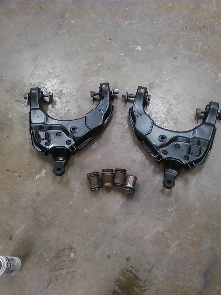

I applied pressure to the bushings and would start getting the bolts cleaned up and just while I was away, a couple of times the bushing just popped right out. Just letting it sit and time doing the work it was an easy job.
I had about an hour total in getting these bushings out. I will keep the old bushings and throw them into a 5 gallon bucket that I keep small junk like that in and eventually haul it to scrap. You would be surprised at how quick some of this scrap stuff adds up. All that goes into the shop or a build. Got the Lower Controls Arms ready. They say pressing them back in is easier to do. I cleaned the bushing holders with some sand paper and I think I will add some silicone to help them slide in. I have some Energy Suspension Bushing somewhere that I need to find as I have been reorganizing and now cant remember where I put them.

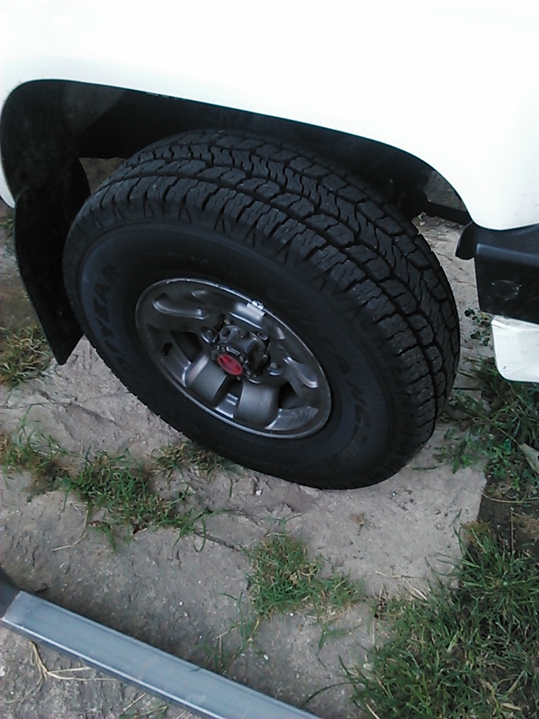

We went and put a new set of shoes on the front end of her runner. I was trying to hold off right until the early winter but her tires were getting worn. I got them from WalMart, and I normally like getting mine from Sears but the nearest Sears is quite aways from me. They have the warranty and since I only live about 20 mile from their headquarters, I have Walmarts everywhere. They only had 2 tires so will get 2 more this Friday.
Tomorrow I have to go 100 miles to get an injector harness for my 85. I do a lot of traveling at night and have gotten my warranty worth out of WalMart. I ruined 2 tires on the 3rd gen not long ago traveling at night when I hit a piece of angle iron.
Since the first of the year she has gotten a new clutch, O2 sensor, AFM, 2 tires, and I am going to let her have all of my front suspension parts that I got for my 86. Since the first of the year hers has been getting in better shape and it is starting to really starting to make a difference. It has always been descent to drive and it is really making mine feel that much worse. Mine will catch up soon to it. Just want to get the 85 moving.
New front shoes. Wranglers 31's.

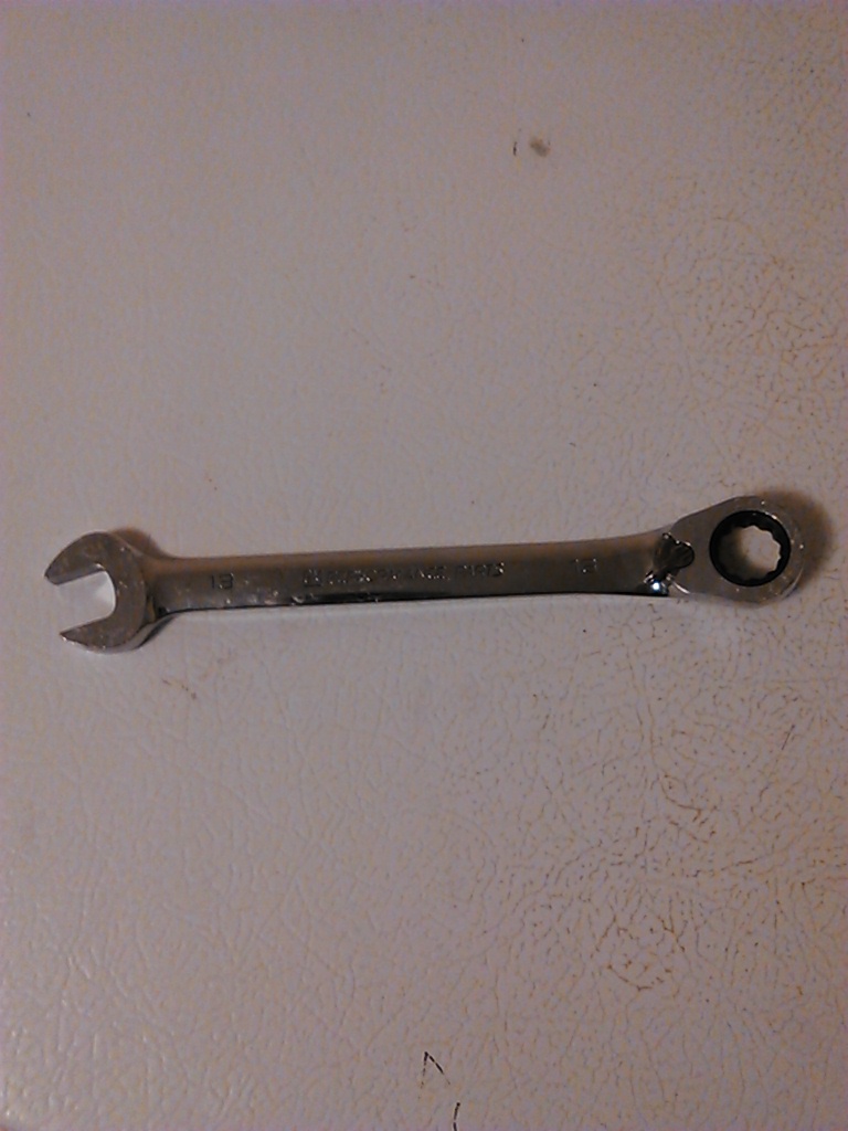

I found this on the road. One of the tools that is on my wish list. It is the ratcheting wrench. I just bought several 13mm wrenches a while back and that is what this one is. It has some scuff marks from sliding down the highway and is where I found it. Misty was wondering why I was stopping and was thinking it was just a cheap wrench. It is a GM Performance Parts wrench. Now if I could find my scuffed up welder, chop saw... lol, Works Great!!!
