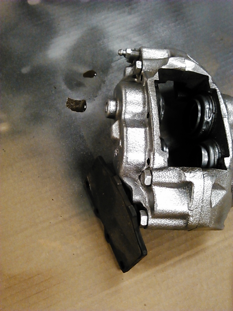

I was cleaning the shop and had a spare set of calipers laying around. Something told me I should just rebuild them and have them ready to go for spares. I blew it off and sure enough, I could of used them. Mistys runner was making some brake noise and it was just needing pads. I got the passenger side swapped out in 5 minutes. The drivers side, I could not get the pistons to collapse so had to pull them off and work with them in the vise.
I finally got it to collapse, but I don't have that warm fuzzy feeling about them being in the best shape so will get me a rebuild kit and hopefully get them done this week end or sometime soon. I got them changed just in time as the pads were paper thin and all wore down evenly so was happy with that. I don't think I have ever changed the pads on this truck and if so it has over 49,000 miles on it since I have gotten it running so guess I cant complain on the brakes. I really don't have to do much maintenance on it other then the usual.
Paper thin brake pad left on it and cleaned up the one caliper I had to pull off. Will rebuild both calipers soon and when doing that will finish fixing a few dings in her rims and paint them a darker gray.

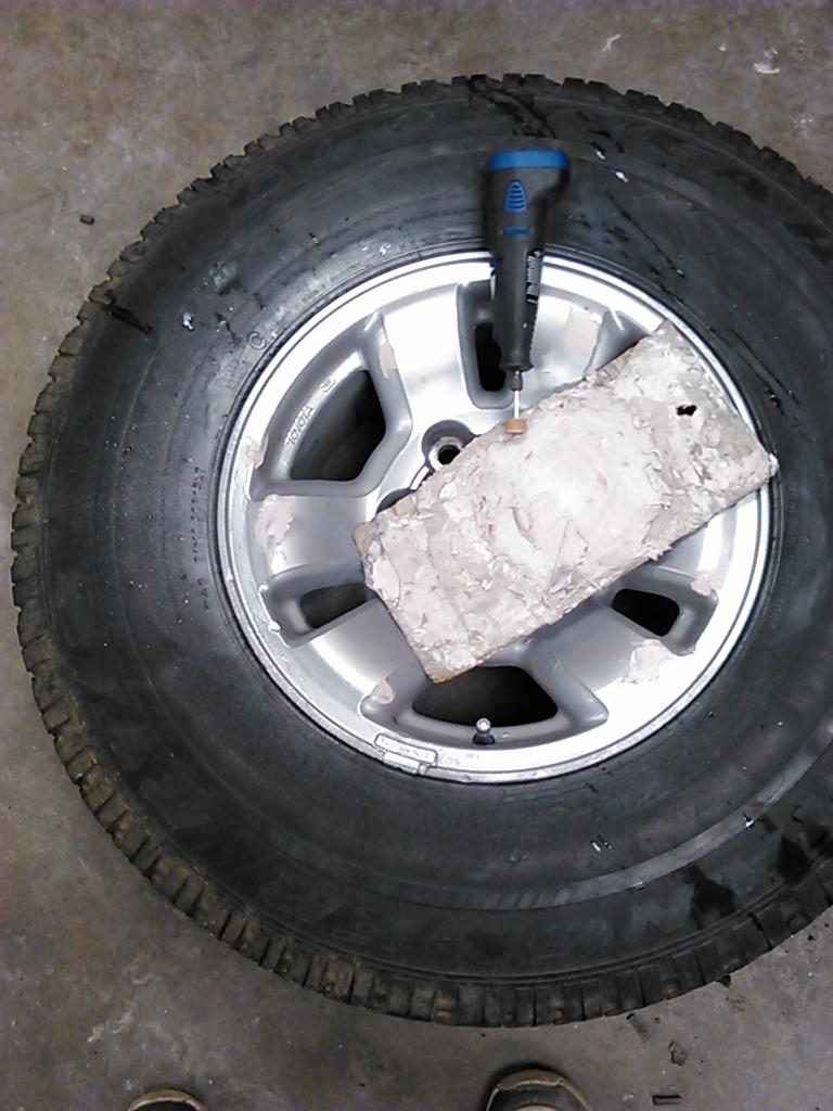

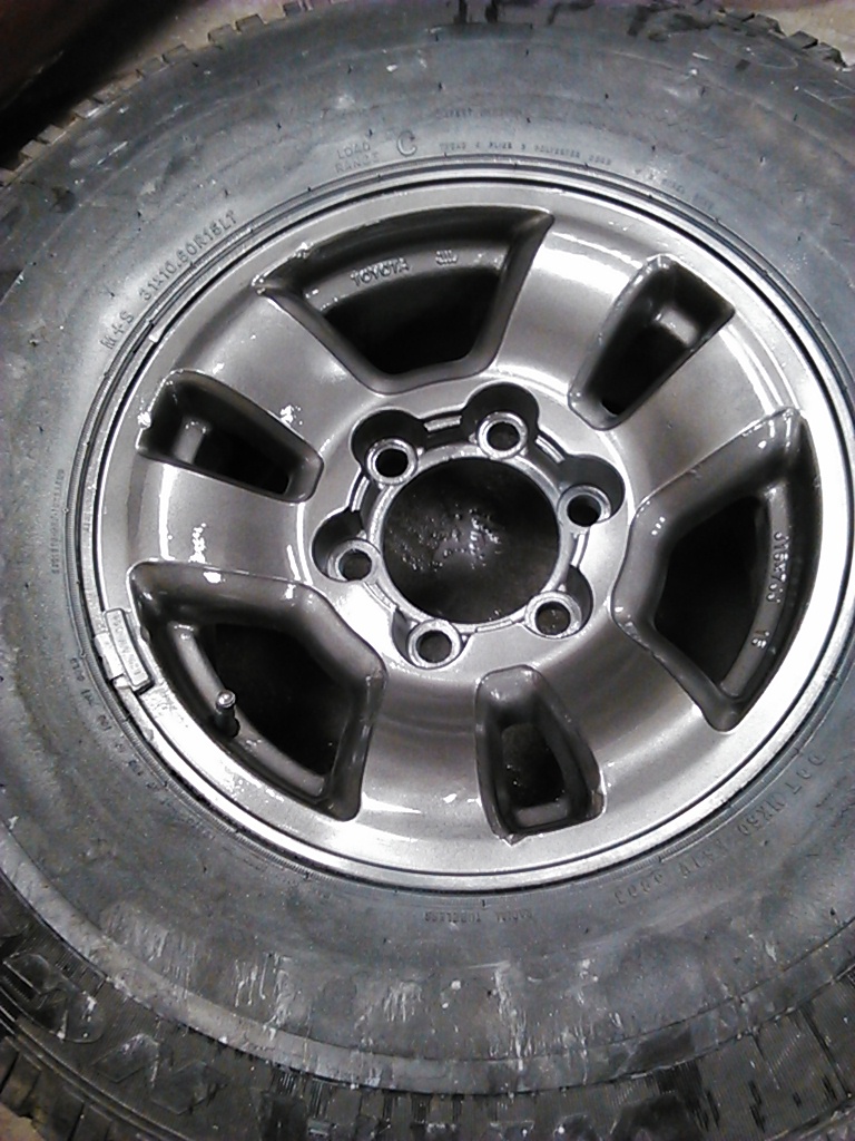

I started working on getting her rims looking better. They are in bad shape. Here is what I thought was similar in color but is darker then what I thought it would be. I will see if I like this when it is back on the truck. The last color was to silver I think. Looks better in person as what looks like blemishes is light reflection.
Showing some of the damage. I ran out of 320 wet sandpaper so had to finish it up from there. Will get some more paper and finish what I didn't get to complete.
