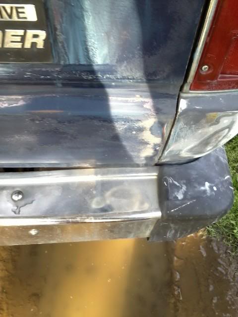

It might be a bit longer on painting this thing. I have an oppurtunity to split the cost of a 4Runner with a friend that would have several parts I dont have and would pay for themselves real quick. It is rusted way beyond any repair. I hate parting one out, but there is no saving this one. There will go the painting money. Will have to wait and see.
I do have another issue to work on. The rear bumper is bent in. I was going to take this off when I paint to get better access to the lower side. I will find something to keep working on.

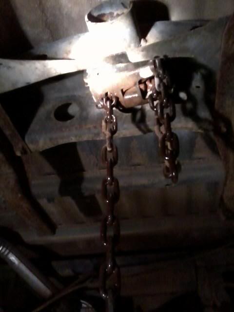

Have been busy for awhile. But I did get a couple of things done. My Spare Lift Assembly wasnt working so spent quite a bit of time getting it cleaned up and it lifts great now. Cleaned it and oiled it real good and run it through several cycles.
I worked the tire down a couple of links by going back and forth. Then I was able to get a pry bar and compress the spring that holds the tire and work it through the center of the wheel and let it drop. After that I soaked it with PB Blaster and started working it with my jack handle and until it broke loose and cycled several times til it was working great and then oiled it heavily.

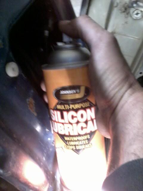

Been working on the dreaded Tailgate. I oliled all of the metal tracks and cleaned all of the gears. I think the best thing I did was to put Silicon in the tracks and that made the biggest difference. The motor was reall struggling to get the window up. Works like a champ now. Realy would suggest spraying your tracks with this stuff if you are having problems.
Just got to get my switches working. I am going to replace the relay box behind the Drivers seat and think that will have my rear window working again. I am currently just hot wiring the window for now.

Looks good! Re: your spare tire assembly, how the heck did you get the spare off in the first place? I'm in the process of cleaning and painting my under carriage too and tried to put some PB Blaster on it but the spare is jacked so close to the body I couldn't get to the top part at all. I'm thinking of cutting the chain and piecing a new one in there.

Hello Nervo... It was a pain to get to the tire assembly. I took a small can of WD-40 and got it as best as I could. Then I was able to lower the tire low enough to pry and pull til I got the tire out of the way.
It was still a bear to operate but I was able to get it with PB Blaster and let it soak for a few days and after that I kept working the assembly til it worked its way smooth.
If you can get the tire out of the way, there are 4 bolts that I think you could get a wrench in between the frame and body and get it out. It would be a slow process.
On a pickup, when I have the bed off I take it out that way and let it soak really good.

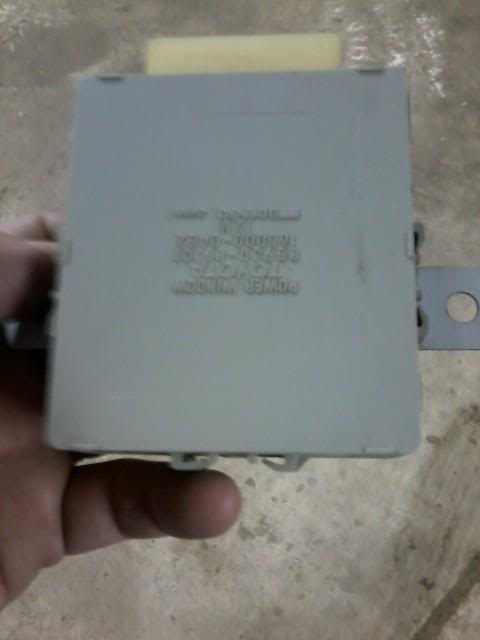

I made some progress on my rear window. I replaced the Window Relay switch and had the rear wiper working and the window would go up. I have been checking all of the wires and connections.
Everything was going great, until I tried to roll the window down and that is where things have stopped. I can hear the relay click when I push the up button, but nothing on the down button.
I would like to think that maybe it is the switch. Dont know if I could be so lucky. But I have another switch I will try and see if it works. That would be great. Getting closer.

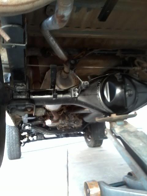

I have been saving to go in with a friend on a rusted up 4Runner and I could use several parts off of it. We are going to look at it today or tomorrow. So for my cheap progress, I have been cleaning the underside.
I get part of cleaned and then I rattle can prime then paint. I eventually will be working under there and geting things cleaned sure make it easier.
Too bad I didnt have a before picture.
