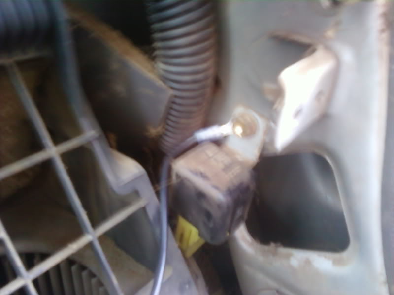

heyy glad to hear you got it fixed. on the relay. the only one i remember seeing on the passenger side was this one.
it was above the ecu hidden by the dash

Twisted.. What I found when looking on YT, that it is located above the ECU. One I seen showed a bigger box that was lime green. But guess they could of changed it to a different style. Got me curious as to what that relay goes to. I might try tonite to see what it is. I would like to have a more indepth fix for this, for others to use.

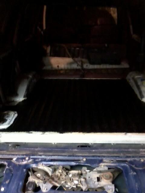

Trying to get caught up on some of the things I have gotten done lately. I did the Duplicolor bed liner in the back. I want the truck to be quiet inside so I just did the trunk area. As soon as we get out of this rainey season. I want to pull the seats out and give them a good cleaning and get under them with bed liner. After that I plan on putting sound deadner insulation in on top of the bed liner.

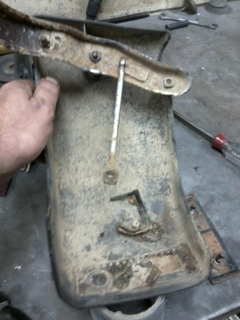

Here are some of the parts I have been working on. May not look like much, but the rust has slowed me down. I will eventually replace the end caps, but for now I will make them work. I am wanting to get this truck painted soon. But needed to get the parts truck as we got a good deal on it.
The washer bottle pump is not good.
The bolts broke when taking it off of the parts truck so had to cut these brackets off to work with mine. Still not ready. Maybe tomorrow will be a better day

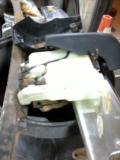

Got another cheap fix. The washer bottle in the pic above wasnt working. The PO took the pump out of the original washer bottle.
I put this one in and with the key on, but the motor not running, I would hit the water button. Nothing happened. I could tell power was going to the washer motor as the dash lights would dim and the amp guage would move. So I knew it was getting power.
I was going to buy a new bottle and pump from the bone yard and figured I had nothing to lose. I had tried tapping on the motor with a wrench and it did not do anything.
I then ran a wire from each terminal of the battery to the connectors on the washer bottle. They will have two male connectors.
I switched polarity a couple of times and on the 3rd try, the pump motor started whirring. Plugged it in and filled with water. Everything works great.
