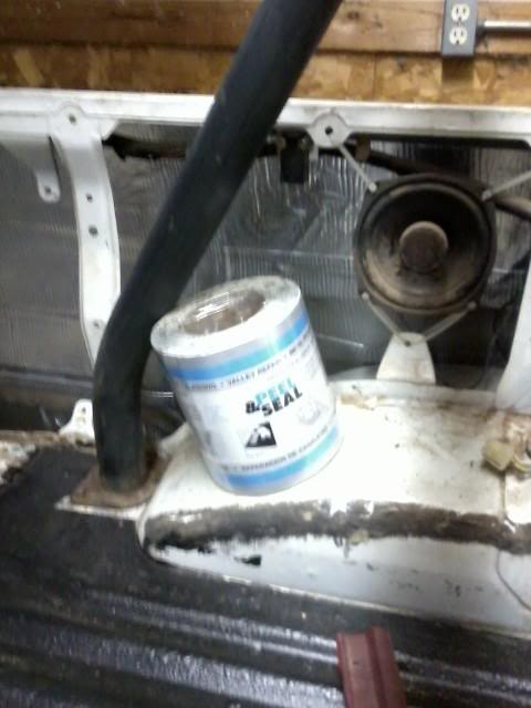

I run out of sandpaper today, and besides I need to gt some finer grit for the finish sanding. So guess it worked out. I wanted to get something done so I got some peel and seel and got the drivers side done for the most part. Dont know how much quiter it will be since I have the top off. Found out about this on someone elses thread.
One roll wont quite get the whole side done if you go this route and I got it at Lowes. I had to call 3 different stores to get it. Not all of them carry it.
Above the roll of Peel and Seal is one of the safety switches that could keep your window from working. How about that high tech speaker mount? It is from the PO.

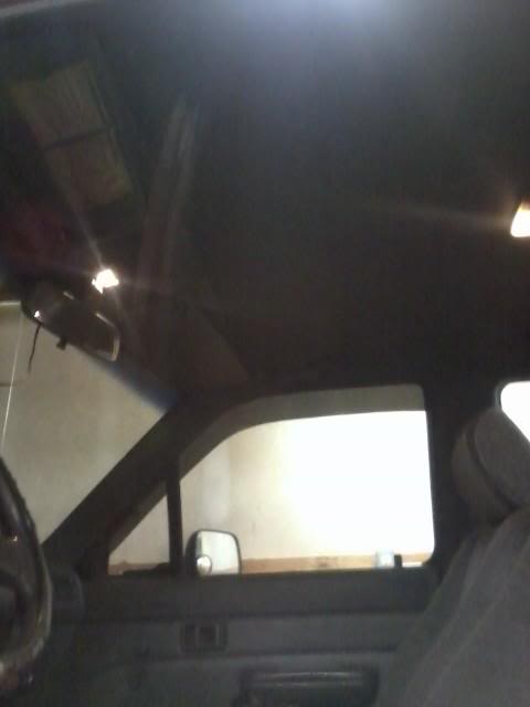

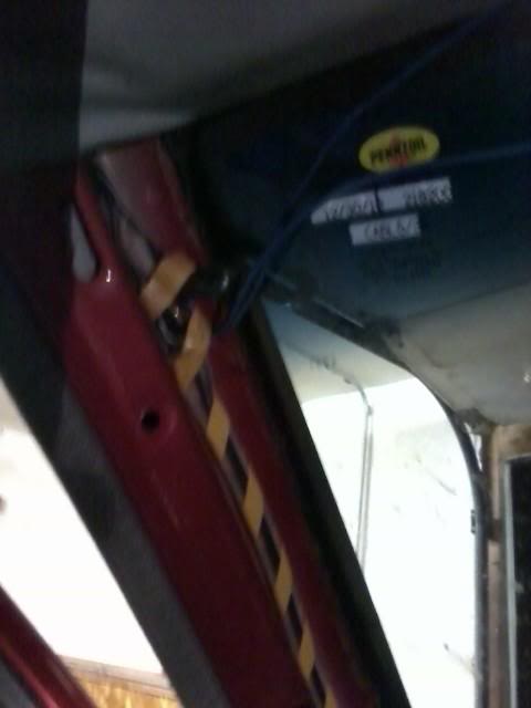

I actually did this awhile back to my wife 91 Extended cab, and sure it would work on a runner. I will eventually post this in the cheap upgrades. But just now got around to getting it wired in. Took some investigating at a salvage yard to find the wire to tap into.
I got a dome light out of a Standard cab out of a salvage with the same interior color as my wife truck and mounted it in to where your mirror is. I just drilled a small hole to run wires along the windshield to the driverswindshield post and poped off the trim.
There is 2 wires that run along the post that I tapped into and soldered and taped up. Get the plug to the mirror and about 3 feet of the wire out of the donor truck and screw in. Easy and cheap upgrade. The dome ligh on a extended cab and 4Runner is behind you and doesnt light the floorboard up and that is where I am usually trying to find my things.
Front and Rear Dome. Not the best picture, but gives you the idea. Door and On Light work.

Where I tapped into wires.

I might have to steal your dome light idea. I was already thinking I'd try to throw a better bulb in my dome light because it's horrible, but your dual dome lights idea is way better.

Cool idea Terry and clean doesn't look just slapped in place, great job as usual.

The dual dome light works great. I am trying to find a standard cab one for my Runner. Wish I would of thought of it earlier. It more useful and you dont have to reach over your head to get to it. Really used it alot this weekend.

Thanks.. I tried to make it as clean as possible. Watchout for the dripping solder. I had blue jeans on and it still was a little hot.lol, But it peeled right off when it cooled.

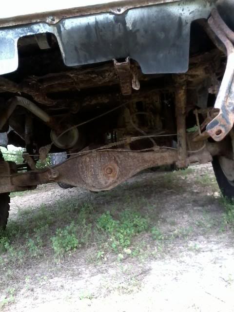

Had a good few days off. One of them I spent stripping parts of off a rusted out 87 4Runner. Hate scrapping one, but this one the back end was so rusted it was nearly in two. Did get plenty of parts and wasnt much left. Even the rear axle wasnt usable, except for the third member.

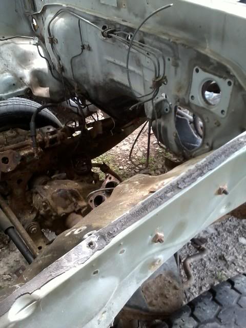

Here is how well we stripped the front end.

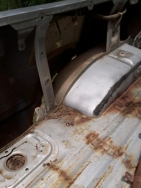

Here is where the back would fold up and down. This thing is tripped.
Here is a pile of parts. I have quite a few from aquiring things in the past and have them organized really well, I will get these also. My friend need the motor and some odds and ends.
