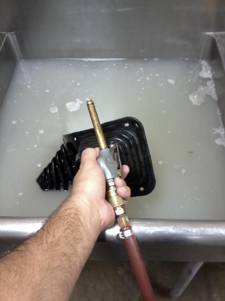

Just thought I would post a pic of my hi tech parts bubbler washer. In a pinch, I have even used a 5 gallon bucket with some detergent and an air hose. It actually works pretty good. Just hold hose and part under water. Just thought I would post this in case some one might could use the idea. Patent NOT Pending.lol

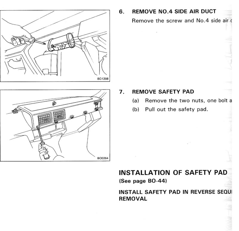

Dash Pad Replacement.
I am currently replacing my dash pad and will update my post on this as I go. It is fairly easy once you know the steps.
1.Remove Speedometer Bezel and there is a 10 mm nut that holds the left side of the dash pad in.
2. Take out the far right vent on passenger side. Mine cracked bad as it was brittle.There is another 10mm nut that holds the right side of the dash pad in.
3.Take out the glove box. 2 screws at the bottom, holds the glove box in. There is a black strip that has a cover attached to it. Just take a flat blade screwdriver and pop out the little tabs.
4. I will get a picture below but there is a little screw that holds part of the ventilation pipe in. Take the screw out and slide the 4-5inch vent pipe out of the way(first picture). Straight above it, there is another 10mm nut that has to be removed.
5.You have 5 screws at the bottom of the dash pad that you have to take out and it is done.
With the dash pad out of the way, it makes it easier to work on the heater control assembly. Mine is broken and it is still a pain to get to.
Notes for myself.
Black cable goes below heater core.
White/clear cable goes along top of dash to right side.
Blue cable goes to assembly under hood through firewall.
Great link to dash pad removal. https://www.yotatech.com/forums/f115...emoval-189633/
Great Thread by nvdesertrunner. https://www.yotatech.com/forums/f115...emoval-263039/

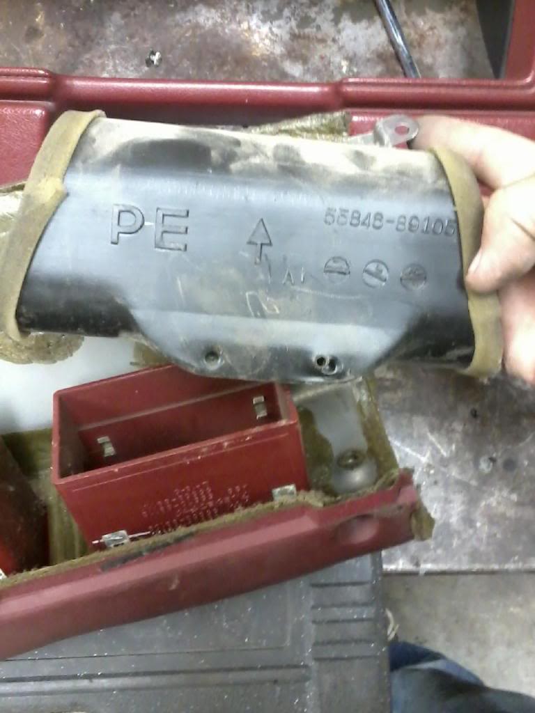

Duct that needs removed to get the center nut of dash pad. Once you remove it, straight up is the nut.

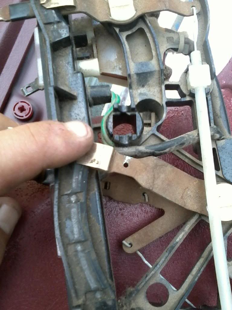

Most likely broken part on heater control. Once the dash pad is off, there is a single screw that holds the double plastic vent that needs to be removed to make a little more room to get the heater control assembly out. I pulled the whole assembly and cables out together making sure not to get any sharp bends in the cable. I was able to pull the cables from the right side and then the right side of the assembly and the the left side of the assembly and then left cables.

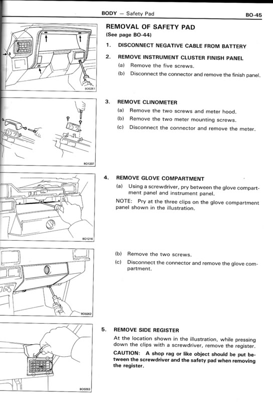

Factory Manual.

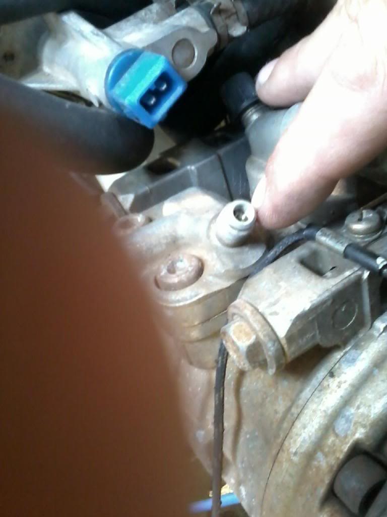

Been looking into my air conditioning and am wondering it if it has the right compressor on it. There is no way of getting the connections on it as it is now. I am going to see if I can mount it in a different position.
One finger shows the one with a missing cap. My other finger shows the other connection facing rearward with the cap on.. I have never worked on this compressor my self, so am hoping it is just on wrong.

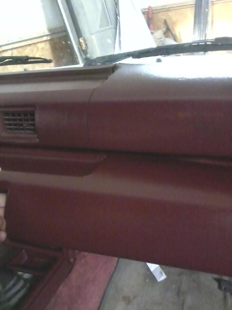

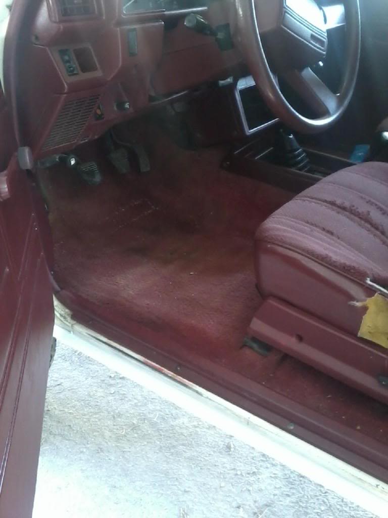

I was asked to post some interior shots of what i had been working on. No matter how hard I try, I cant keep the glare down???
Once I get new carpet it should make a big differnce.
Drivers Side, I painted the Plastic on the seat, Drivers Kick Panel, Steering Column and horn button. Will be replacing Steering wheel with something better at a later date.
Center, I painted the Dash Pad, Shifter Console, and trim that goes around stereo
Passenger Side, I painted the Door Sil,Kick Panel,Trim on seat, Nothing else was painted. Dash, Speedo cover,Main housing for stereo, Door Panels, Glovebox and Steering Wheel has just been Armoralled.

Could I get some of you guys to post pics of how your air condition compressor is mounted. I am trying to find the "Show off your Engine" thread and havent been able to find it.
Chef, I looked through your post and on your post #2502, both of your fittings are facing forward. I still looking for more pics of your compressor.
I am hoping maybe I can mount mine in a different position. It still has freon in it and some pressure, but maybe not enough to engage it.

PS> that looks completely wrong, dude! lol. Both high and low side face forward.... and I can't see how it's even hooked up if it's reversed... maybe it's from a transversely mounted engine? Must be, cuz the way the High side is set up, it's basically opposite of the low side, .... 2 gnarly allen bolts hold in each valve on top of the compressor.... both inlets face forward. You have to be able to change schrader valves, etc., ...and that seems IMPOSSIBLY with that set up. Better pics, maybe, for us?
