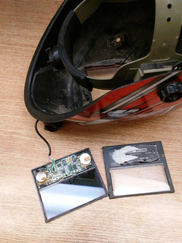

We were practicing welding and the auto darkening stopped working. I did some Youtube searching and the solar power does have batteries. I have had this helmet for a long time and it sits in the dark and the batteries finally died. The Youtube video showed how to replace the batteries. I am going to get some battery holders with an On/Off Switch and mount them inside the hood. I will get the switch from ebay or my local Radio Shack if they have them.The batteries are 2032 and require some soldering to make work. It seems to be working again.

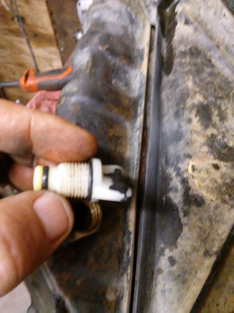

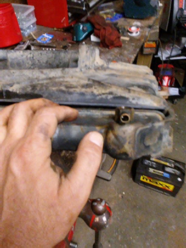

I have a radiator leak. One thing I have fixed many times on these radiators is putting an O-ring on the valve. I have never seen one on one from Toyota. It is the bigger O-ring that I installed.

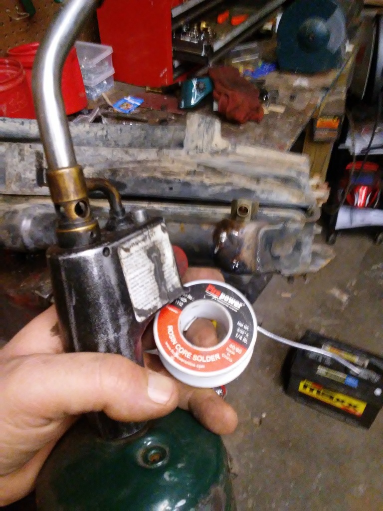

I have never soldered a radiator to fix a leak. You may not be able to see it but it is a small crack.
Here I tried to use Rosin Solder and a torch to seal the crack. I am hoping it fixes it. If not I will send to the local radiator shop where they can flush out a radiator. If I were keeping this truck, I would suggest having these radiators professionally flushed as these get a lot of build up in them. I have seen flushing drop the temperture gauge by 25%.

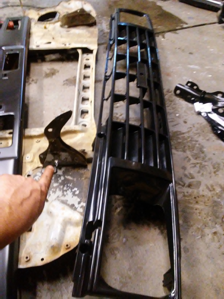

I got my bumper, brackets, and grill in. Getting the spot welds off of my replacement Core Support is being difficult as the spot welds go thru three sheets of metal. My spot weld cutter is having a tough time getting thru the spot welds.

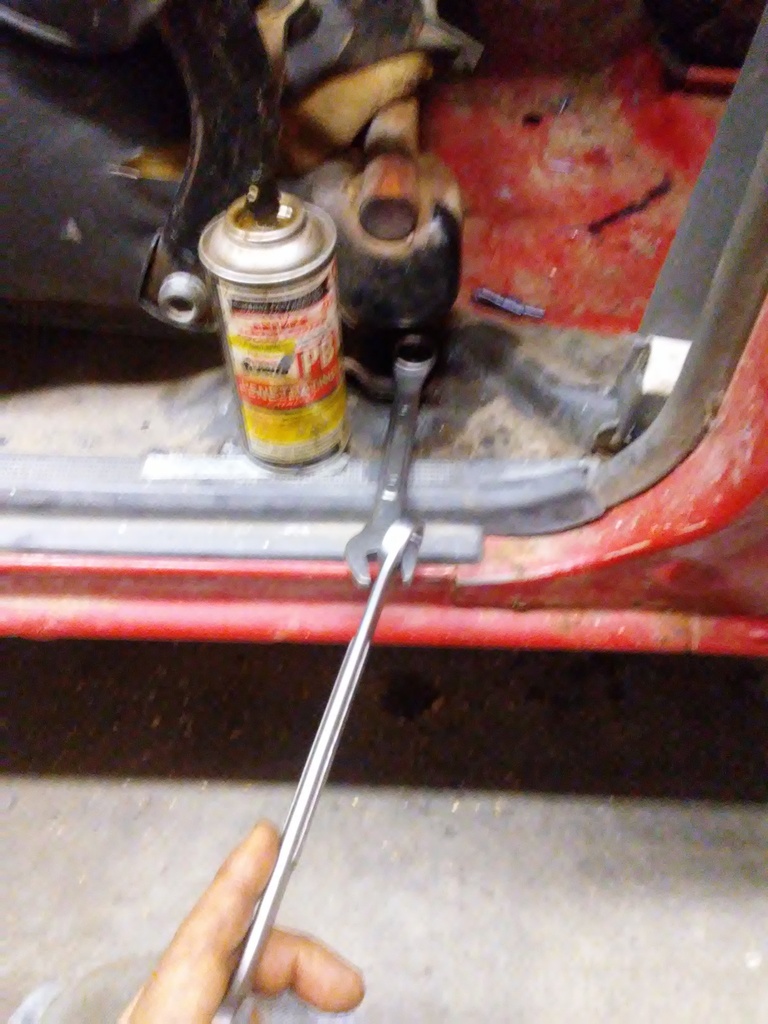

I have snapped a few HF wrenches doing the lever trick, there is more meat on the other side if you can cope with the bend on the closed end. Using a brass brush on the outside of the self tapping bolt helps get the gunk off and better penetration for the lube.

Thanks CO 94 PU...It was a work out and I was finally able to get the lever to operate that I was able to slide the seat up and get access to the passenger side. It was a pain to do. I have already wore out a spot weld cutter and been trying to get to the other side. It is some tough metal. I did go buy two more cutters just for this job. My one cutter lasted several years.

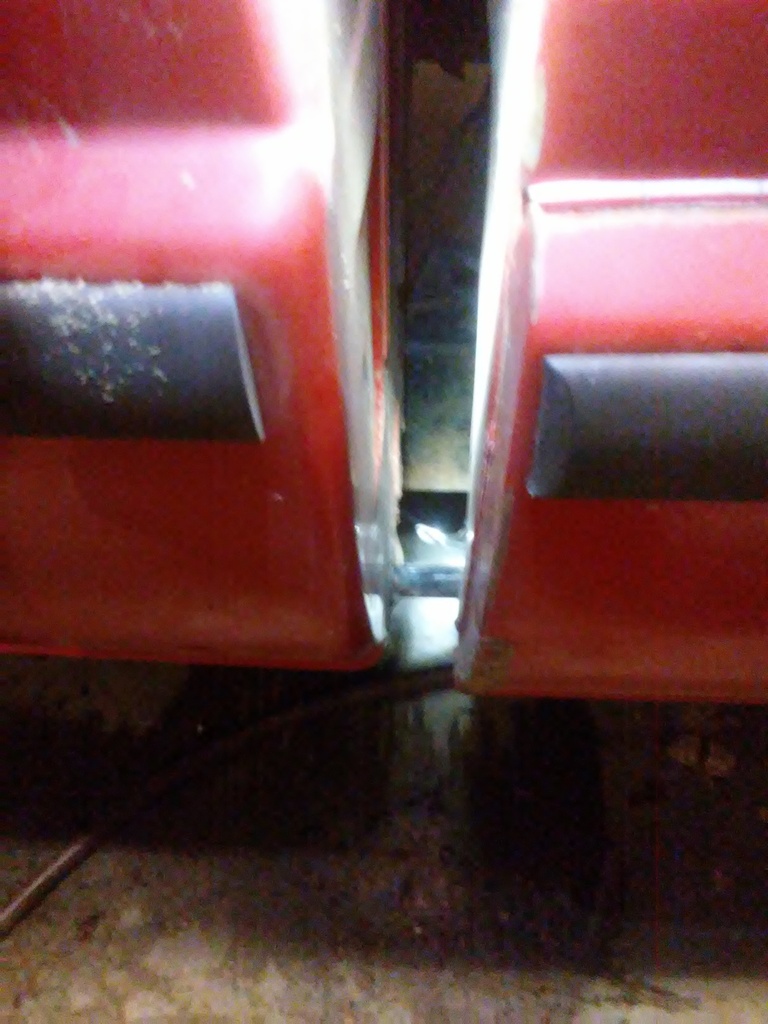

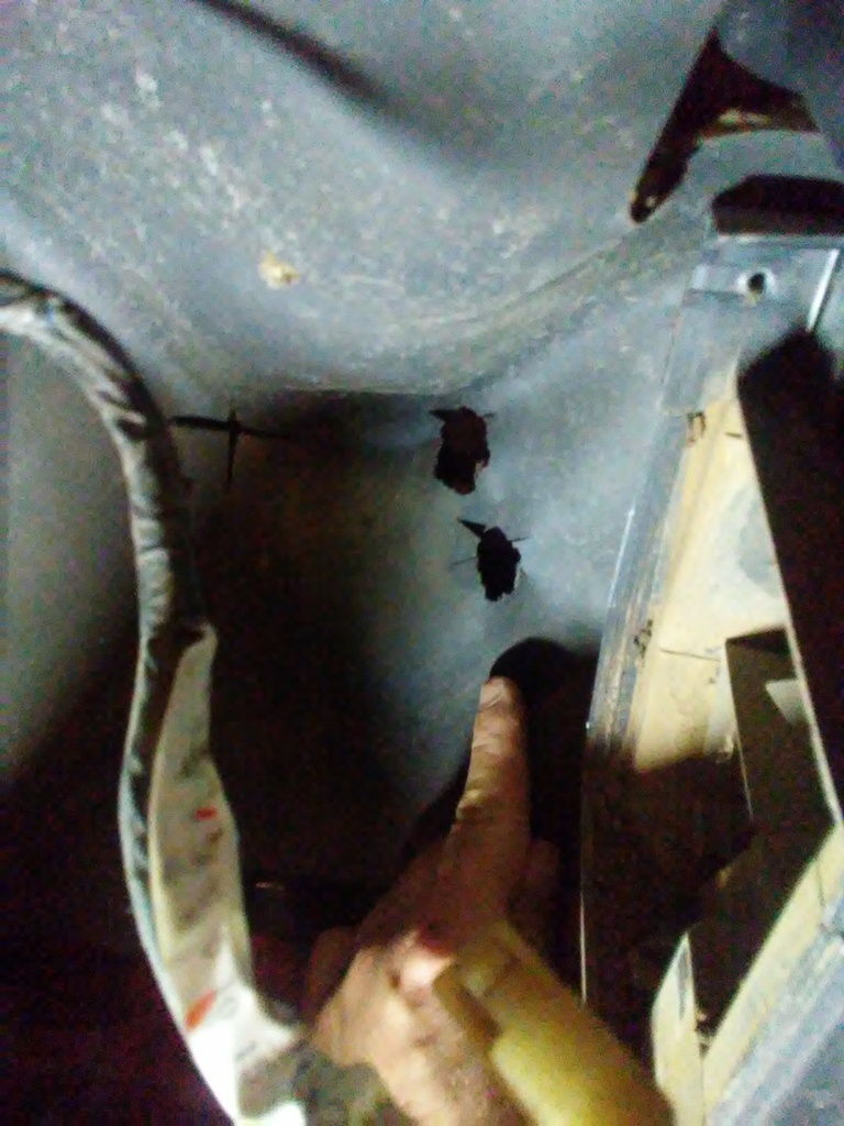

I am in cleaning mode of the truck. One thing that causes the rocker panels to rot out is the drain holes plug up. Pull up the door trim and you can get access to the body holes and blow out the dirt and clear the drain holes.

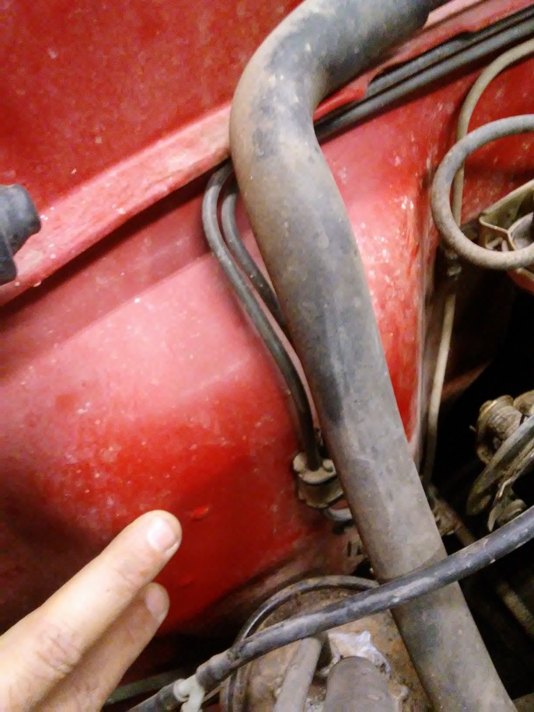

What I am trying to show here is my air gun is in a factory hole with a rubber plug. The plug is missing on this truck, but you can get your air hose in the hole and blow the dirt back and fourth and I use a shop vacuum to catch the dirt when blowing toward the front.
How some of the dirt came out when I blew the dirt from the rear to the front and another view of the access holes.

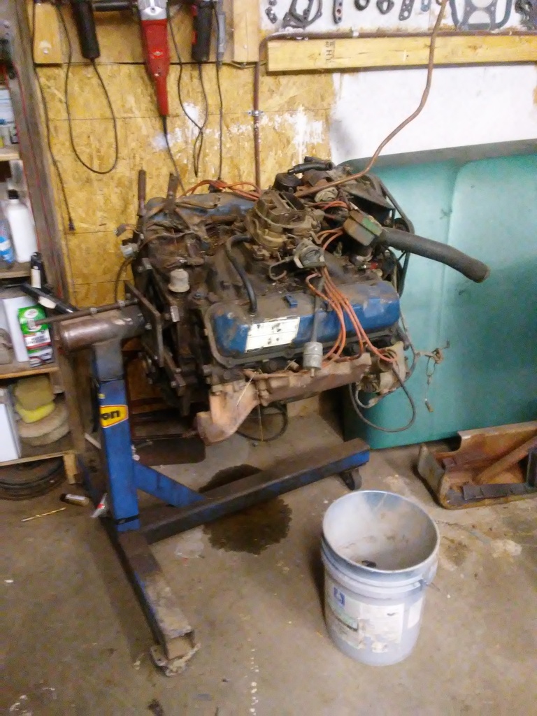

I did get a bit of good news. A guy is going to come by in the morning to buy my 460 motor and transmission. I am going to use those funds to get the welding things I need. .020 wire, gas, wire nozzle, and maybe a few other items welding related. Not sure if I want to use the rest of what I may have left over to buy a motor for my truck or some replacement panels.
Bye bye motor and that will free up some shop space.

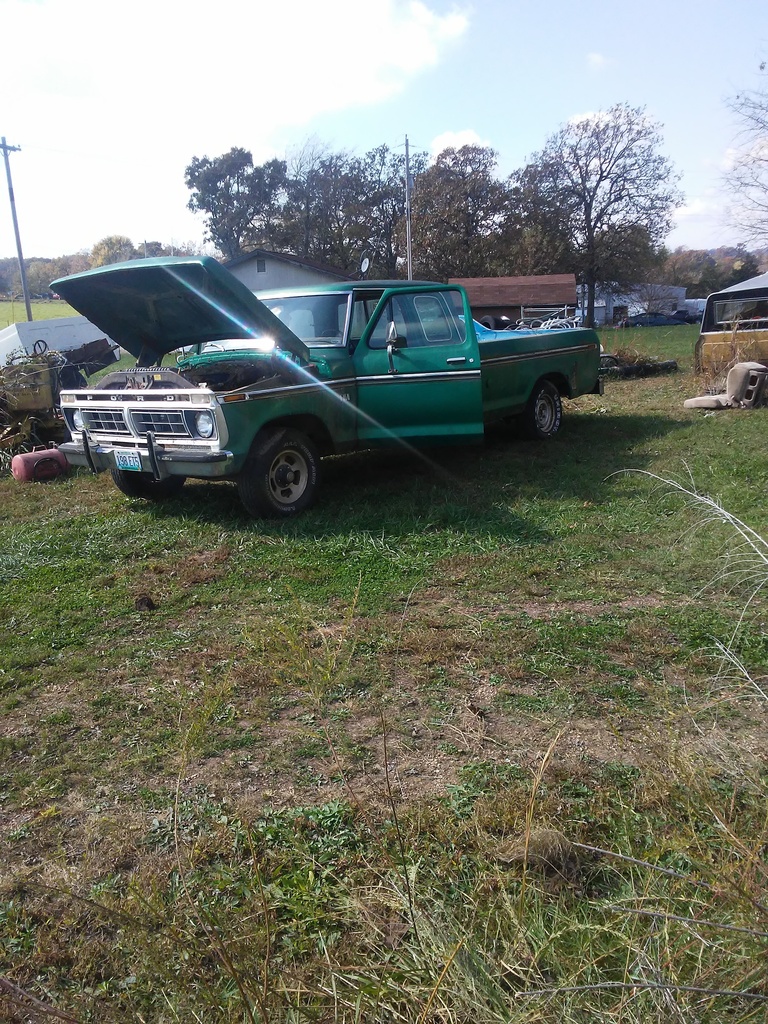

Terry, is that a 61 F100 hood in the background?

Hello flg822r... It is a hood for a 76 Ford. I do like the older body styles. I like just about anything someone puts their time and effort into. I am slowly building my retirement rig to pull a 5th wheel camper. I am under the 10 year mark until retirement and when it is too hot or cold, I plan on moving around the country for a month or so at a time until the weather gets better here. I like travel but also like being home. I think it would be great to live in an area for a while and see the different sites. When it is cold, I plan on heading south, when it is hot, I want to head for cooler weather. Here is my 76 build>>>> https://www.yotatech.com/forums/f188...estore-296600/

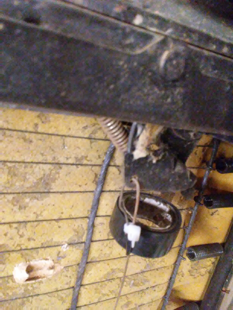

I got the seat fixed. I had to lube the rails and the spring that holds the cable to the release lever had the spring missing. Here is how Toyota did it.

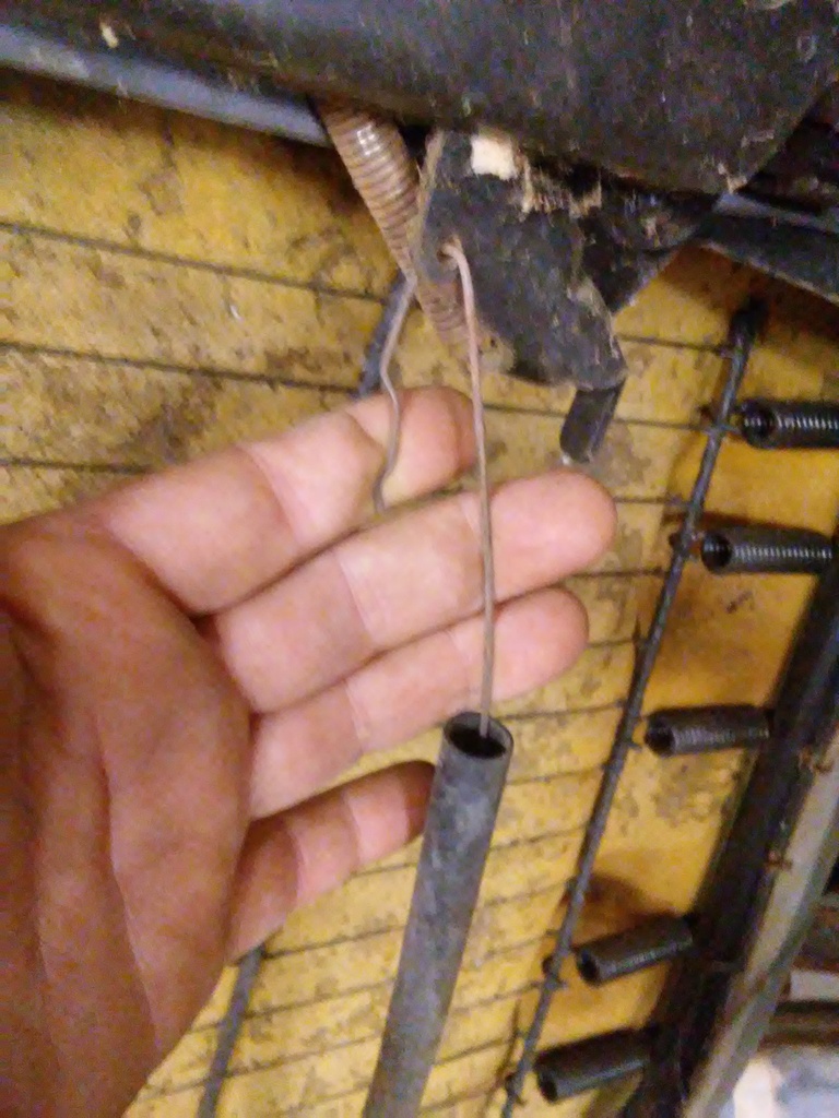

The spring had slid off of the wire.
I used a zip tie and then wrapped it with electrical tape which I hope is a better fix then what Toyota did to it. I also did the same to the oppisite side.

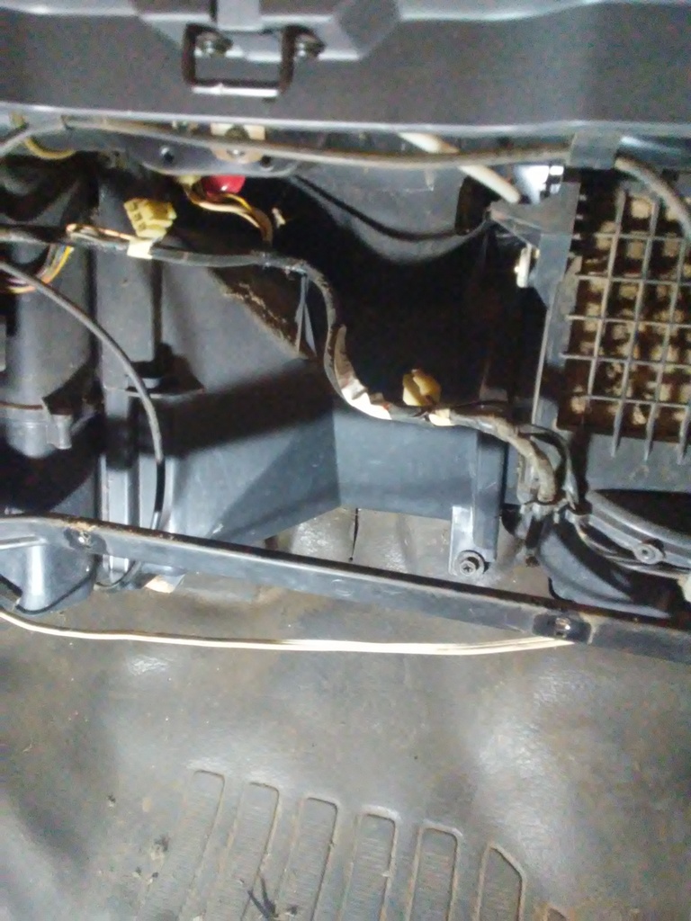

For a truck without AC, you will have a square tube that takes the place of the Evaporator.
Installing AC in these trucks is easy. Here is the dimple for the drain hole for the Evaporator. Just drill it out.

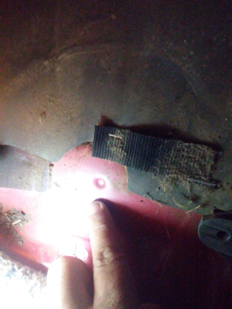

Just above the drain hole dimple, you will see two pre-cut holes in the insulation and there are dimples there as well to drill out for the Evaporator.
I could not get a good picture of the dimples from inside the truck but here you can see them on the fire wall

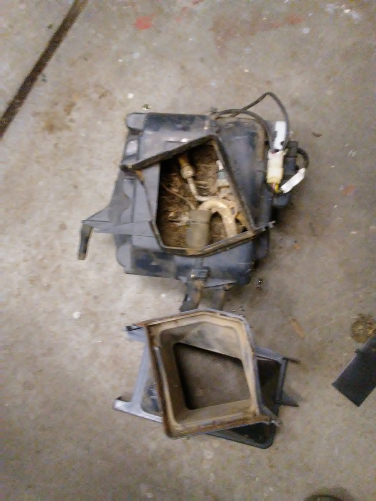

I have a spare Evaporator but wanted to show that without an Evaporator, all of the debris will go to the heater core.
