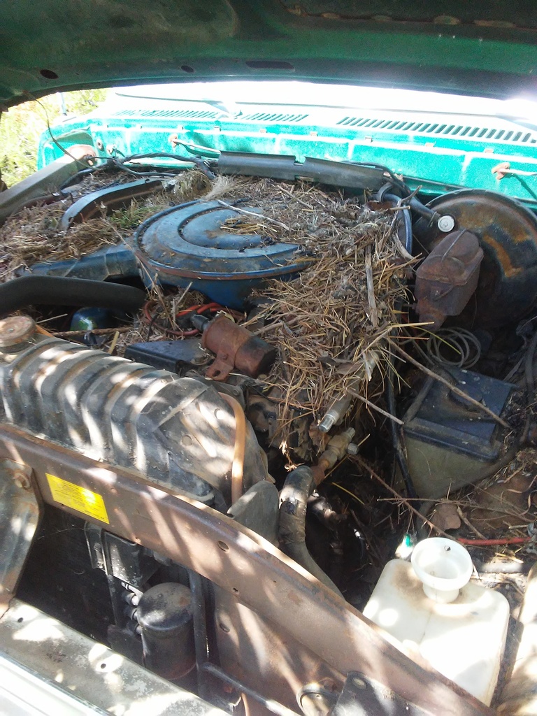

A packrat has gotten under the hood and from what I can see there is no damage. I did not have the heart to tell the previous owners that it will in a few years get a motor swap for something more economical such as a 12 valve Cummins or I would like to stay with a Ford motor. I am hoping I can get the mileage up to a more reasonable number. 8-10 miles per gallon is about what I am going to get with this setup. I am hoping I can swap in a newer model transmission with overdrive or even a 5 speed manual transmission.

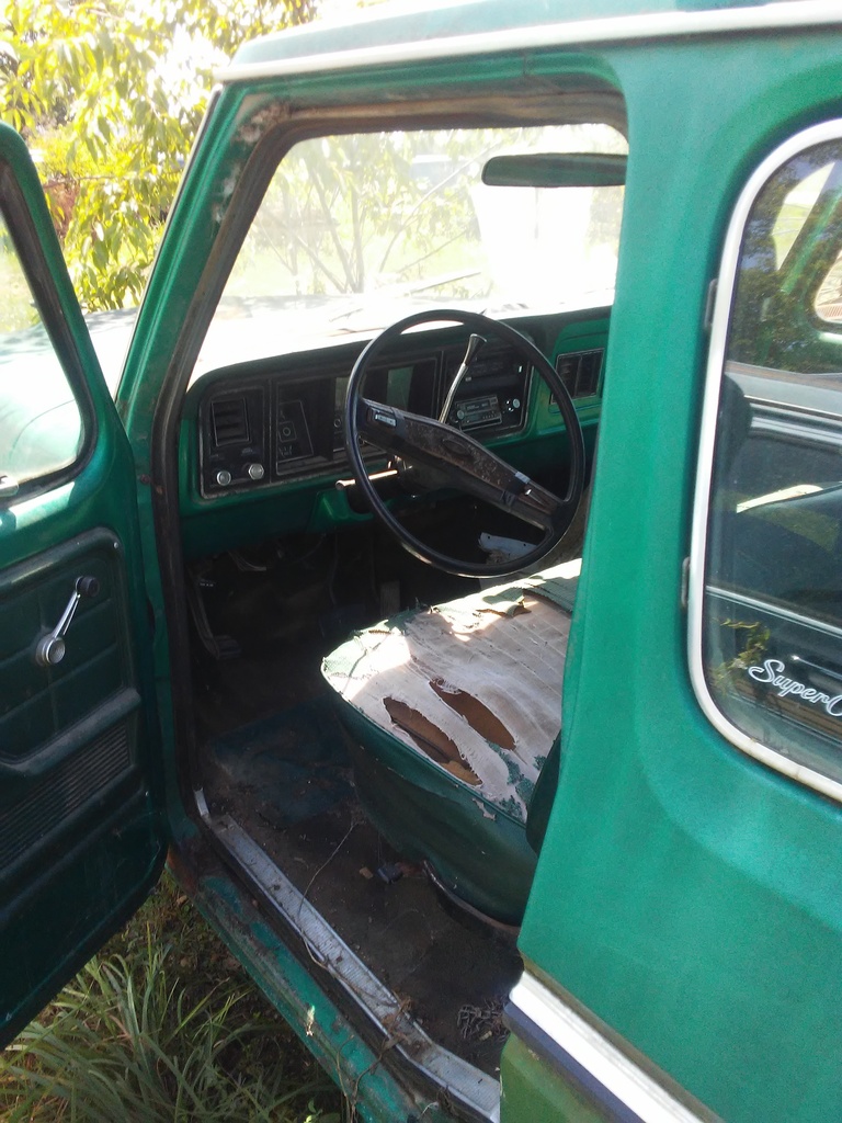

I am hoping the bench seat is comfortable and I want cloth seats and would like to find original material. I will swap in buckets if I have to but really don't want to. I will be adding carpet. I do not want rubber floor mat. On long trips I like to drive barefooted. This has factory air and cruise control. In the 70s that was an option at the time. Now even the base model trucks have ac and cruise that we take for granted. I will add trailer brakes and want to look into adding air bags to level the load when pulling things.

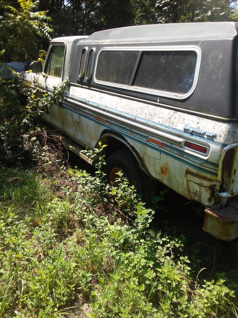

Later on I might by this truck for parts. It has all the options mine has. It is rusted beyond economical repair but with the tanks, cruise, knobs, some chrome mine does not have, and other parts, a parts truck will pay for itself many times over, plus it is 4 wheel drive and I can part out the rest of the truck of what I don't need.. 76 have ugly gas caps on the drivers side of the bed and newer trucks have gas doors which is one thing I will have put on my truck. I will have to send it out to the body shop to replace wheel arches and gas doors but will do the rest myself. This truck has trim on the tail lights and tailgate and buying pieces one at a time can add up quickly.

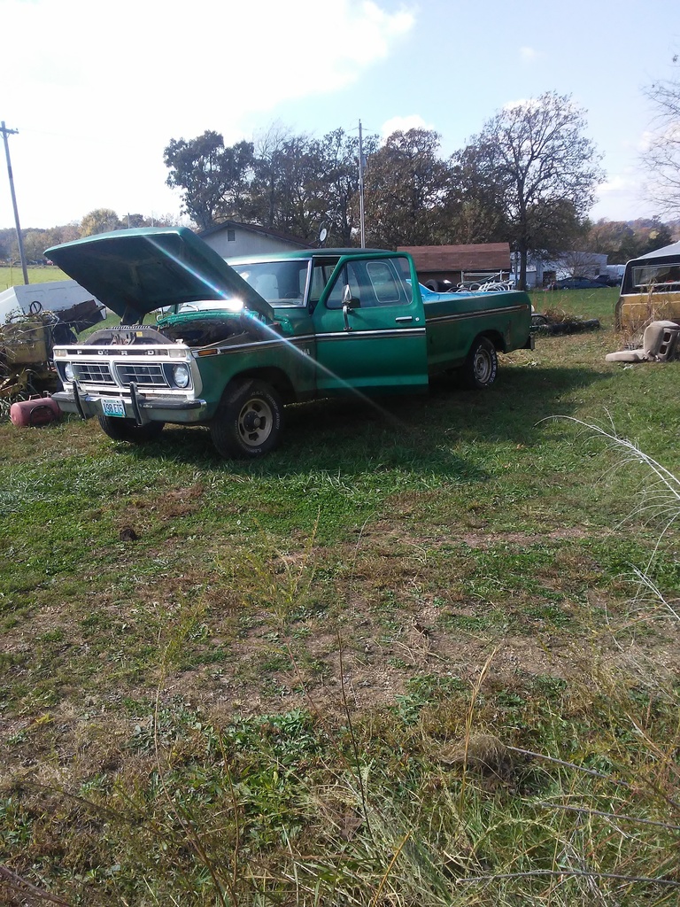

I finally got the truck dug out of its pit. I did have to air up a tire and just as soon as we got it pulled out the tire went flat. I am hoping to get it home tomorrow or maybe Saturday. My friends trailer brakes are not working and we have some hills to traverse that would make it very interesting in some cases. We worked on them quite a bit today and just unable to get them to operate. First time it has moved in 16 years. He wanted the camper shell which I was just going to scrap. I was impressed with the condition of the bed as it as seen very little use. He originally wanted the front rims and how now decided to let me have them and if I can find the rear rims and they match the front I will take them.
Getting closer to home.

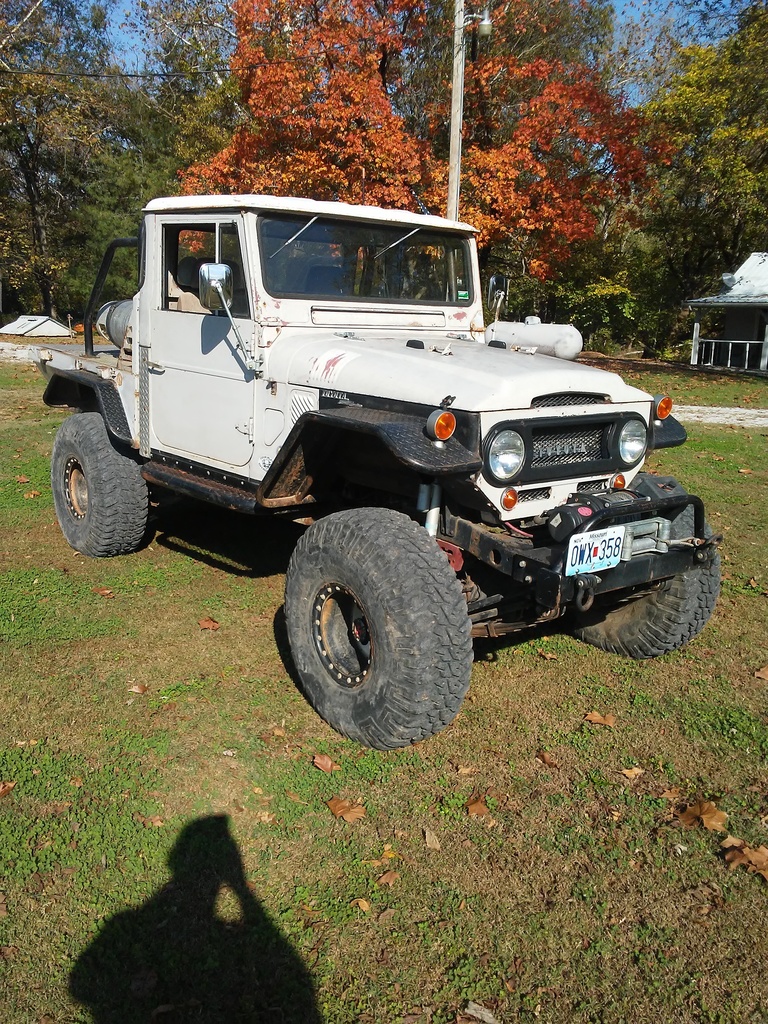

I did get to ride in a '65 FJ45. It was built as a rock crawler and the guy was afraid of damaging it. My friend is going to bring it back as a road worthy daily driver. There is some money spent on this truck. Way out of my budget but real rock solid for a 65 model and originally the truck came from California. No idea of why the picture is so out of whack. Will get a better picture later.

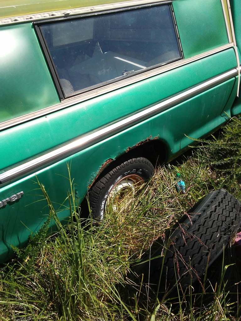

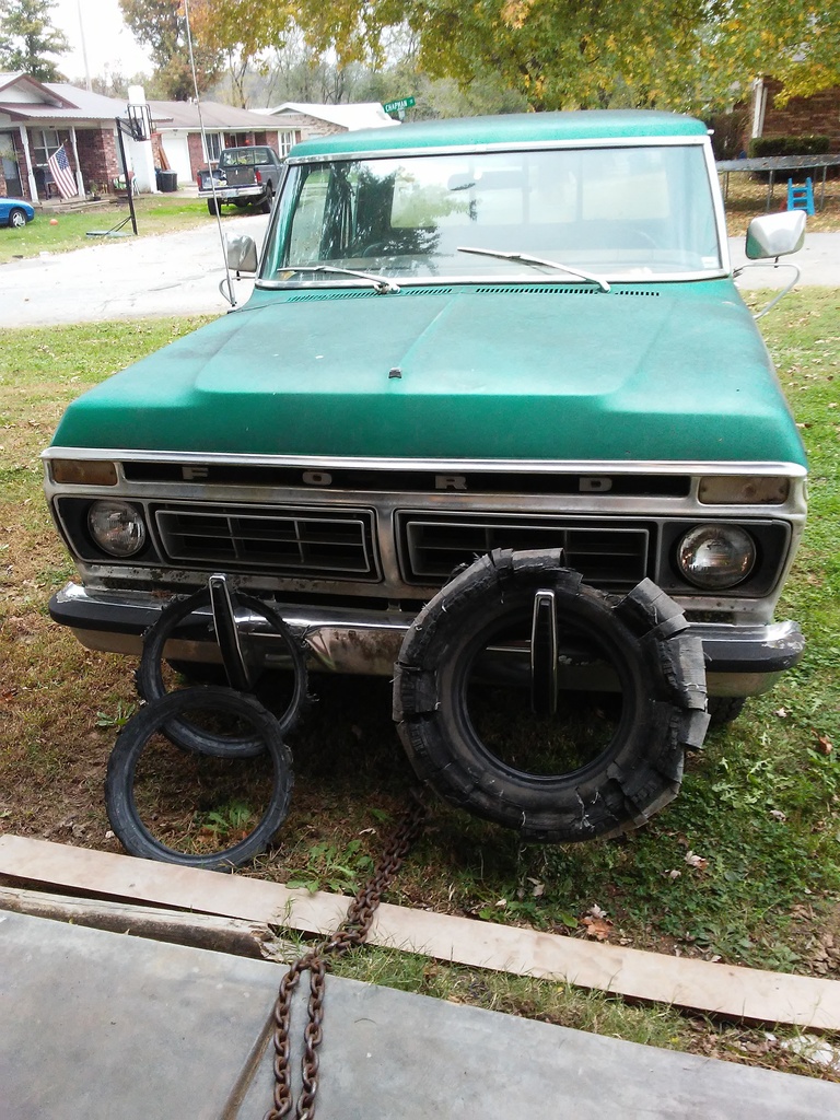

I finally got this pig home, but it was the trip from Hades. Got two flat tires on the trailer. One blew out and the spare was dry rotted. Luckily we were able to find a shop that had two 15 inch trailer tires. What should of been a 2 hour round trip took us 5 hours total and a lot of driving since we were out in the middle of nowhere.
What is left of the two tires. The bumper guards will not be going back on. I am sure it was an expensive option back when it was new.

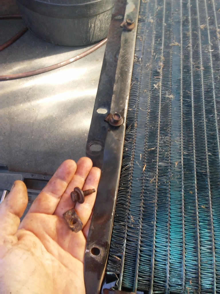

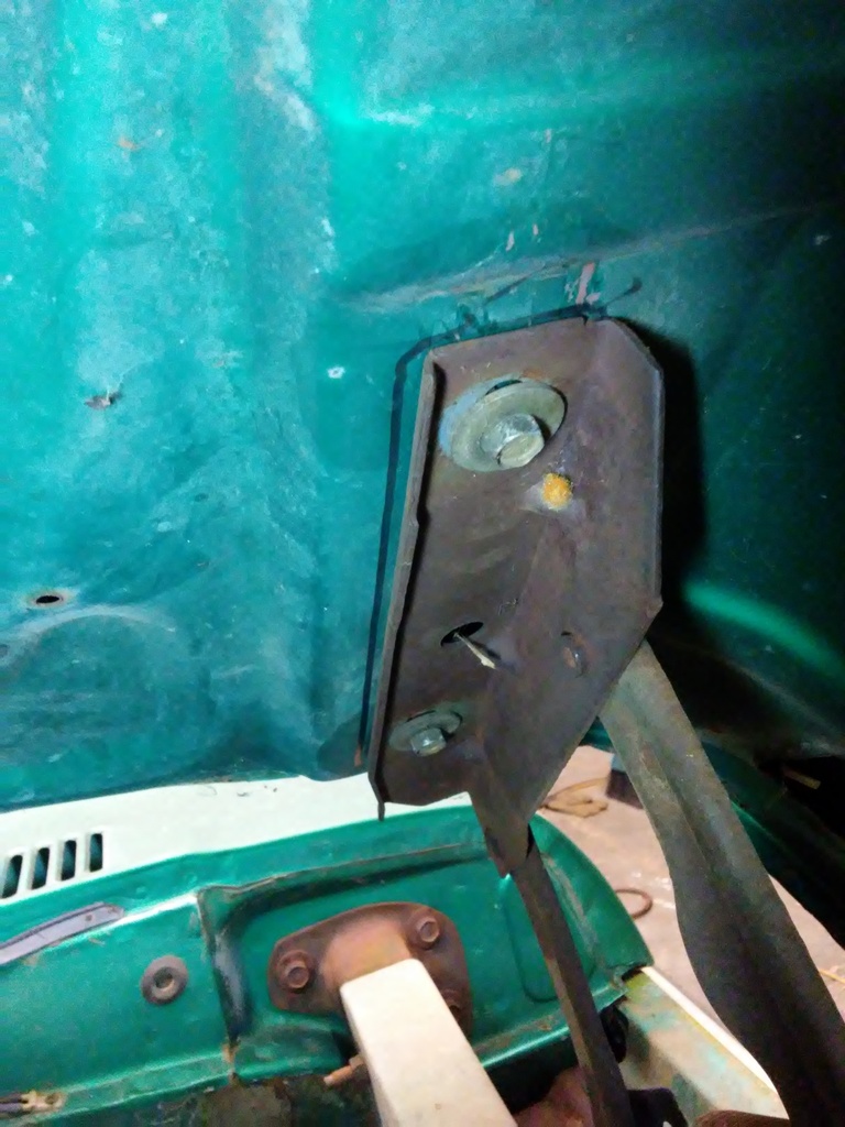

Yeah!!! first hack job I have found while cleaning the engine bay. Instead of getting the correct bolt to hold the air cleaner cover on, they used a long screw. Not the correct way to do it. For the most part this truck does not look like it has been butchered up.

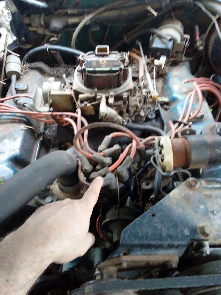

To show some of the cleaning I got done and one reason I like to work on Ford and Dodge is the distributor is up front and easy to get to. Two reasons I dont care to work on a Chevy is the distributor is in the rear and the exhaust is a pain to work on and getting to the spark plugs in some cases. This being a field truck, there was plenty of rat droppings in the engine bay. Probably 5 pounds worth. It will be sanitary when I get it completed. I have seen cars in the bone yard that were probably bigger health hazards from humans and one reason when I get a used car I clean it myself.

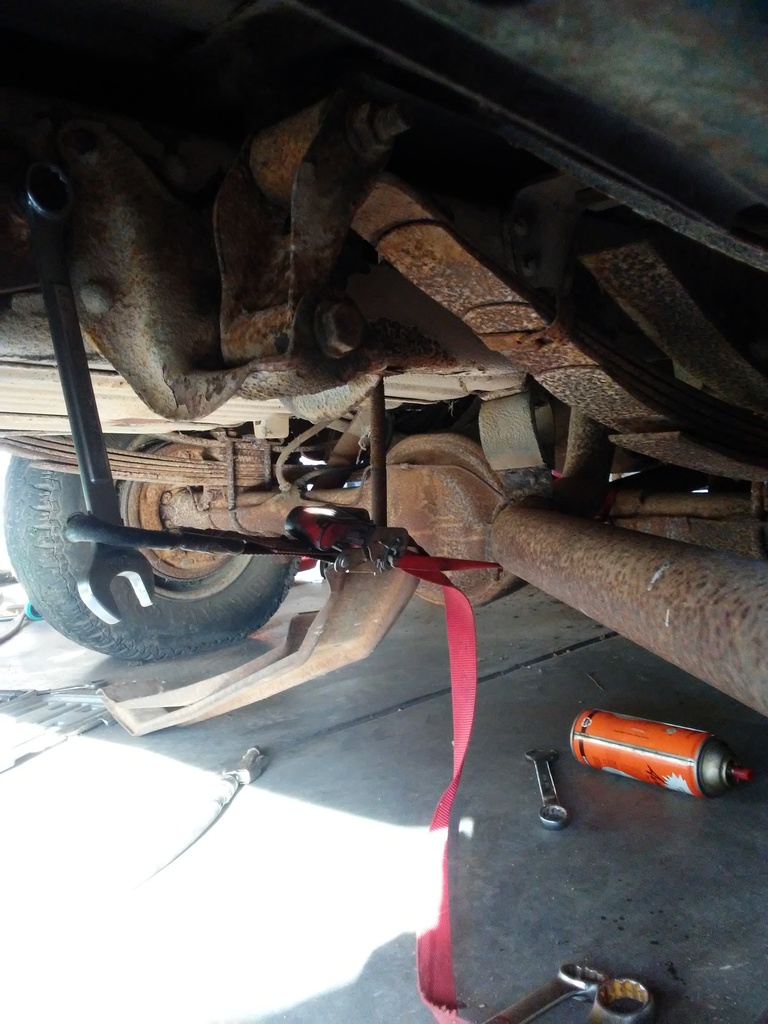

I got out and started soaking every nut and bolt that I could get to with PB Blaster. The doors were not opening as smooth as I would like so used WD-40 on hinges and the hood release and they are operating a little smoother now. Still will go out and soak them every few days until I get to the stage where I start pulling parts. I am hoping to pull the motor and transmission on my day off and try to get things in the shop before the cold weather sits in. I dont want the truck in the shop at this time as it will take up to much space.

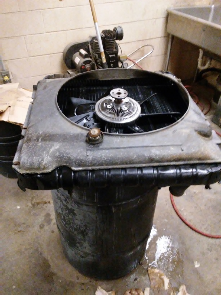

I got the Fan Shroud out, Fan, and Radiator. I will clean, test, and paint each piece as I go. It would be nice to just buy new parts but I got to use what parts I can to cut down build cost. Still soaking some bolts and hope to get the motor out in a week or so. Still have some cleaning to do from the rats former home.

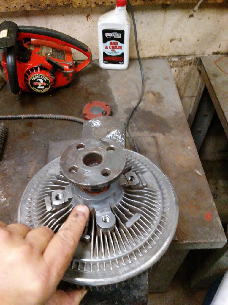

Fan Clutch is falling a part at the shaft.

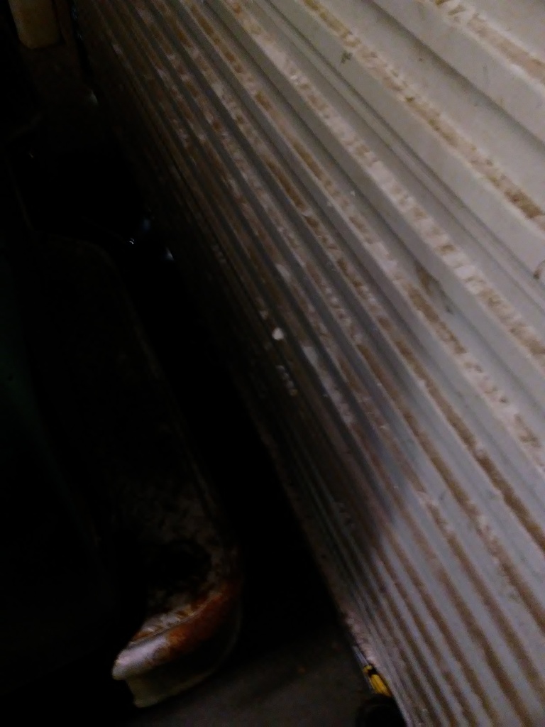

Fan shroud was covered with oil and grime. Radiator has some bumps and dings in it but looks to be usable. It usually cost me $25 to get it flushed and some minor repairs done to it. The radiator is big, looks big enough to cool a Freight Liner Truck.

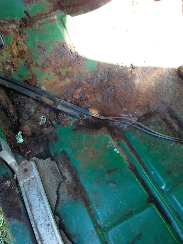

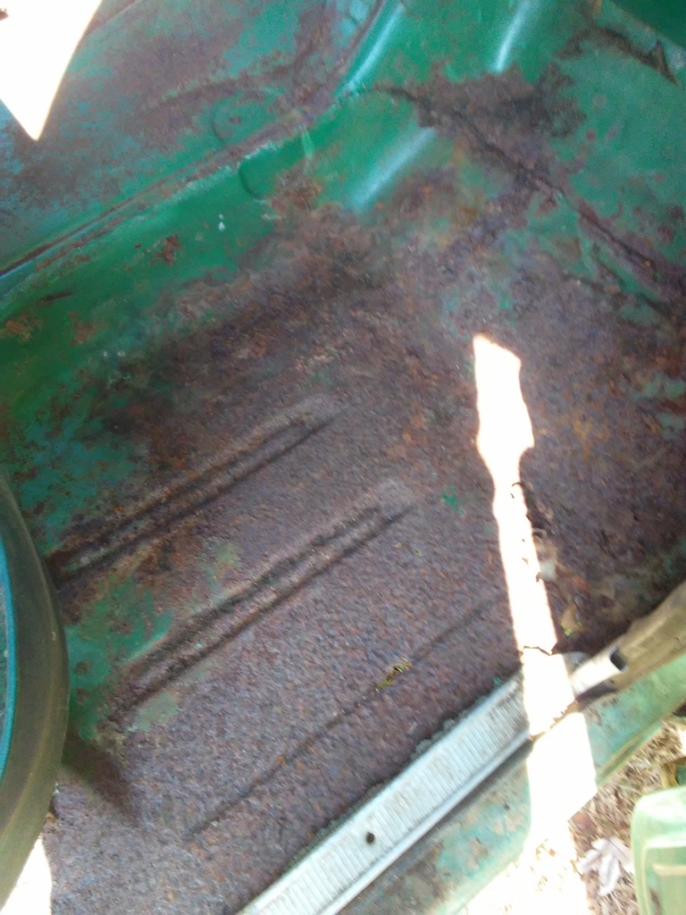

Drivers Floor Board is not as bad as passenger.
Passenger Floor Board. I think patch panels are easily available for these

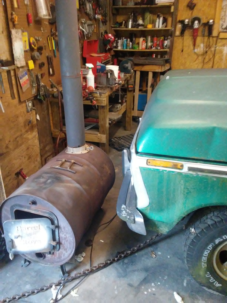

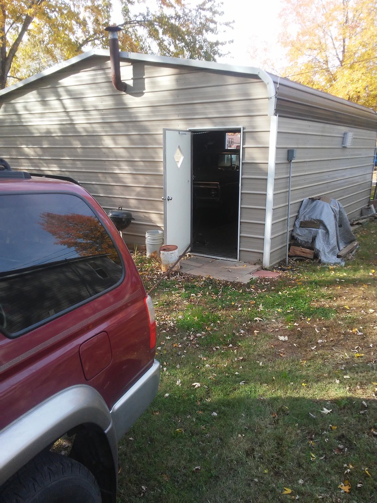

Getting the truck was a real pain in the rear as I loaned one of my chains out and need to get it back. I use a Come Along to get close enough to connect the chains I had to the 3rd Gen and get it hook up and drag it from the rear door. One year I will get a winch for dragging in non running trucks. I did bump the door with the chain a little bit but no damage to door.
It is in but not much room to spare. Might move my work bench to the side and angle the truck in and see if that gets me any more room I will have to eventually pull most of the truck back outside as it just takes to much room. Trying to get it in pieces before it gets cold and work on it a section at a time.
With the truck in the shop, I have about 6 inches from the rear door.

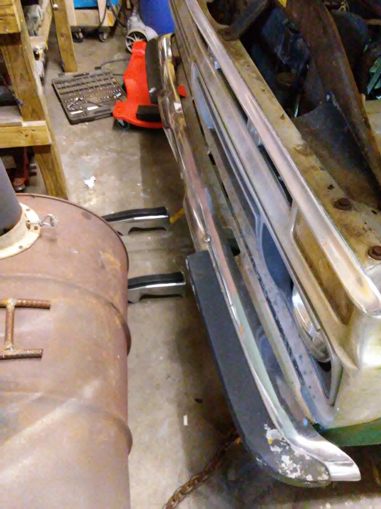

Desperation!!! I am trying to get the bumpers off to get some more room in the shop. 4 bolts hold the rear bumper to the frame and that would give me nearly a foot more to work around the shop. I soaked the bolt in penetrating oil and have a ratchet strap on the wrench and will try letting it soak over night with pressure on it. I am worried about stripping the bolt head or possibly snapping the bolt. It has a captured nut on the back side. Even if I had a cutting torch accessing the bolt would be a real pain and the gas tank is next to it. I am also working on getting the rear tank out. Making slowwww progress.

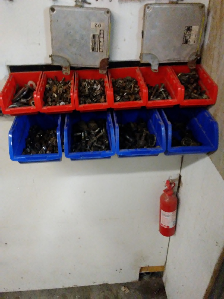

Here are my Toyota bolts. I will go to a bone yard and strip a Ford in the yard of just nuts and bolts and get the same baskets from Orshielins and make another row just below the Toyotas. I like to stay with factory hardware when possible and dont use big hardware store bolts unless just absolutely have to.

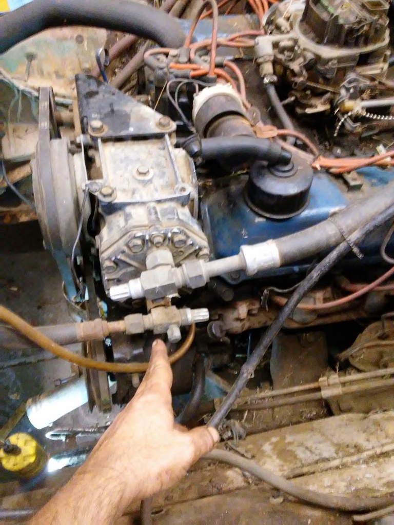

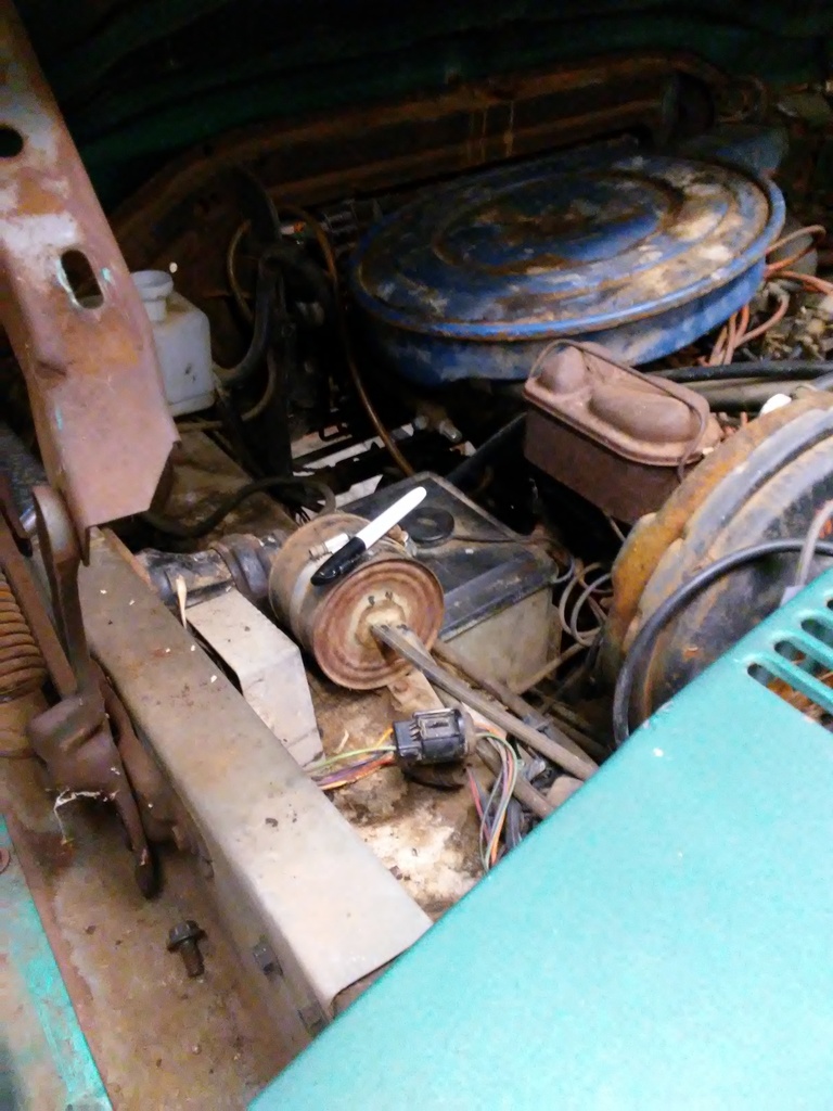

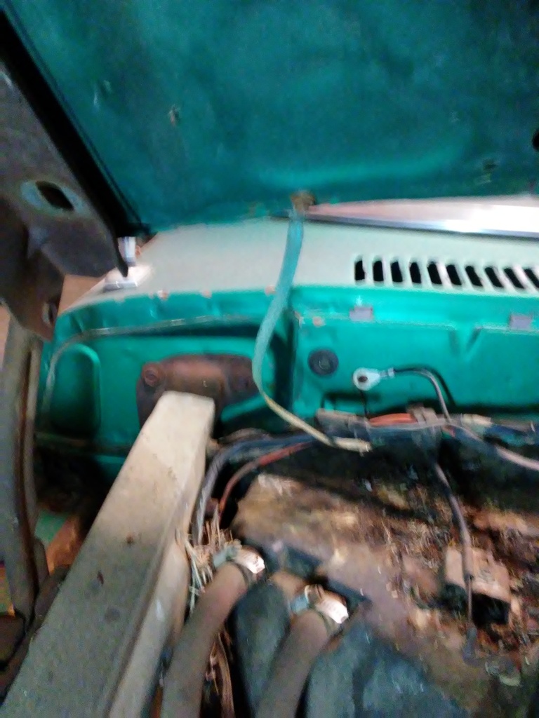

Not sure of the purpose of this ground strap. Something else I would not remember where this goes months/year later. Build threads are great for keeping pictures for future reference. May seem like some needless post but I will be going back to these pictures when I reassemble.

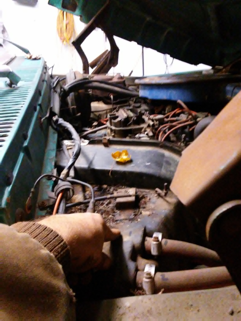

While waiting for the wife or someone to come help me lift of the hood, I marked some hoses as to where they go with a marker. In some places I will use rattle can spray paint to mark things. I am sure I will eventually do some spray paint and will post them for an example.
The front clip will be coming off in one piece eventually. These hoses will stay with the fire wall and is a reference for me. #3 and #4

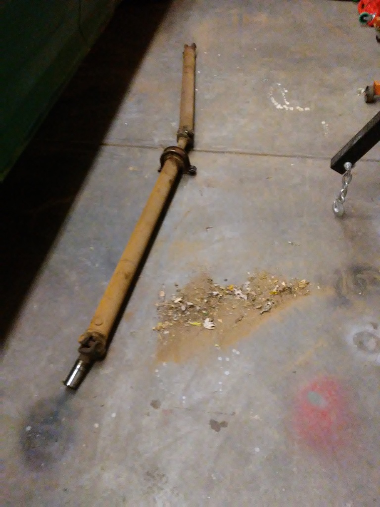

I got the drive shaft out. One bolt and clip to the Carrier Bearing is still in the frame as the clip will not come out due the gas tank being in the way. The other clip and bolt is in the Carrier Bearing Housing. I put the rear u-joint bolts back in the axle just to keep them in place and not need to keep track of them. Since I dont have a Thread Chaser, I just run the nuts on the bolts several times to clean the threads and bolts. I have a million tools and still not enough.
