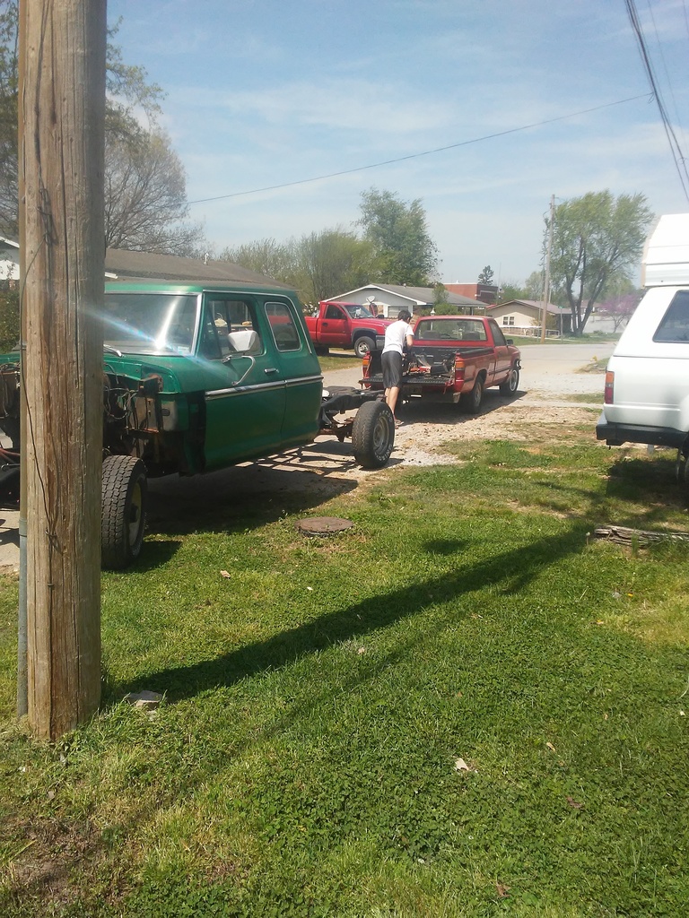

I did finally get the wreck home but still have not ordered any parts yet. Have a few things to take care of before that can happen. I used the wreck to pull the Ford out of the shop so as I can get the wreck in the shop to do some work on it. Justin got to do some driving on helping to move the trucks around. He liked getting to drive. He is getting the Drivers License itch. It is still a couple of years away but even getting to drive a short distance is pleasing to him. He got to pull the trailer with the Ford bed on it and helped to pull the Ford out of the shop.

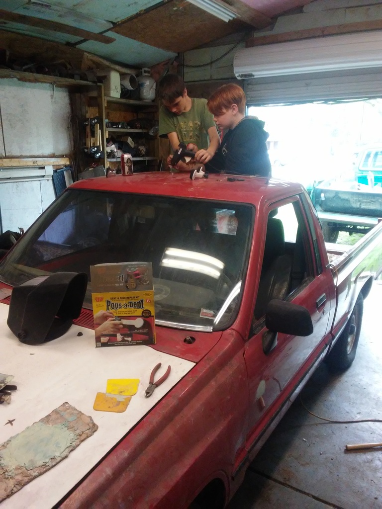

Here is Hunter and a neighbor using the Pops A Dent. It works on some small dish dents.

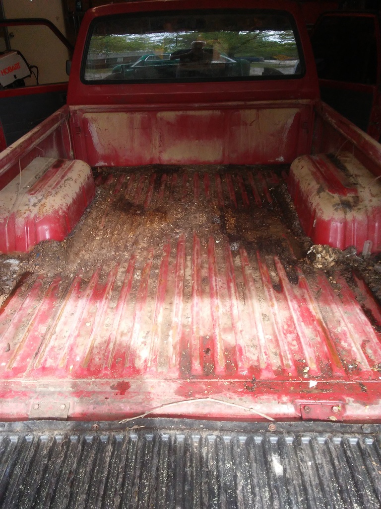

Bed Liners can ruin or save a bed. Luckily I got the wet stuff out before any damage could be done. This bed is in great shape. Good luck on me finding another bed in this condition. The floor still looks like new and no dents in it.

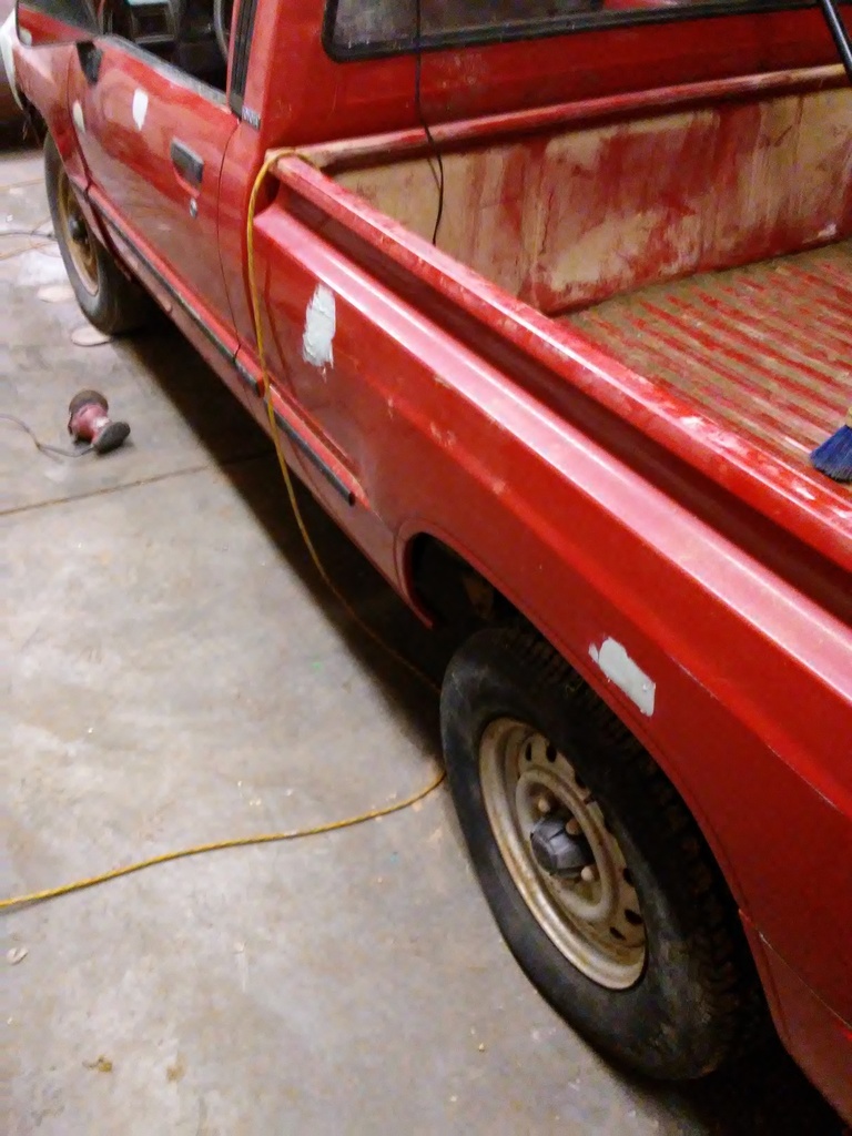

Here Hunter and his friend removed the tail light and worked the dent out. Grind down the paint and got a little carried away with the body filler. Showed them how to prepare filler and apply.
These are some minor door dings. A little excess filler and I did bump into some filler while it was wet. Doh!!! Showed them how to find dings. They were ready to sand the whole truck but once a truck is sanded it is hard to find dings when the gloss is off or in primer.

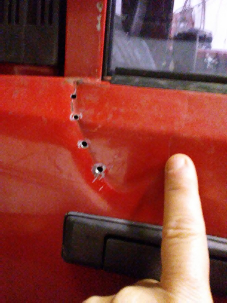

This dent in the passenger door is a horse shape. Justin had to do the drill and pull. I will let him weld up the holes at a later time before we fill the dent. Toyota sheet metal is difficult to weld on. I will have to remove the door handle to get this fixed.

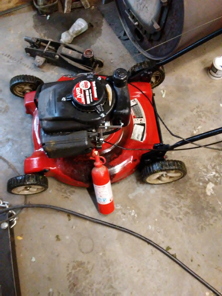

Today I went out in the shop to get pictures of the kids progress and to clean up the shop. Wife wanted me to fix a piece on the mower and thought I had done everything right. I started welding and I had the fire extinguisher ready to go when I suddenly had a small flame. If my extinguisher was working correctly I would not of had any damage to the mower. I have been a part time fire fighter and know fire fighting really well. I have even mentioned in other post about having a extinguisher available even when just working on cars. I have seen a back fire from a carb get out of control.
This was a new extinguisher and is still full but it is old. I know how to operate one and have taught people how to operate them but this one would not function when I needed it to. Luckily I was able to drag it out of the shop and with one of my buckets I use for wet sanding the the wife swimming pool provided the water, I was able to put it out. It did not go out easily as I had to get up under the mowers cover by turning it over and still it would not go out easily. It took several attempts and I was exhausted when I finally got done.
Check them fire extinguishers!!! Go to your local fire department for proper use and they can be bought cheap at most stores. Even a small one can do quite a bit if used correctly. Does not look bad but there is a lot of damage under the cover and you can see how hot the deck got. May have ruined a new mower.
