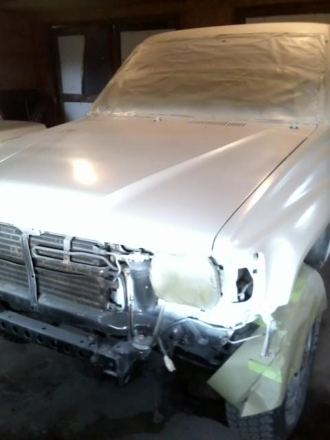

I got it painted last nite. Found 2 small hail dings and some sanding scrathes I missed and a couple of small flaws. Kind of disappointed as I tried to go over it really well and missed them, but for the condition of what the truck was really in before, I am quite happy how it turned out.
When painting last nite, I had some gnats to land on it and get stuck. This morning I was able to get them off and they didnt do any damage that will really show. I still need to clear coat and will do that today.

Here is a front view.
Here is a side view.

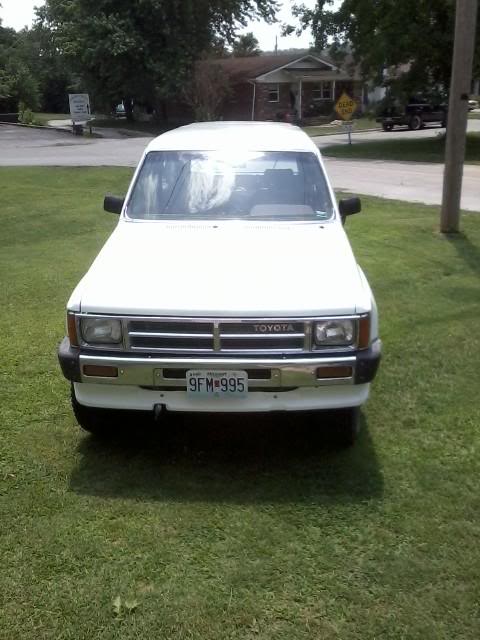

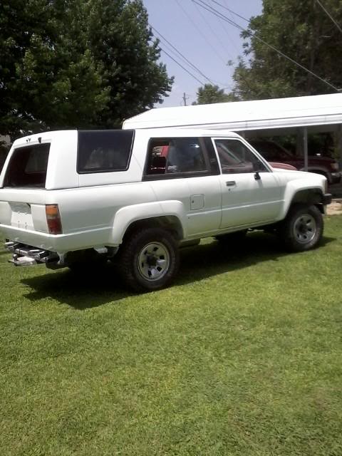

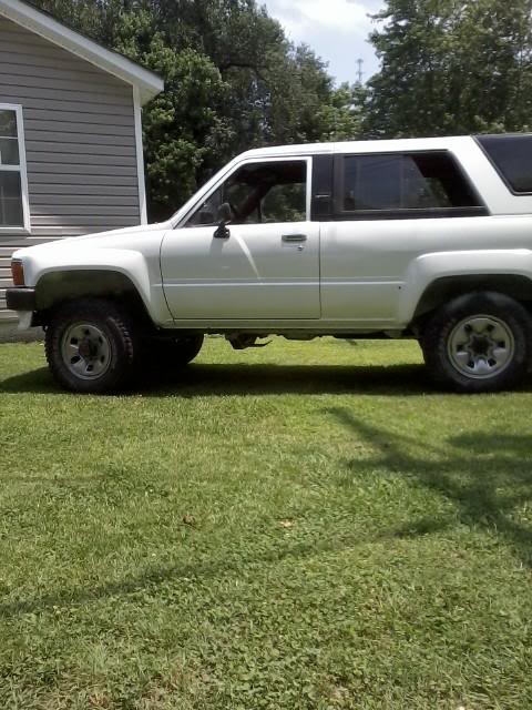

Here is the front painted. Letting set out to dry for a few days. Just got it legal enough to drive. Will get the rest of the trim on it when I get cleaned up.

Driver side painted.
Passenger side.

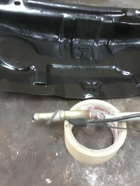

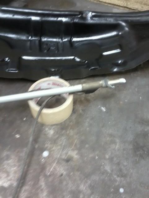

Dont know if this falls under the Redneck Inginuity post. But my antenna is broken. Tried finding one in the boneyard and it just isnt to be found. I have had to repair one like this before.
I am touching up overspray and had the Inner fender out and you are able to get to it from there. Also need to take the right kick panel off inside and above the ECU is where you can find the Antenna. Just have to work it out of the dash.
Not the best picture, but in the top picture you can see I just found a bolt that threaded into the two broken pieces and cut the head off twisted them together. I have done this before and it works great.
Broken
Twisted into one fixed piece.
Size:  28.9 KBee the bolt in the top half of the antenna.

tht antenna idea is good i may have to do the same on the scav

Hello Twisted..I tried finding a new one and had to come up with something, did this before and is working good. I know this has to be a fairly common problem.
