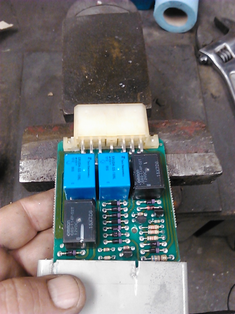

I then replaced the Window Relay Box, I got my Rear Wiper working and Defrost but no window control. Located behind the Drivers seat behind the vinyl panel. If your rear wiper and deforst work this is some indication the box is good, but a relay is in there that operates the window so you cant completely rule it out.

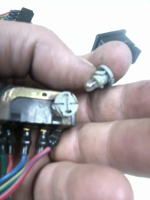

I then took the Switch apart. It comes apart easily if done right. First remove the gray plug. It is the light bulb. Then pull the cover away from 2 tabs on one side and then the 2 tabs on the other side.

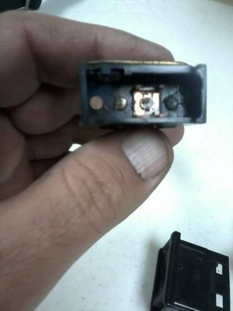

I then washed the button with soap and water and air dried it with air hose and used electrical contact cleaner to get the corrosion, coffe, dirt and who knows what else out of there.
Here is another picture of how it should look before going back together. Make sure you dont lose the little white pin and the metal toggle piece. These are very brittle being 20 plus years old. On the rear wiper and safety lock, they are difficult to get seperated. I just take contact cleaner and hold the switch upside down and spray cleaner in there and blow it out with an air hose.

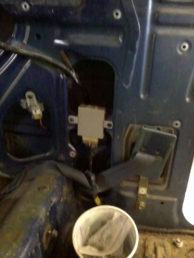

Located behind driviers seat.

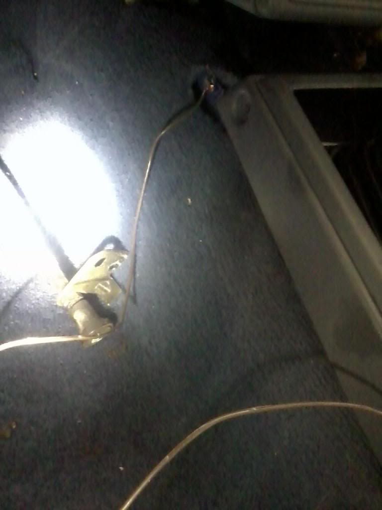

Running a ground wire from this wire on the plug, the blue wire to the place on the pic below elminates a lot of problems.
Ground to center consloe mounting tab.

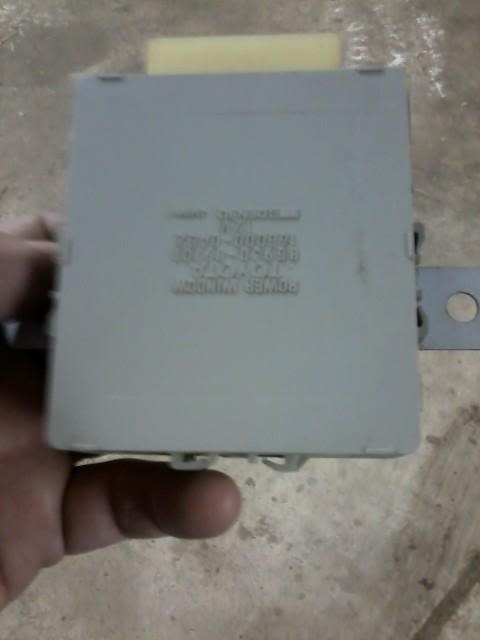

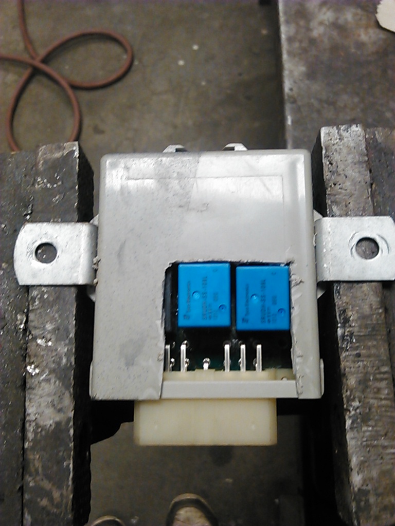

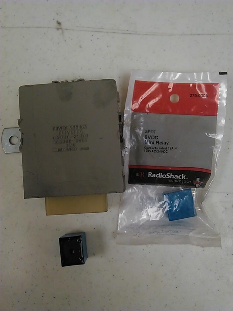

Mistys back glass has been having issues again. Sometimes it works and sometimes it doesn't. The rear wiper and washer bottle work so I know it is in the relays. We use the tailgates on our trucks a lot and these switches and relays are just worn. I haven't checked the dealer and that would be the best way to go and just be done with several problems but I have a feeling it will be expensive. I replaced her relays and still haven't gotten them installed yet, but if I have any more issues. The stock setup is going to go away and I will install a basic switch in to completely eliminate any future problems.
I got the idea for replacing the relays from 4Crawler. I will still need to get it into her runner and see how things work out.
Here is the Relay box located behind the drivers seat with the Radio Shack Relays.
If I understood 4Crawlers thread right, it is these two relays that control Up and Down. The blue ones are the ones I replaced. The black ones are Toyota. I could have/should have replaced all 4 as they are all the same relays.
You could press them back into the cover, but it will bulge the cover and put stress on the relays. I just took a Dremel and notched out the cover a little bit.

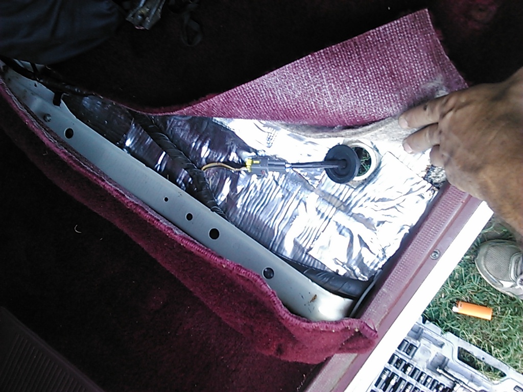

On the 88 Runners, the O2 sensor connector is under the seat. I tried to just pull the connector thru the floor board to make the connection. It wasnt going to come out that way and once I pulled the seat I seen why. There is not enough slack in the harness to do that. The seat has to come out to make the connection. She had an exhaust leak and it was one of the manifold nuts that came off. My 85 donated one for it so will be stopping by Toyota and pick up a few spare exhaust nuts this week.
Part number of 88 Runner O2 Sensor is DEN234-4152

Yes. The 02 sensor comes out underneath the drivers seat and the wires runs across to the catalytic converter. When I first noticed it kind of freaked me out. I was expecting it to go in the manifold. It seems like this would be a potential problem for a serious off road vehicle. Mine hangs just enough to maybe get caught on something. Seems it ought to have a little plate over it or something. I was beginning to think 89 was the only year for the wacky 02 sensor. I guess those universal catalytic converters would require welding a 02 bung onto it? By welding I mean JB Weld 'cause I can't really weld. My 14 year old starts welding in his shop class this year though.
Hey buddy, I got these relays from Jonnyboy, and he got them off eBay. They were the smaller types that fit right in without screwing with the cover. Let me know if you need me to find out where he got them. I have at least 4 spare rear window relay modules and when I ship back your stuff I would gladly send you one..

Hello Nervo19... The 88's and newer are under the seat. I always thought that you could just connect them without pulling the seat. Would be nice if they gave enough slack in the wiring to do that but they couldn't make it that easy. I will be glad the day I get a welder. I always have to go have it done and sometimes it is just a quick tack weld or something that is easy to do. Those days are getting closer. One reason I do like the 87 and older is fewer emissions and some ways easier to work on.
