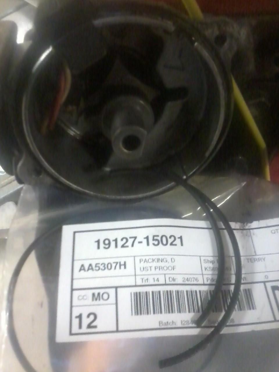

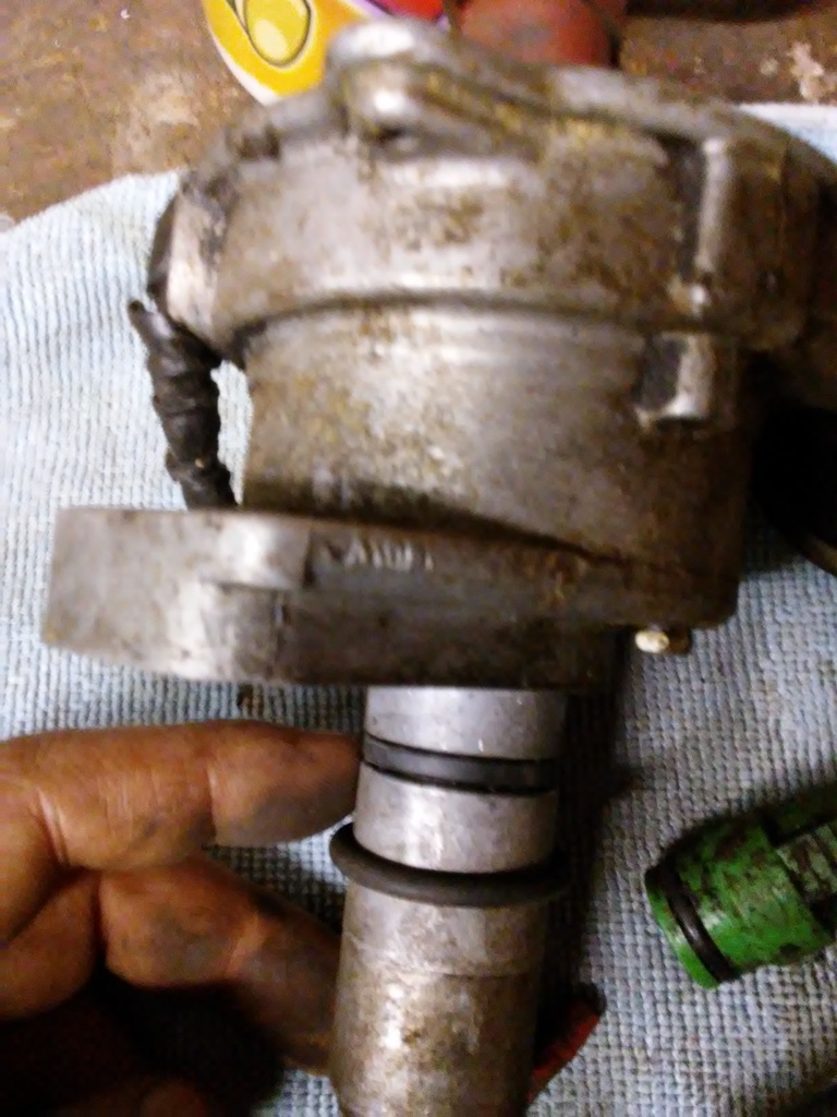

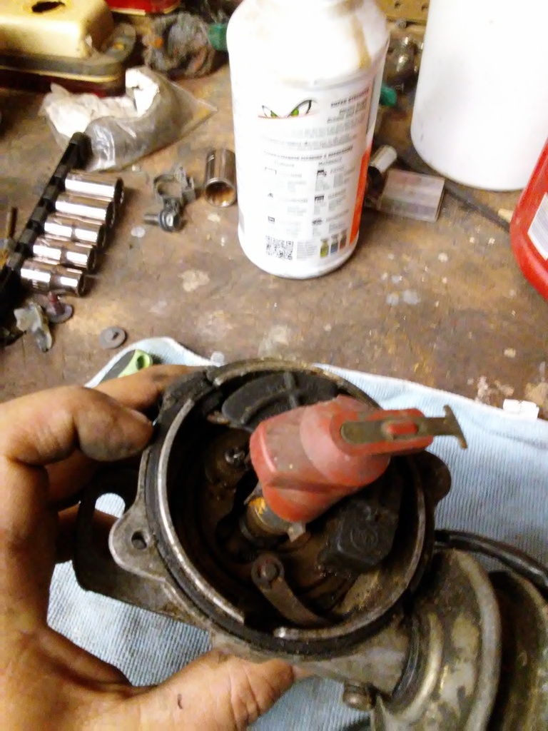

I always replace the O-ring on the Distributor. Stops some of the leaks these trucks develope and normally has the original. I just get teh O-ring from Orielly.
I will get a new seal from my local Toyota dealer. I wash my motors and dont have to deal with wet caps.

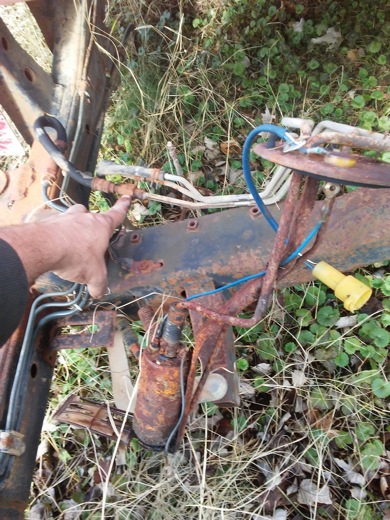

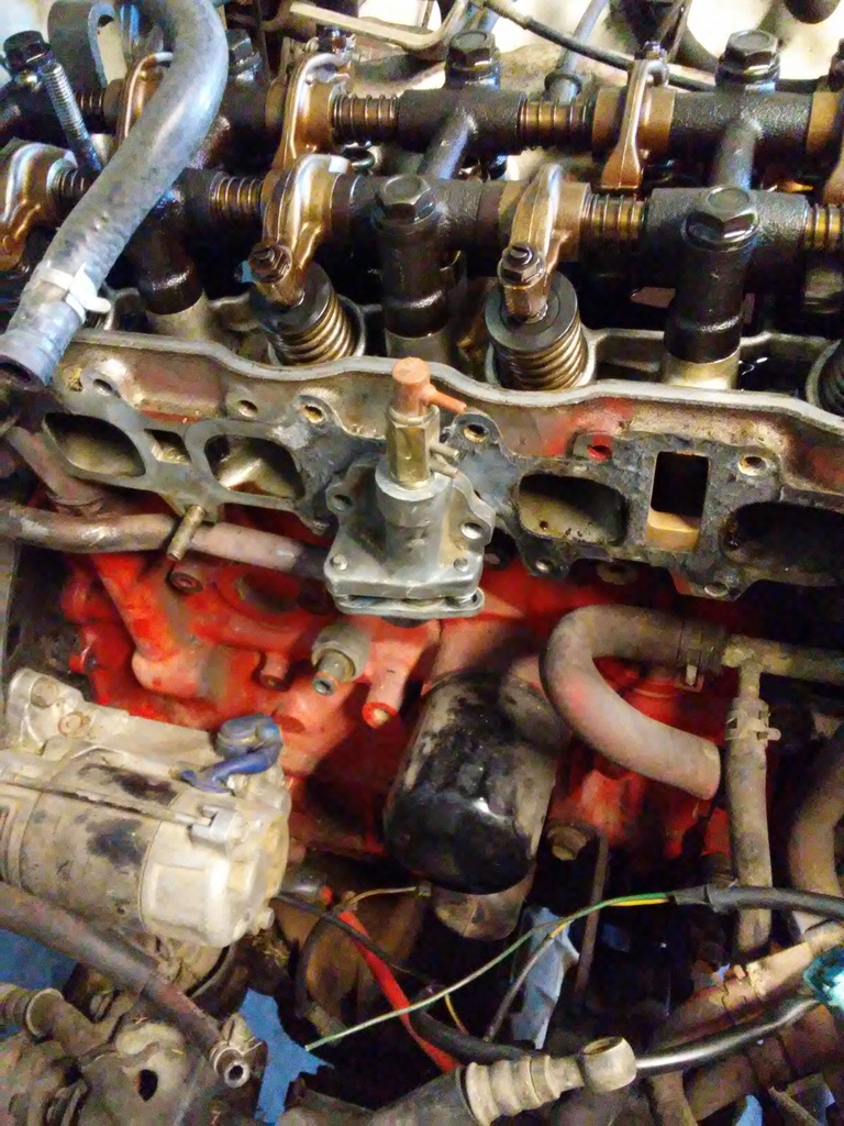

I have hit a delay. I need one part that goes on before the Intake Manifold so I am working on the other small projects on this to get it that much closer to driving. The bone yards are still closed for Christmas and my friend and me neither one has it. I could go get it from my new to me truck but not going to. May be going a 100 mile trip to Springfield just for that one part. Grrr!!! Not the first time I have driven distance for a part.

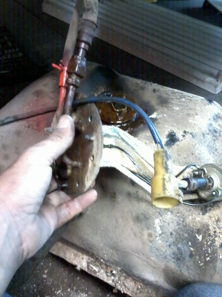

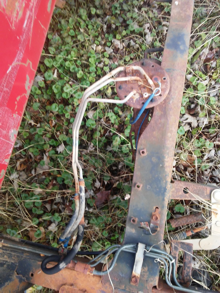

I have never seen an 84 Runner as they are carbed. A pick up tank is different from a 4Runner so I had to modify the Fuel Pick Assembly and make it a 22r Fuel Pickup Assembly. It does have a 22r filter on it now.

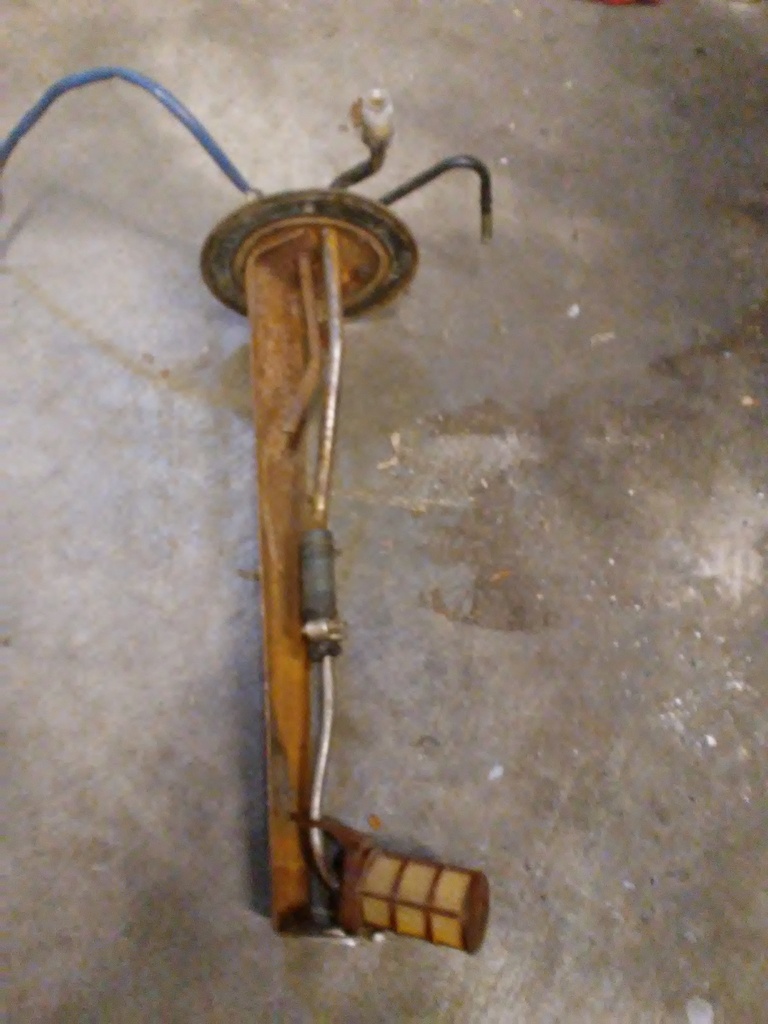

Anytime you get a chance to get an EFI Fuel Pick Up Assembly, grab it. It is a hard and expensive part to get a hold of. This is on my 4x4 frame and I can not get the assembly to seperate from the Supply Line. In that case I will remove the 8 screws that hold it to the tank and drop the tank. Where my finger is, some have twisted and broken the line or in some cases the line just rots away.
These assemblys vary in style, but this one is actually in great shape. It will clean up nicely when I get to it.

Here is another style and it was on my 85. I let it hang the whole time while it was under construction.

It usually takes me about 40 hours to convert a pickup from one to the other. A 4Runner allow a good 10-20 hours more just because you have to remove both rear panels. A pick up everything is down the passenger frame rail and you can get a carbed fuel tank. 4Runners require everything out to access the wiring and the drivers side rear lights are on the drivers side and not down the frame like a pick up. I am not going to get into any hurry to convert a 4Runner. It is a big job.

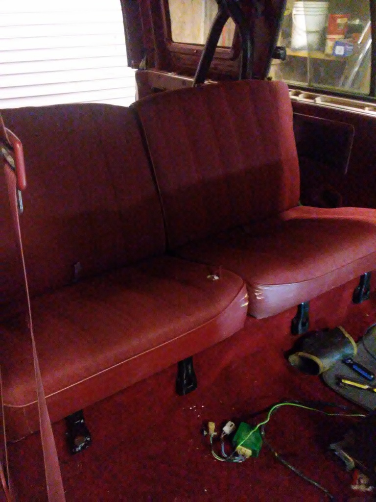

I got the Distributor in, Fuel Tank done. most of the rear interior done. some more dash work done and still not finished with the dash. Wont be long until I am just under the hood. Doesnt look like much from previous post but lets me know I got something done. It will be a true 22r without being a hack job. I am glad I passed on an 88 Runner a while back that some one had tried to remove all of the EFI wiring. Those are always a mess. Christmas break is over for me as I have to work tonight. I was hoping to have it competed on break. If it had been a pick up and I had the missing part, I could of gotten it done.

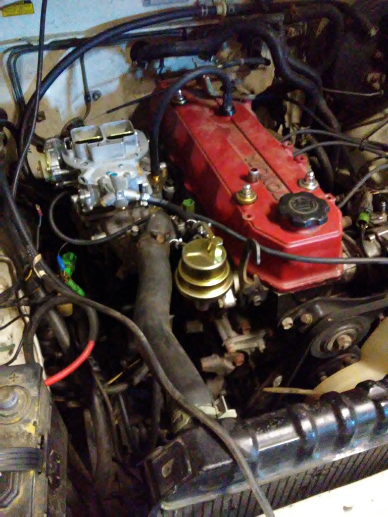

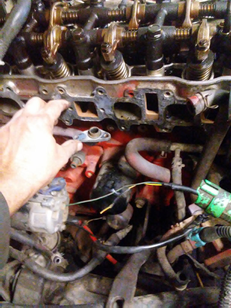

I finally got the piece I was missing. A friend of mine had a junk 20R motor and it looks like it will work. First 20R I have seen and really cant tell the difference from a 22R.

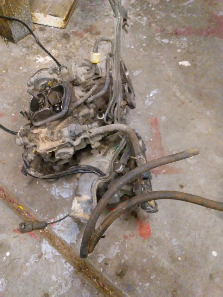

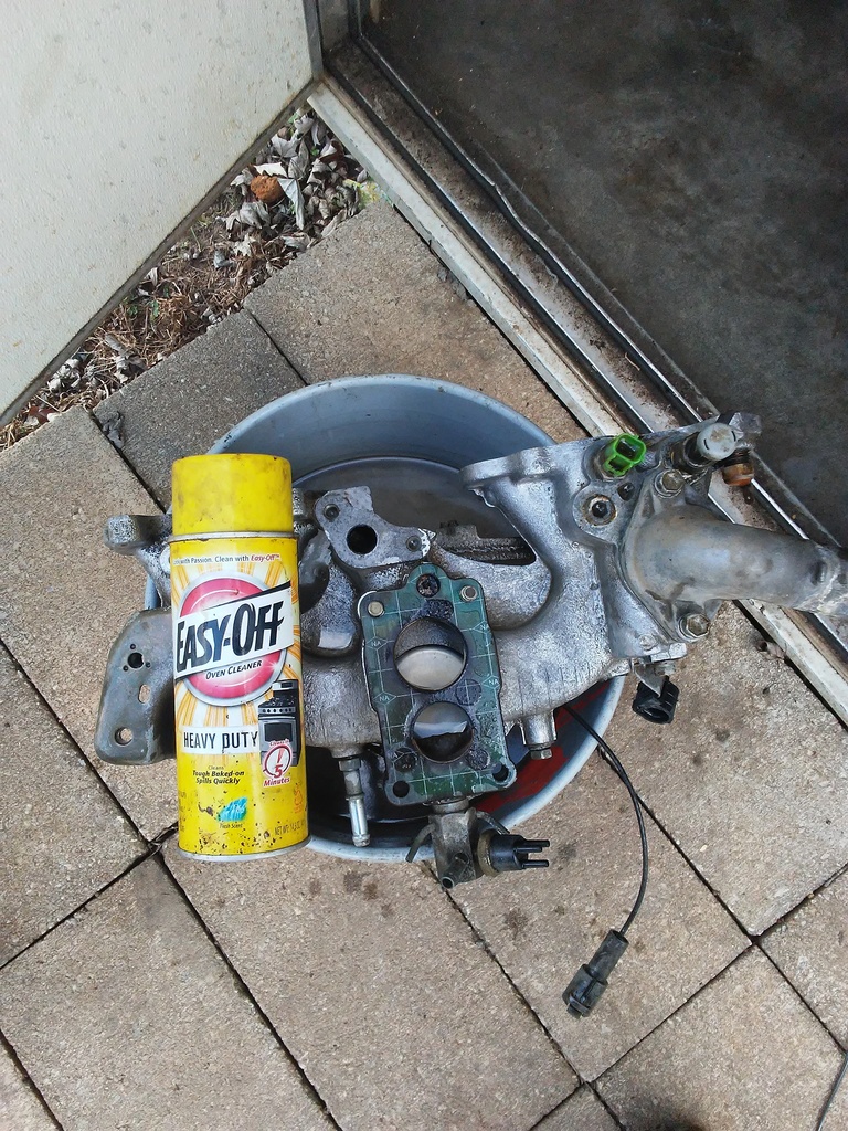

I took the Intake to the carwash to get the grease off of it. It had burnt on oil and would not shine up. I used some Easy Off and it cleaned up quick. I am not getting the water hose out as I have already winterized things but the bucket of hot water worked great on getting it cleaned up. I will touch it up with a wire brush and it will look good. It is cleaner then what it looks in picture.

Its ALIVE!!! A running 22r. Will get some pictures up later as I have dinner and a movie to go to and got to get around.

I was trying to get it at least running as we had planned on going out and the day just flew by down to the last minute. I had been putting the swap off for a while as I was frustrated with all of the time I had into trying to get the Cherry Manifold issue fixed. I even sent it to Toyota dealer twice trying to get it fixed. I still have to get the fuel hoses to the length that I want and extend a few electrical wires and eliminate a couple of wires as the Webber does not need all of the sensor connections. I still have not got to take it on a test drive yet but it will fire up in 1/2 to 1 full revolution of the motor and I still have not put a Timing Light on it.
Needs cleaned up but should be done in the next few days.

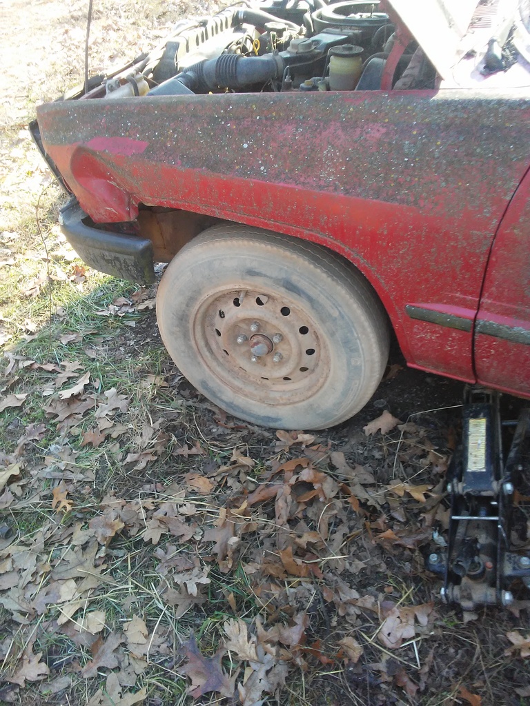

Hope everyone is having a great New Year. I get to celebrate it at work, Urgh!!! I still have to get the 4Runner all put back together but today was a nice day. 57 degrees so I took advantage of the weather to try and get the wrecked truck ready to bring home. It had 3 flat tires and I got two on and still one of them went flat. I checked to see if it had a spare and I am thinking it could be the original spare. It is a bias tire and not sure if it has ever been on the ground. It still had air in it but it is dry rotted. I put it on the truck and it did go flat.
I took my oldest with me to help see if it will start. I turned the motor over manually and it did turn. I poured some fuel in the carburetor and it fired up.The owner told me it had ran out of gas so he just parked it there. It has been sitting 5-7 years and I did try and put some fresh fuel in it and it would pull it to the motor. Either the Fuel Pump or the Lines are clogged. Todays fuel is crap.
Justin was asking me what I am going to do with it and told him to fix it or part it. He wants to fix it. I told him if the frame is bent it might not be worth fixing and then he said we could use a 4 wheel drive frame I have. I had not thought of that as I was on a one track mind of fix or part. It would be a good experience for him. Of course he wants to keep it and I told him I got enough projects already.
Original tire maybe?
