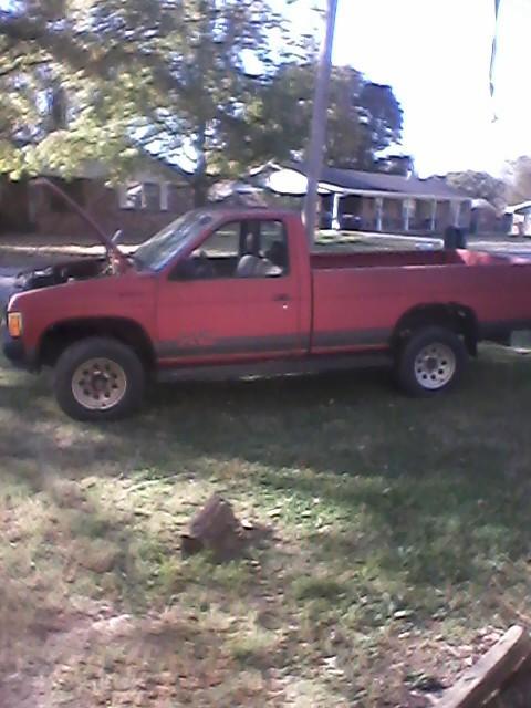

My brother got my dads Nissan that dad bought new in 86. It has 380k miles on it. Dad retired and it was his work truck and it had been sitting. He went to drive it one day and the gas tank was full of water. A squirrel had chewed the vent line and the bed had a hole in it and drained the water straight to the tank. Got the tank fixed but the fuel pump is ruined.
While testing other things, I primed the carburetor and my brother started cranking on it and it backfired and I still had the gas can close to it and had a little fire. Nothing serious but it happened quick. First time for everything. Luckily I had a fire extinguisher near by if I needed it.
I will someday restore this truck for dad but it wont be anytime soon. Other then the bed having some rust, it is one of those one owner older trucks you wish you could find. Dad was very easy on it. I was disappointed to see the wire nuts he used to put on a trailer light kit but other then that it is still a solid truck. Last time I drove a few years ago, it still felt tight in steering, transmission and other areas.
He did go buy him a newer Ford something or other. I bought a new Ford in 98 and tried to tell him quality has gone down hill in Fords. I have already had to troubleshoot his Ford already. He is retired and not driving nearly as much so guess it will work for him but with his old Nissan, you would think he would of stayed with Nissan. They are some great trucks as well. Still working on it is a pain as I have to look in manuals and not something I can just jump right in on and fix without some studying.

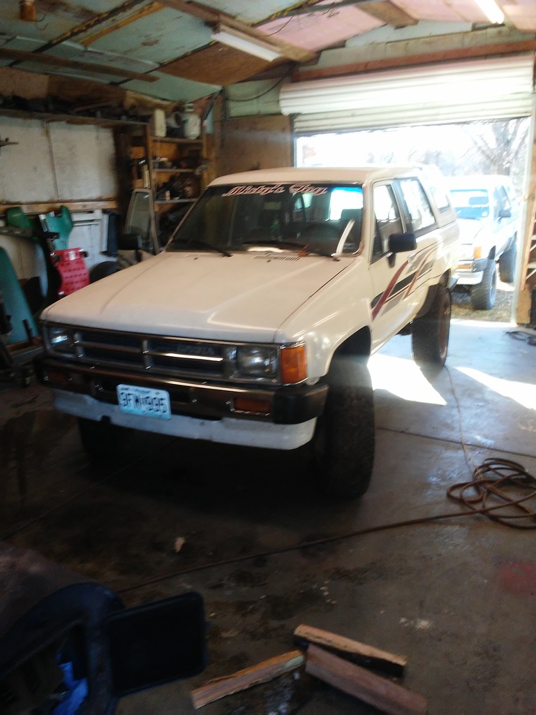

The 88 has been sitting for quite some time. It still has the cherry manifold issue going on. I have had other mechanics to look at it, taken it to Toyota and $95 later they still cant find the problem with it. They said their computer would show where the issue was and it did not. I was a little disappointed in them.
Things I have done, new Denso TPS, Denso, O2 sensor, removed catalytic converter, new fuel pump, tested all the sensors and most I have swapped to known working trucks and they never caused any issues on them trucks, different AFMs, tune up with OEM parts, filters, fuel pressure test, timing verified, valves adjusted, EGR cleaned, tested, and operational, all carbon removed from system, swapped and tested injectors and hours of trouble shooting. I am sure there are other things I have done and have not mentioned like swapping out manifolds and Intake.
I am able to get these trucks to start in one or two revolutions of the motor and running great. This runner is no different but if I drive it for about 8-10 miles, the exhaust manifold will glow cherry red and I am afraid that I will burn up a piston, as I believe it is running lean. I even pulled the motor out of my 86 as I know it is a good motor and has never given me a problem. It too started making the manifold glow. Literally I have hours into troubleshooting this cherry manifold and tons more into research.
Misty really likes her runner and wants to get it back on the road. I told her the only way I know to get it back on the road is to go with a carburetor. She is fine with that. Normally I will run from a truck that has been a fuel injection motor and they try and make it carburetor as all they do is try to remove the fuel injection wiring and it is a big mess. I have yet to see one done that was not a soup sandwich and would suggest staying away from a truck that some one has tried to carb like that.
I have in the past converted from fuel injection to carb and carb to fuel injection. On a runner, the 84 is carbed but I do not want an 84 harness as it has an external voltage regulator and requires a different alternator. I will only do an 85-88 truck harness. That way it is done right and will not be a butcher job.
Today a friend and me went to the bone yard and I got an 86 22r truck harness. I will be ordering a Webber carburetor here soon and will plan on converting it to a 22r. I am going to wait until the heat wave passes here as it is hot. It was miserable getting the harness out of the yard.

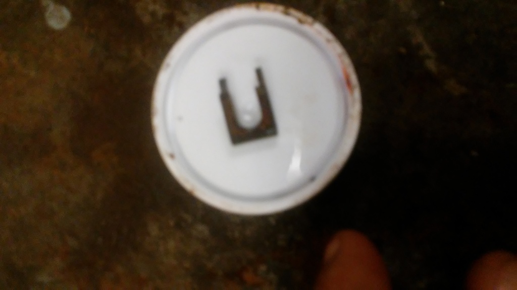

This clip is hard to find and is needed of the linkage. I grab these anytime I can find them.

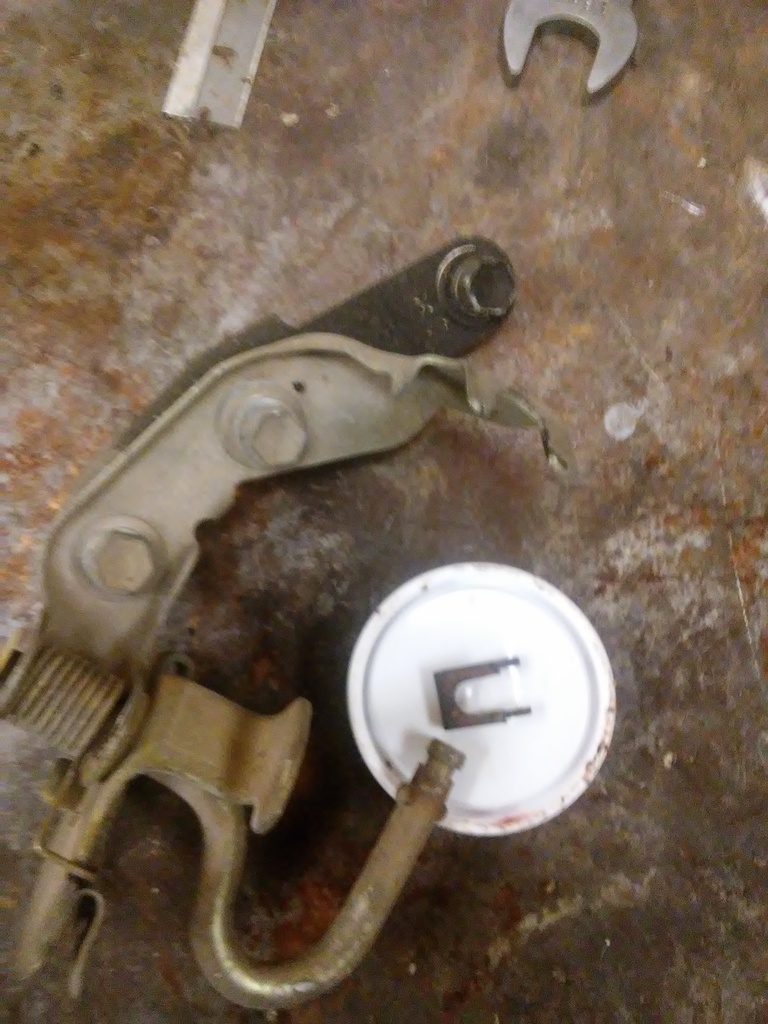

Connects to this.

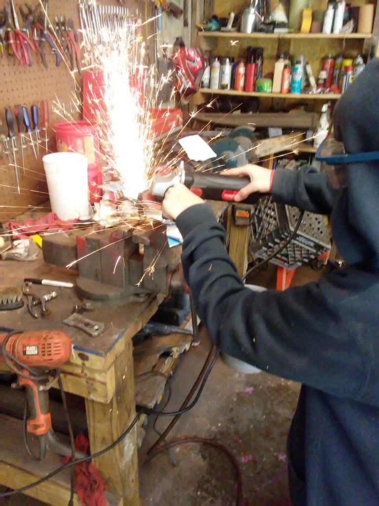

Every time lately I have been out in the shop, my oldest has been there like my shadow. Well my youngest has been starting to want to get involved and I had a bolt that I need to save for my Ford truck build and let him cut the shaft down so as my short socket would get on it. Here he is cutting the shaft. He was a little concerned using the cut off saw. He did like getting to cut it.
I explained to him on how heat works on some rusted bolts. Here is his first time with the torch. I did not get a picture of him using the Impact Wrench but he liked how it all worked to make it happen.
