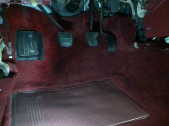

I try to hide the mileage and age of this truck. It has 320k miles on it but the pedals still tell the signs of it getting used. I replaced them once. It is just something I look at when looking at used cars or projects. Later on I am going to go thru all the brakes on this truck after getting it back on the road.
I will say I like how stockinteriors.com carpet has held up for the red color. The gray color looks alright in my 86 but I would try gray from a different manufacture. Red I would go back to stockinteriors.com.
Tattle tale signs of the brakes getting used. Not sure why the carpet has a black spot on it in the picture as it still looks new.
Black spot = shadow maybe?

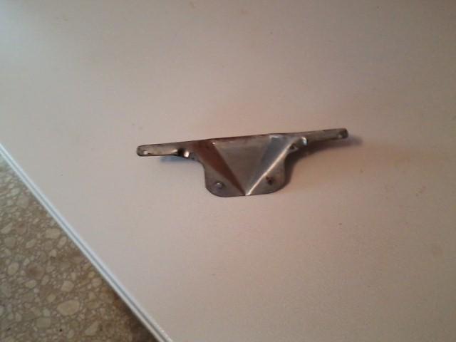

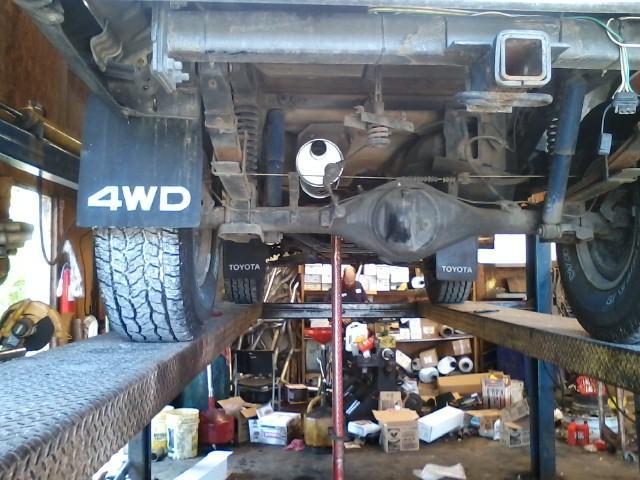

I was messing with the exhaust and the pipe broke off in the muffler. It was getting in bad shape so I just took it to the muffler shop and got the whole exhaust replaced. Still need to put some trim pieces back in on the interior and then hope to get back to a few other fixes. Some how I have an oil leak I need to chase down and start taking it on some test runs and see if I have all the bugs worked out.
I did see Misty had one of the wipers replaced and my guess is she had one of the parts store guys to put it on for her, something I was unaware of. She only had one replaced. I replace the in sets. You can tell she has two different brands on. She was probably trying to save a dollar or two. At least that will be an easy fix.
Getting a new exhaust system. I was asked by another member recently and just to keep track of my expenses on this build , but from the "Y" pipe to the end it was $130.

I despise jury rigging things but I had an exhaust leak at the manifold to head. I had a new gasket but still got a leak. Most gaskets are basically a thin card board gasket. I checked my local parts store for a better gasket. The Beck Arney was $45 from them and was going to take a week to get. I ordered one from ebay and getting the exact one for $25 shipped.
In the mean time I wanted to get it sealed up and stop leaking. Seems to be working fine. I wanted a thicker gasket that had some crush material to help seal it. Instead of waiting I had an extra gasket. I drilled the rivets out and installed it on top of the new one I already had. I did not get more pictures as I am having to use one of my brats computer to post pictures.
Here is what is left after I drilled it out the rivets. The piece not showing is what is used to have a thicker gasket. Not the kind of fix I wanted to do but is working for now. May actually not be a jury rigged fix and might be something I will do the next time I get in a bind. I am going to leave it as it is and will have a spare exhaust gasket next week.

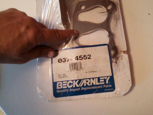

Another news thing I just found about the collectors someday http://www.foxnews.com/leisure/2015/...resectionlists
Rear window switch>>> https://www.yotatech.com/forums/f131...switch-242554/

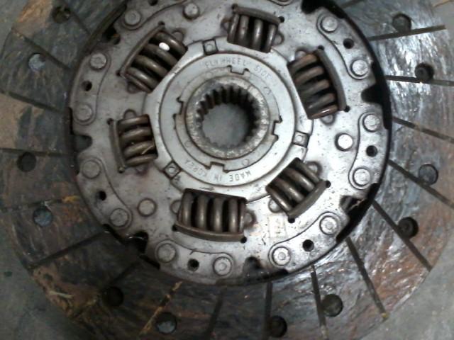

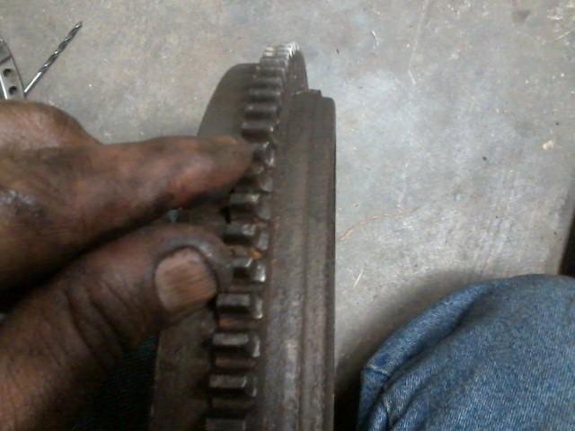

I pulled the transmission out thinking I had a Rear Main Seal leak. I am now sure it is the half moof that was causing the leak. I used a new seal with sealant on the seal and it still leaked. I think I got that fixed.
While I had the transmission out, I had to replace the flywheel as it has some bad teeth on it. It would only land on the broken teeth once in a great while and it did it the other day. Wish I would of remembered it when I swapped the motor out on it recently. Oh well guess now is as good as any other time.
Here is the teeth that are chipped. Doesnt take much.
I forgot which way the clutch actually mounted to the flywheel. Luckily I had an old clutch laying around. I was sure the flat part went to the fly wheel and the hub part went to the toward the transmission. Mostly a reference picture for me, but I have run into clutches not always marked.

I changed the flywheel on the 88 and put it all togther. It started slipping in the higher gears. Never understood why a clutch will slip at higher speeds when there is less torque on it then when at lower speeds.
I suspect the flywheel I used was the culprit even though it was turned and in great shape. I did not want to pull the transmission again and not sure why the clutch failed so since it had to come out again, I just replaced the everything with a new clutch and flywheel. It is $25 to turn a flywheel or $55 for a new flywheel. From now on I am just going to replace flywheels when doing a clutch.
