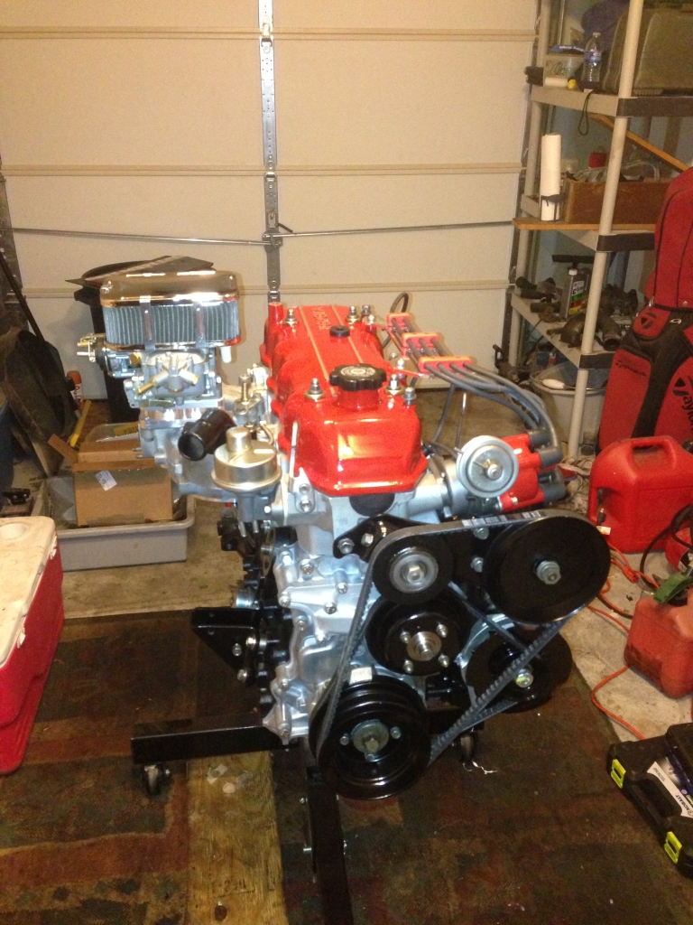

I recently wrote a thread regarding the rebuild on my 22R for my 1983 Toyota Pickup (My 22R Rebuild - KawaZX636). In rebuilding my engine, I completely eliminated any and all factory smog equipment. Since I created that thread, I have been approached by several YotaTech members with questions regarding the desmogging of a 22R. I don't mind helping, but it has become rather time consuming answering all of the questions I have received thus far so I decided to create a thread on desmogging a 22R. There are other threads out there that discuss the desmogging process, mainly Pumkinyota's De-Smogging an early 22R thread. Pumkinyota's thread is highly informative, but it has become inundated with questions and uses a slightly different approach to desmogging a 22R which involves capping vacuum hoses and utilizing the factory carb (no offense intended to you Pumkinyota).
In this thread, I will go over all the smog equipment, vacuum hoses and vacuum switches that need to be removed as well as which LCE block off plates to purchase and install in order to completely and effectively desmog a 22R engine. This desmogging guide will also utilize a Weber 32/36 carb with a manual choke. This guide will be based on my most recent 22R rebuild with the engine removed from the truck; however, all step shown below can be completed with the engine in the vehicle. I BELIEVE that desmogged the 20R is very similar to the 22R, but there may be slight variations.

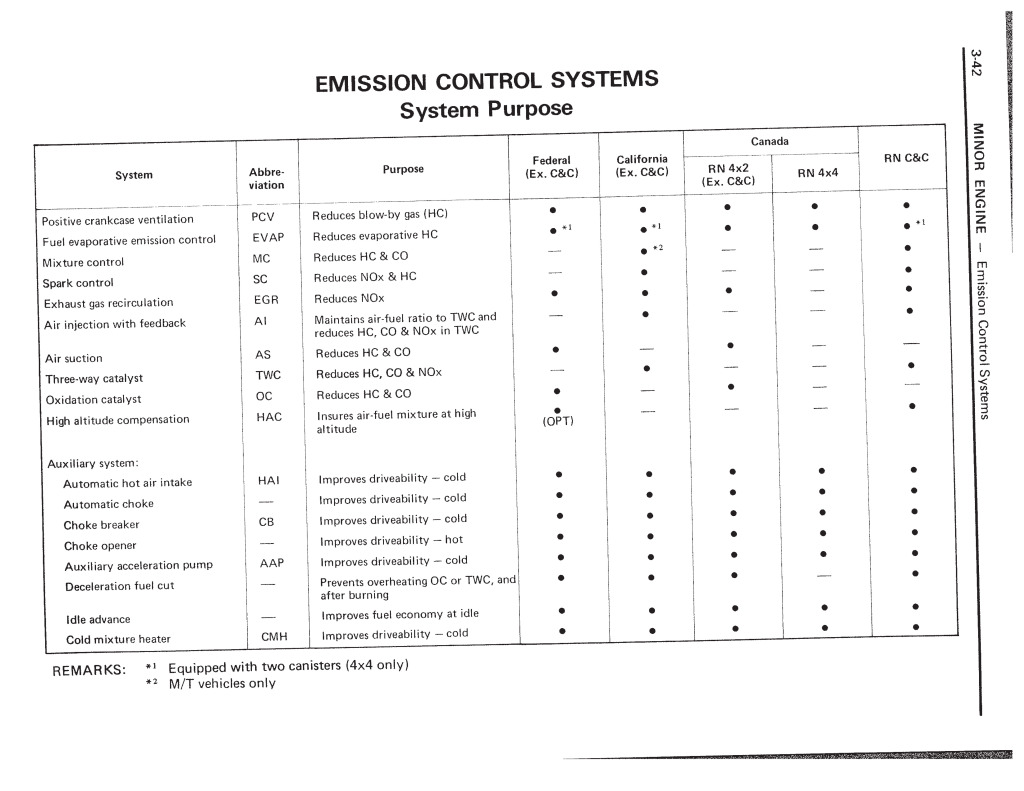

Here are some valuable resources to reference the smog equipment under your hood. These images come directly from the 1983 Toyota Pickup FSM. When asking questions, it's good to know what you're talking about and use the appropriate part name since the smog systems on Toyotas are quite extensive.
This image provides the abbreviations and functions of each piece of smog equipment:

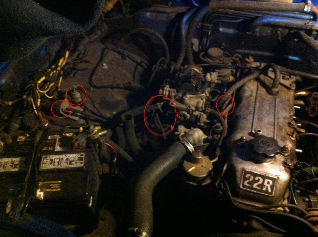

The quickest and easiest way to rid your self of smog equipment is to hike up your britches and start yanking anything with a vacuum hose attached to it. Be brave, because at first you will second guess everything you should remove, but keep in mind that YOU DO NOT NEED SMOG EQUIPMENT FOR YOUR ENGINE TO FUNCTION PROPERLY!
Below are items that you can start to tear into first.
Counter clockwise from the top left circle:
-EGR Vacuum Module and Outer Vent Control Valve
-The pesky hard vacuum lines (remove all the vacuum lines attached to it too)
-Thermo switch
-Air injection piping (on the exhaust side of the head attached to the headers)

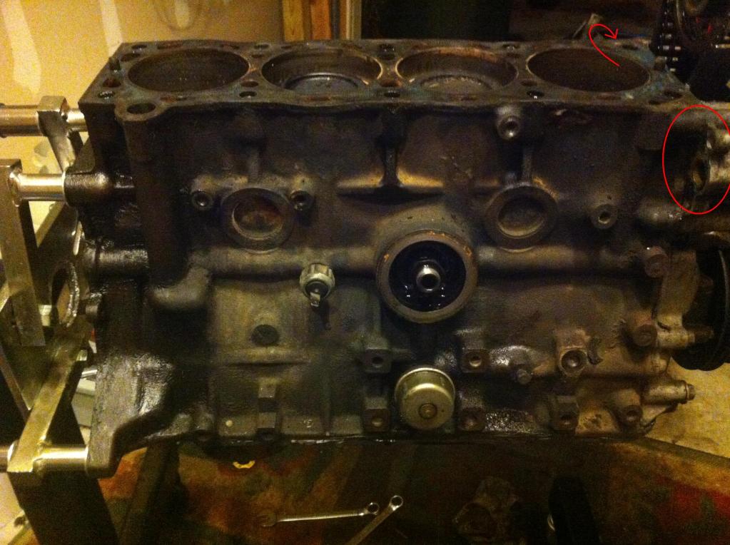

This is optional. There is a plate on the base of the intake manifold that has a temperature sensor for the electric choke (I believe) - I prefer a manual choke simply because manual chokes are far less likely to fail. The LCE plate does not allow you to retain the sensor housing, but will have a fitting for the heater core:

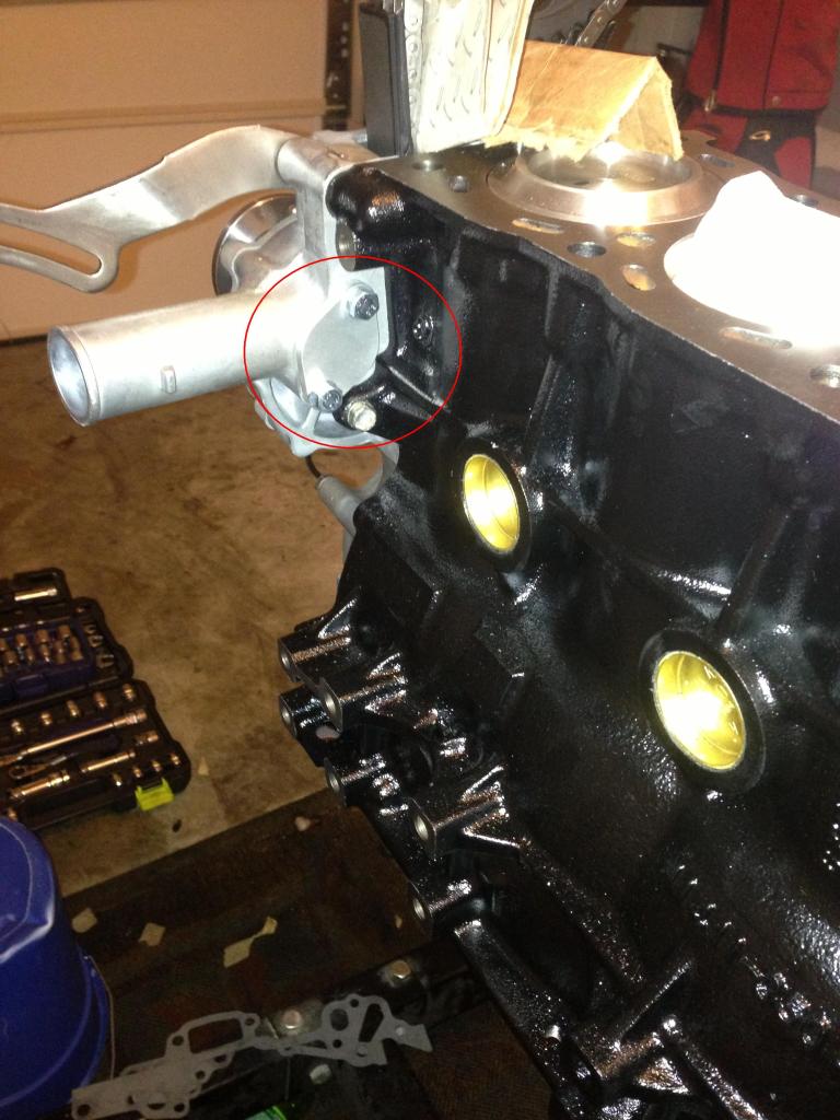

First, water block plates in the LCE Pro Water Block Plate Kit. Two of them go right on the back of the timing cover (note, I was rebuilding my engine when installing these, you DO NOT have to remove the head to install these plates as seen in the pictures, but make sure that either the gasket is in good condition or use some gasket sealer when installing these plates):

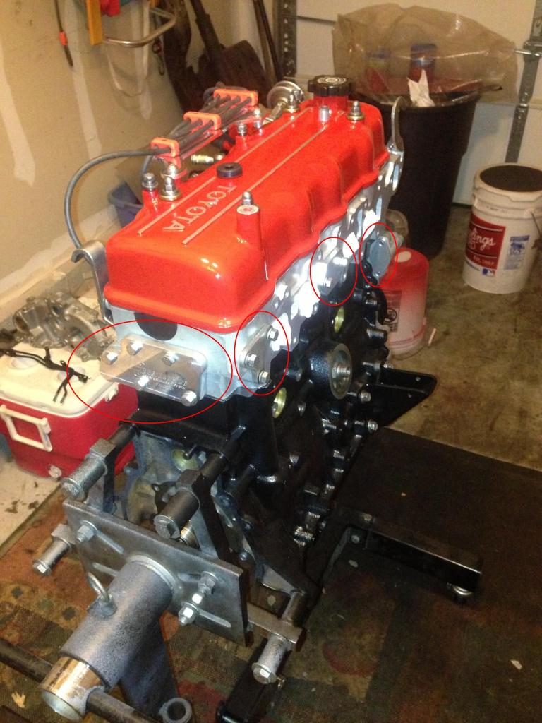

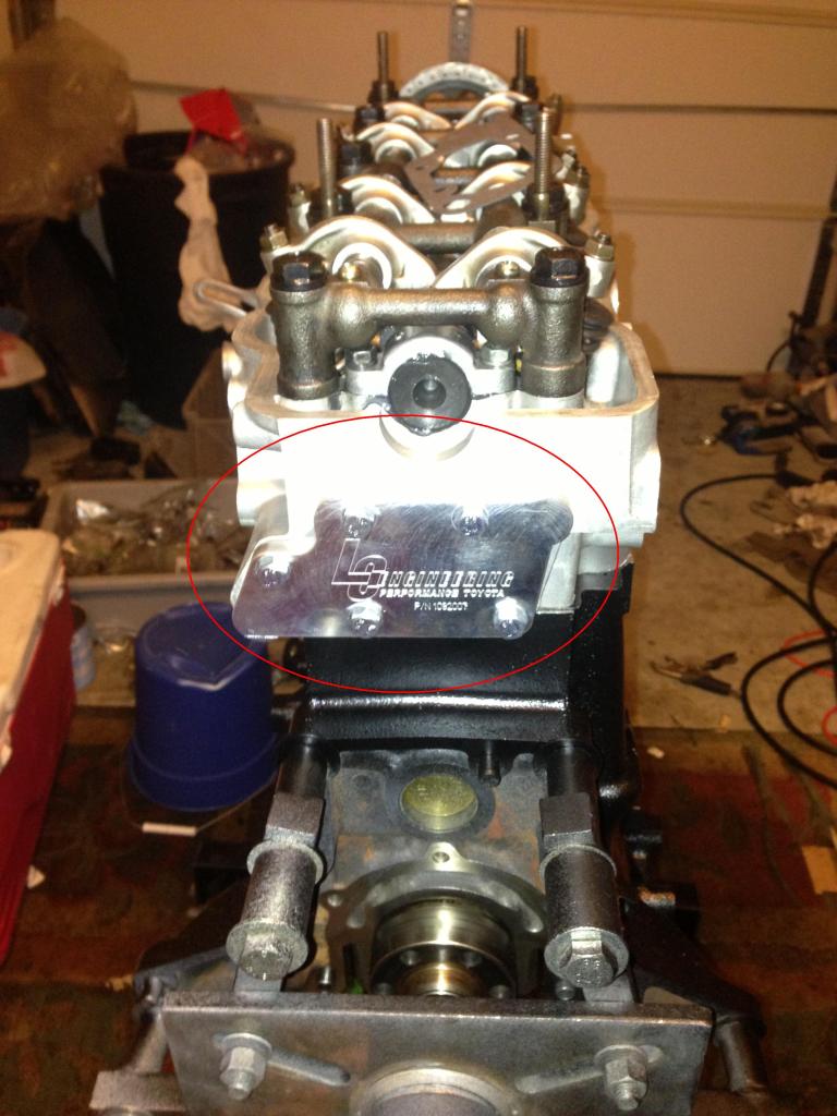

The other plate in this kit goes in the middle of the head on the intake side (Second circle from the right in the pictures below). This was just a mock up from me, but the intake manifold gasket runs between this plate and the head. Make sure that gasket is good or use gasket sealer.
Also in the above pictures, is the LCE EGR Block Plate Kit (second circle from the left). The intake manifold gasket also runs between this plate and the head so, again, check the condition of the gasket or use gasket sealer.

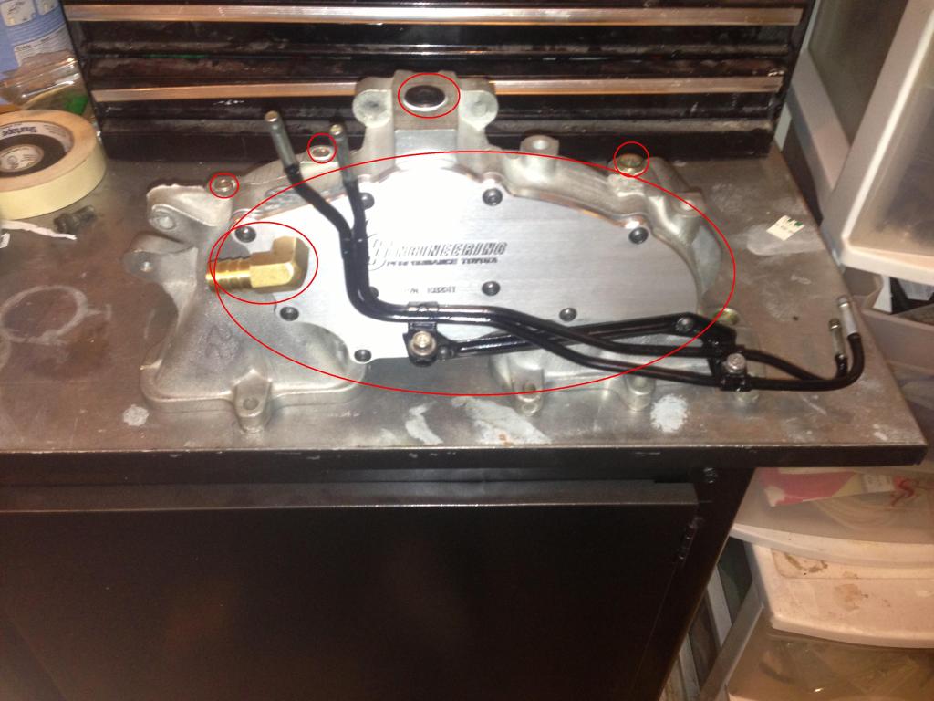

Next is the LCE Water Block Plate Kit (11 Bolt) located under the intake manifold. The elbow fitting supplied with the kit is for your heater core (optional if you choose to keep your heat) and new bolts are included with the kit as well. The factory hard fuel lines will bolt back up if you decide to keep them (recommended). Also in the below picture, you can see the locations of the plugs that come with the LCE Intake Manifold Plug Kit. The far left two plugs were temporarily plugged during my build, but will later be used for the brake booster fitting and the manifold advance to the distributor.
Here is the intake manifold bolted up. Notice the plug locations, the EGR block off plate to the left and the water block plate in the middle of the head. The barb fitting with the yellow arrow pointing to the PCV valve is an option. That particular plate and barb comes with the Weber kit; however, you can use the LCE EGR Block Plate Kit (Carb Manifold Plate) which DOES not have a barb and utilizes a breather filter on the PCV valve (for race applications). I would not recommend using the breather filter on the PCV because it can get reeeeeally messy under your hood really quick if something goes wrong.

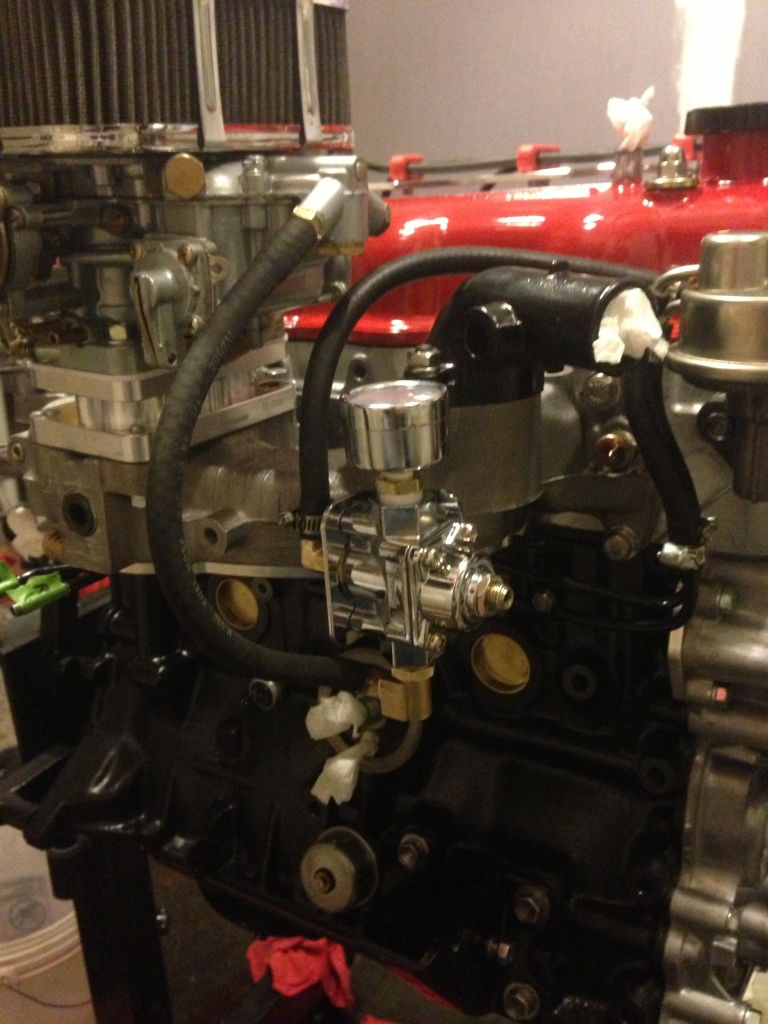

Now you can start the plumbing. Run a hose from the PCV valve to the manifold using the barb fitting that came with your Weber (note, if you chose to use a breather filter on your PCV valve then you will be installing that instead):

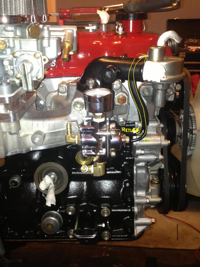

Install the Holley fuel pressure regulator. I used the bracket that came with the regulator and mounted it to the intake manifold. You can either do this or run it back to the fender wall. I prefer it this way because it is cleaner and keeps the hoses to a minimum. You will have to use the 3/8" NPT male to 1/4" NPT female reducer fitting to install the gauge and the 3/8" male NPT to 1/4" barb fittings to attach the fuel hoses. Run the Fuel "IN", Fuel "RETURN" and Fuel "FEED" lines as shown below:
Make sure that you have the Fuel "IN" and Fuel "RETURN" lines hooked up properly at the other side of the hard fuel lines under the manifold and at the tank. You will only need about 6 ft of 1/4" fuel hose to do the job.

For the port in your valve cover that sits just behind the oil cap, you can do one of two things:
1) Slap a 5/8" inlet breather filter on it and plug the hole in the Weber filter housing or,
2) Run a 5/8" hose from the breather port to the fitting in the Weber filter housing that comes with your Weber
I recommend #1
Don't forget to hook up your heater core and brake booster vacuum.

The vacuum switches and sensor plugs that come from the wiring harness on the passenger side fender wall can either be plugged or taped off with electrical tape OR if you're feeling froggy, you can track all of those wires back to the Emissions Control Computer located on the driver side kick panel and completely remove all of the emissions electronics. I plan on removing the wiring from my truck when I get to the body work on the cab so I'll do a write up on that as well later. Meanwhile, it does not hurt to just have the wires and vacuum ports plugged or taped. The emissions equipment only "communicates" to its self so if there is no emissions equipment then it's talking to nothing! If you used all the block off plates mentioned above and removed all the smog equipment attached to the engine and manifold then THERE SHOULD BE ABSOLUTELY NOTHING TO CAP OFF.
FILL YOUR ENGINE WITH COOLANT BEFORE STARTING!!!
After you complete your desmogging you WILL need to time your engine and adjust your carb. IT WILL NOT RUN PROPERLY if you do not do this! The timing for a 22R should be 5*BTDC at 700-950 RPM WITHOUT the Vacuum advance.
Now your engine is officially desmogged!

A couple of notes before I let you guys have at it:
1) You can make your own block off plates, but I would highly recommend going with LCE's products. They are the front runners in performance Toyota parts and they provide quality parts and service.
