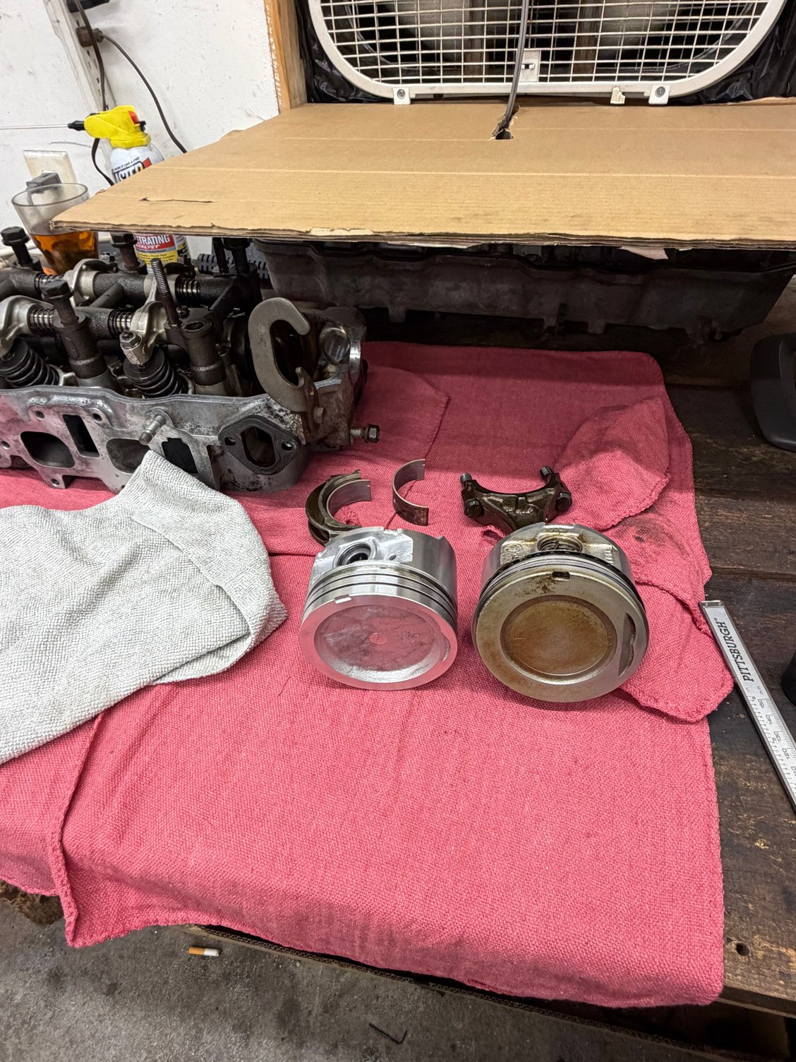

I wholeheartedly don’t expect this engine to last long because I can’t get the wastegate to go 8psi so I have another engine to build with RET pistons.
I pulled the engine from a truck with 59,000 miles and didn’t really like how the bearings and crankshaft looked. So I’ll be working on polishing up the crankshaft since there’s no real grooves, thankfully the bearings sacrificed themselves.

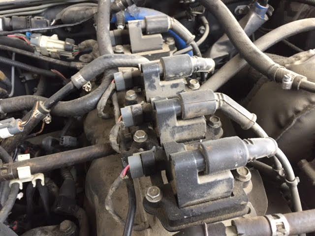

I just got my SNP innovations full harness kit with the haltech elite 750, got it laid out and preparing to do the install tomorrow. That is a nice setup you’ve got there! What type of coil setup/crank signal setup is that? Very cool!
Old Apr 9, 2026 | 05:03 AM
davefarr's Avatar
Posts: 122
Likes: 13
From: Yellowknife, NWT, Canada
The ecu, nice unit and capable but obscure.

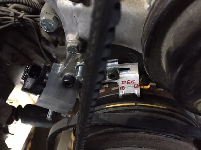

https://controls.is/shop/ecu/lpc8gen2

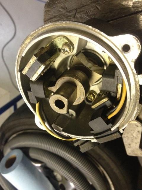

Coils are LS truck, crank trigger is no longer made but that a Ford VR sensor on a 36-1 trigger, harmonic was machined to accept and welded on.
Cam is using the gutted dizzy.

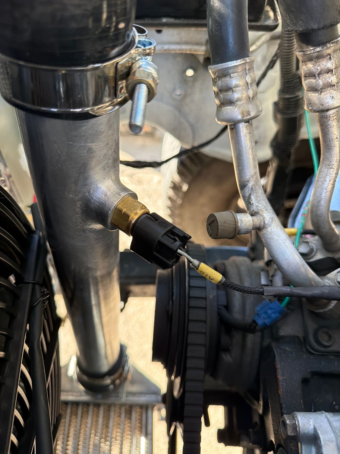

I have to say this kit from LCE built by SNP is a very nice piece and was a breeze to install.

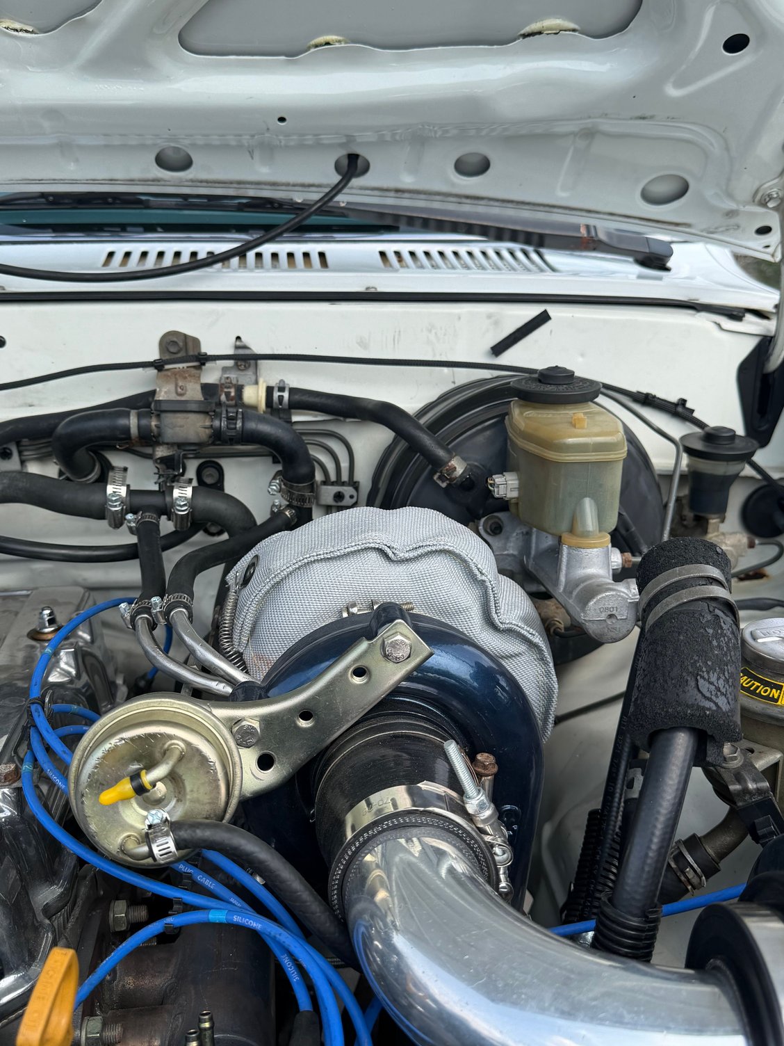

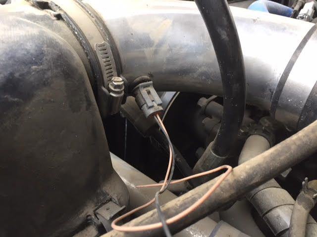

only thing I really felt was necessary was moving the intake air temp sensor to the charge pipe. The intake manifold was heat soaking the sensor and I was seeing 200+ degree intake temps all the time.
now I see just about 20* above ambient temp which isn’t bad for having the intercooler facing down.

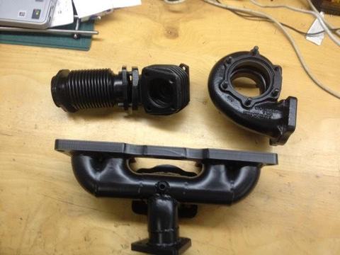

My home made manifold keeps cracking (probably because we used cheap Chinese stainless)
my buddy who fabbed the manifold warned me not to use that material so here we are. Crack #4
though I have 650ish miles on the setup and the manifold is my only issue I’m pretty happy with how the truck drives. Amazing to use 5th and do 70+ effortlessly uphills!!
the underwood temps are pretty serious so I’m hoping this cheap blanket helps.

Had three locations for the IAT, settled for in front of the TB.

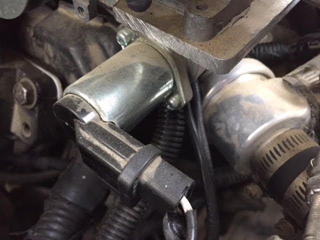

Originally Posted by davefarr
I see the ford style IAC do you have any pics of how you adapted it to the throttlebody?
Old May 16, 2026 | 11:48 AM
davefarr's Avatar
Posts: 122
Likes: 13
Very easy on these- 3/8in aluminum plate and trace each side- drill two holes.for air (directional) and two/threaded for mounting. The GM stepper is more difficult with this ecu and you have to be VERY careful about +- on the PWM wiring, the ecu has to go back due to this and be repaired.
Here’s what I came up with before you replied (waiting for my ford IAC to come in the mail)
Old May 16, 2026 | 02:04 PM
davefarr's Avatar
Posts: 122
Likes: 13
As far as I know the IAC is motorized in one direction and spring loaded in the other- there is a direction for air flow to help load the valve in the correct direction.
