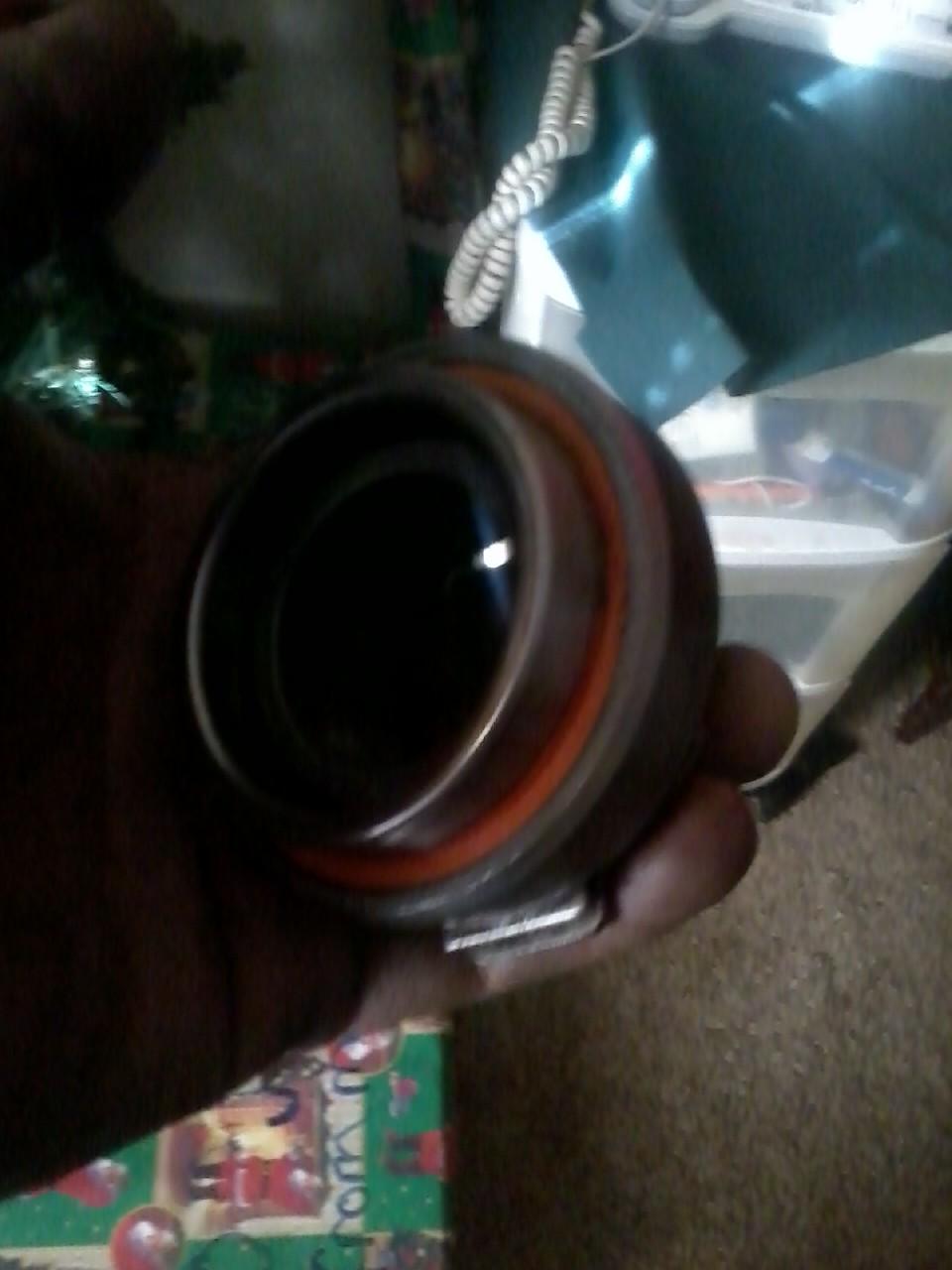

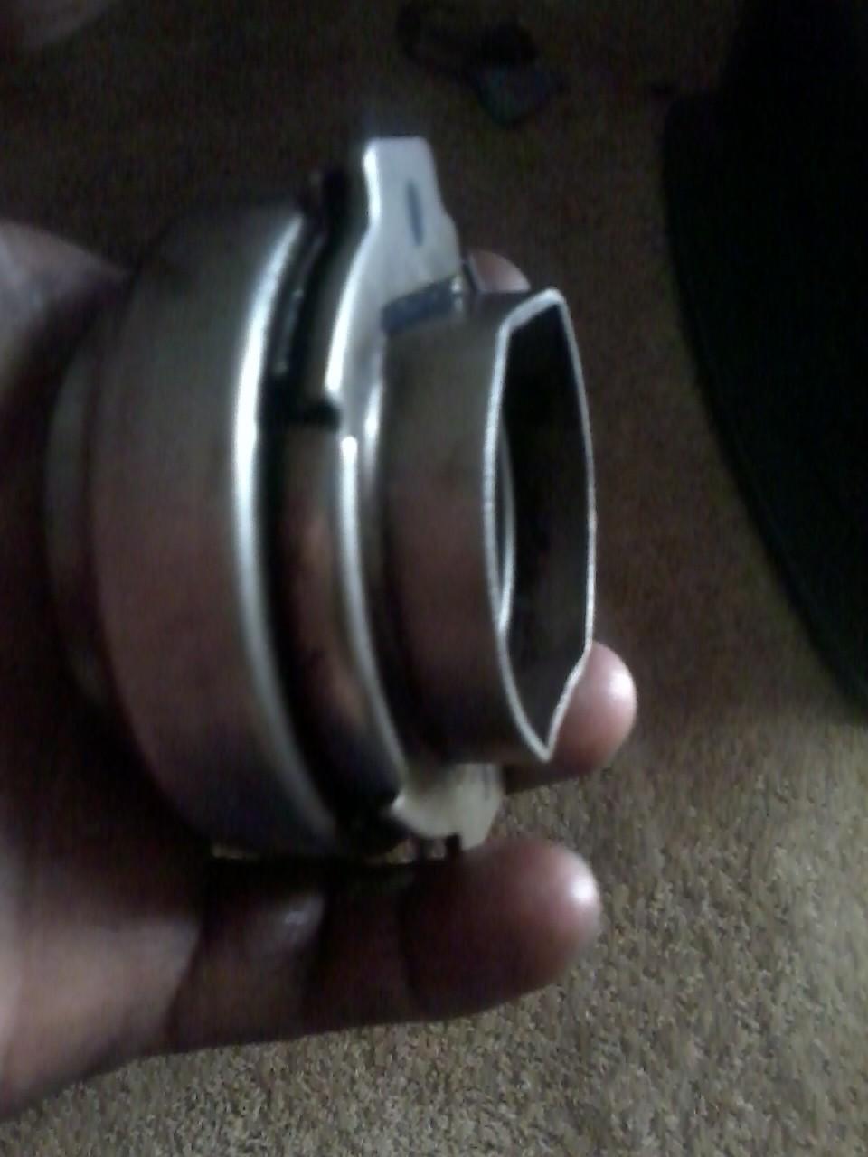

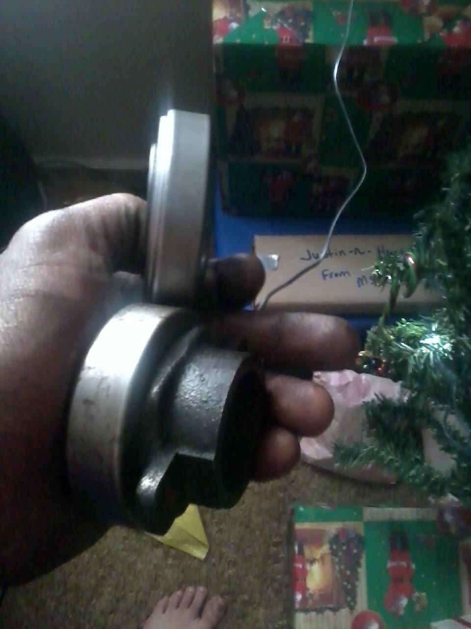

Basically, I have run into the same problem as this thread>>> https://www.yotatech.com/forums/f116...cement-208121/
Parts store gave me a bearing for a G52
I need the W56 and not sure how to get it off. Guess it will need pressed once I get a W56 bearing.

It will be Monday before I can get the part. None of the parts stores have the correct bearing in stock. Anybody got any suggestions, I am all ears. I could of gotten the motor in the truck today if this hadnt held me up.
THIS IS the same problem I am having>>> https://www.yotatech.com/forums/f116...cement-208121/
Another post http://forum.ih8mud.com/79-95-toyota...ring-help.html
Just moved the thread from upabove so it will be easier to find.
Monday I do know a guy that will have alot of information on this and when I find out I will pass it along.

I remember back in the old days, you could buy TO bearings with or without collar. Nice work everything is looking sweet. .........Nice feet dude.

Hey Terry, ........
I did do a write up on this, early on in my build thread(OK, early on WITHIN REASON, lol)..... I believe I was getting the clutch in at that time....
First off... I got the bearing at Napa... not sure if you were asking that. It's a Koyo.... BUT, seems Napa has gone full on 'CHINA' over the last few years... like most everyone else. Hey, they gotta compete, I get it.
If you have the bearing... as it seems in the pic....
I will try to find that portion of my thread........
Old Dec 16, 2012 | 02:13 PM

Hello ksti...I just couldnt believe a Throwout Bearing would be so difficult to find. A friend of mine had a used one and I liked how it rotated better then my new one so went with it. Somehow my sexyless feet get into a few pictures. I try different angles to avoid some glare but my views of my feet the glare may be the better thing.
Thanks Mark..I didnt like my solution to the Throwout Bearing but we have colder weather coming and it was such a nice day, I didnt want to waste it. It gets to cold, I will just have to sit. Supposed to be cold tomorrow but better the days following.

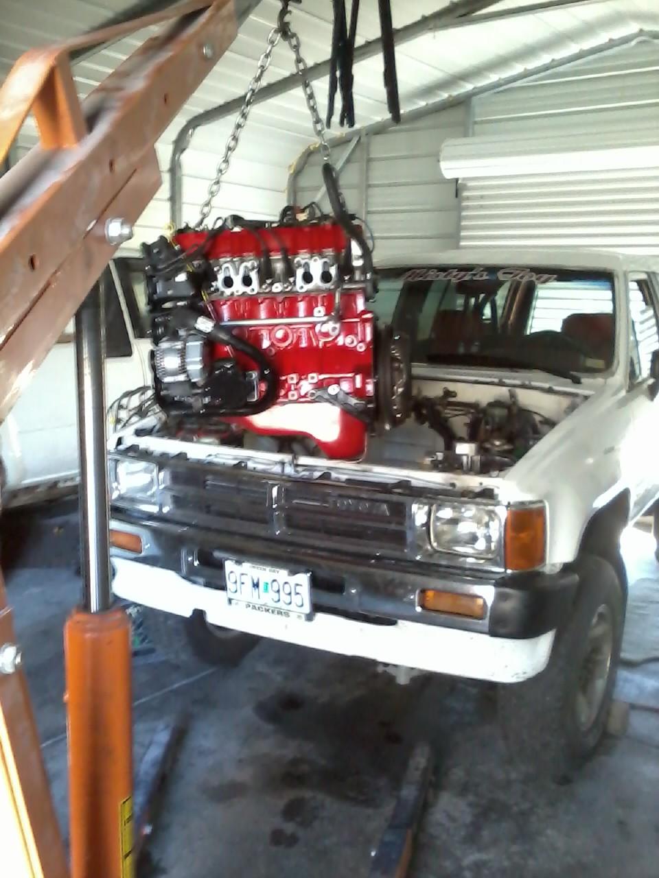

Putting the motor in, always get nervous when a motor is this high in the air.
I like to put the tranny in first then the motor, when I try to put the motor in first and then do the transmission, I have spent hours trying to get the transmission shaft to line up. When I do it this way, I usually can have the motor and tranny connected in less then 10 minutes. Always scary as it seems to easy. I use screwdrivers as long dowels to guide the motor to the tranny.

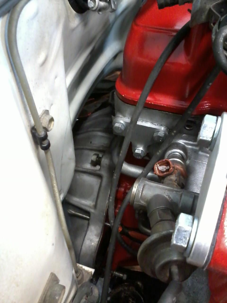

What I like with the EGR off is I had the tranny bolt tightened with my fingers and then used a box end wrench and had it done in no time. Changing fuel filter is going to be so nice the next time. Put silicone grease on all electric connections.

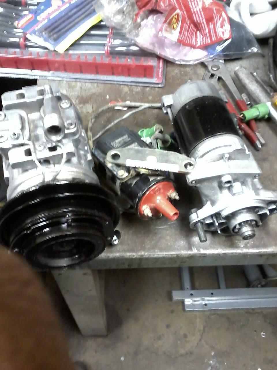

Did get the starter and AC Compressor cleaned. Also a while back I got a coil/igniter for my 85 truck that I will be starting on soon. This is the first $10 I have spent on the truck. I am waiting for another blcok off plate from Toyota so this could hold me up on getting it started.

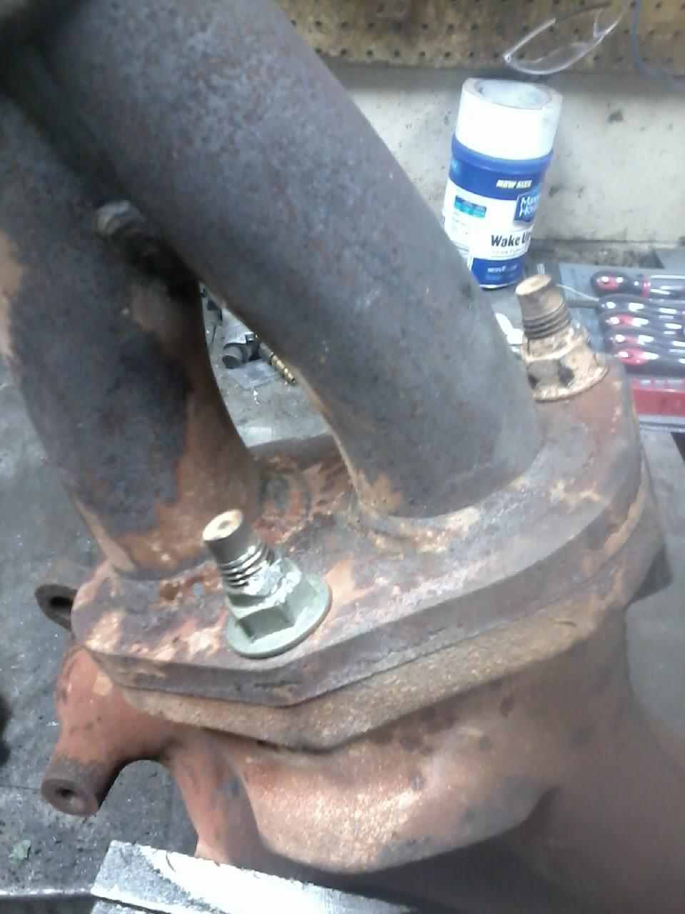

Toytota called and said my other block off plate is in. I cut the exhaust off to make putting it back in and getting it out alot easier. Once you break the connection from the exhaust to the "Y" pipe, I have had alot of problems getting it to seal back up. It cost me $15 to have a exhaust shop to connect the cut part back up for me.
I did have a missing nut on one of the studs. I staked it and knarled up the threads. If I had a welder I would weld it so it could never come loose again. I dont like headers and always had more problems with them. Once the studs come out of the manifold, I have never been able to make them stay in even with new studs. I never thought of it but think it was Mark that said you could helocoil them. Dohh!! cant believe I never thought of that. I recently scrapped a good one out. Jason suggested staking the nut on this one. I just took it a step further.
Doing my best to make sure I never get an exhaust leak. Now just got to make sure I get a perfect seal on the head.
