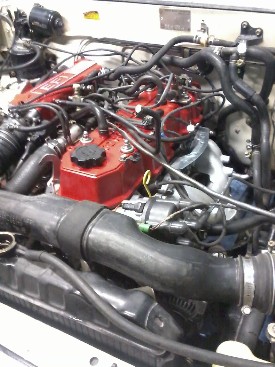

Well one of the benefits of the not so rich and famous is when I had the tranny out I should of done the clutch. I ruined my old bearing cleaning up the clutch fork and thought I would use another bearing and it is making a noise so I will just have to wait til I get paid to go get a clutch. Her motor and tranny is the same as mine so I used the bearing style that I have. One must be a W56A and the other a W56B, I dont know. Something is different.
I will just buy the whole kit and do it right but will have to wait til tomorrow to get the clutch. Then the weather is going to be an issue, as we are getting some cold moving in so dont know when I will get it back in. So I get to enjoy my fringe benefits for awhile, trying to think positive.
On better news, it is running and sounding great. Got the dizzy in right and timing set, runs smooth and so far no leaks. A friend of mine came by and has way more experience then I do and liked how well it sounded.
Didnt get a picture of it, but he took an 84 solid axle and combined it with the turbo truck. He did an outstanding job on it. Then sold it to a guy who painted it and did alot more to it. My friend just bought it back.
Other then Power steering, the motor is done. I am going to straighten the wires and hoses out later for a cleaner look.

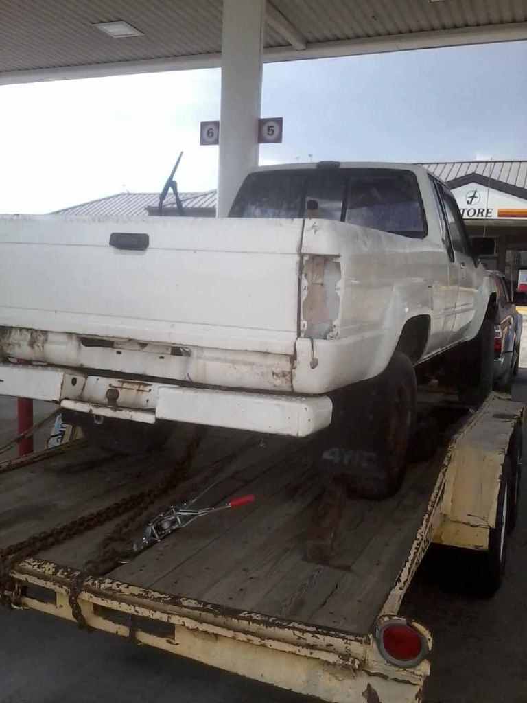

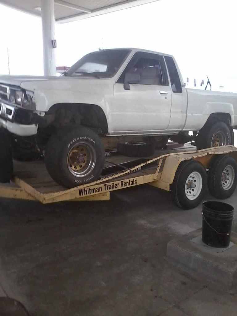

Another reason I want to get Mistys truck fixed besides being a daily driver, and I nearly have my Runner done with exception of interior,rear bumper, and side mirrors, is that I am gearng up to start restore thread on my 85 Extra cab. I bought a standard cab truck to fix and sell and this Extra cab one was either take it or it was going to the crusher in a week. Free Toyota... Let me think about that for a moment. A split second later, I owned it. It was used as a parts truck and is alot worse then what it appears.
Head is gone, wires butchered, paint job that is peeling and has runs, an 89-95 dash that was just held in with 5 small tabs of metal and the rest of the dash just resting on the steering column and some seats that looked liked they came out of a conversion van. The doors would barely shut. This will be the third parts truck that I will be restoring.
Mistys Runner I started on January 11th of 2011, My 86 Runner I started on January 11th of 2012 and I will start on this one on January 11th 2013. That keeps all of the dates the same and lets me get the rest of my projects wrapped up as far as I can go with them.
I am not into the solid axles but more because it is EFI and solid axle and makes it a little harder to find. I like the extra cab as I am 6 feet tall and from what I am finding out, it seems to me the solid axles ride a little smoother. This one will be about as stock as can be as I want my 86 to be the one I really fix up to be extremely nice.
I will do a full frame off restore on it as the drivetrain is already out and really all that is holding the cab on is 6 bolts, steering shaft and a few lines. I want to try and get some good pic to add to my frame body swap post for others.
