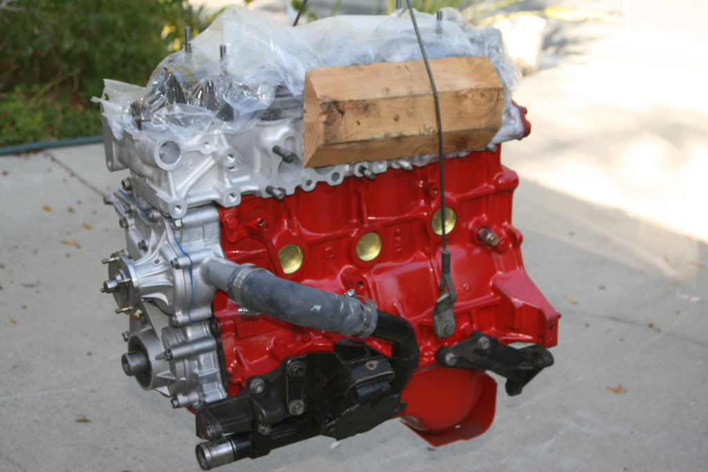

WOW, looks great.... And yes, Richard is right... looks similar to the red I chose(Ford Engine Red).........

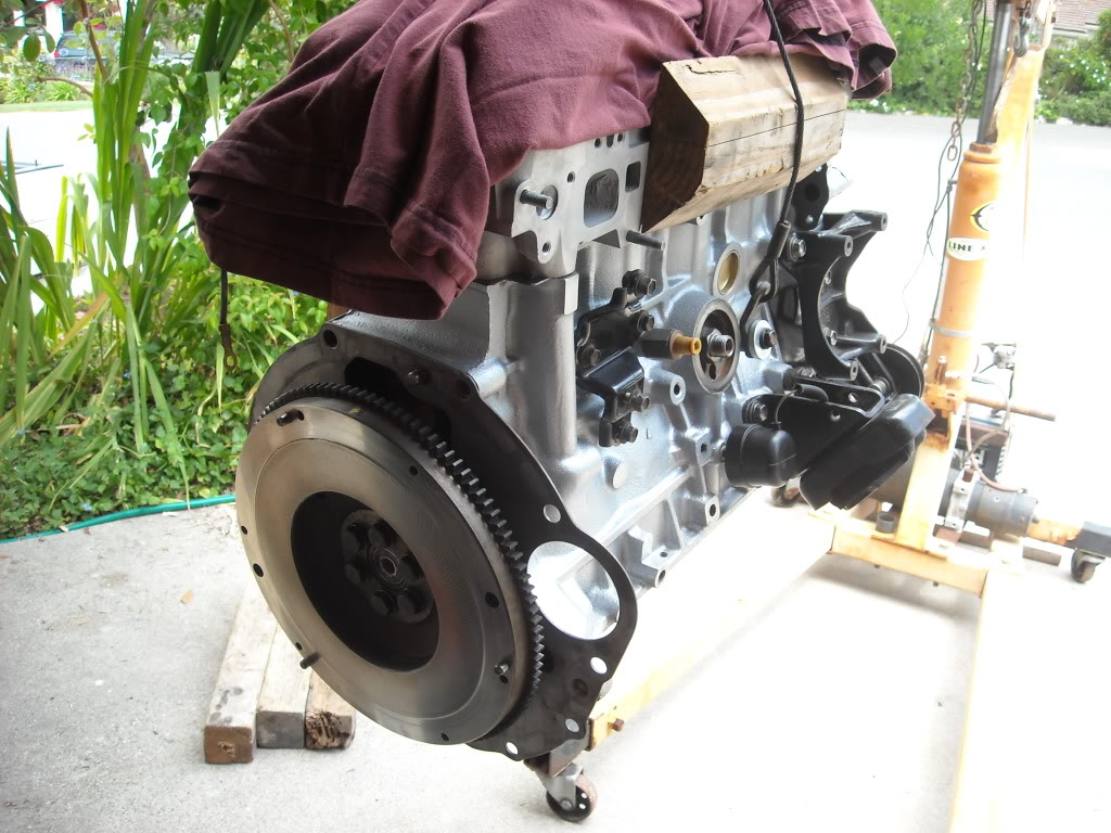

Course... now I went "Alumicote' on the 'Rebuilding the Rebuild' , lol..>>

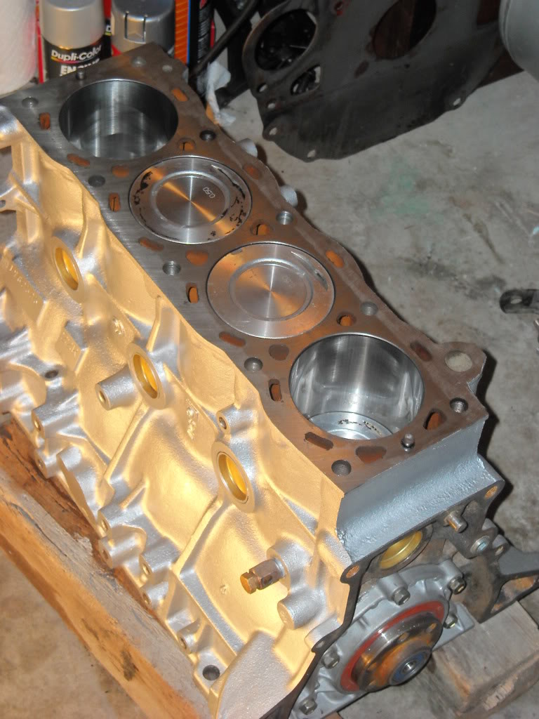

I definitely liked the red more... BUT, I had that laying around and, well, after all that nightmare'n.... with that motor that KNOB did for me... I thought I'd better choose my own fresh start color, right? hehehe.

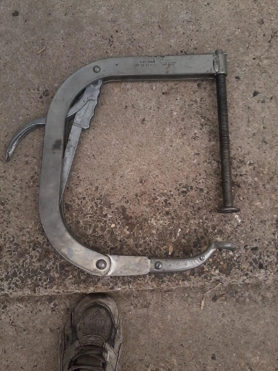

I have been busy and seems like I am going 90mph and going nowhere. I have been busy chasing down parts and tools. Found a guy parting a runner so I got a reciever hitch for my 86. I will update it later as I need to get it cleaned up and to pickup the pieces that mount to the frame. It is about finished except for bigger funds that will have to wait such as rear bumper, seats, and carpet.
I also got a coil and igniter for my 85 pickup that I plan on starting a build thread on January 11th as that has been when I have started my other builds. Trying to get Mistys runner and mine finished before I start another one. I gather the parts when I come across them at a good deal.
Getting a head gasket was part of the hold up and the other one which surprised me was finding a valve spring compressor. My old machine shop would put the valve guide seals in. This one didnt which started this snow flake into a snow ball. Was orgianlly going to do just the rear main seal.
Been years since I changed valve guide seals and nothing to it if you have the compressor. I was surprised at how hard it was to find one. If I ever find one of these, I am going to get it. Will start looking on ebay and elsewhere for one. The big name parts store rent a little cheesey one that looks like a gear puller. Dont waste your time with one of those.
Surprised I havent seen any questions pop up on the home page about this, but may because most machine shops do it for you. Im not sure.
Tool I spent alot of time looking for. I am renting it for $10 a day from a tool loan place.

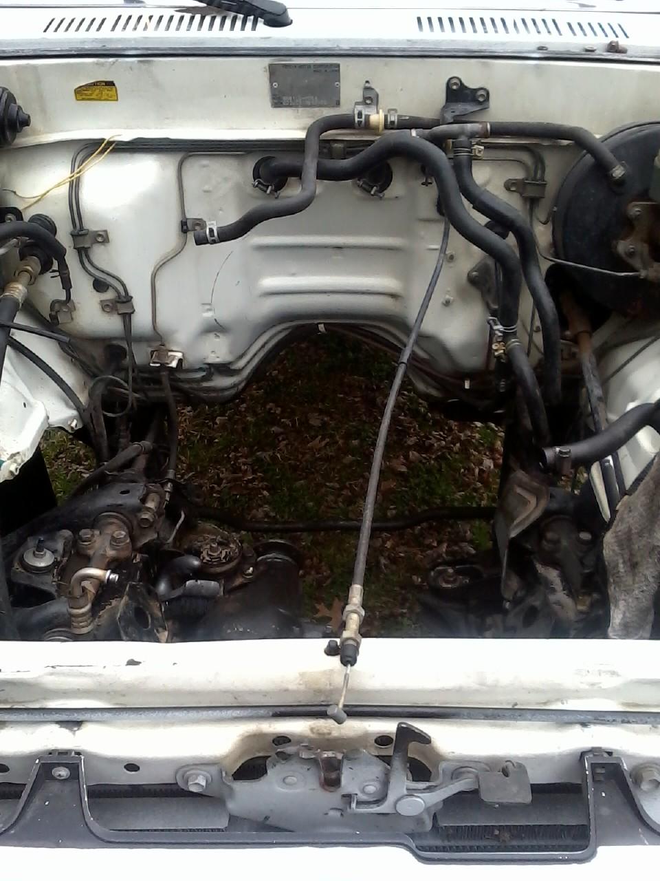

I finally got the rear main seal in and have been detailing the engine bay. Still have more detailing that I want to do. Alot of scrubbing went in to this area. Getting it there slowly.

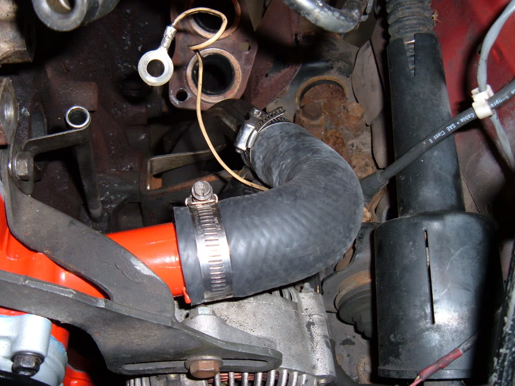

This can be a difficult part to find so want to note it for who may need it. I got this off of another thread that I posted on. I will be replacing this hose soon.
I use Gates Rubber hose PN# 20801, around $10. It comes is a "S" shaped form, but when you cut the lower part off, it looks identical to the orginal and has the larger opening coming off of the water pump and the smaller end for the horseshoe pipe.
Size:  158.0 KB[/QUOTE]
Cal Van 575 on eBay
OTC 4572 is similar

Thanks rworegon..I am going to get one of those. I was just really surprised at how hard it was to find one. The other style that looks like a gear puller should never be used in my opinion. Really appreciate you for posting that for me. I will be making another thread when it is to cold to be outside on different tips and tricks for tools, fixing trucks and parts and that is one I will add to it when I do the thread, Thanks again.

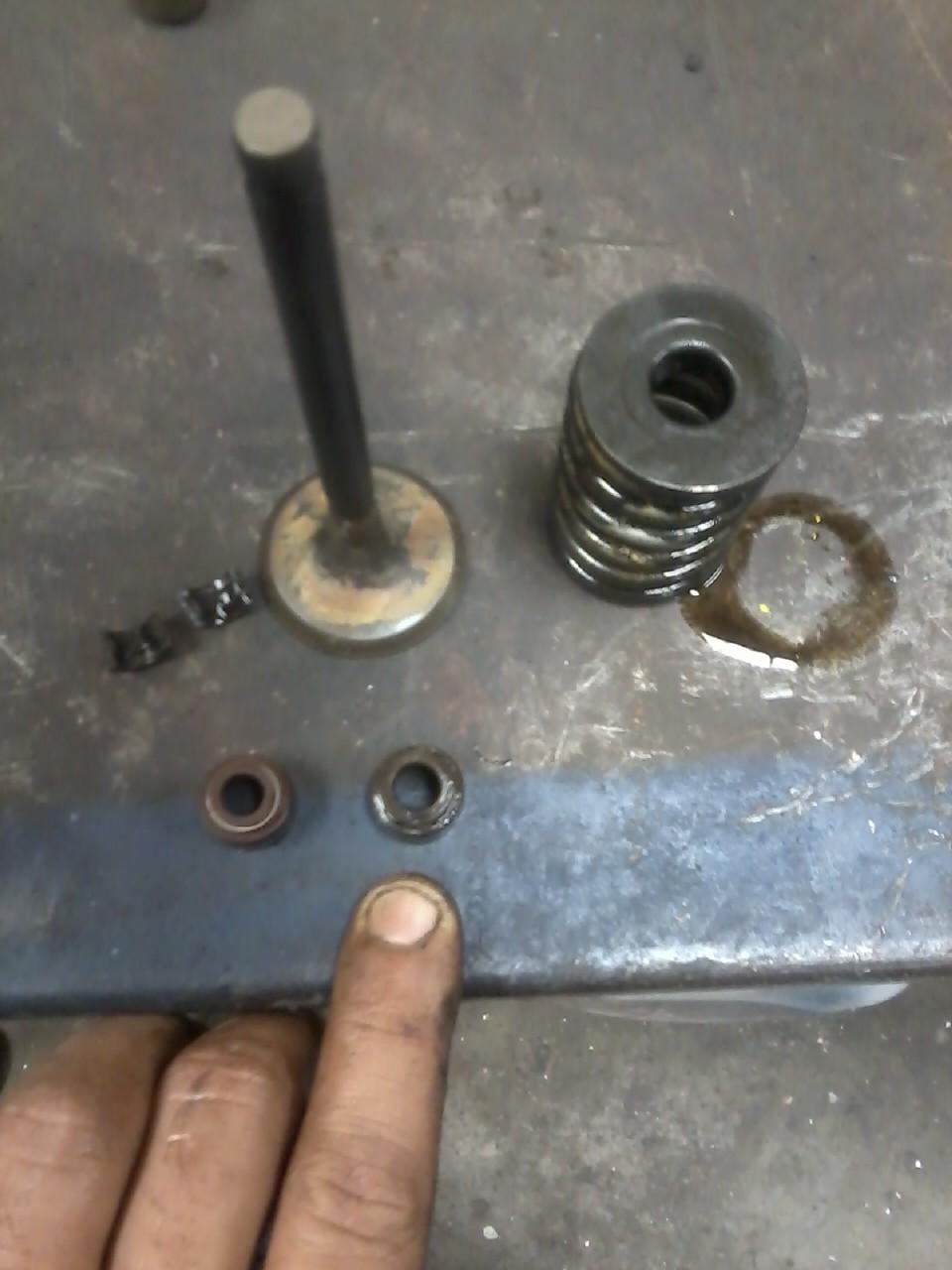

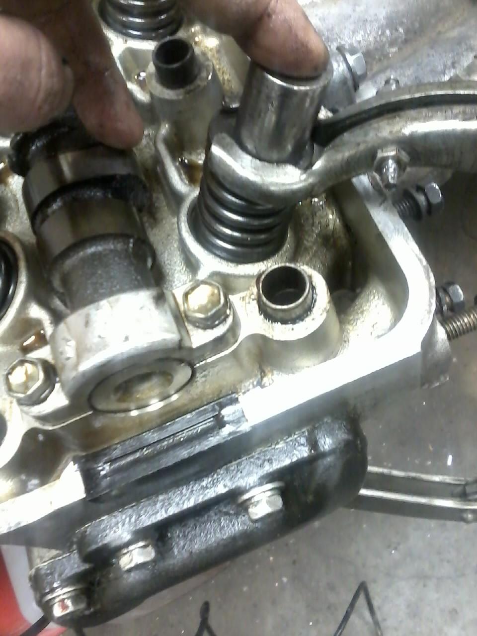

I got my valve seals replaced. I would really suggest using the C-clamp style compressor instead of the one that looks like a gear puller as it squeezes the spring from top to bottom. I am afraid that it could distort the spring. It is a poor design.
There is a pneumatic style C-clamp style compressor and I have never used on of them, but I do like the manual one as you have better control.
The biggest problem I see with valve seal is they are supposed to be soft and rubbery. Over time I have seen them turn into glass like material. My old machine shop would install them for you and this one doesnt. My fault for not checking or asking.
Sometimes the spring and valve keepers like to stick together and not release. When I run into that situation, instead of clamping harder, what I do is put a socket over the keepers and a very gentle tap with a hammer usually breaks them free and keeps them from flying across the room. If you lose one of these valve keepers, they really arent as easily obtainable as you might think. At the very least it will hold up the job. One reason I keep a junk head around just incase I ever need a keeper.

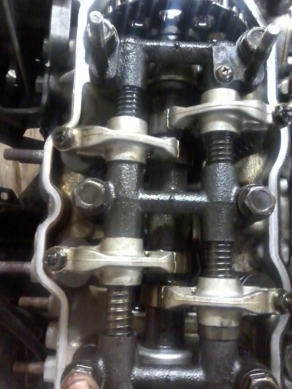

This is the vey first time that I have been into the very bottom of this motor. From its past that I know about, it was abused and neglected. Anytime a get a new (new to me) car or motor, one of the first few things I do is drain the oil and feel for grit or anything unusual in the oil and pull the valve cover to see if there is sludge build up.
An old timer told me this and I have been doing it for 10 years and never a problem is if I suspect alot of build up in a motor is to drain the oil and put 2 quarts of cheap oil and fill the rest with diesel fuel and let it idle for 20 to 40 minutes depending on how bad it looks from previous inspection and drain the oil, refill with cheap oil and run again to get the diesel out and then I fill with Castrol oil as that is my preferred brand. After that I just do my regular oil changes as they should be.
When I pulled the pan, I had maybe a teaspoon of any sludge in the bottom of the pan and was really happy with how clean the motor was inside from the lower block to the head.

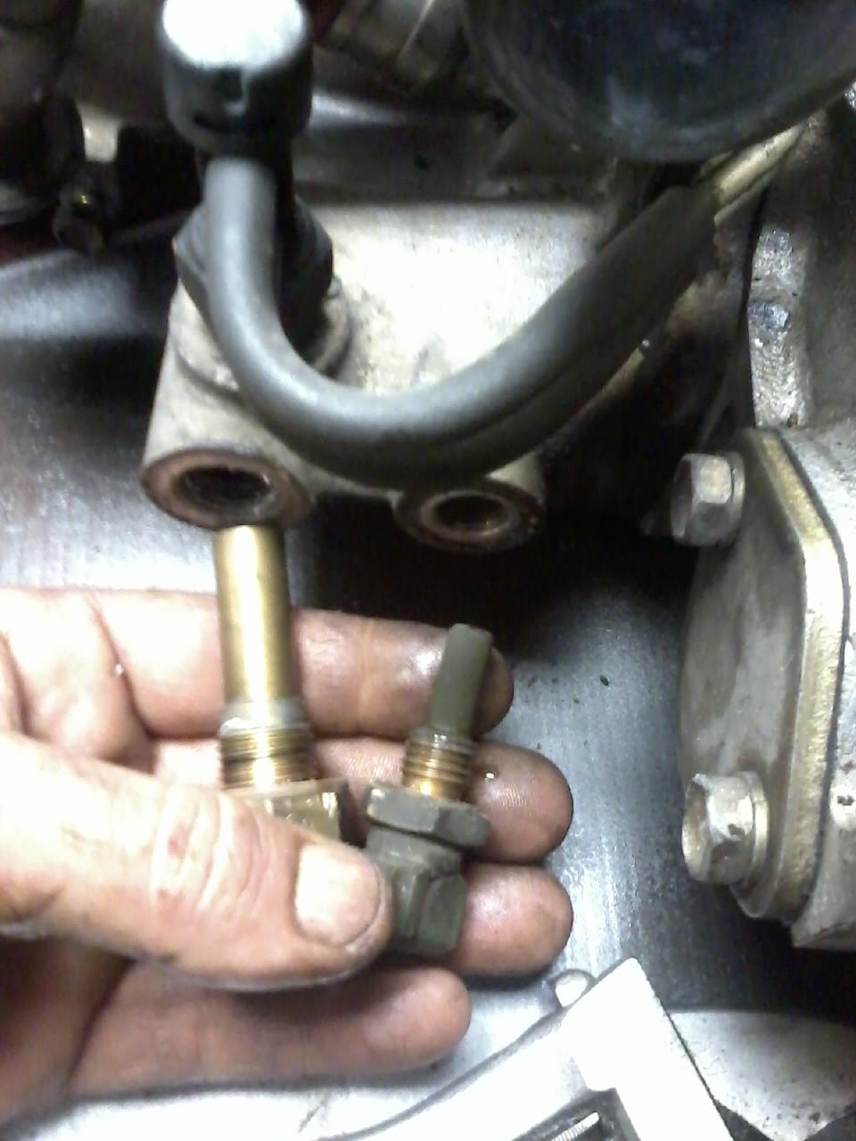

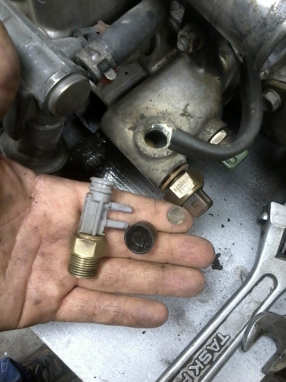

Cleaned Temp Sensor. Have seen this to cause the guage to read max when it was still cold.
Showing how dirty the sensors can get. The left is the Timing Cold Start Switch (cleaned) which controls the Cold Start Injector. I need some plumbers tape to finish reinstalling. The right one is the Thermo Switch that is still dirty. I have seen worse. Just to show the difference in clean and dirty.

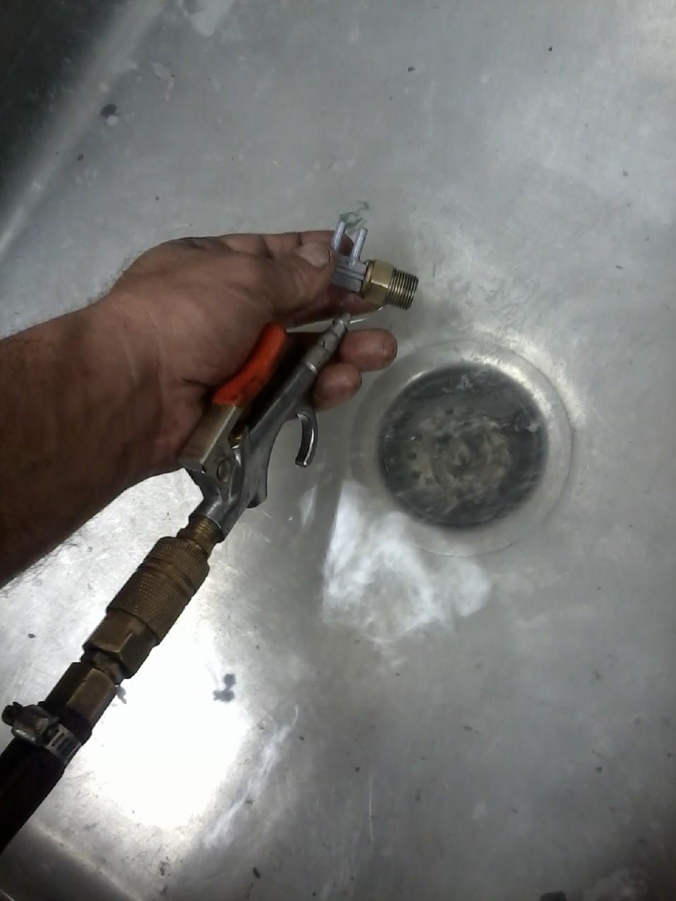

How I clean some parts using air and water. I have even used a 5 gallon bucket before. Works great. Giving it a good scrubbing. Submerge part and air hose in water.

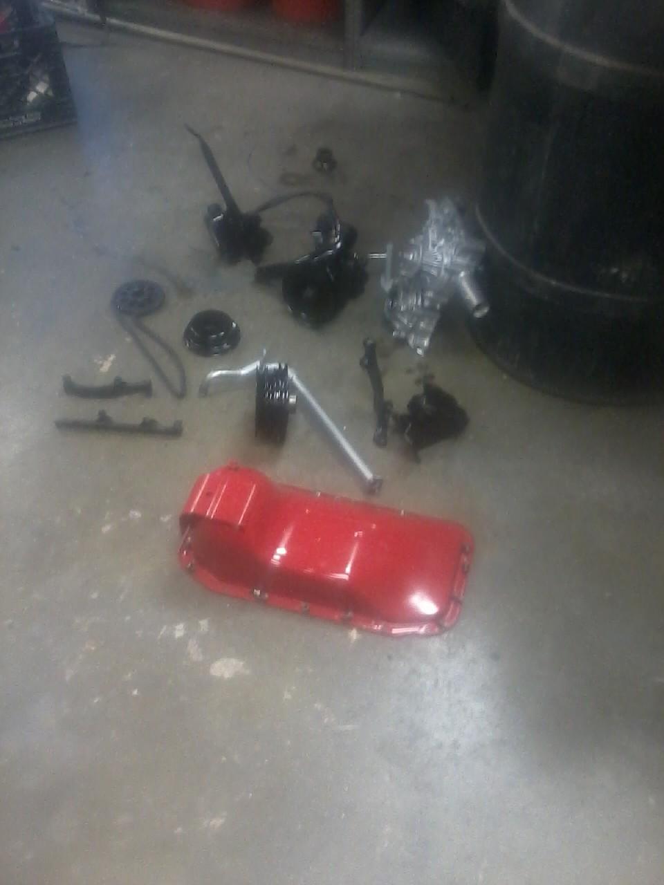

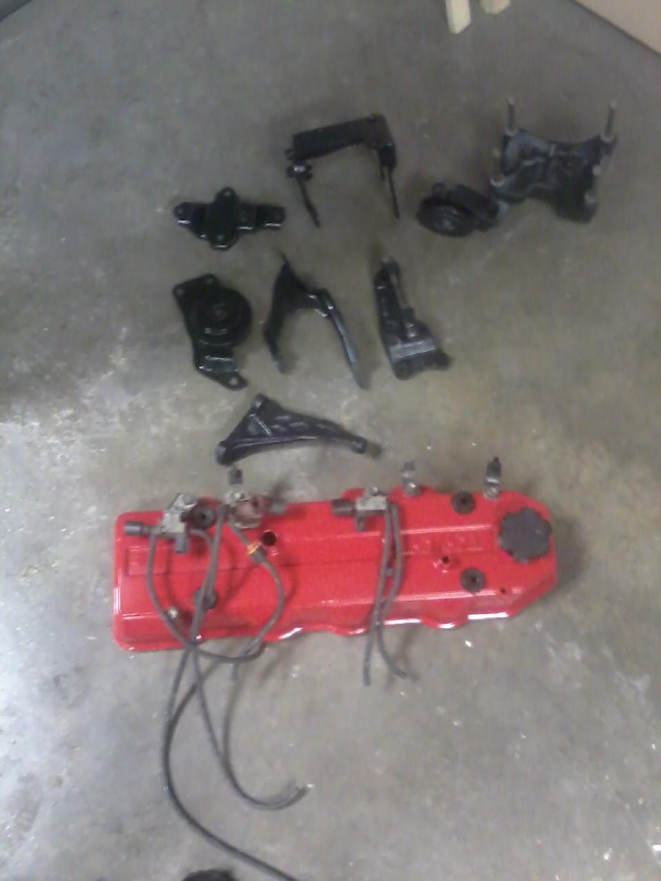

More parts cleaned and painted. Also cleaned alot of bolts on a bench grinder with a wire wheel and cleaned out alot of the bolt holes. Cleaning takes ALOT of time but is something that is real important.
