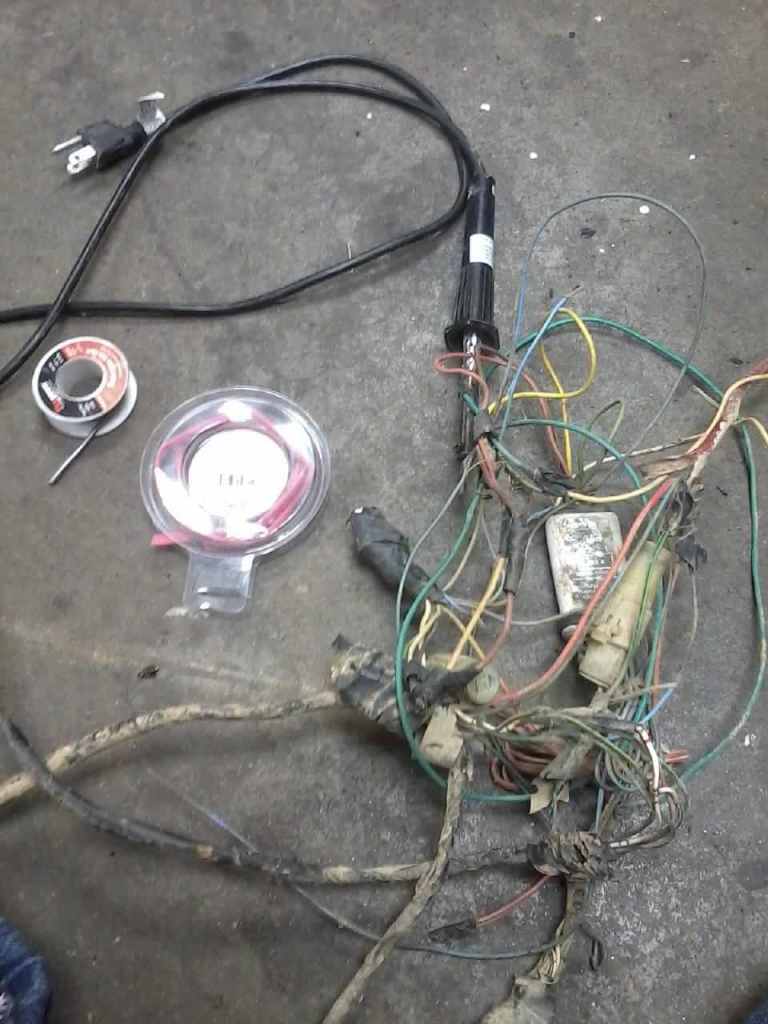

I learned that a Bull Bar from a solid axle wont fit an IFS truck. The IFS is a good inch taller from the frame to the bumper. Misty was hoping it would fit, but not going to happen. She is on the hunt for one. At least she isnt waiting on me. Makes my life better when I am not the hold up.
I am determined to get something done. No matter how small, it adds up. Pulled the tail light harness out of it as some one spliced in some trailer lights. It was done badly at that. Got all of the trailer light junk removed. They just twisted the wires on and wrapped with tape. They must of ran out of wire nuts. The wire nuts were loaded with mud. I have listed in this build on the first few pages of it, on where to get a trailer light set that just Plugs and Plays. Makes life alot easier as there was some bare wires just waiting to short out.
Wire mess. When repairing use a solder iron, solder, and shrink wrap. Not hard to learn and will make as good as new. A kit can be had for around $30 and will last a long time.

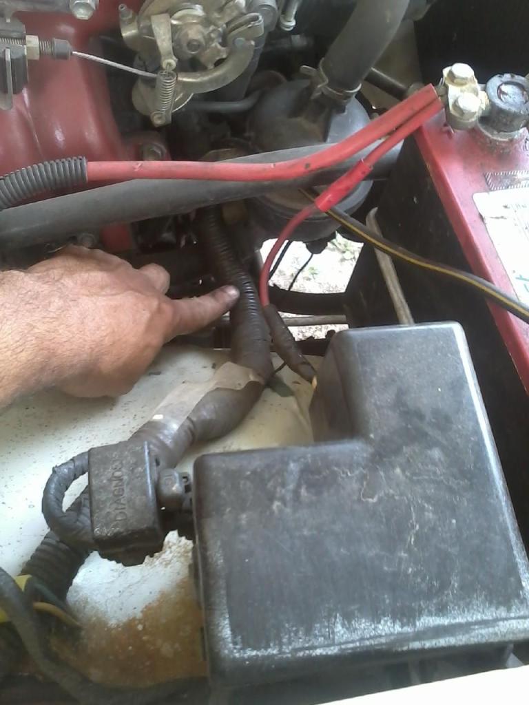

X2! GREAT posting on the Factory Wiring Splice..... And add to that, please? >>>>
*Where, good Sir, is the actual splice IN the main engine Harness to the Injectors?(Is it just before or IN the LOOP portion of the harness, before it heads into the intake(that U portion) )???

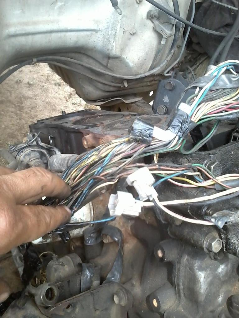

There are alot of those clips in these trucks, the ones that cuase problems are in the injector harness. Helped a few people find out that was what was keeping their truck form starting. It will pass resistance checks and still not start.

Old Aug 1, 2012 | 11:49 AM
  #753
Terrys87's Avatar
Posts: 11,787
Likes: 28
From: Anderson Missouri

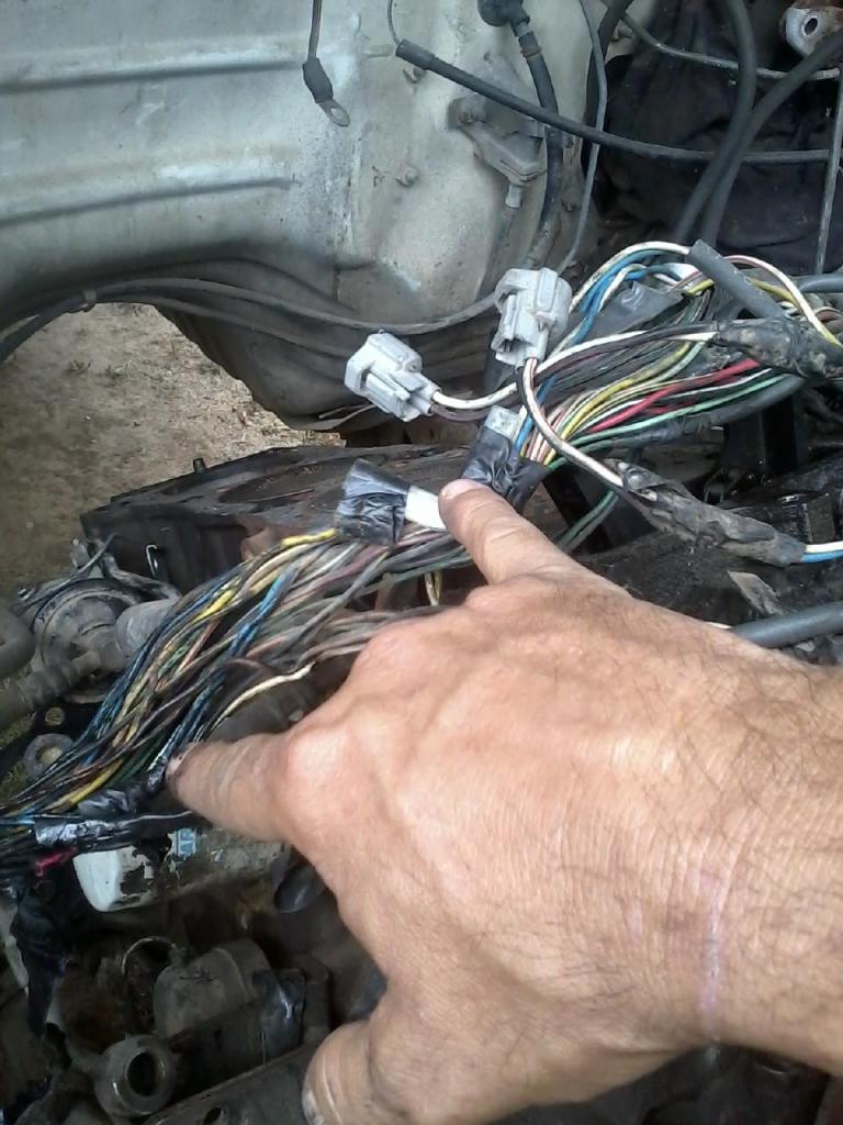

Hello Mark.. It is 3 to 4 inches before the 90 degree plastic piece. Where it sits at the front of the Intake/Plenum area. The 2 clips on the 85 are on a set of Yellow wires and and a set of Blue wires. When I did this on the 86 Runner, I do remember one set being blue on the runner and fairly positive the other is yellow on newer then 85. It has a cheesy piece of black tape covering it.
The Blue and Yellow wires on an 85, maybe the same color on other models. These are usually wet from oil or water from my experience. PO put the newer style injector connections on mine. Normally a good upgrade, but I dont trust their wiring job. Will be getting that fixed soon. Will probably pull the injector harness from the truck and go thru all of it.

So it IS before the Horseshoe portion of the Harness(between the firewall and horseshoe, 3-4" before the 'BEND' in the harness?)

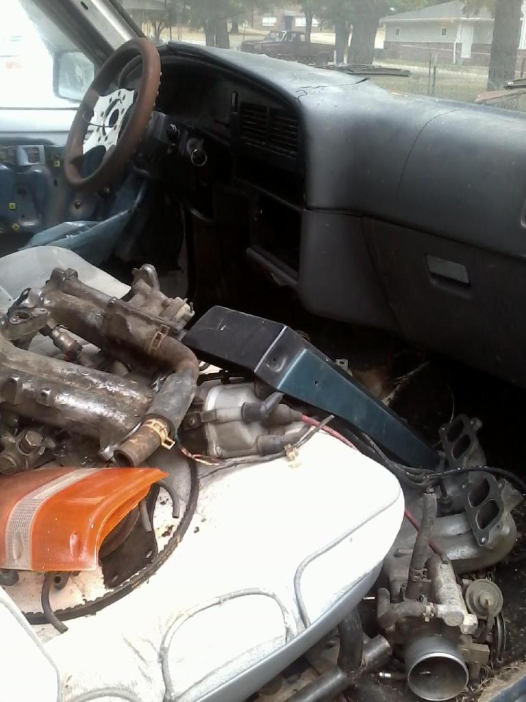

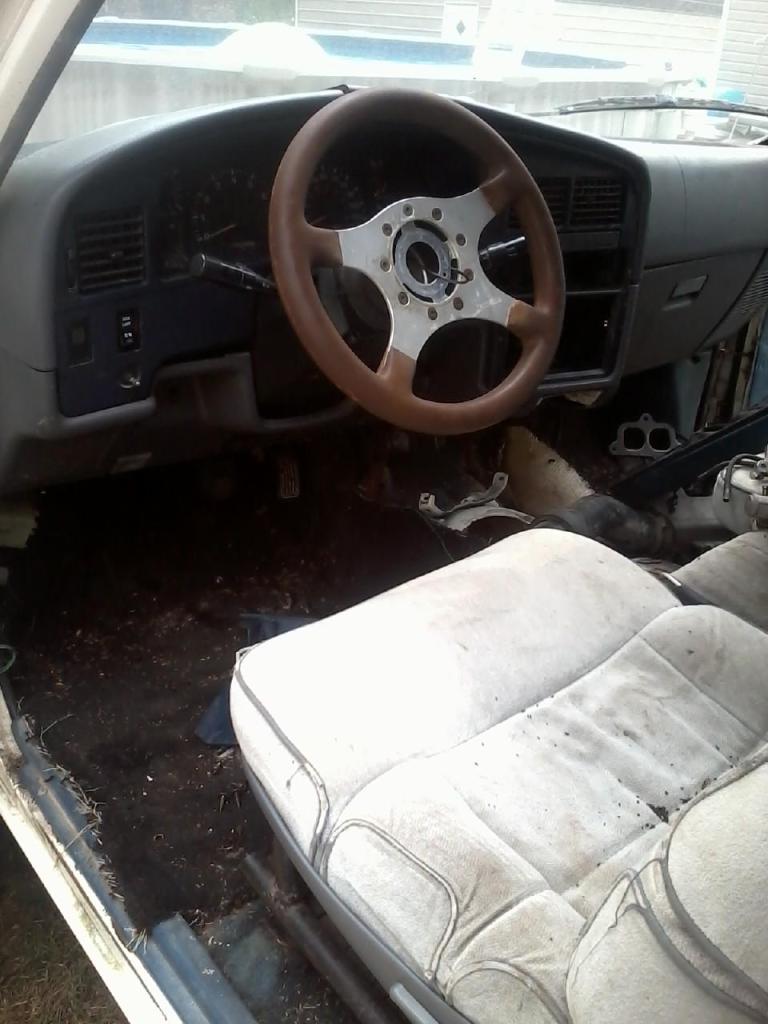

Your Welcome Ed..Think you will like it real well. Just dont panic when you first turn on the lights and they dont come on, just let it charge a few minutes. Normally when pulling a trailier your blinkers blink alot faster. I have never had this to happen. I think that is the purpose of the little pack I was mentioning. Might could mount it inside the frame.
Thought I would give pictures of the interior and wont be surprised it I have to redo some wiring in here as well. Here is the 89-95 dash I was talking about. I have two 84-88dashes and am not worried about getting this swappd out either. If I ever got a truck with just a bad motor, I wouldnt know what to do. Would probably be scared of it.lol

Old Aug 1, 2012 | 12:09 PM
  #756
Cyberhorn The Dragon's Avatar
Joined: Jul 2012
Posts: 2,365
From: Idaho
wow that dash dont look too bad did they have to shoe horn it in or was it a bolt in

Hello Mark.. I would say about half way in the horse shoe. This is off of Mistys truck. Would be about where my pointer finger is. It isnt as bad a job as it looks. Would need to pull the Plenum off and remove the wire loom wrap to access it. The 90 degree piece is just under the throttle.

Old Aug 1, 2012 | 12:14 PM
  #758
Terrys87's Avatar
Posts: 11,787
Likes: 28
Hello Cyberhorn The Dragon... I have heard of it being done before. I am not sure how it is in there just yet. They did use a 84-88 SR5 guage which I was surprised to see. I like the 84-88 dash better myself and is easier to work on. The 89-95 dash, you have to take everything off just to get to the stereo or anything else.

Old Aug 1, 2012 | 12:25 PM
  #760
ChefYota4x4's Avatar
iTrader: (5)
Posts: 19,281
Likes: 21
From: Lake Havasu, AZ
THANK YOU, Terry, for taking the time to take a pic/pointer finger and all! APPRECIATED! I WILL be attacking this, eventually... IN FACT, I believe this should be part of Toyota's 'recall list' OR AT LEAST maintenance for those of us rolling these 300K mile/25+ year old beasts! HAHAHA.
