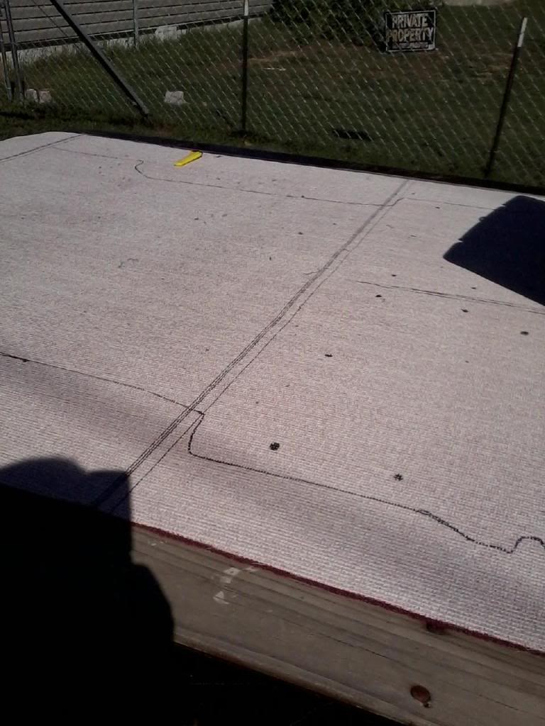

Been busy. Had to pickup my new door seals, and found some carpet that will work for the trunk area. It is close enough for me and for the back area it will work. Still waiting on my shifter boot and seat covers to get in.

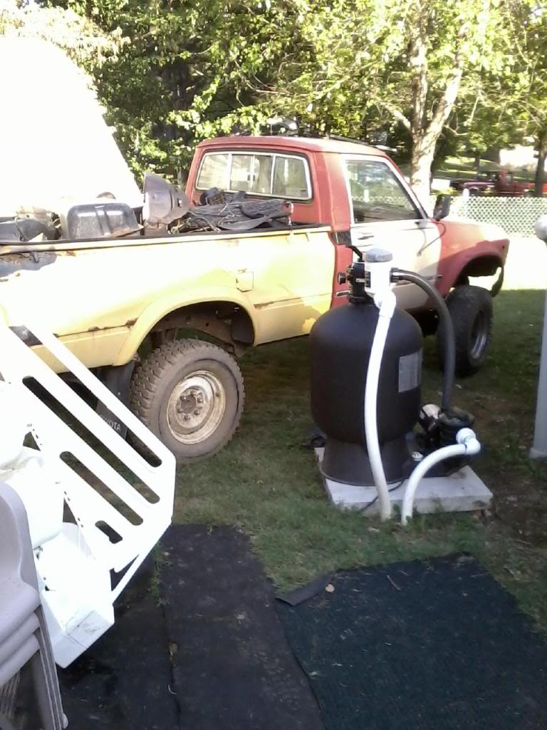

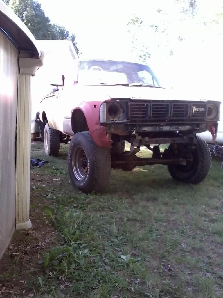

I finally got it home. This is going to be one of my future projects, but it will be SLOWWWWW!! I want to do a frame off restore. I have been helping a friend work on his and have some more that I will be doing and he was selling it for parts. I asked how much for it and he said "Its Yours".
There is going to be alot of work to do one t and most of will be elbow grease. I have a 22r motor and several other parts so really dont feel I will have a whole lot into it.
I will start a build thread on this later on when I get some time and can get some better pics. For now I am going to start breaking it down and working on getting the frame cleaned, then the cab. I will go through the motor during the winter. Planning on painting it green or a tangerine orange.
I am not the greatest photographer.

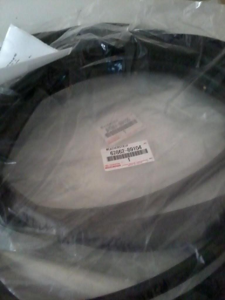

I got my new door seals in and it is alot quieter. I called some dealer and was going to get them from him as I have a Toyota Rewards points and when I asked him for the part numbers, he wouldnt give them to me. So I got them from my local dealer. I could of looked them off of the net. So here they are: Right Door PN# 6786189105 and Left Door PN# 6786289104.

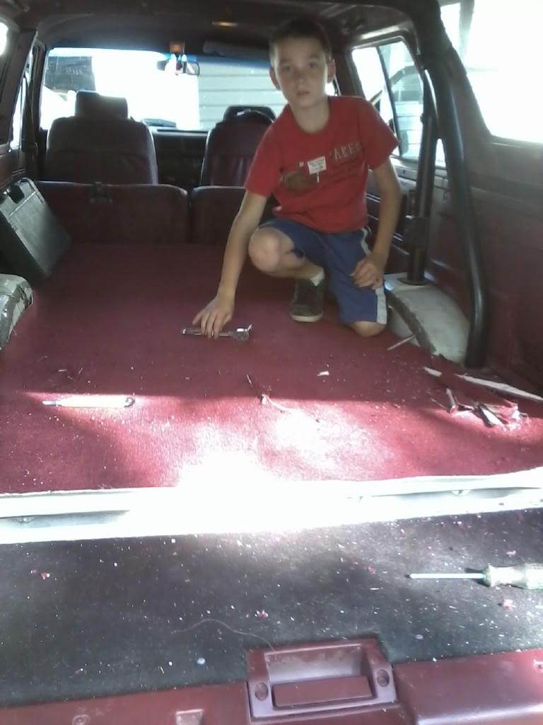

I did get my carpet half way in. Still got to do alot of trimming and get the fastners in. Here is the way I did it. I made it a little wide and a little long and trimmed as I went.

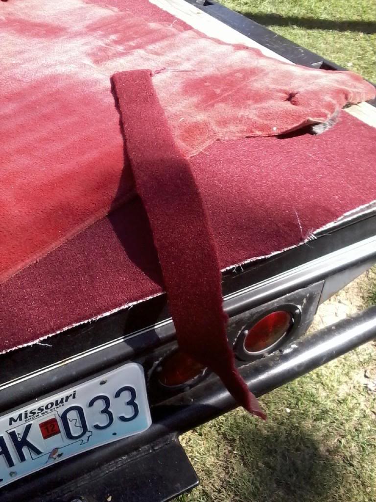

The narrow strip is what the orginal replacement carpet was that is as close as I could get to orginal carpet. The bright red is what I used when it was badly stained and was a temporary fix.

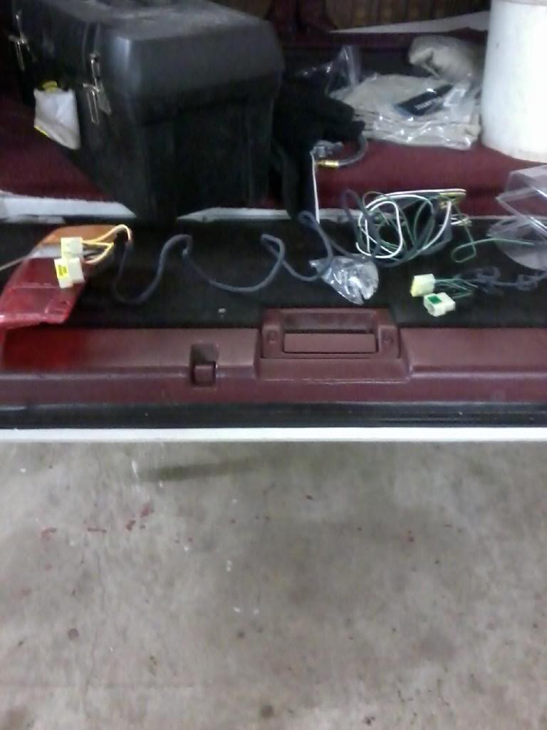

I just got done getting the wiring harness in. I bought the kit that plugs into the tail lights. It would of been cheaper to buy the pigtail and splice it in, but dont care for that. Just looking to be an electrical problem waiting for a place to happen.
Will have to say after putting in the harness, I was wishing I had just done the pigtail. I had to take out the rear windshield bottle to get to the harness on the tail lights to connect the kit.
One thing I found kind of funny. After I fixed the gas tank on this truck my second project on this truck was the tail lights. The PO had knocked some holes in the tail lights and used U-Haul bulbs to pull trailers. Here I going for the same thing, being able to pull trailers only I tried to do it right.
Truck is alot different since I last messed with the tailights. This did turn into a bigger project then I had really expected. Just getting all of the wiring throught the rubber boots, but it is done. Now I just need to get a hitch and it should be ready.
Here is the kit layed out.

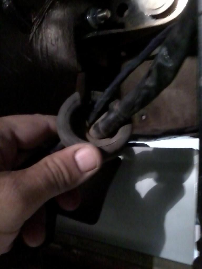

Here is what was the biggest pain trying to get the wiring out of the truck. Will go back and silicon the rubber boots to keep water and dust out.

When I got the 4Runner it had a broken back glass. I just swapped the whole tail gate out as it looked like a Chinese puzzle in there.
When I swapped the tailgate out, I didn't have power to go up or down with the window, no rear wiper, and no rear defrost on the back glass.
Some quick and easy test are 1. Make sure your rear wiper is in the stowed position. 2. Back gate is shut good, may even want to lean against it and try your key. 3. The plug in the drivers side corner in the back is hooked up good, by your rear windshield washer bottle. 4. That the bolt/pin on driver's side, by the roll bar, is all the way in. There is a safety lock located there.
I wanted to see if my Motor was good so I ran 2 connectors right to the motor plug. It is a PITA to get that plug separated and ran each wire to a battery. Just reverse polarity to control the direction of the window.
I could tell the motor was good right away but it was really struggling to move the window. I thought it was off track, but the metal track with rollers were pretty rusty and I just greased them.
It still was struggling to move up and down, so I took some Silicone Spray and got the window tracks. This made a big difference and was the biggest problem. Works great on your door windows too.
I then replaced the Window Relay Box, I got my Rear Wiper working and Defrost but no window control. Located behind the Drivers seat behind the vinyl panel. If your rear wiper and defrost work this is some indication the box is good, but a relay is in there that operates the window so you cant completely rule it out.
I then took the Switch apart. It comes apart easily if done right. First remove the gray plug. It is the light bulb. Then pull the cover away from 2 tabs on one side and then the 2 tabs on the other side.
I then washed the button with soap and water and air dried it with air hose and used electrical contact cleaner to get the corrosion, coffee, dirt and who knows what else, out of there.
Here is another picture of how it should look before going back together. Make sure you don't lose the little white pin and the metal toggle piece. These are very brittle being 20 plus years old. On the rear wiper and safety lock, they are difficult to get separated. I just take contact cleaner and hold the switch upside down and spray cleaner in there and blow it out with an air hose.

I finally got my rear carpet finished put it in. My seat covers are to be here today or tomorrow and still waiting to get the shifter boot in the mail. I will be done with the interior at that point.
Only thing that I have left on this restore is tcase (will be getting to soon, time is the hold up) AC, and getting the seats reupholstered and this will be considedered DONE!!
Wife has alot that she is going to do to it so it will keep getting updated. She is wanting a Nerf bars,bull bar,rain guards,Grant steering wheel,stripes,windows tinted are some of the things that I know of. It will happen slowly. I still get to do the maintainace. Funny how that works out.
Soon as I get the shifter boot and seat covers, I will update the pics. Sure wish I had some good pictures of what it looked like before. Still need to do some detailing on the inside.
I did have to go back and fix a sunvisor so did get a little accomplishment done. I am helping an older guy on his Chevy and had to take care of a few things and am hoping to get to my 83 real soon. Been bugging me that I have had it for a few days and not able to mess with it at all. I am really looking forward to getting started on it.
This 88Runner thread isnt going to go away. We have decided that this runner is a keeper. It is fun to drive and a being a SUV, really rides nice. Only problem I have had with it(my fualt) was when the fuel O-ring was knicked when I put it in and leaked.
I will update what all cost were to get it to this point. I did all of the work and still cheaper then buying a used car and I know what all is in it. Besides I did enjoy doing it.
Now if I could only get the mailman to run a little faster.
