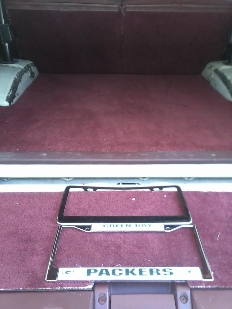

Been really busy, but wanted to show the trunk is almost done still need to get some tabs into the back seats to hold it and work on the split between the seats.
I got her Greenbay Frame on, she wanted that for awhile. Myself I am a Cowboys fan. Still havent gotten the 4Runner one. I need to fix something for the missing bolt. Just need to get it done.

GREAT JOB! Love watching this thing come to completion! (while, surely, you know it will NEVER END! muahahahahaha! ) hahaha.
Curious... gonna pull back up the carpet and do the fenderwells?

Hey Chef.. I tried to lay it in one piece and it just bunched up. So I tried cutting a piece for each side in on piece. It still had wrinkles.
This time I think I will try cutting the fenderwells into a top piece and side pice and if it looks good I will glue them to the fenderwells.
3rd time is the charm. Right?? lol

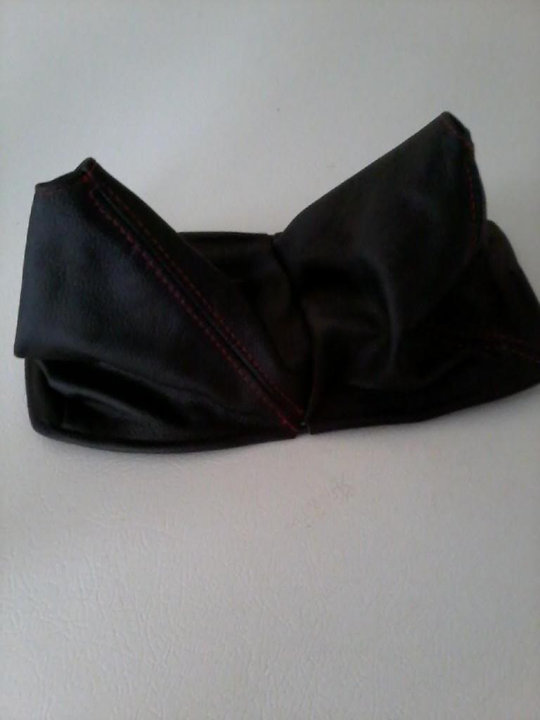

I got my shifter boot in that Nervo told me about. Was going to install it when I did my transfer case. Was going to do it the other day and then I had a tooth to break up and had to go get it pulled. So that got it put off oagain. I have all of the parts, just got to get the time to get done.
I have gotten some of the other things that I been needing to get done, out of the way so should be able to get back on this soon.
I am really satisfied with quality of the boot. Thanks Nervo.

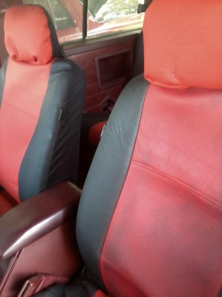

Thought I would give an update on the 4runner. Has been doing great and really have been enjoying driving it. I dont get to drive as much as I used to as the wife took it over and really likes it. Did get some seat covers in it for now. Not real happy with them but guess it looks better then it did.
Her and a friend are still trying to get together to redo the seats. Her friend used to do them and has a sewing machine for auto upholstery.

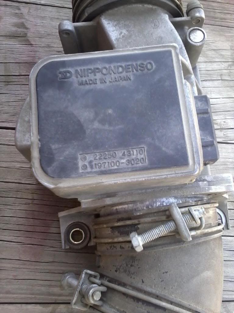

With the recent cold weather we have been having, I have had 2 problems. On the 4Runner it is hard starting on cold mornings. I am sure it is the Cold Start Injector or circuit. I havent looked into it just yet, but if there is a quick fix, I would appreciate it. I will be able to figure it out when I get the time to look into it.
The other problem is on my flatbed/ my avatar and I cannot find anything on this one. It is coming up with a Check Engine Light Code 46. I dont have it listed in my Haynes and I can promise I have looked all over the net and Yotatech for this code. The truck runs great, just the light flashes.
I know I am jumping Te and E1 one right. I have done this many times and have helped several others do this diagnostics/timing wire trick.
When searching, I have used CEL 46, Toyota 46, in several different ways in Google and Yotatech. This one has me stumped. I will look it up myself if just pointed in the right direction. I have found this code for everythign else but Toyota.
I am going to spend more time searching this Code 46 but may have to post a question on the Homepage.

Maybe you'll slap me, ...but I'll say it anyway, hahaha........>>>>>>>>>, "Maybe it's a Code 4 and a Code 6, separately?" >>>>>>> BUT, I had an 88 ECU in my 87 Rig for a short time(the yard had marked it as an 87 4Runner ECU, but it was really an 88)...and it threw codes all over the place up into the 70's. Are you getting 4 flashes, then a pause, then 6 flashes?
Please don't be mad, lol... I figured, maybe you've been stuck in 88 mode for a while now and forgot the 87 is much different in reading CEL codes? lol. Oh well, worth a try, right? lol.

Chef..lol... I feel like an idiot, You are right 87 and 88 are different. I am stuck in 88 mode. For some reason I went straight to the 88 and up. I was thinking the 86 and down were codes 1-14. Doh!!

I got my code 46, I mean 4 AND 6 fix.lol... I had some loose connections and corrosion and cleaned them up and seems to be working fine. Thanks for the keeping me from posting and off the wall question.

I was out taking care of things and seen this Supra setting a salvage. I guy I know is into them and I told him I would send him some pics. I figured it was an 85. Got to looking and it was an 82. So I checked the AFM number. Wahoo. It was what I have been looking for, for a long time.
Seemed like everytime I found one someone beat me out of it or I couldnt get it at the time. This Supra had been a one owner car by a woman who really took care of it and got rear ended by a kid who was texting. Sweet car. The salvage has already had several wanting to buy it.
The 88 has been running fine, but with this cold weather has been hard starting. I figure it is the Cold Start Injector or the timing switch. I have a spare CSI and am hoping that is all it needs. I will be spending some time on the 88 here shortly and seeing what I need to do to get the 82 AFM working on it.
