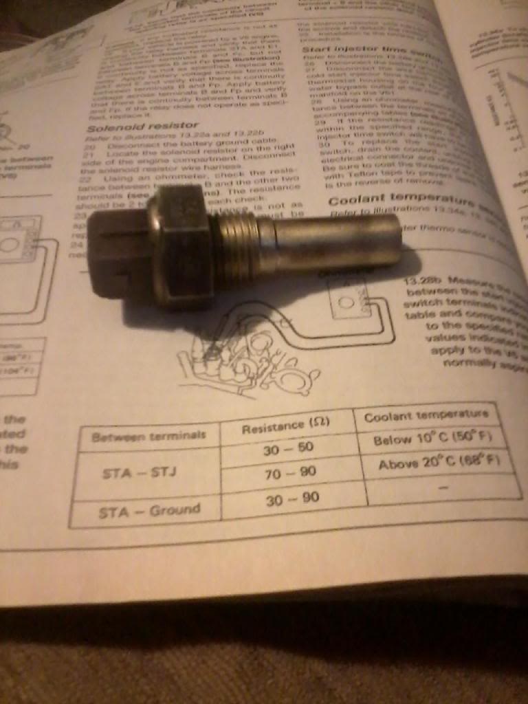

The runner has been running great. 1400 more miles and I hit the 300,000 mile club. Have been having some starting issues with it while cold. I knew it was in the cold start area of the truck.
I had alreadjy cleaned some green gunk/corrosion/build up on the Cold Start Injector connection and seemed to fix it when it was in the 30s degree weather. The other day it wouldnt start til it got into the 40s and fired up fine.
I took the Cold Start Injector Timing Switch off of my blue parts truck and cleaned the sensor and put it in and it is currently 17 degrees now. The motor may have turned 3 complete revolutions and fired off and sounding great as normal.
I took my old sensor and put it by the stove and ran the resistance check and it was right in the middle. I then put it in the freezer for a few hours and it was right in the middle of where the resistance should be.
I really think this sensor is good, it just had a bunch of that green corrosion built up on it. This cold weather coming on, might just need to pull it and give it a good cleaning.

Hello EFI85..I havent been wrong yet on this, but when I have talked to people that have this problem, it is because they have the rear heater option, sitting between the 2 front seats. Somehow water gets warmed before the thermostat opens and reaches the guage.
When you have the heater option, you are supposed to use Part # 90916-03070 for Dual Stage Themostat.
I havent put in the correct thermostat myself yet but since I now know the cause, I quit worring about it. Also talking to others, with the rear heater option, the rear heater will start putting out warm air before the front heater.
It isnt anything to worry about. If by chance you dont have the rear heater, but I am hoping you dont prove me wrong,lol..another possibility is the temp sensor has a hard water build up on the water sensor behind the thermostat.
On Page 15, #353, I show the sensor all dirty and then it cleaned up, that will fix your water guage from bouncing all over the range of temperture, but I am still betting you have the rear heater.

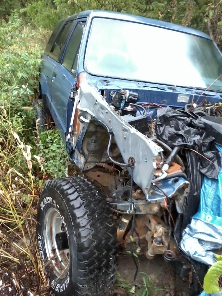

I want to show what my next build is going to be. I will start a build thread on it on the 11th of this month. I have posted these 2 pictures in this build earlier on, but just to give a heads up on it.
I orginally bought this blue 86 for parts for this 88. I got it for $400. It has well paid for itself on the 88. It orginally came for Florida and is really solid. I have very little work to do on the body. I think just 2 small dents.
It may look bad but I did part out a rusty 87 4Runner that was literally rusted in to. I have always liked blue and this one has factory cruise control. I will have very little into. I will put more info on the 86 Runner on the 11th. It keeps both builds on the same day, just different years. Basically it just worked out that way.
Right now I am still getting the shop set up for it and getting the tools around for it. I have the boat in there right now and just bought a cover for it and I need to get it out.
This blue runner is going to be MINE.... I wont give it up, been wanting one for along time and it will be manlyfied..lol.. I just hope I can get it as solid and dependable as the 88. If I can get it like the 88, I plan on just to keep driving it as long as I can get parts for it or until I kick the can. That is my plans for now.
I have had 2 new trucks in my past (young and single) but I get so much more satisfaction building my own.
Keep an eye out on the 11th (Wednesday) for the 86 build. I should have the shop ready today and then getting it home. It looks bad, but this truck is not going to be a challenge at all. I have 98% of the parts. Really all it needs is paint,interior, front bumper,alternator,clutch,valance. I have everything else. I have slowly replaced all of the parts that I had used on the 88. I had to do a lot of digging for the deals.
I dont think it will take me that long at all to get it into the same shape as the 88. I actually have maybe a total of six months work time on the 88. Dont think I will truly ever be done fixing these two trucks, nor do I ever want to be completely done with them. Always looking for the next improvement.
