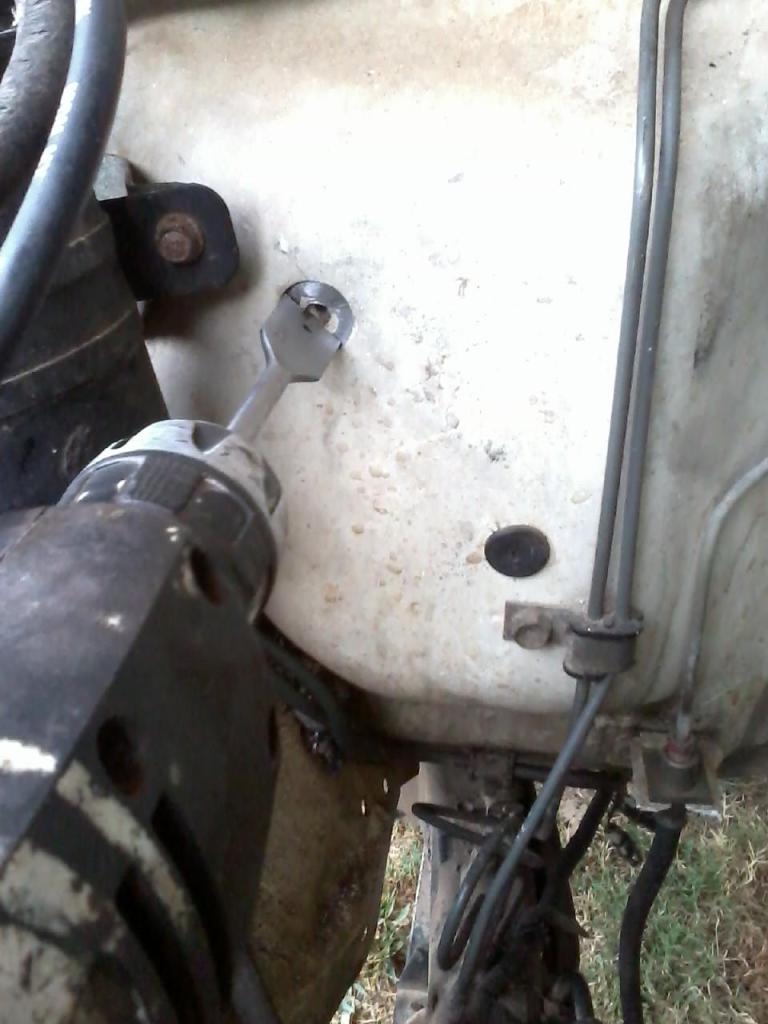

Carpenters are going to scream with me using this tool to cut the holes. But it worked.

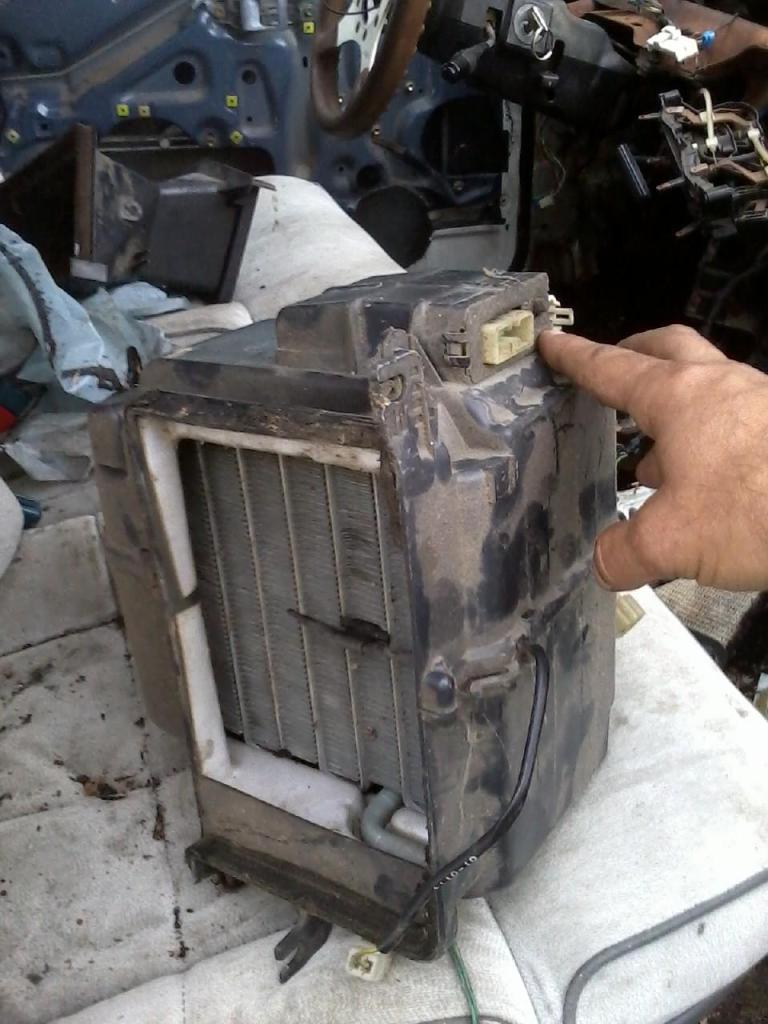

Evaporator you will need. Where my finger is pointing is what Mark is talking about on his thread that needs adjusting.

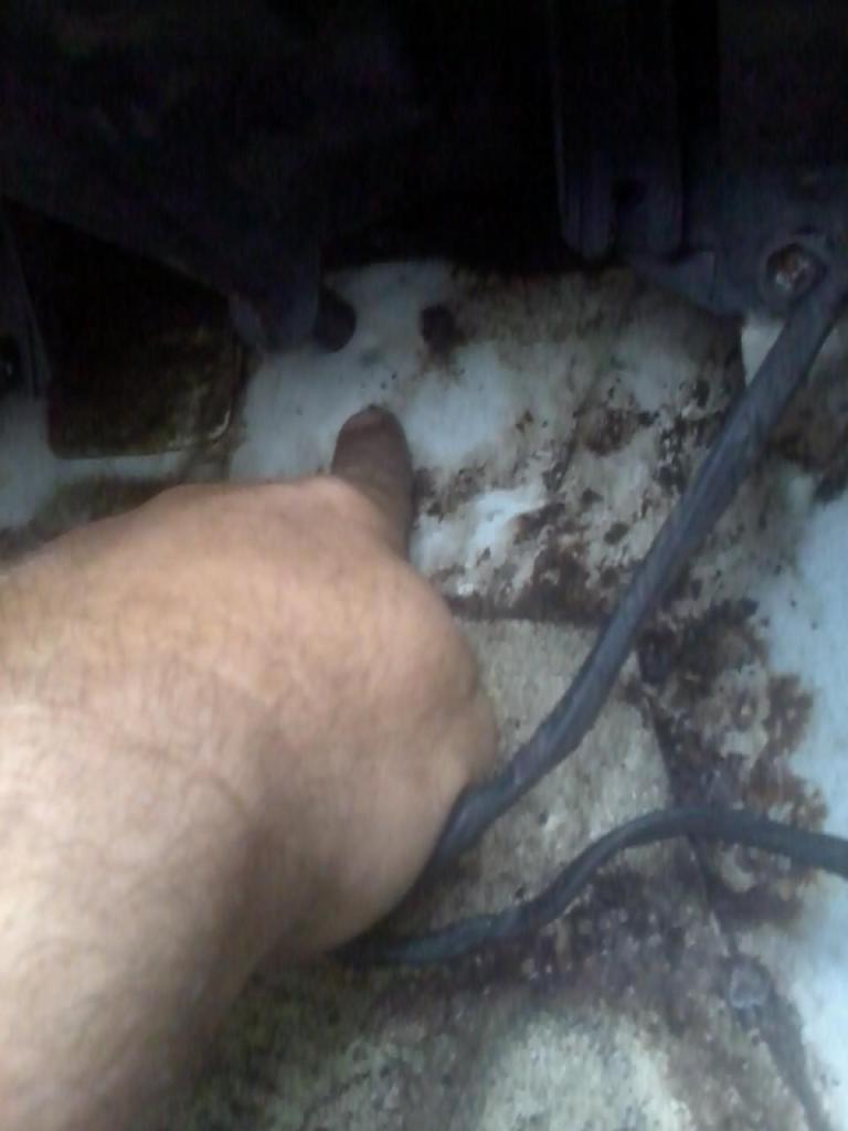

Just above my finger is a dimple I was talking about. This one is for the drain hole for the Evaporator. Makes installing an AC so much easier.

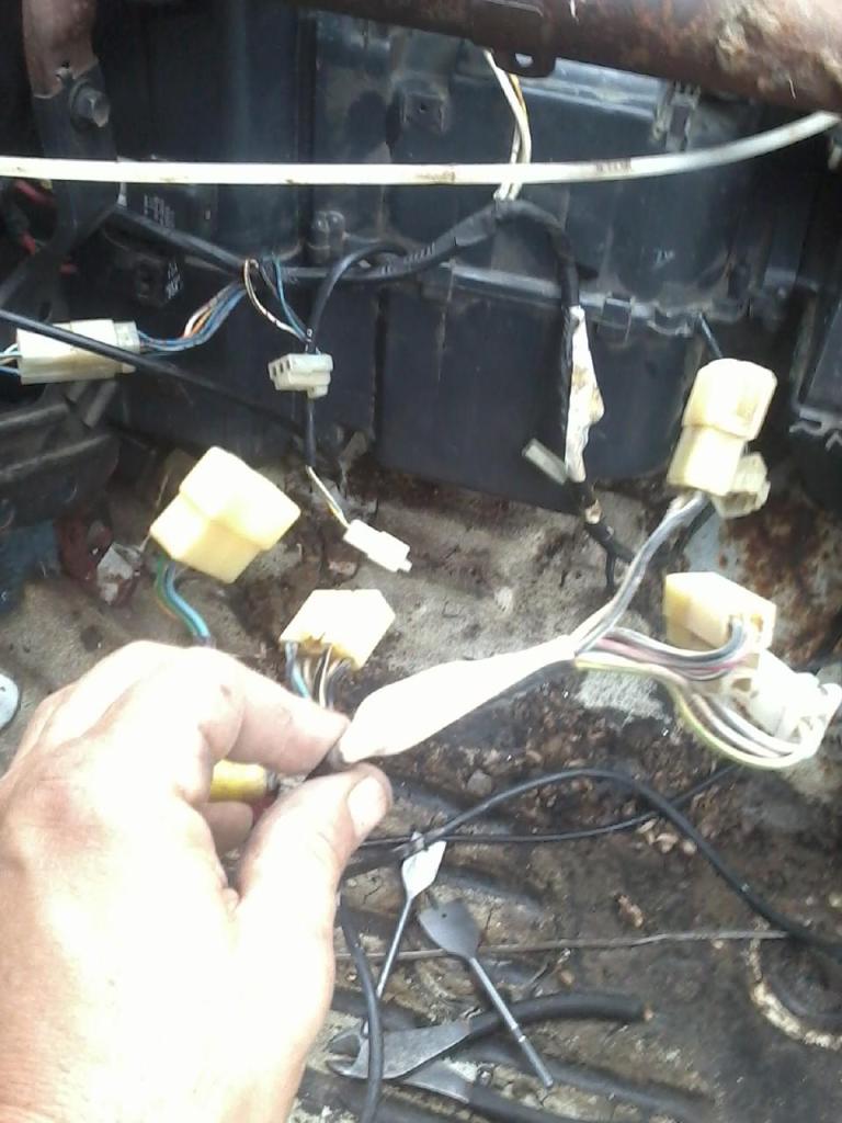

Wiring harness needed to connect to the trucks main harnes. Appears all connections are already installed.

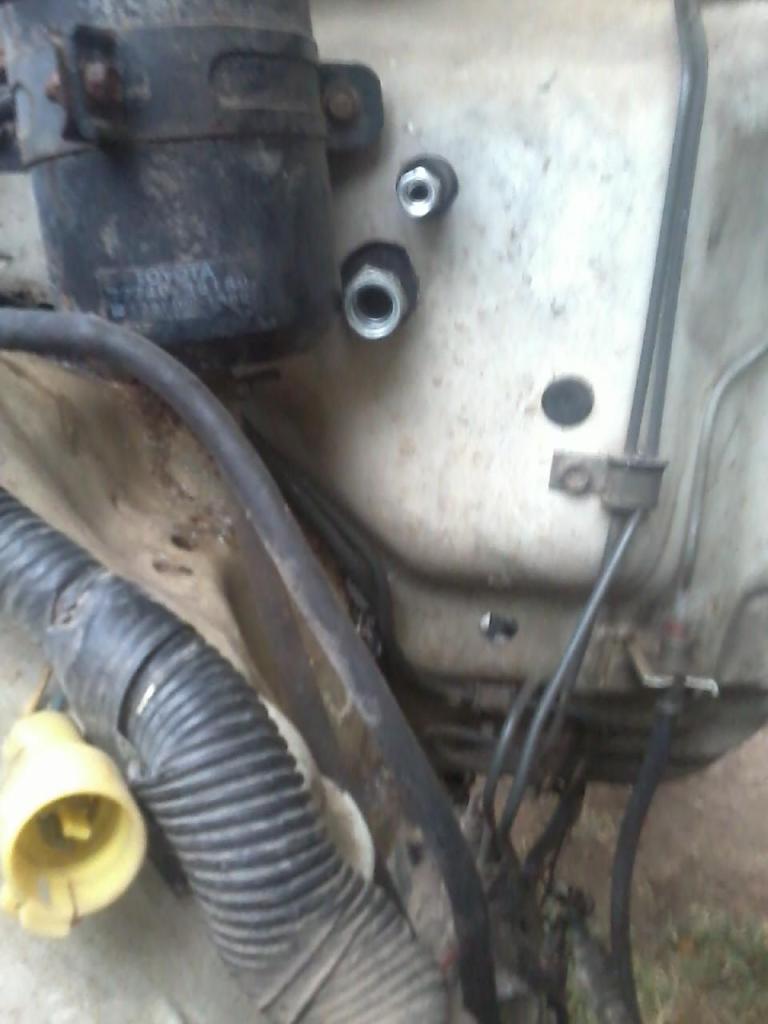

Will get some rubber grommets to seal up the excess hole and for protection of the evaps metal pipes.

Nice work on the AC install Terry! I had to laugh to myself when I saw the drill bit you used, I've done the same thing in a pinch, glad I'm not the only one, ha, ha!

Wow, great work! Love the bit choice!!! WHATEVER WORKS, MAN! Let's see.... 2$ for a wasted bit.... or 6$ for a hole cutting bit? GOOD CHOICE! HAHAHA.

that is too fun terry all the connections right there to put ac in AND dimples in the metal to put the fittings in the right places
cringes at using a spade bit on metal BUT if it worked it worked lol!

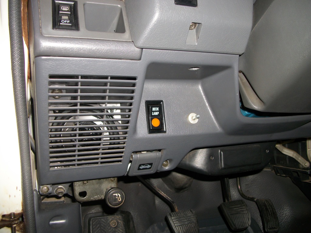

Terry don't forget none of the early Toyotas came from the factory with air. It was always a dealer added option. So they all have the electrical harness ready for the option. I think the whole kaboodle came together in a box because I have the installation book for 1989 Toyota trucks and 4Runners. It shows the A/C as a kit and not the individual parts. It tells you to drill the holes at the dimples. I've collected most of what I need to install it in mine except I need to get the O rings, belt and a new dryer. If you look at the plastic directly beneath the steering wheel there's a rectangle ghost there to cut out. A small vent fits in there. Are you going with 134A or R12? I probably won't get this done while it's still hot. I've had many cars that didn't have A/C in the past but this summer really impressed me that I need it. My 1st gen is not getting much love these days.
You can see the black rectangle and two screw holes uncut here:

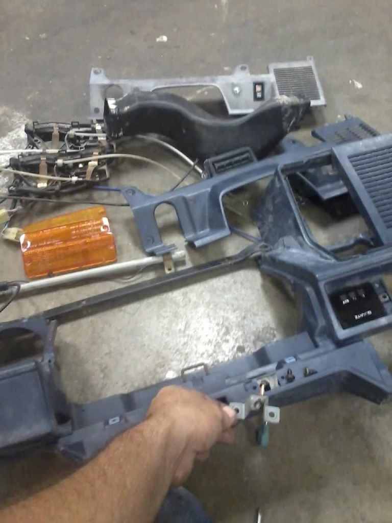

Just starting to get a few parts around to get on the truck. I am having to do a lot of piecing together. It took two heater controls to make one. I got the lenses cleaned and ready for clear coat. Finger is showing what nornally gets broken.

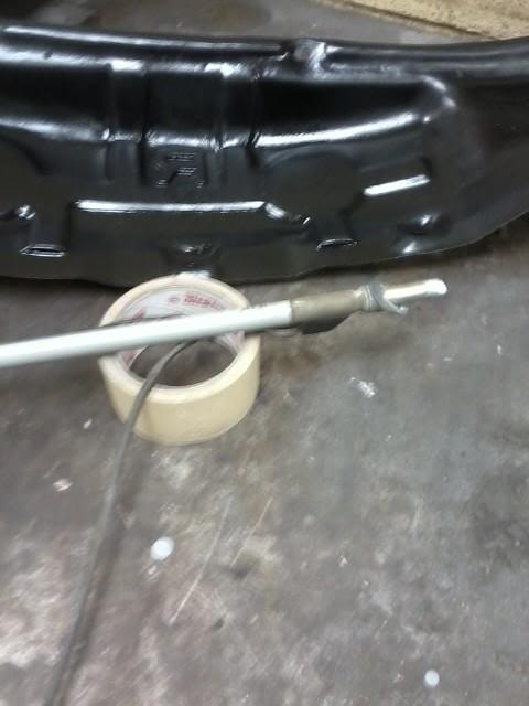

I have showed this before, but just to show others that may not have seen this trick for the antenna. Works great for me. I cut a bolt head off and thread it in. Got this for free from the bone yard as it was broken. These are hard to come by. Did this on the 88 runner and still working great.
I am getting the dash ready for paint. I will be taking the speaker cover into the parts store to have them to mix up some interior paint. Stacey David did this on Gearz for Ted Nuggents truck. I did this on the 88 runner and it is still holding up. Will pick up some paint tomorrow. Prepping takes alot of time. Where my finger is, that is for a glove box light. Dont know if I have any connections for it and need the switch for the bottom of the glove box door, hoping to get it working. Antenna is in one piece now. Blinker lenses are clear coated.

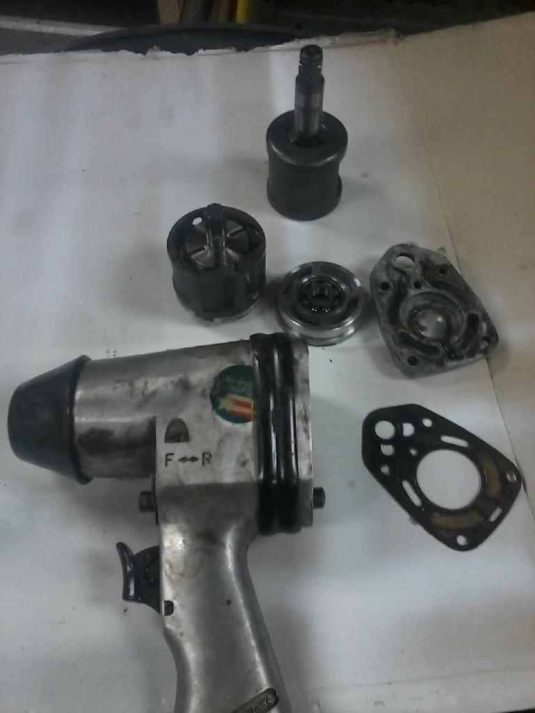

My impact wrench stopped working. It comes apart easily enough. A good cleaning will get it working again.

Tried to work out in the shop for awhile and had to come in. It is just to hotttt. Did get my Impact Gun working. All I did was take the four screws out of the back and watched how it all came apart. Couldnt find anything broken so cleaned it up and put new oil in. Put it on some tough bolts and it torqued them right off. Figured I didnt have anything to lose if I couldnt get it working, so this time it paid off.
It is a Campbell Hausfield gun and I have had it for 15 years. For 10 years it sat and was not used. Probably not the best impact gun but works for me. Hope this might help someone else out there.

usually its the resin impregnated vanes that either wear out or get stuck terry on impacts. the valve shop i worked at everyone came to me to fix their impacts an air ratchets oh dont buy craftsman air tools they dont lifetime warranty them learned from experience

These antennas are known for getting broken. They use a cheap plastic pipe to support it in the upright postion. Trying to find a good one in the salvage yard is next to impossible. Here might be a better explanation.
Not the best picture, but in the top picture you can see the bolt in the top half of the antenna.
I just found a bolt that threaded into the two broken pieces and cut the head off twisted them together. I have done this before and it works great.
Broken
Twisted into one fixed piece.
