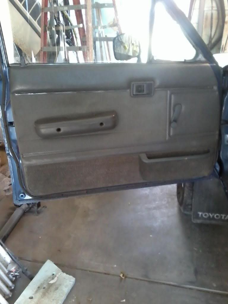

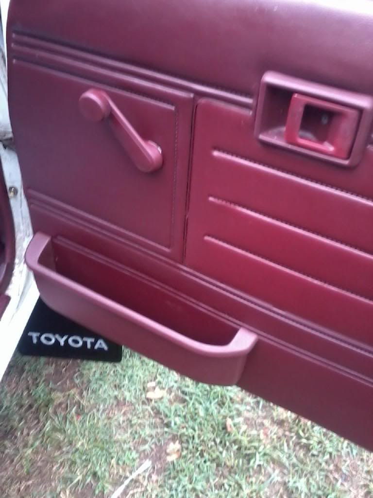

I have been wanting my Runner to be as useful as possible and came up with the idea to add more storage (for junk..lol) and took some door pockets off of a 2nd gen runner as I dont have alot to choose from here in this part of the country.

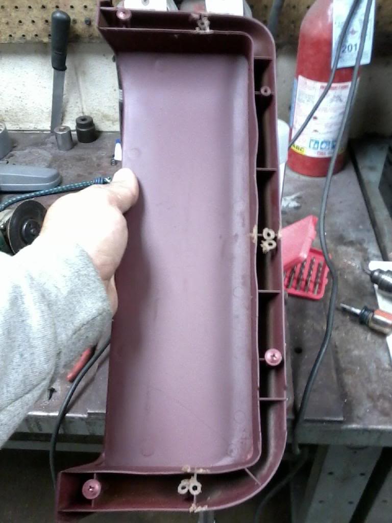

I took a door pocket and had to take a cut off wheel and knock down the tall tabs. On the Runner I pulled it from it was only being held by 4 screws. Haynes Manual has a great descrition for getting your door panel off.

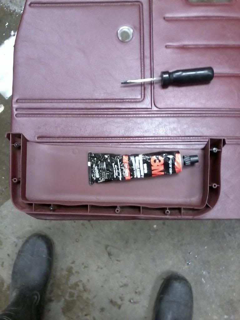

I then figured where I wanted it and put a dab of weater seal on the screw holes and set it where I wanted it so as to know where to make the screw holes. I used about the smallest drill bit I had and made a small hole and ran the screws in from the back side then mounted it to the door panel.
Here it is done and is the way the 2nd gen was mounted. Wont take heavy items but will work for what I need. I got it off of a brown truck and did have to paint it.
https://www.yotatech.com/forums/f199...l#post52144056
When adding pockets to panel with carpet, I use finishing nails to make holes. The first and second gen pocket hole screws dont line up.

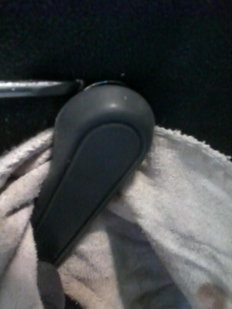

Here is how to remove the clip that holds the window crank on. Just posting this for others to see. Take a cloth and work it around until you see the clip. I then take a jewlers flat blade to lift the clip out.

That looks pretty good if I didn't have speakers there on my doors I would do the same thing.
In the Camry we have those and they get used all the time.

Hello Jdogg, How are you doing? The pockets are ready coming in handy. I like to look at other trucks and try to apply some of the handy things to mine. Always looking for more ideas.

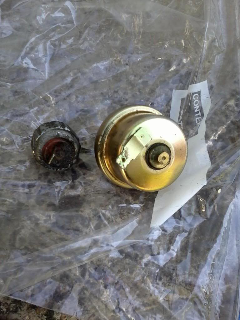

Got home and had a package. My Oil Pressure sensor. Thanks Jason, appreciate it. That is normally a 5 minute job, so I couldnt wait to get it on. It went smooth this time.

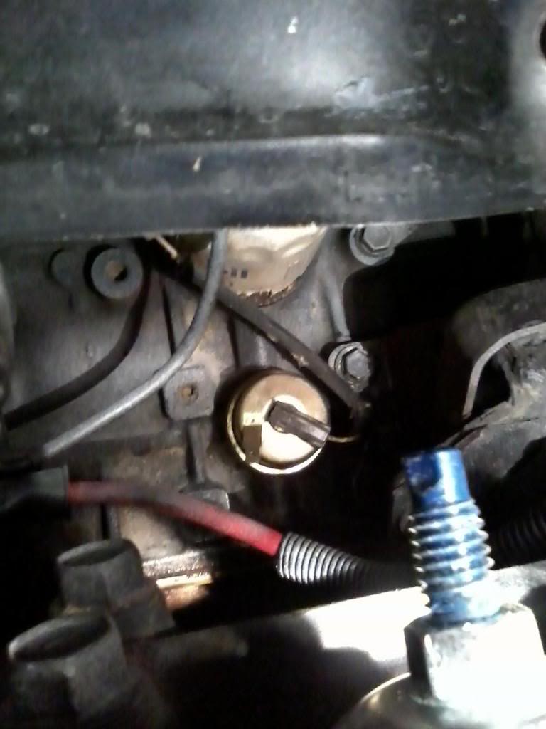

On one swap I did and it was right after I got the 91 extended cab, the PO of the extended cab had a 2 wheel drive clutch in it and it was slipping bad. I thought that I would just swap my oil sensor out quick. The oil sensor for the light broke in the threads in the block so I was immediately down 2 trucks. What happened is I used a deep well socket and turned it slowly thinking it was twisting out. It was actually twisting the head off of the threads leaving a big whole for lots of oil to come out. When you start it up, it will flow quick. Luckily I had this to happen on my 2 wheel truck and a guy was able to weld a nut to the broken threads and take it out with a wrench. I dont know if you could get a welder in to the threads on a 4 wheel drive.
This time I used a pair of vise grips so as I could make sure that I could see that the threads were twisting with the head. Once it was out I used a 14mm wrench to put in the new sensor for the guage. I will update my guage swap later but want to put this out to someone new.
The BIG sensor on the right is for the GUAGE and the SMALL sensor on the left is for the LIGHT.
DO NOT plug into the ground wire, it will ruin your oil guage on your cluster. Plug into the center of the sensor.
Give me a day or so and I will update my SR5 guage post.

they can be used for almost anything. trash, maglight, change, pens, paper, phone holder etc...

those pockets turned out really nice man good thinking on that one, I really need to find some interior parts for mine, miss a craigs list deal awhile back becouse I couldnt get home maybe next time. I hate to see that you sold your 91 you put a lot off work into that truck but I understand. hope the presure switch helps. hope all is well with ya.
