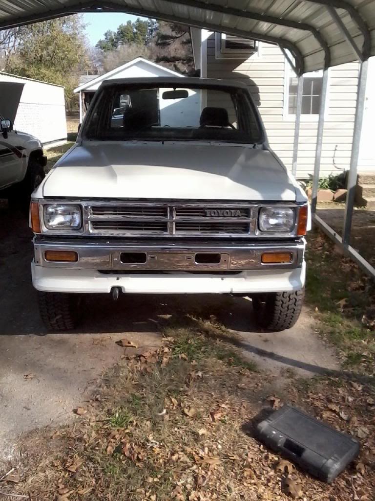

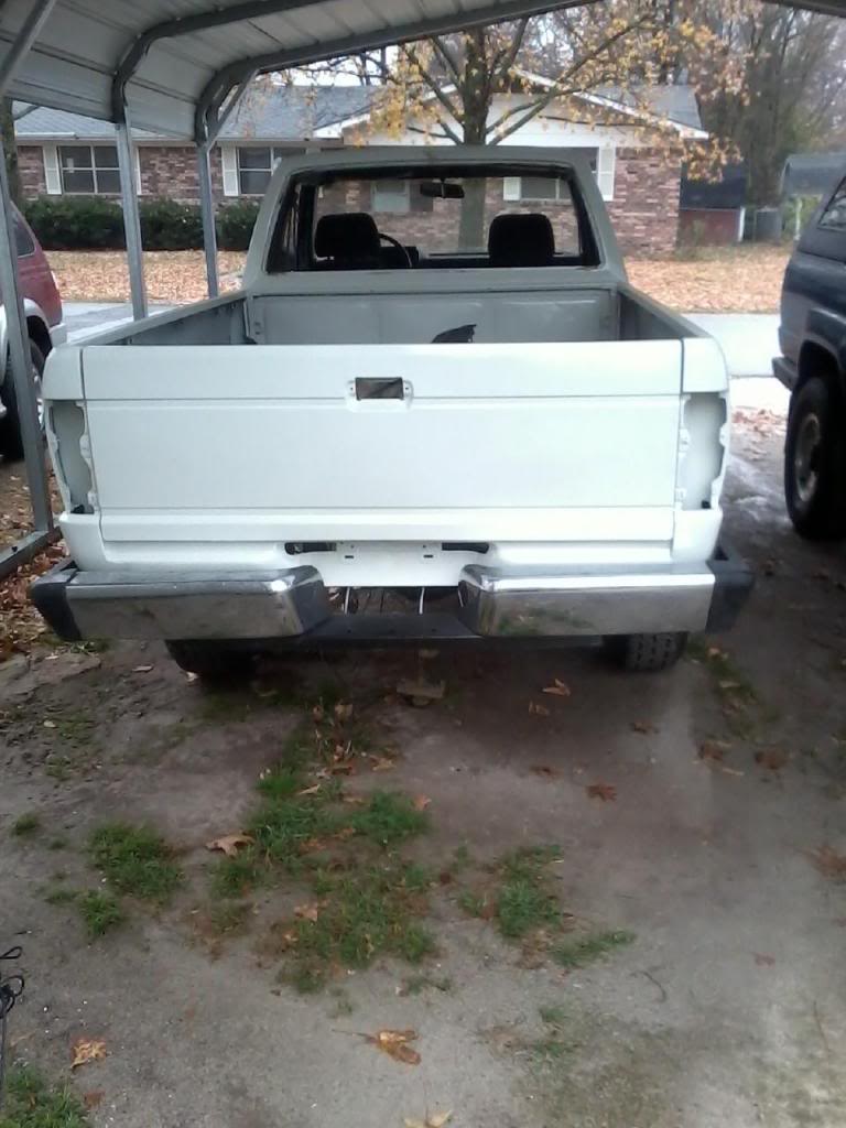

Got the valance painted and on the 86 Extra Cab. Went and got some 2000 grit sandpaper to smooth out the clear coat. Misty seen the picture and wanted to know why the hood was 'Funky", it isnt latched down at this time.

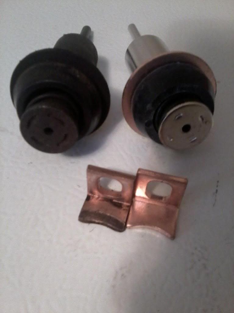

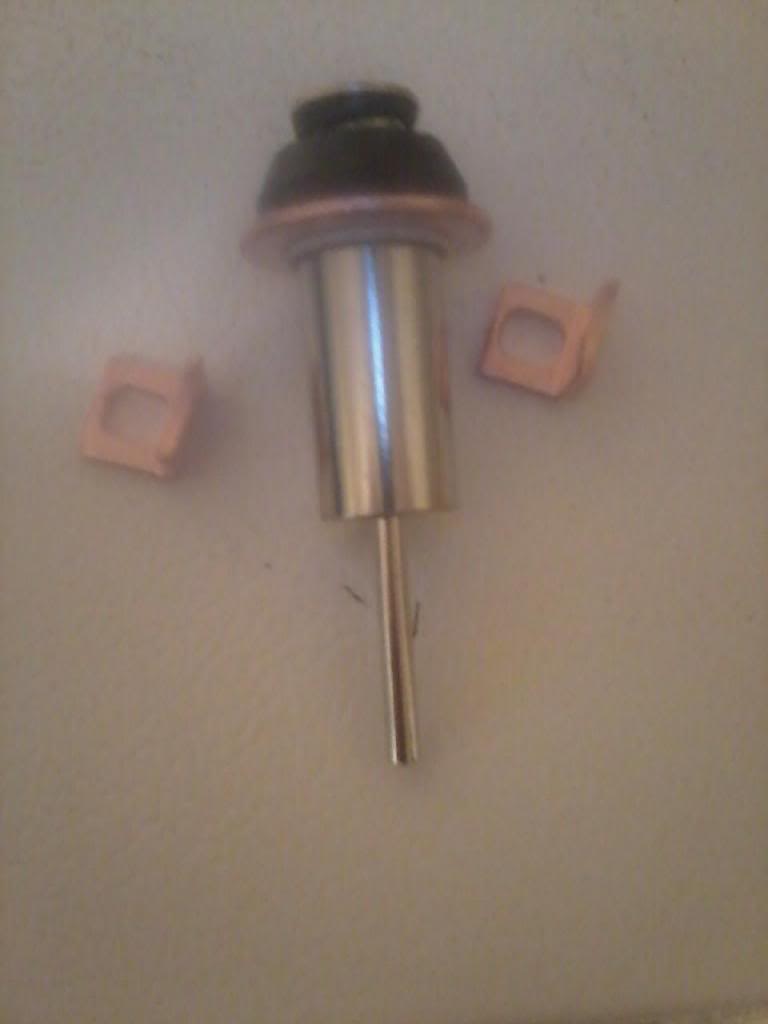

I also got my Starter repair kit in today. I am hoping to do the starter in the next couple of days. I am also working on the front bumper caps for the 86 pickup. Might get some pics posted later tonite of that if I get them done.

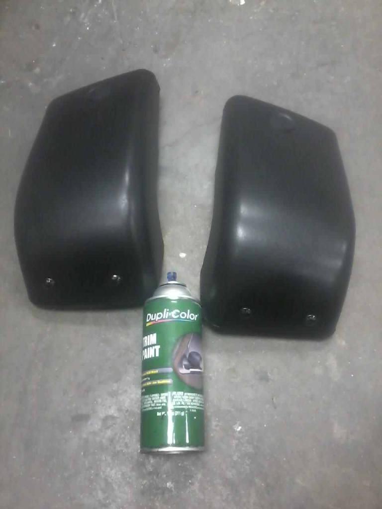

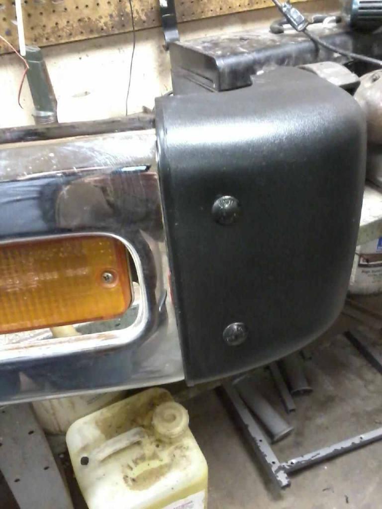

I mount the end caps to the bumpers with same size carriage bolts as the rest of the bumper uses. I have a couple of end caps out on the highways as I would just be driving along and the wind takes them off. I have had Toyota and aftermarket end caps to come off, so now I try to make it look like they are factory with the bolts. These caps were faded bad and I just use Duplicolor trim paint. These are for the 86 extra cab.
Here the caps are mounted and will post pics when I get it back on the truck. I will get a picture of them on the truck tomorrow.

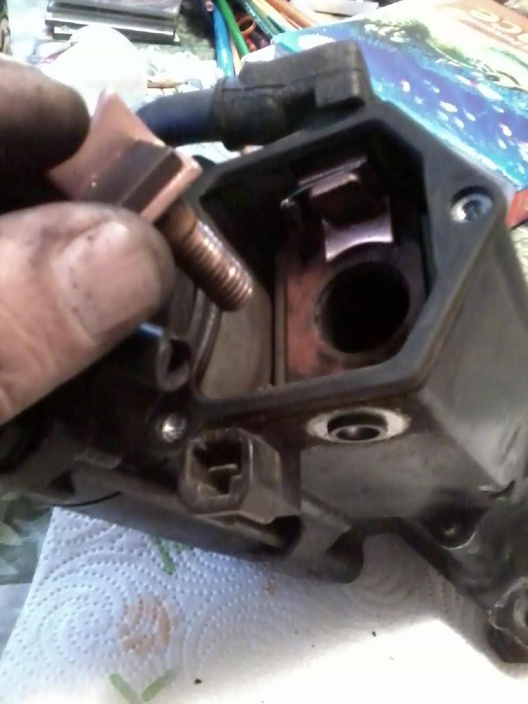

My battery was an old one and was low cranking amps for winter. I replaced it with the same battery that I have in Mistys. While doing that, I went thru the whole starting system and cleaned the contacts in the Starter Relay, and then replaced the contacts in the starter.
Here is my old ones compared to the new one.

When replacing the contacts, pay attention to the one contact that has a wire attached to it.

I got my new battery in. It is a 1000 Cranking Amps with 800 Cold Cranking Amps. I usually like to run the Diehard battery, but we have a battery store here and I wanted to give theirs a try. My dad say theirs are great so we will see. I replaced Mistys a month ago and now mine. They were old batteries. Misty went and had the 3rd gens oil changed and they said the battery is going bad in it as well. It is 8 years old so I am not suprised. Guess I will be getting one for it now.
I also got my starter in with its new contacts and plunger and I cleaned the contacts on my Starter Relay. Onlyt thing I want to do later on is do a little battery wire work and should have my starting system in fine shape.

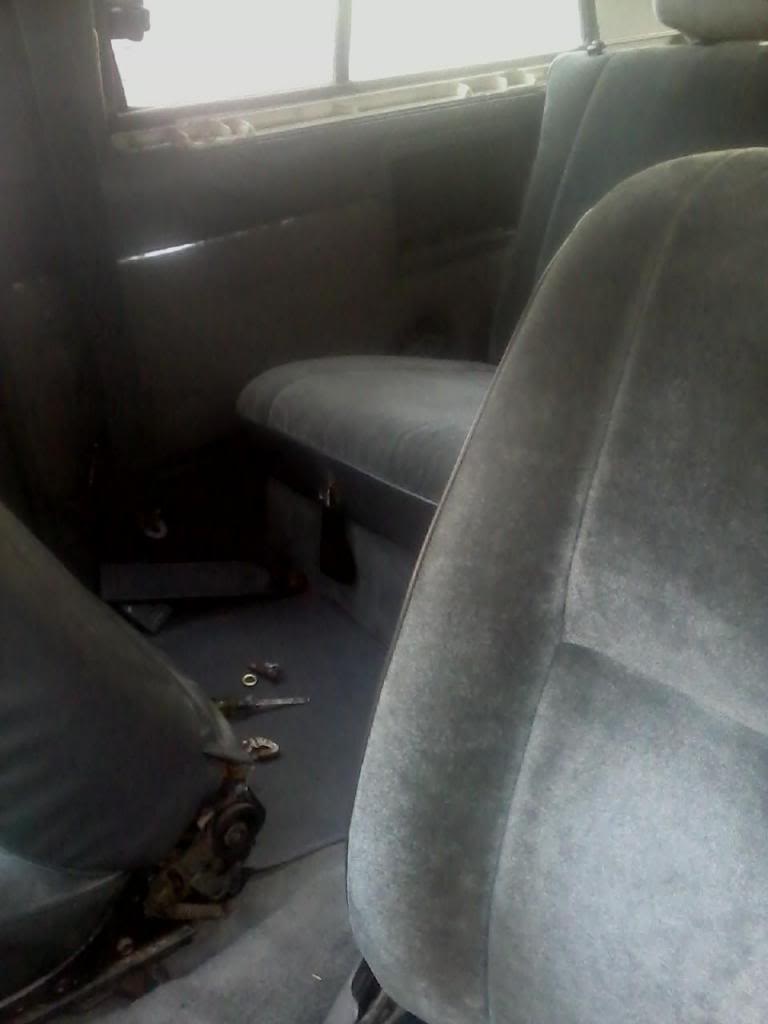

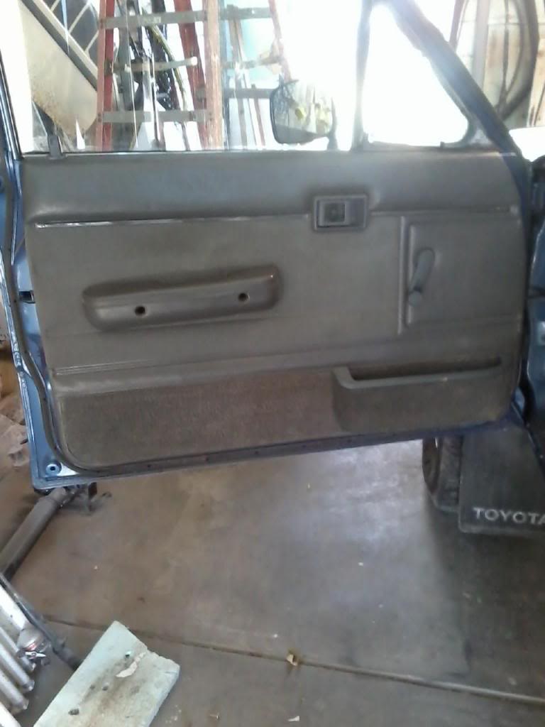

After that I got my SR5 door panels in. I dont like the first gen pockets so I stuck my 2nd gen pockets on. I will do some touch up on the carpet at the bottom of the door to match my pockets to doors a little better. Hunter gets my old panels. They are ok and will work for him.

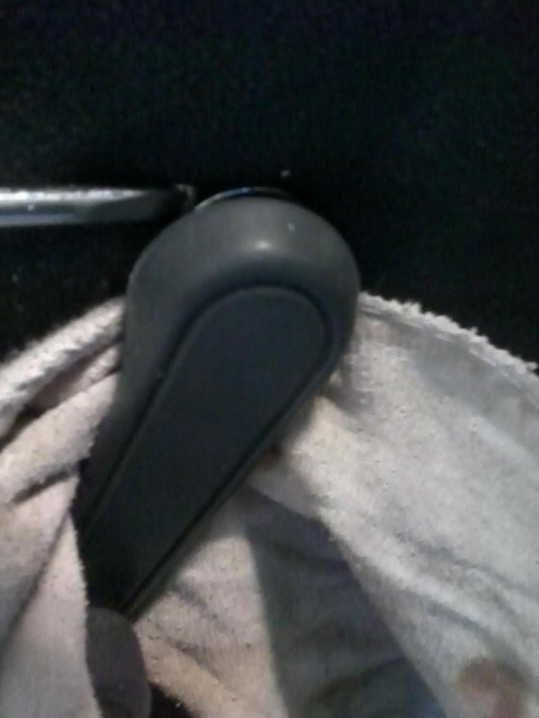

Here is how to remove the clip that holds the window crank on. Just posting this for others to see. Take a cloth and work it around until you see the clip. I then take a jewlers flat blade to lift the clip out.
