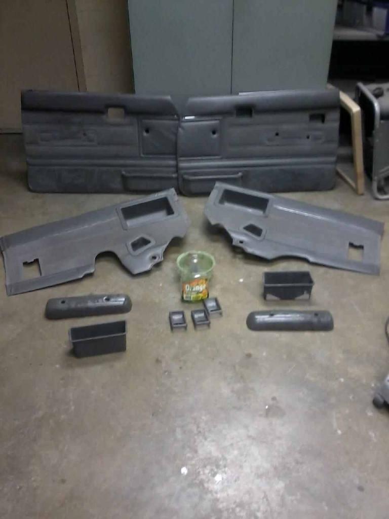

Here are my new to me SR5 interior panels.The left ones I cleaned and the right ones are dirty.

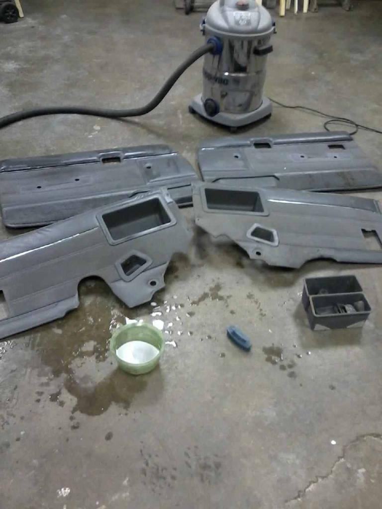

Here is everything cleaned. I just used a bristle brush, some Simple Green and a shop vac to get the water back out. Got my rear pockets that I just like having and little by little it becoming more of an SR5.

I have been spending my build funds on the truck but when something like this comes available, priorities do change. Could be sometime before I have a chance to get stuff like this.

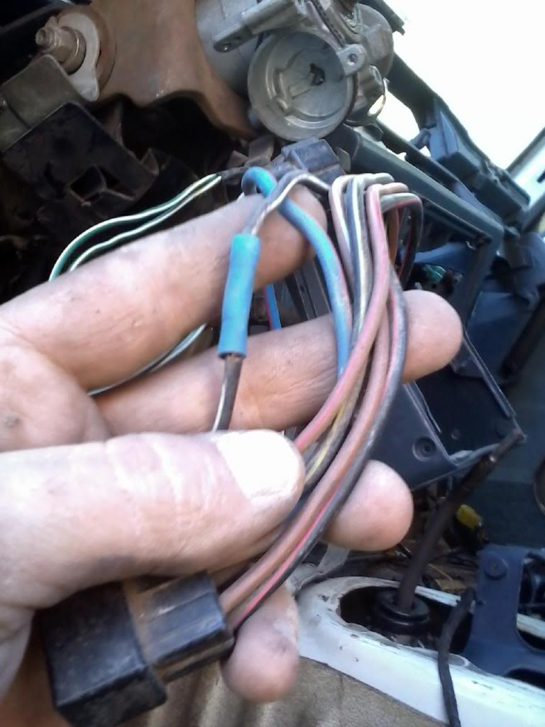

In the Steering Column that I installed, I found another butthead connector.

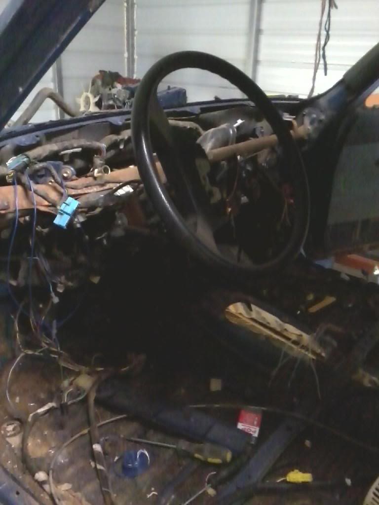

I did get rid of the cheezy steering wheel that the PO had installed. This wheel is small and was something I was glad to see the trash man haul off. Also I rented the tool to pull the factory steering wheel from a spare column. Do not try to bang one of these off as you will bulge the shaft. The tool is a must when swapping steering wheels.
