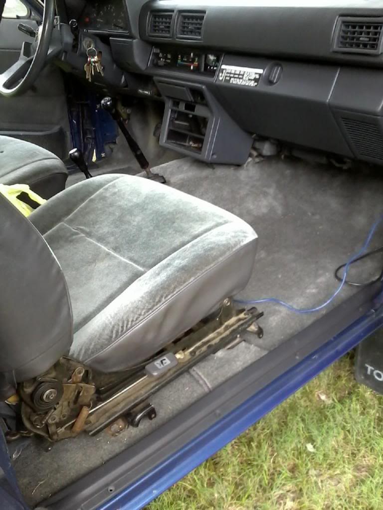

I was driving the 86 and I think I want to just turn it into a fully loaded SR5. I have plenty to keep me busy so it probably wont happen til the end of summer. The 88s clutch just went out, which I knew it was and have one ready to go for sometime, just wasn't going to mess with it while it is cold.
I have been thru my ignition system from one end to the other and the other day it clicked twice before it started. I am going to do RADs upgrade and do away with any future problems as well.
Not really a whole lot left to do on it, just making it more dependable and upgrading it which wont take much time if we could just get out of this cold weather.

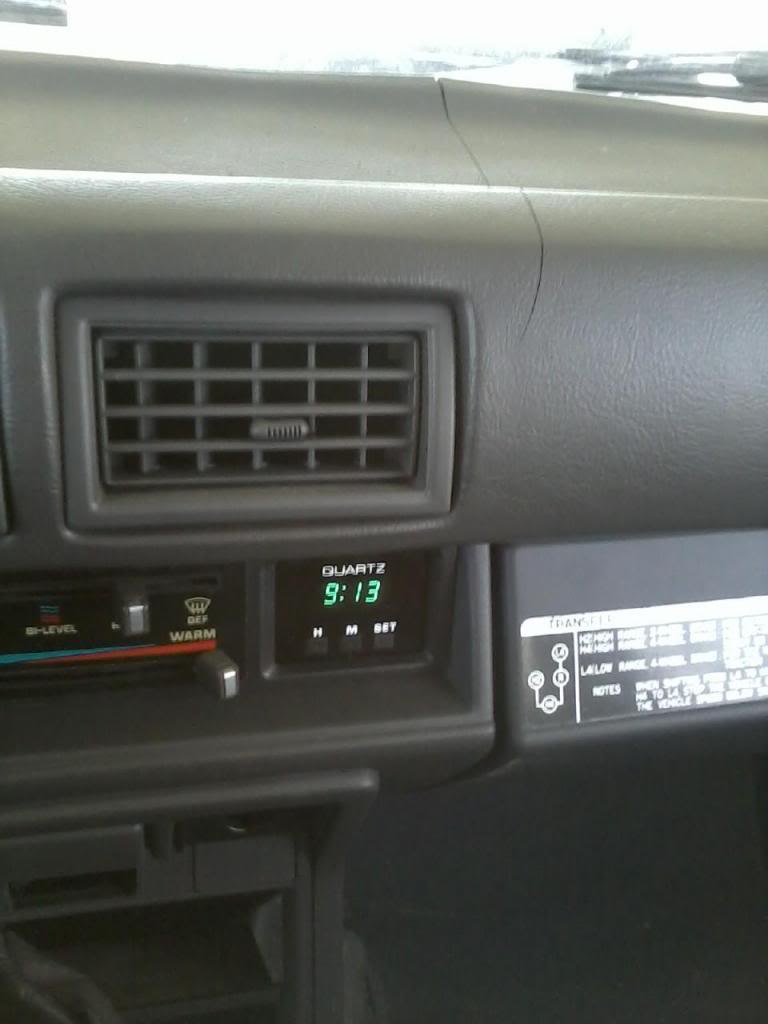

Two days ago I was driving the 86 and each time I drive it, I still feel like I am in a new car from looking at the dash. I replaced my dashpad with a near perfect one awhile back that I had gotten out of a camper at the bone yard. It had two different hairline cracks in different places. Barely noticeable.
Near perfect at one time. (older picture)
Today I was is in the runner and this happended over nite. Must have been the cold that got ito it. It cracked all the way to the front. Grrrr!!!

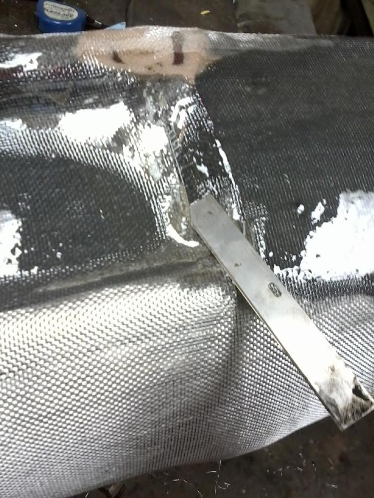

I have some spare dashpads that are cracked really bad. During my lunch break at work I am going to try doing Coraxs dash pad fix. https://www.yotatech.com/forums/f123...repair-230891/

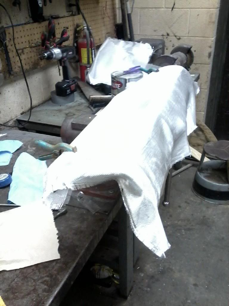

I picked up the Fiberglass material. I havent worked with Fiberglass a whole lot so will see how it goes.
The Victim.
The Victim.

Hello Gizler... I just got the fiberglass on and it currently drying as I type. At this point I am feeling good about it and looking forward to seeing if this could turn into a great learning experience. I kind of looking forward to it. I am sure there will be a few things to work out but so far so good. Tomorrow should be interesting.

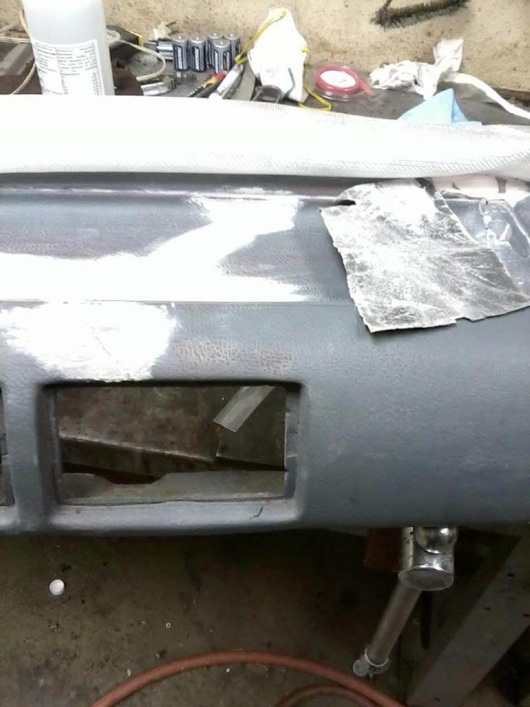

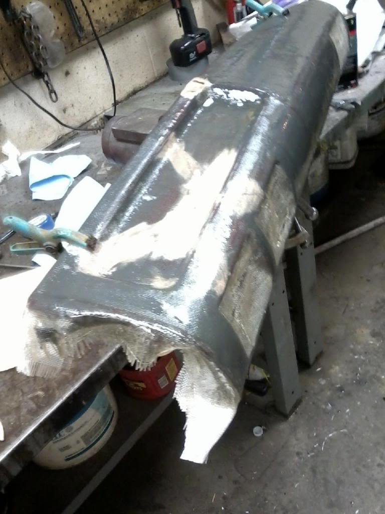

What I did was mix up some body filler and filled the cracks. I had some pictures and not sure where they went. After the body filler dried, I just smoothed it out with 320 grit sandpaper.
I could of used 2 more c-clamps, but I laid the fiberglass mat over the pad and allowed about 2 inches of extra mat around the edges. In one of the links where Coraxs linked off of the 240sx, the guy used glue to hold it down. I poured it on the mat and once it soaked thru the mat, it was sticky enough to hold. In one of the links, someone says they had issues with the threads getting every where. I found by taking a lighter to the edges, it didn't really melt the fiberglass mat but kept the threads from separating easily and I didn't have this problem.
I laid the mat over the dash and didn't really brush the liquid on, but more or less dabbed it to get it to soak thru. One problem I did have was where the pocket and vents are, it would keep pulling the mat up in other areas. What I did then was to add some relief cuts with a razor blade. This seemed to fix my problem of the mat moving. You will see whiteish spots where the mat is not making contact with the dash and just do a little dabbing to correct any errors. Also I had plenty of time to work with it. Bondo sets up fast, but fiberglass you have a lot more curing time.
Here is the dash covered in fiberglass. My intentions tomorrow is to put a light coat of body filler over the entire dash. I will do some more research and see if that is the best way to go as of know. I know I will lose factory texture that came on these, so I as of now plan on going for a smooth finished look. That could change depending on what I find in more researching.

I used about 1/3 of the can and not showing in the picture of the can of fiberglass is a tube of hardner in the top of the can.
The can of Resin is $20
The mat is $7

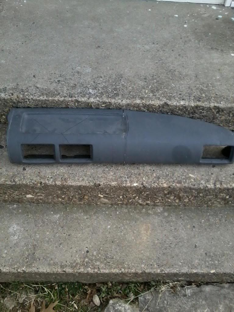

Thanks Gizzler00.. I will need to scuff up the resin to get it smoother, It actually has a slight run in one area and I would scuff it anyways just to make sure I get good adhesion. I will try to post some indepth pics of it. I sometimes have to go back thru my thread for a reminder and tips on something I havent done in awhile.
I am hoping I find a way to salvage these pads that will look nice. I have a few more pads for experimenting with as well. I checked it 4 hours later and it was just starting to cure. I moved it to a heated room and will get back to in on Wedensday. Takes longer to cure then what I would of thought. I know the possibilities of fiberglass is endless and is still a little new to me. Anniversarys come quick.
