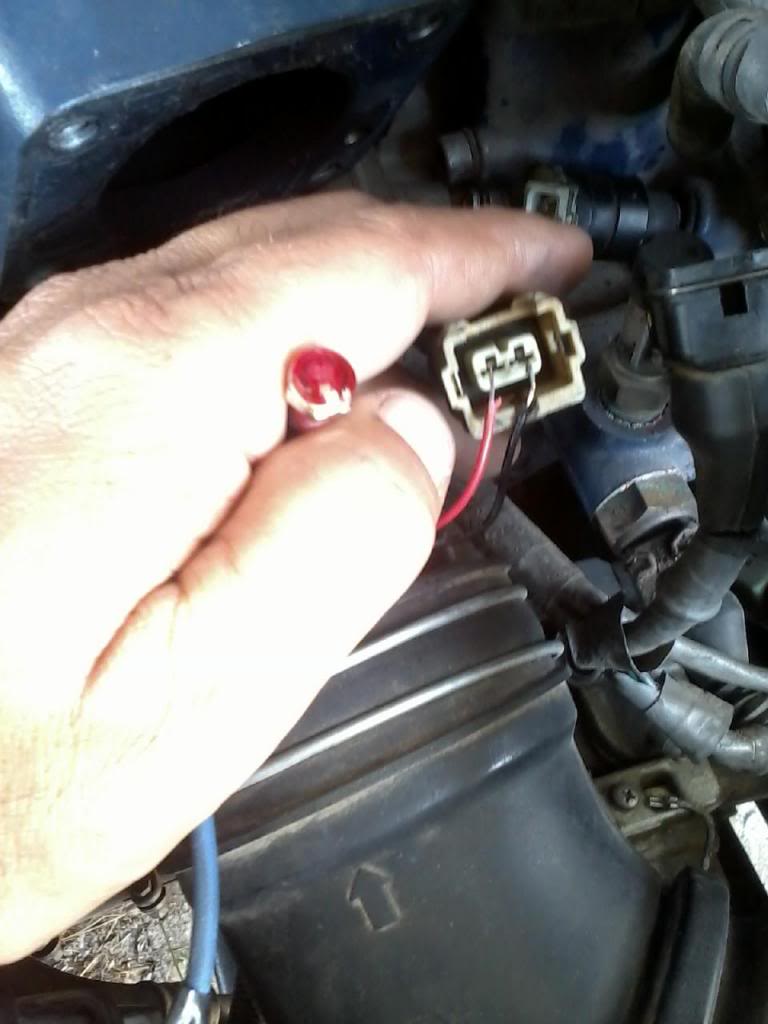

After suspecting my Injectors not firing. I tried to find a noid light for Toyotas. My local parts store didnt sell or rent a tester. I hear some do but not in my area from my experience. This worked for me and I seen a question recently about someone else asking. Hope this works for them as well.
I disconnected my fuel pump at its electric connection by the fuel tank. I was also checking for fuel flow problems and didnt want fuel everywhere, if fuel lines are connected, you wouldnt need to do this step. I then stuck each lead into the injector connection and while cranking the motor was able to observe the LED flashing.
Edited: Scope103 has a great point in the post below. The LEDs are polarized. If it does not work one way, switch the polarity or the leads the opposite way around. Thanks for Catching that Scope 103.
My $3 noid light. I was not able to find one anywhere and this worked great. It flickered each time I cranked it. I just could not get any pictures of it lighted.

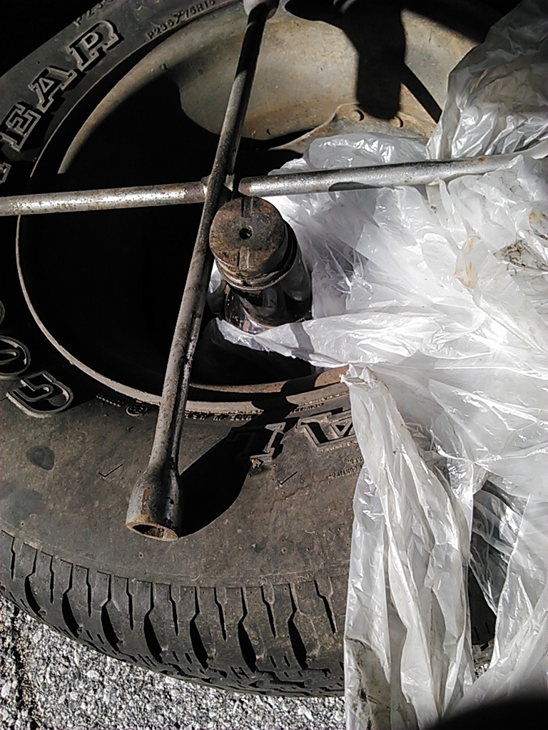

I had a flat on the road side today and I keep a 4 way in the well of the spare tire. I also keep a spare jack wrapped in a trash bag to keep it protected and out of the way. Luckily I did have my 4 way as I was unable to break a nut loose with the factory lug wrench.
Where I stow a jack and 4 way.

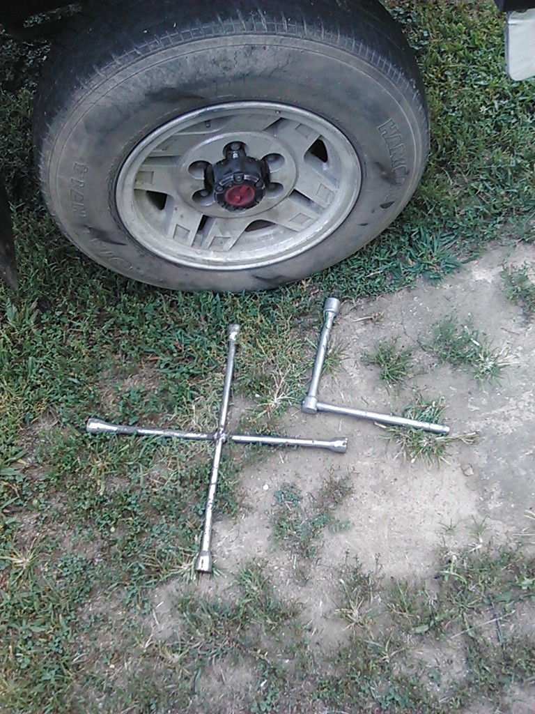

The lug wrench Toyota uses is not long enough for some leverage. You can get a smaller 4 way to fit inside the tire well a little better and still get some better leverage. It just takes a little work to make it fit under there and not rattle. Glad I had my 4 with me today. I mentioned this to another member and he liked the idea.
