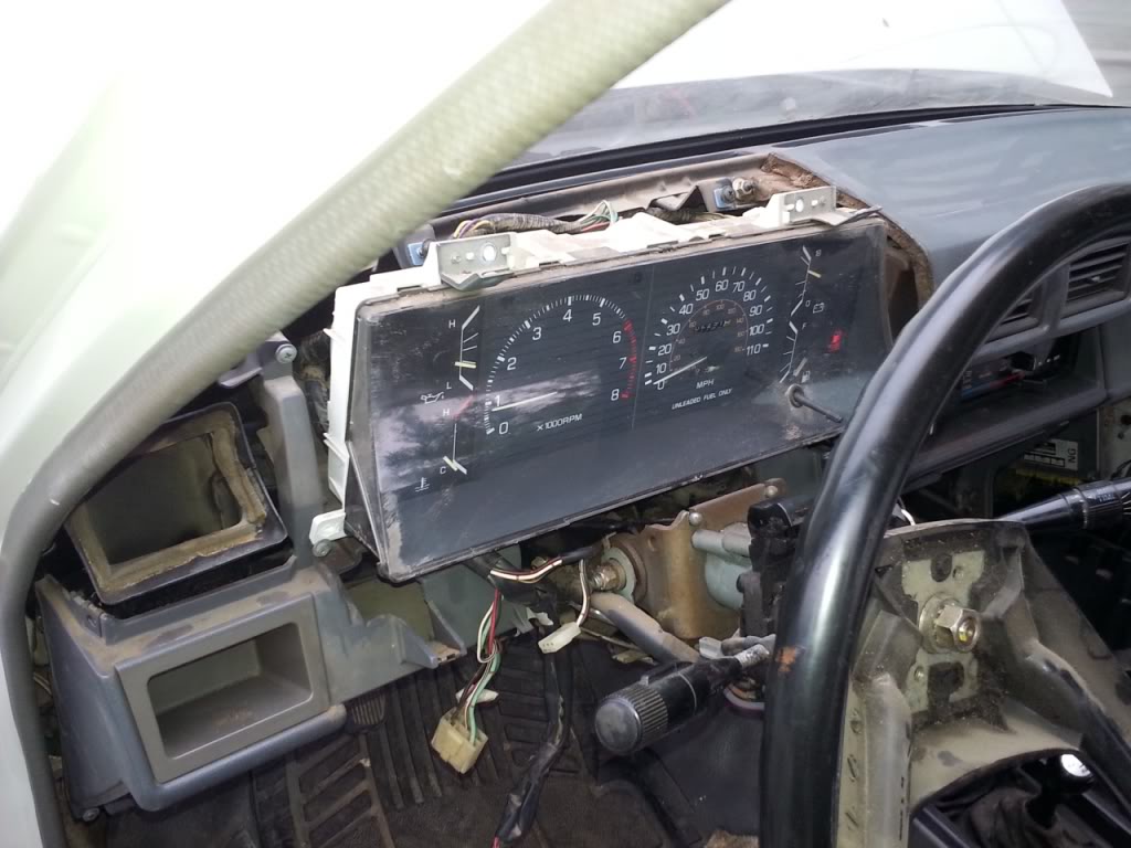

id appreciate that terry i tried sticking a bolt in there an nothing is there to bolt likely gona have to pull the door apart an fix this

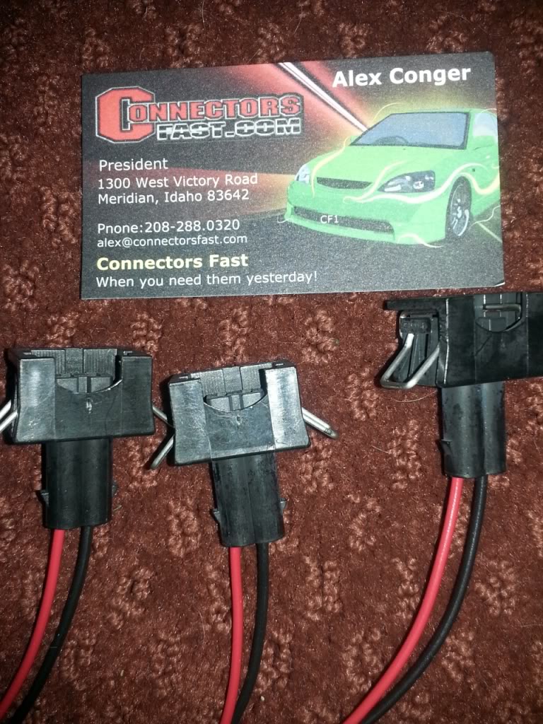

Hey Terry, looking good on those EV1 connectors. I hate the factory ones because you have to get something like a pick in there to remove those clips and hope that they don't drop like they have on some occasions when i have taken them off. Plus because of the age, some of them are cracked. In your past post I remember you mentioning those connectors to the TPS, soon I will need to change the one on mine, some where along the line part of the plastic cracked on me that holds the clip in place.

Hello junk4u...I just bought one to see how I would like it and how it would work out. It is better all the way around and a whole lot easier to install and remove. I am just noe getting to putting on the other 3 I got the other day.

I had to replace the water hose under the Plenum and am installing the other 3 connectors that I got from the above mentioned. These are a great improvement and the condition of the connectors that was on before is a big improvement.
Showing the different stages of installing them and trying to get used to the phone and posting pictures. Do like the idea of them going straight to photobucket.
